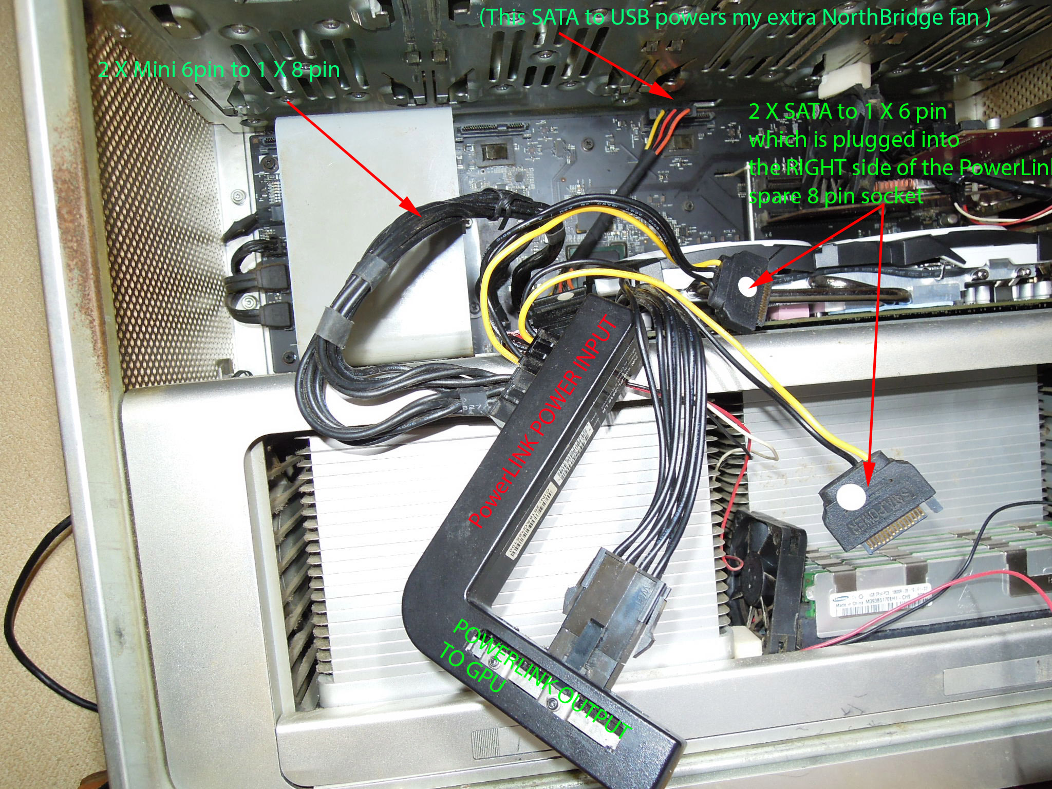

A suggestion.
Buy an EVGa PowerLink ; it balances all power fed to it and then on to the GPU.
Although originally designed for Nvidia cards it works just was well with AMD cards as well if set up correctly.
My MSI Armor RX 580 8gb is not EFI flashed and I only have two 1080 monitors but I power my RX 580 thusly ..
1. TWO X Mini 6 pin to ONE 8pin - this goes to the PowerLink's 8 pin INPUT female socket
plus . .
2. TWO x SATA to a MALE SINGLE 6 pin - this goes to the right side of the PowerLink's other
female 8 pin socket.
The combined power from "1. " & "2" go from th e PowerLink to the R9 580's 8 pin female socket
plus . . .
3. The PCIe slot power.
If I'm not wrong - correct me if I am. . . . the total is over 300w.

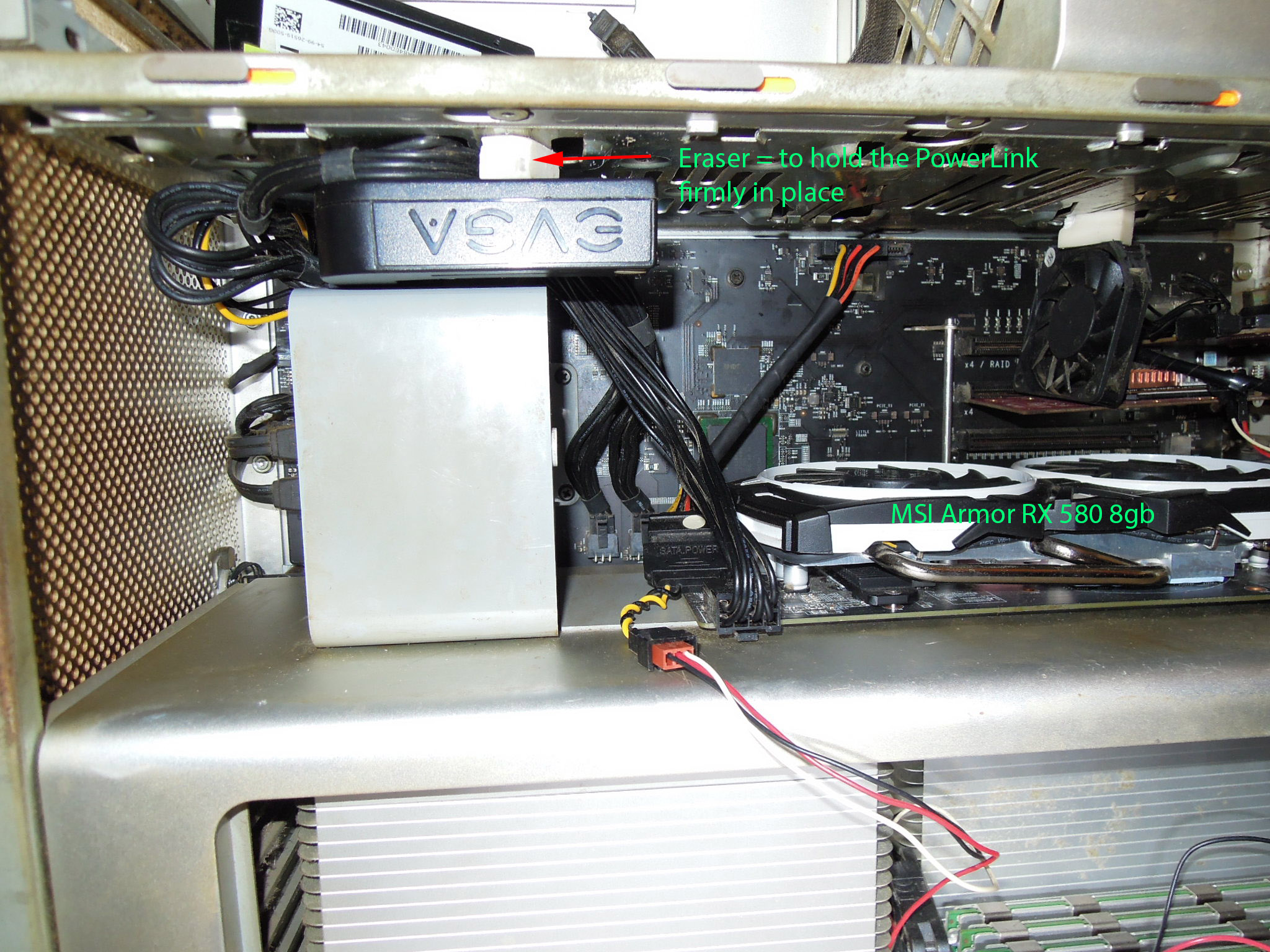

Note : Because the R9 580's 8 pin socket's cable lock tab now faces DOWNWARDS I had to connect the PowerLink remotely = it sits on top of the PCIe area's INTAKE fan - held firmly in place with an eraser :D.

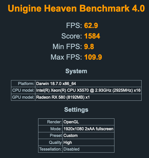

I just ran Heaven at HIGH + Anti-aliasing X2 and was pleasantly surprised with the benchmark, it is the highest I have achieved since adding the extra two SATA to 6 Pin power.
I agree that your 4k monitors resolution and your Heaven settings are most probably demanding more power than usual. My aging eyes can't really discern the difference between 4k and my current 1080 x 1920 setup.
I'll post some pics I took of the setup later tonight.
Just a suggestion.

I don't think you would need a Pixlas mod for your RX 580 but the extra power added by the two SATA ports + 2 x Mini 6 pin to 8pin to an EVGa PowerLink PLUS power from the PCIe slot should give you all the power you need to run 4K at your monitor's resolutions.
My MSI Armor RX 580 8gb setup. ( Looks messy but it works )
In situ
( Looks much nicer, neater directly connected to my Sapphire Dual-X 7970 :D )

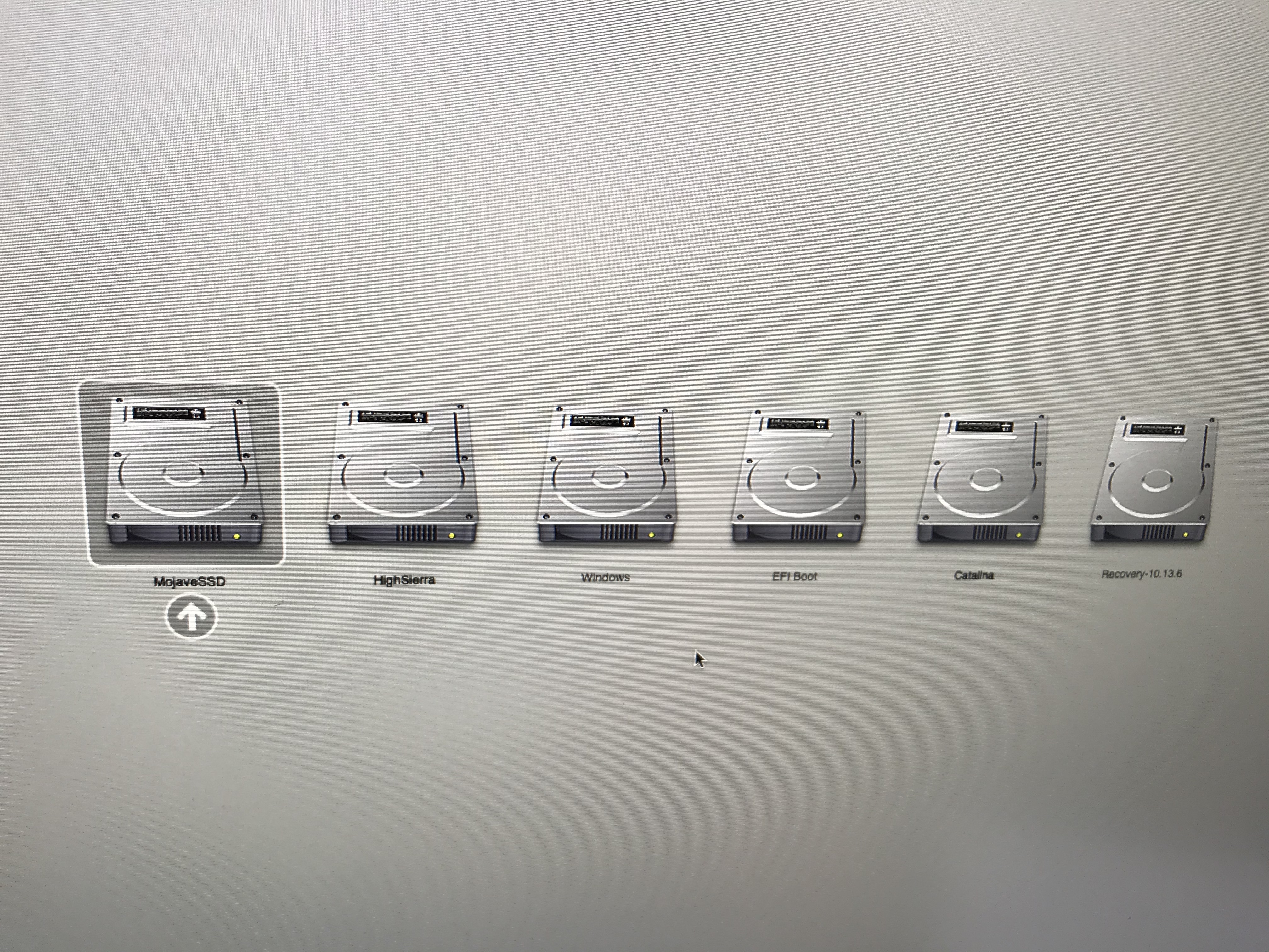

Well, I got my MVC RX 580 8GB
1. It works. Boot screen is displayed in 4k (30HZ), during macOS load progress it changes to 200% dpi.
2. the GPU is NOT NEW, I'd say it's at least a year old, maybe even two: lots signs of wear...
3. Displayport/HDMI holes were misplaced (couldn't insert displayport cable!) and I had to disassemble the card to tune it a little. One HDMI cable has problems inserting, like it's "too tight".... Not good, really :(
PS. I believe MVC don't bother buying a new RX Saphire RX 580 card (for 195$ at the moment) but is searching for some bargains. That's why probably their patched gpus are mostly "out of stock"...

My RX580 was purchased from MVC and I have been pleased with it. While I didn't expect a brand new card, I didn't see any evidence of excessive use or wear on mine. My last card was a 980ti that I purchased retail and sent to them to have it flashed. This time I just purchased the card direct from them since the cost of a card + flashing cost was equal to what they charge for an already flashed card...
I am powering mine via a cable soldered directly to the PSU and it has been rock stable in OS X and Windows 10...
