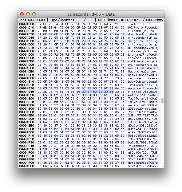

It's differing from the original in the following:
- the warning.CAF files (obviously) in locale-specific subdirectories under /Library/PreferenceBundles/CallRecorderPreferences.bundle and their accompanying plist file, containing the CRC of the CAF file
- the CRC's are also contained in /Library/MobileSubstrate/DynamicLibraries/callrecorder.dylib. An example screenshot of the first CRC in the original file:
No other changes have been made – everything else is exactly the same as in the original version, including the control, postinst and postrm files.

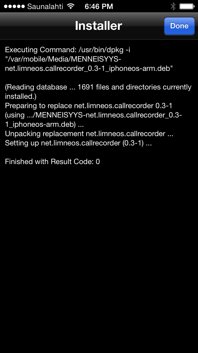

Done (with producing quite a sizable phone bill for me :) ) - now, with the MS Reload fix (available from the devbug.me/apt repo) active to avoid having to reinstall MS after every reset.
My findings:
- after a reset, AR didn't record in any case, not even if I flipped the switch twice before calling.
- after a reset, if you do reinstall AR (by simply tapping the DEB file from inside iFile), all subsequent calls were recorded. No Enable switch flipping was necessary.
All in all, you only need to simply reinstall my DEB file after restarts. Nothing else needs to be done. And also install MS Fix - again, all the tests above have been done with it enabled.
With all this, now it's perfectly safe for iOS6 users depending on to upgrade to iOS7, assuming they don't forget the reinstall after every single reboot.
EDIT: you can safely reinstall my DEB file on top of a working (for example, already reinstalled) call recorder any time, should you forget whether you've already installed it after a reset. It won't mess up anything.

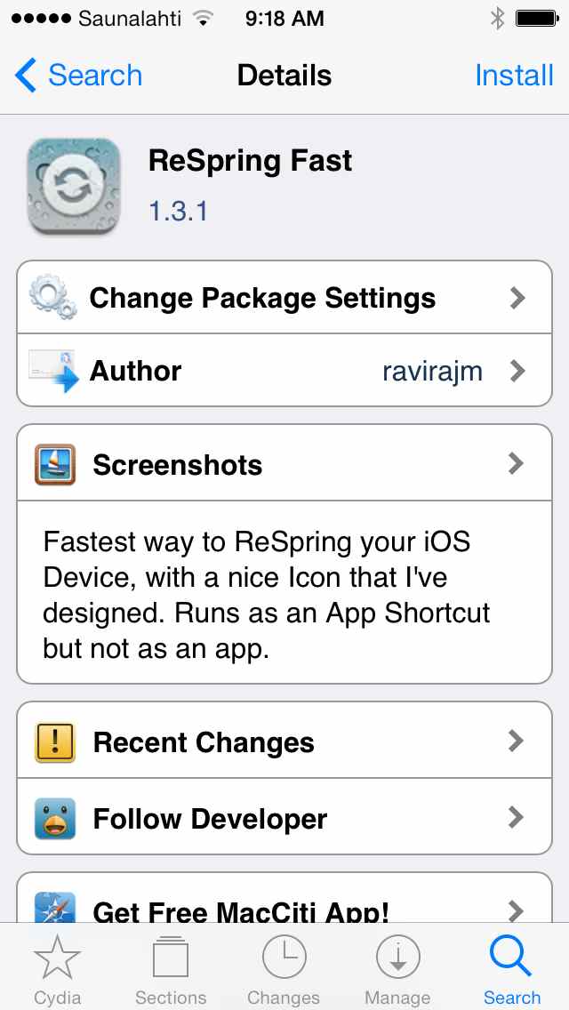

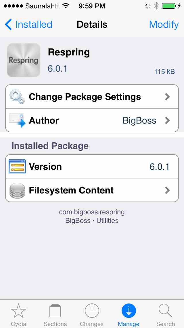

Warning: do NOT use ravirajm's ReSpring Fast for respringing. As of 1.3.1, it doesn't properly respring. Cydia image:
Use BigBoss' slower but at least working Respring 6.0.1 instead:

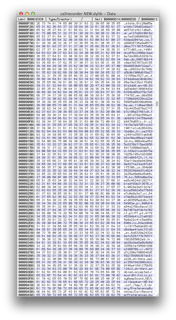

I've just found the CRC's in the new dylib:
If you compare it to the old, 3.1 version at https://forums.macrumors.com/posts/18548567/ , you can see their position is also greatly changed - yes, the dylib has indeed been recompiled for 64-bit.
Hope I can mute it...
