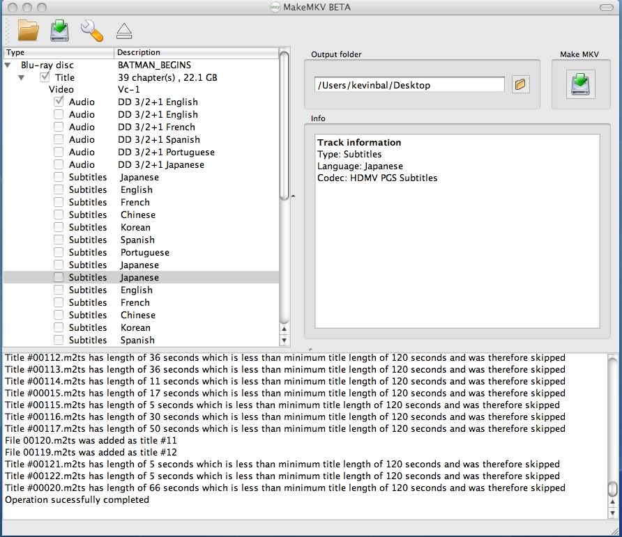

Well, almost every BD that I've ripped (0 failures so far), title 0 has been the main feature. I haven't done a single 'full disc' rip, but rather just the main feature and audio track, I'm not going to use the rest for Handbrake encodes, so why waste the time/space?
Are you trying to do a full disc rip or just the main feature?

Aside from that, I've always just saved everything to the desktop and the moved/edited it from there. I'll post a screenshot of my program right before I click the magic button for you in a bit.
