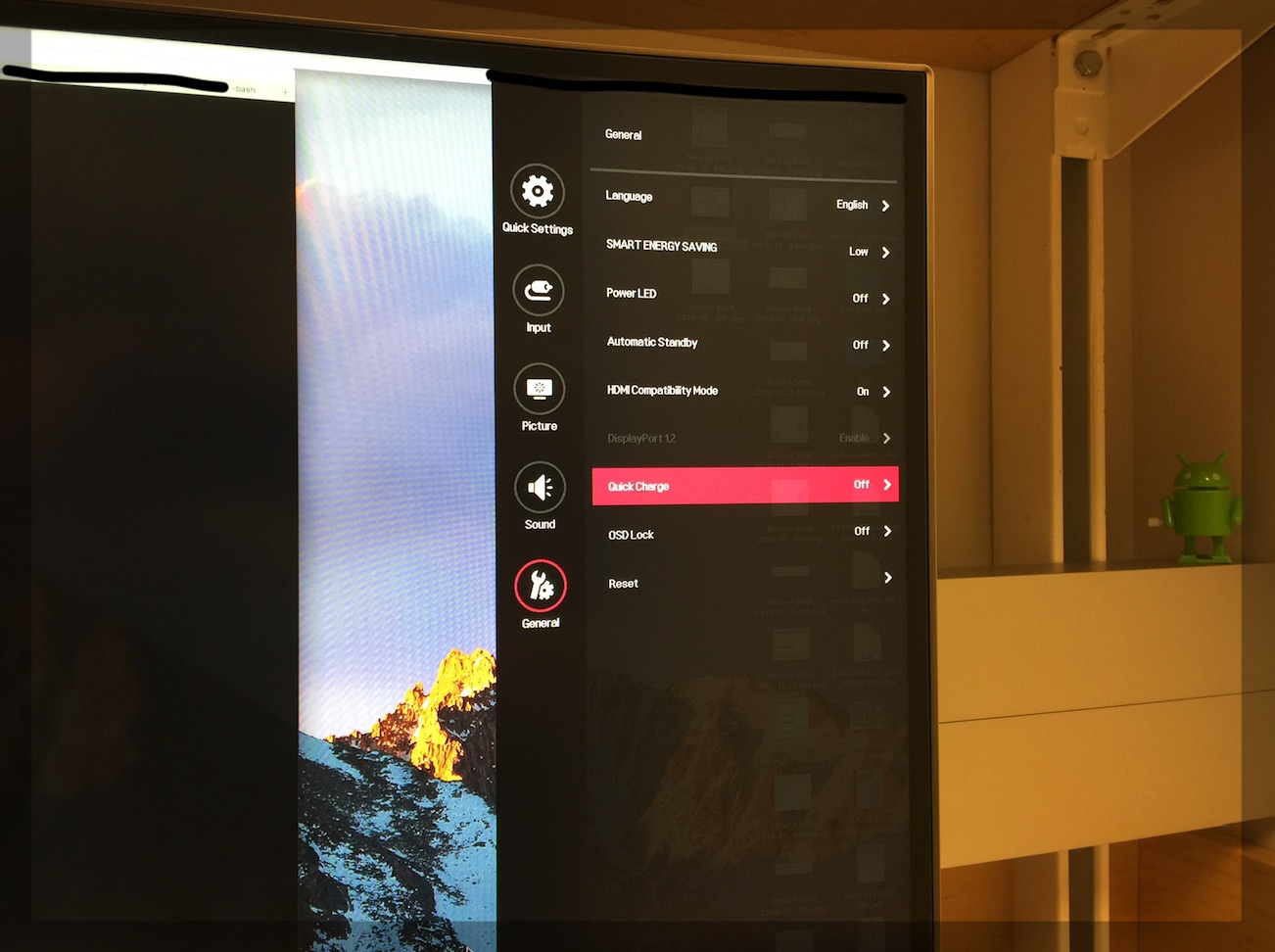

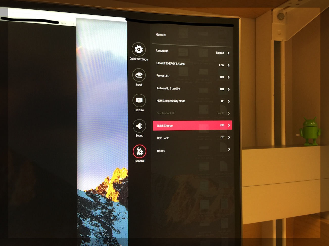

I'm not seeing the USB-C charge option anywhere in the menu settings...

general>quick charge?
AMD freesync is a tech built into the video card i Ielieve, you need supported AMD card
USB Quick Charge is to quick charge mobile devices, such as an iPhone... It does not charge the 15" MBP.

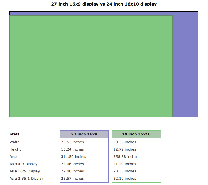

You should consider two 24" 16:10 instead of two 27" 16:9.
24" 16:10 have about the same height has 27" 16:9 but with a more manageable width.
screen-shot-2009-10-20-at-4-19-26-pm-png.199630
Dual Dell U2415 would be a pretty nice setup.
