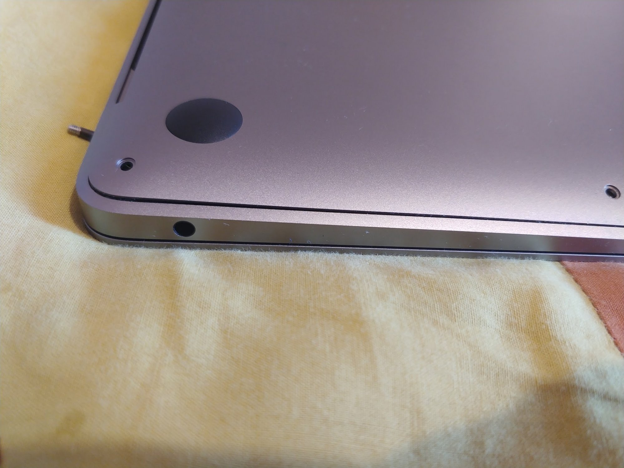

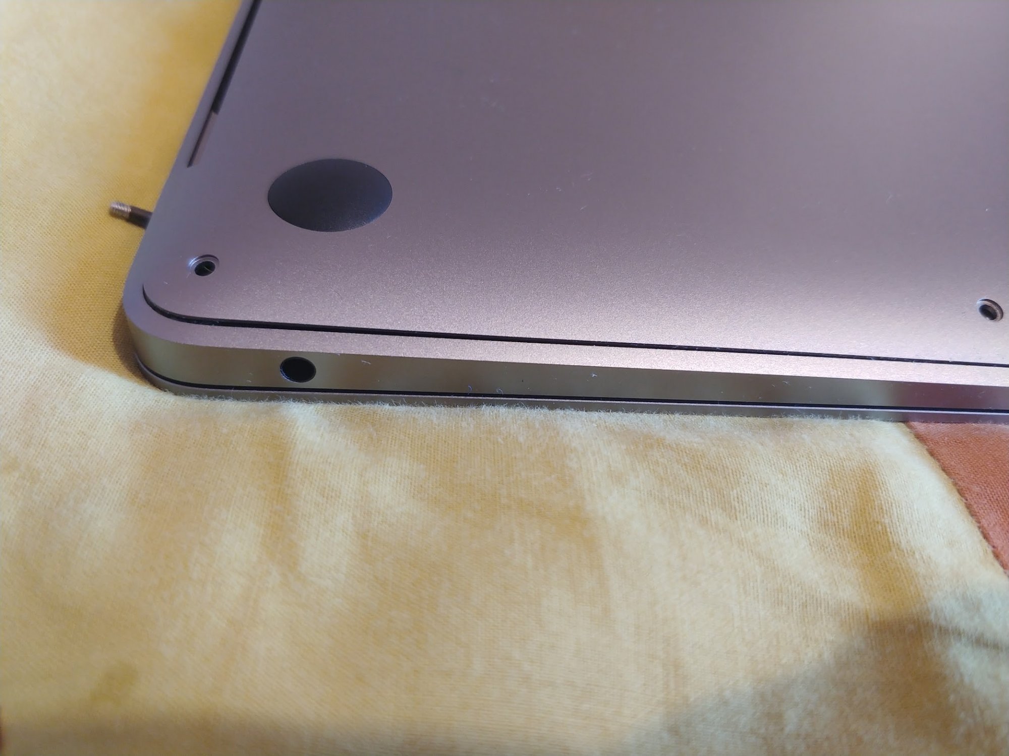

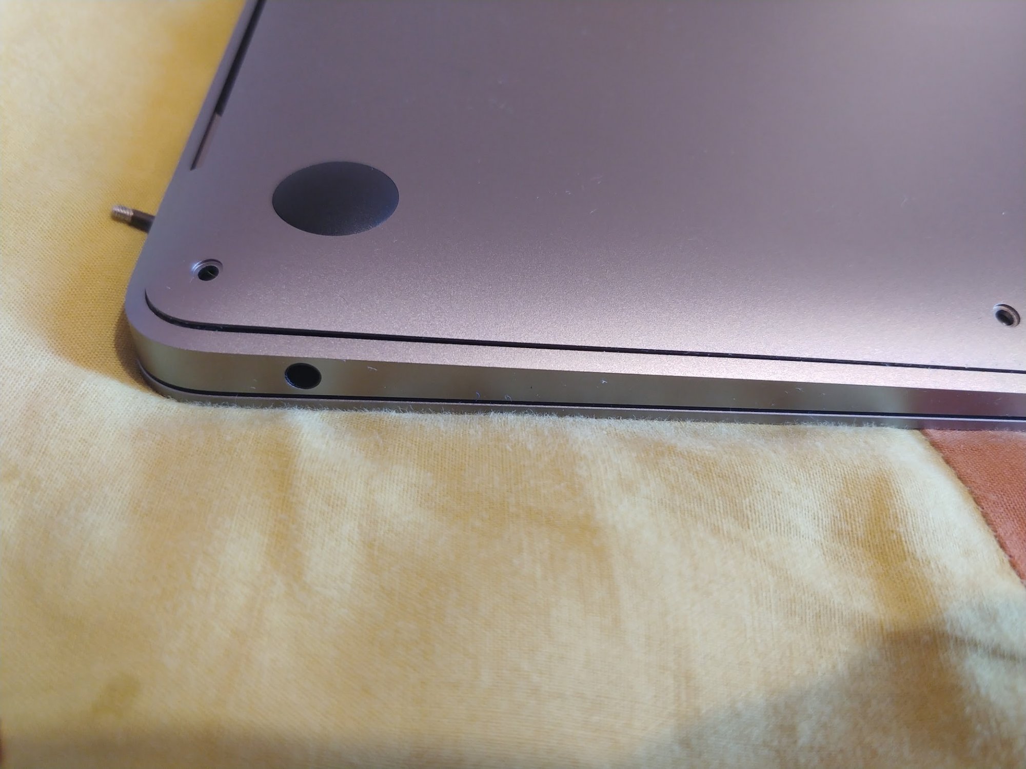

Mine wobbles too, and after removing the screws I see this. Is the bottom case not fitting in perfecting and resulting in the wobble?

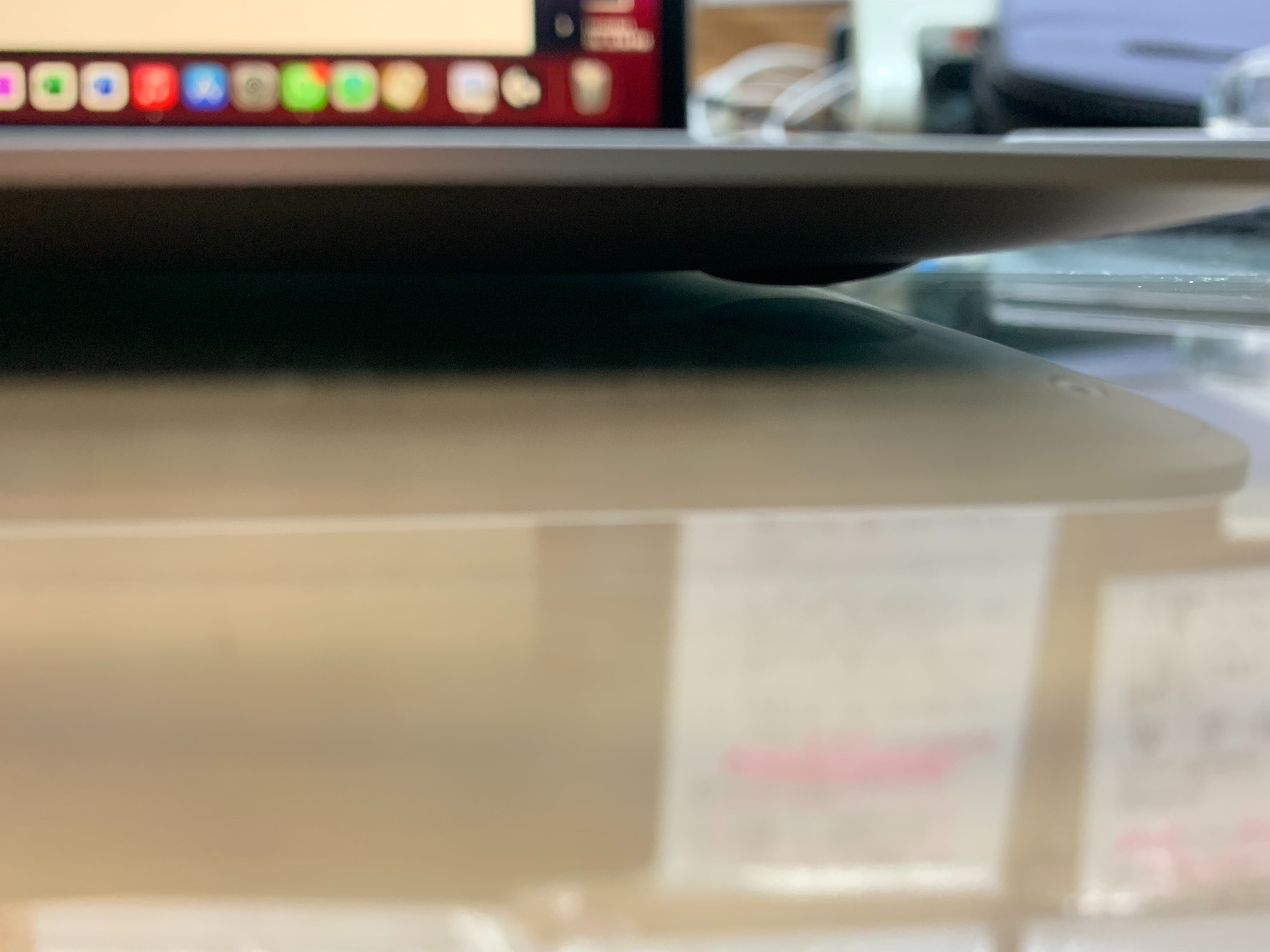

I can clearly see that corner raised in the air by at least 5mm. 😀

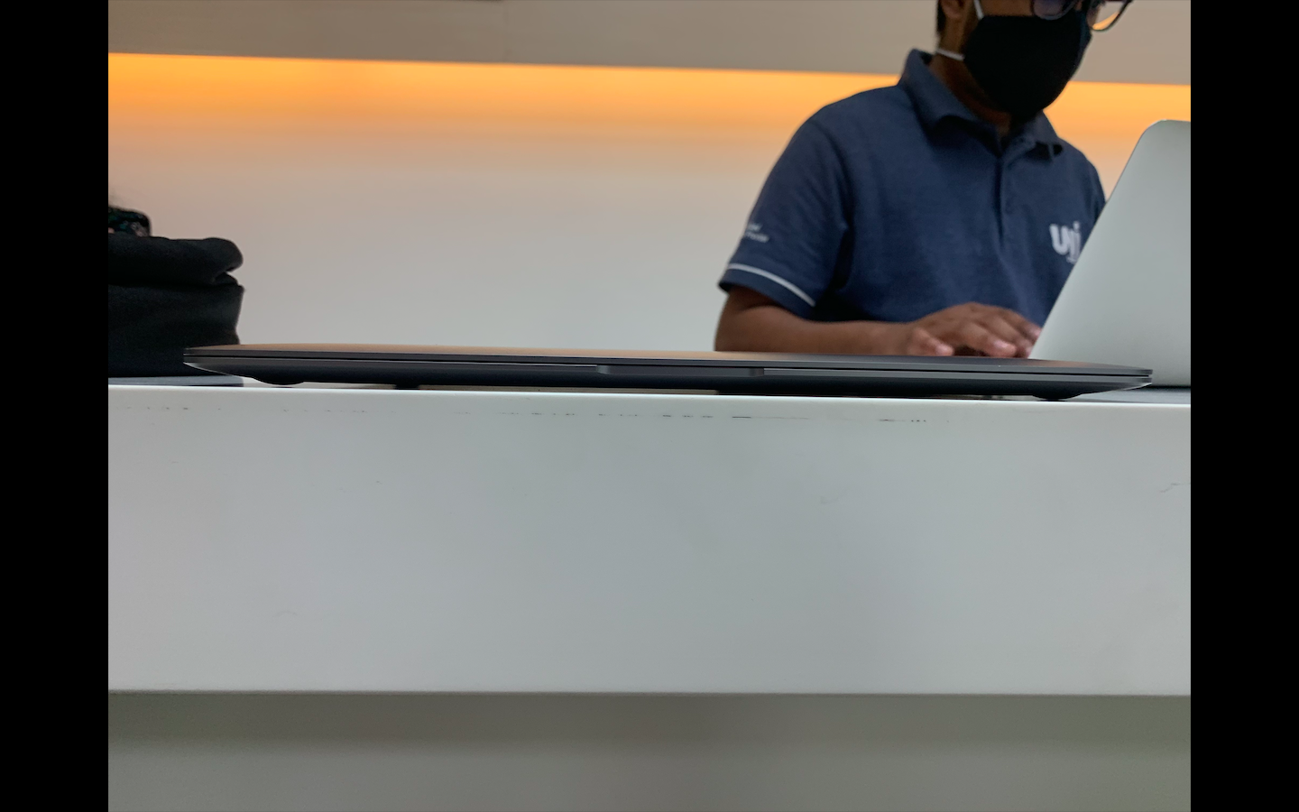

BRO CAN YOU PLEASE SEND ME YOUR CASE ID. SERVICE CENTRE IN INDIA is not helping me out. Maybe if i show them your case id they might help and consider it.
