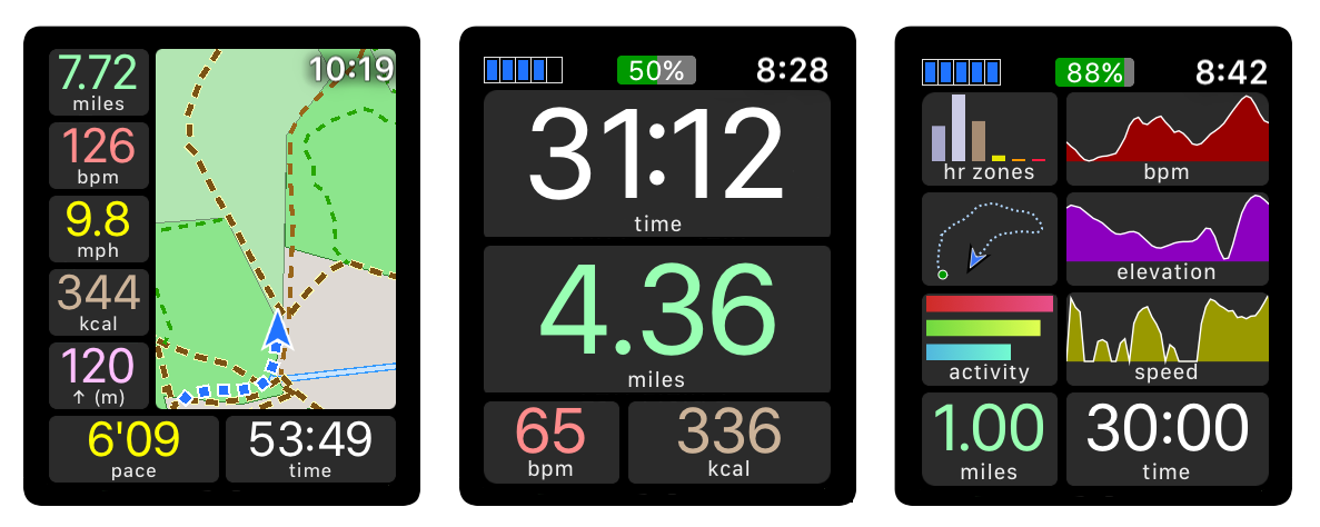

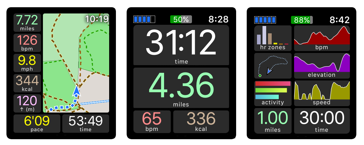

It's great to hear that you like the app. The next version (released in a month or so) will have 4 different display formats:
- the existing format with 2 or 3 fields below the map;
- an 'L' shape with a smaller map and data fields to the left and below the map.
- a "tower" with 2 to 4 large fields above 2 or 3 smaller ones (which sounds like what you want);
- a grid with 2 or 3 columns of 4 to 6 fields;
Each of these modes will have a choice of 3 text sizes (hence the varying number of fields) and a full screen map will always be available by double-tapping the screen. Double tapping the map again shows the data.
The fields will be fully customisable by the user, choosing from a pool of over 170 live fields, including graphs and buttons. The app will come with a set of pre-configured "profiles" showing particular types of data. So for example you can easily switch from the Heart profile to the Pace, Elevation, or Graphs profiles at any time during a workout. You can tailor any of the profiles to show exactly the fields that you wish to see.
Hopefully these are the sort of features that you want?
Incredible !
It's far more than I was expecting ...
I really congratulate you for this awesome work !
If you need someone for beta test ...
