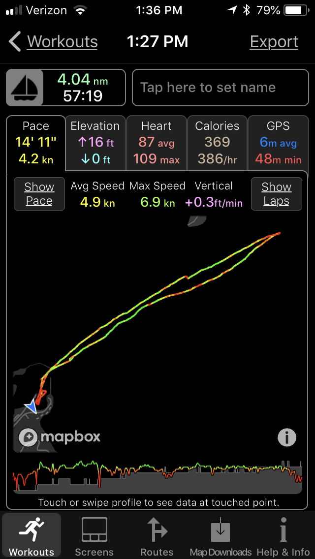

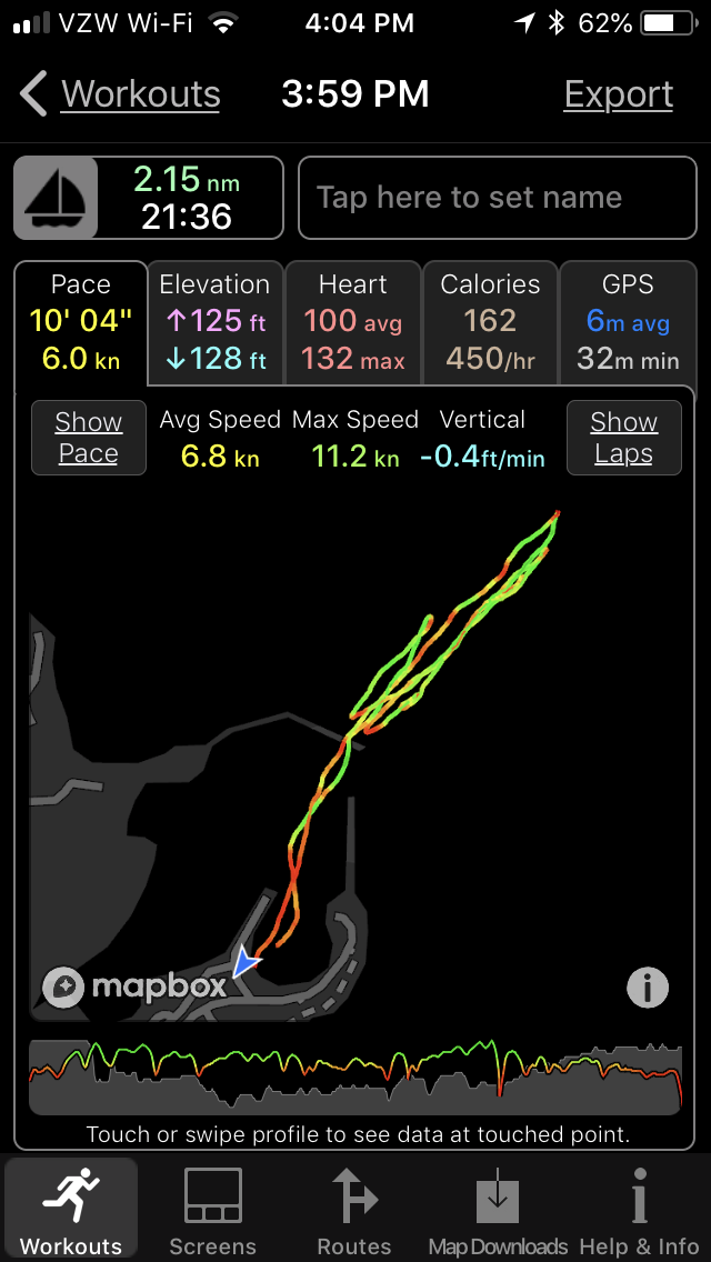

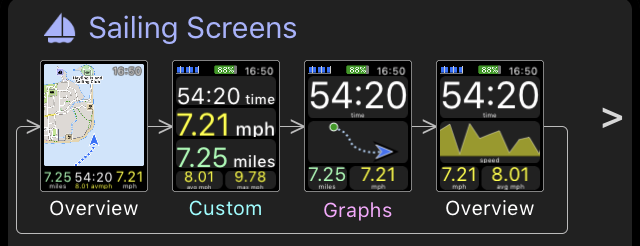

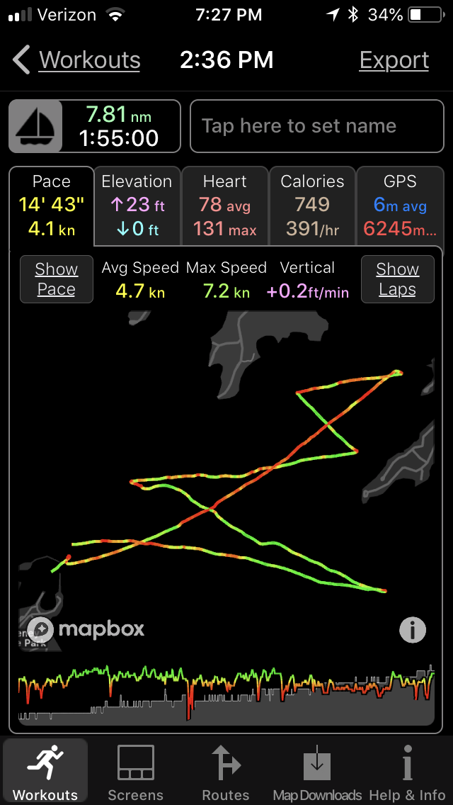

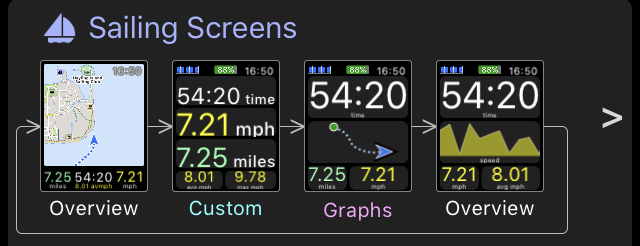

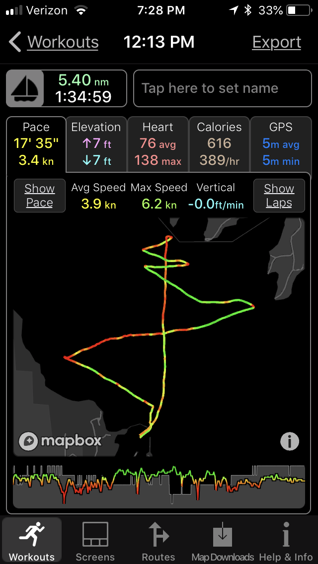

Took the app out sailing today. Extremely pleased with screen options. I mainly used the 2nd screen option today.
Got a couple of good workouts as well!
Trying to figure out the pace numbers and how that relates to sailing.
Like last year, the map still shows me sailing though the jetty.

Glad it worked well for you! I guess that the GPS was either slightly wrong or the position of the jetty on the map is slightly out.
It looks like the map data is wrong. I imported the GPX file into Google Earth and the data plotted correctly. I put in an error request to fix the data using the 'Improve this Map' function.
Thanks!
Thanks!
That's great - thanks for that.
I had forgotten that I had added that feature! It was a requirement of switching to using data from Mapbox.

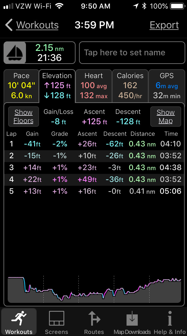

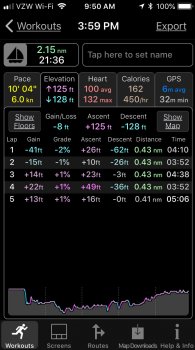

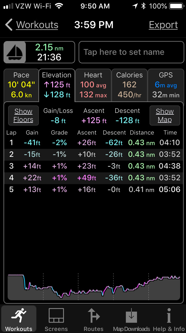

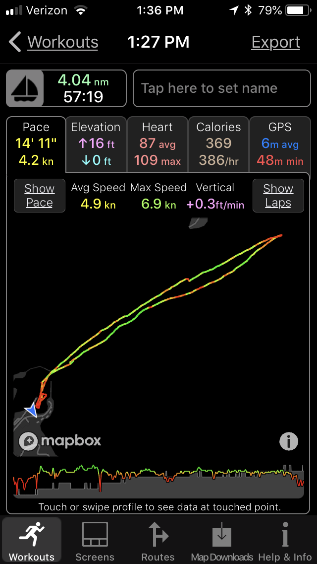

I have been looking over the data from yesterday and noticed the elevation readings. How does the tracker calculate this?
For example, on the first lap it shows I 'climbed' 26 feet. The reality is I'm always sailing at whatever level the lake is at... currently 1,920.60 feet above sea level. So theoretically my elevation wouldn't change. However, I am sailing over waves which yesterday was 1-2 feet. Is this a cumulative total? Is the simple fact my boat is climbing up a wave adding to the total? In the same case I'm also falling down 1-2 feet over each wave.
Just curious. I've never paid much attention to elevation with workouts in the past.
Thanks!
The elevation is determined using a barometer if available and if not then by using the GPS elevation. What series of Apple Watch do you have? Series 3 watches have a barometer, which would be more accurate than GPS, but neither is perfect. The app smooths out the values to help reduce the inaccuracy, but it cannot smooth out every variation. The watch barometer only supplies relative elevations to the nearest metre, so even if you had a barometer then it probably counted some of the waves but not others.
To be honest the elevation smoothing algorithm is more suited to land than water! I may look into tailoring it for sailing though, by making it do more aggressive smoothing.

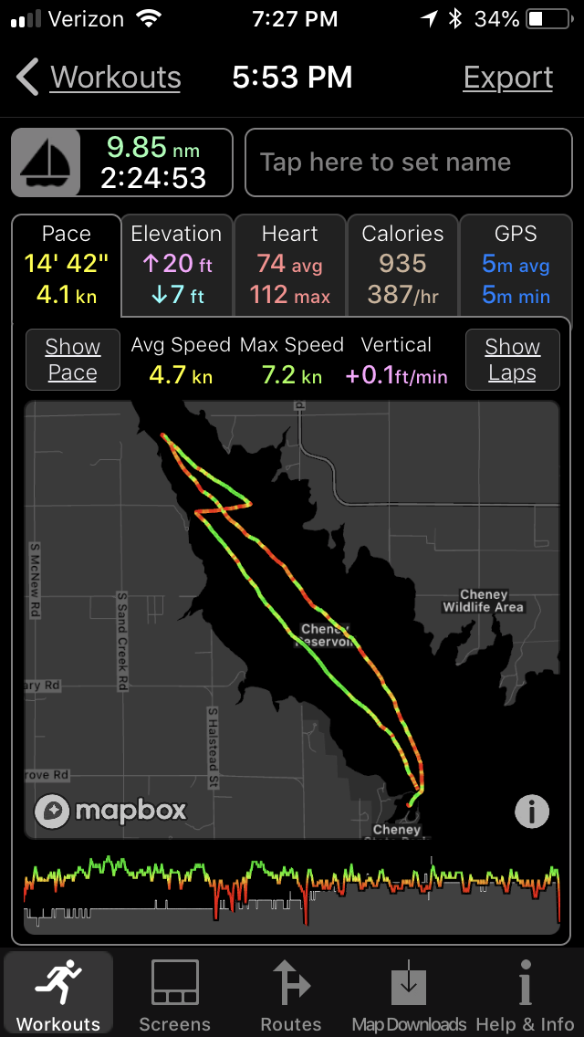

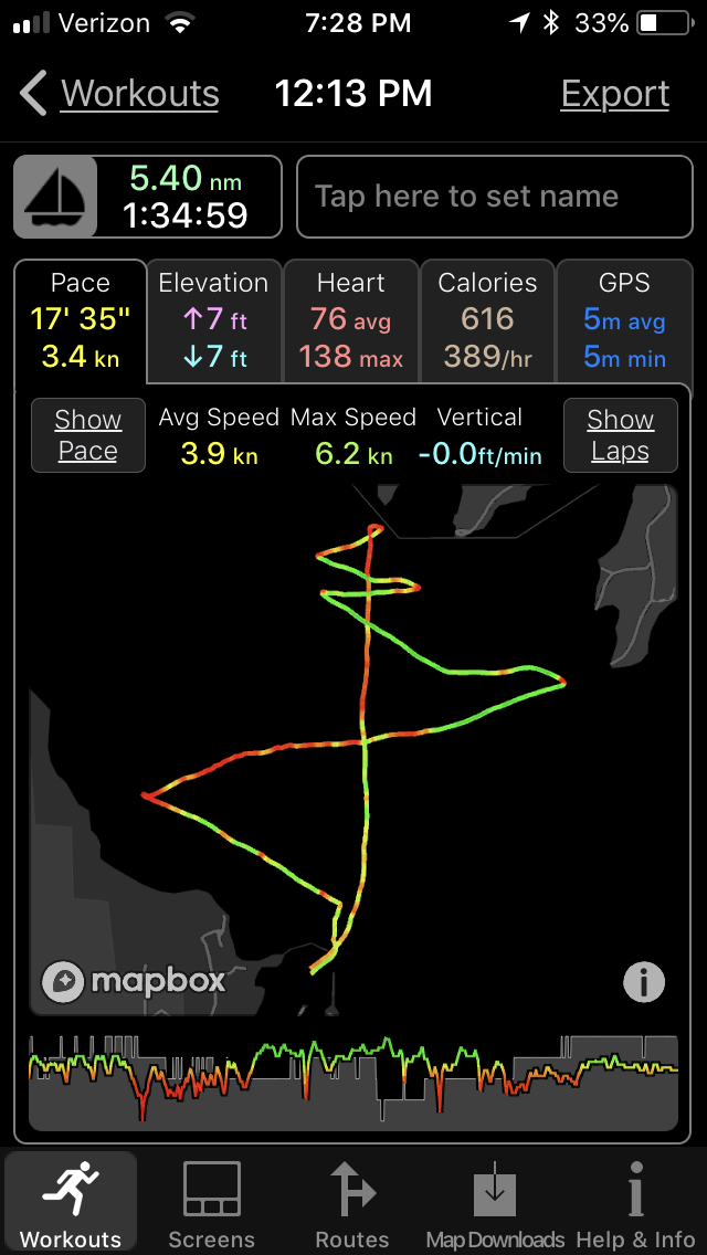

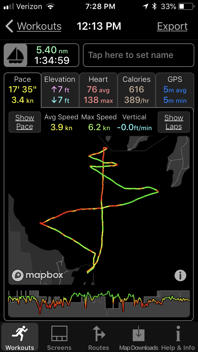

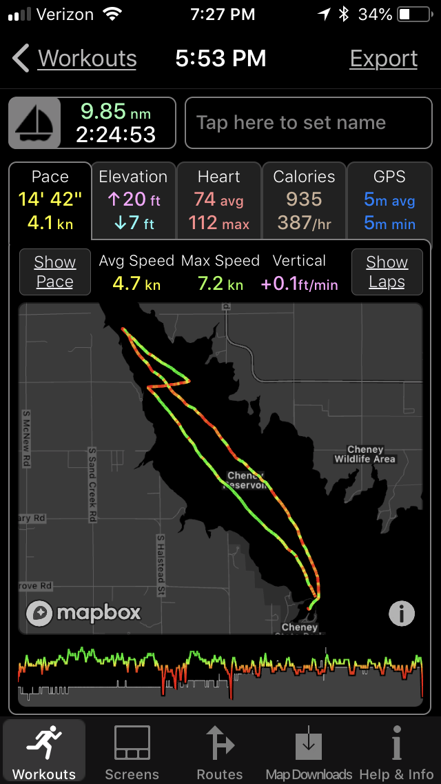

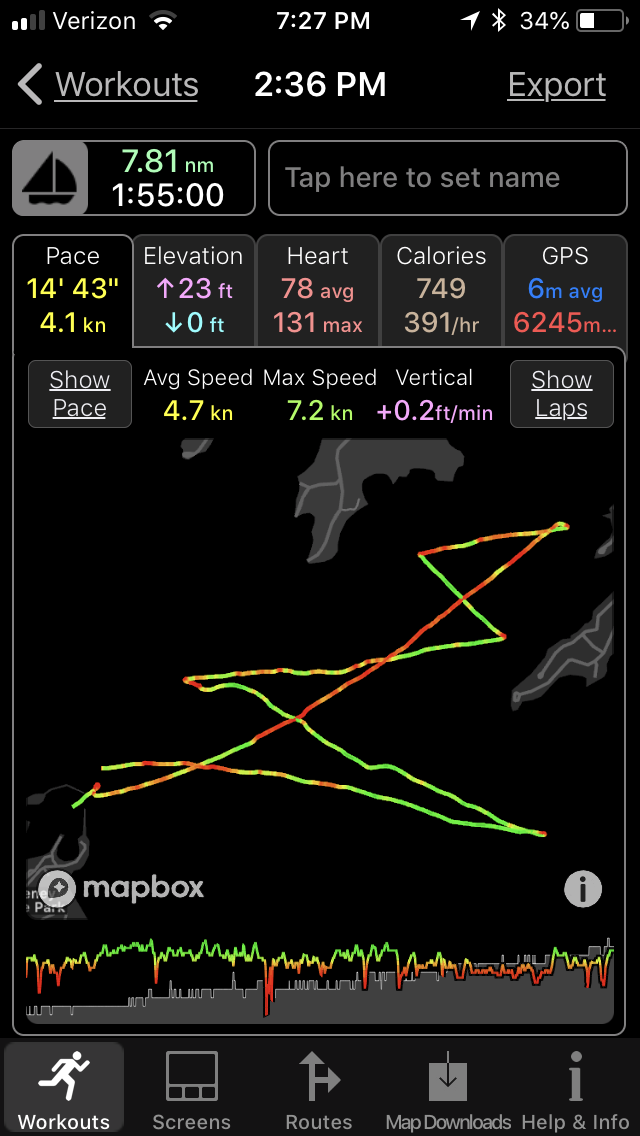

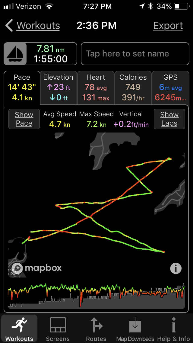

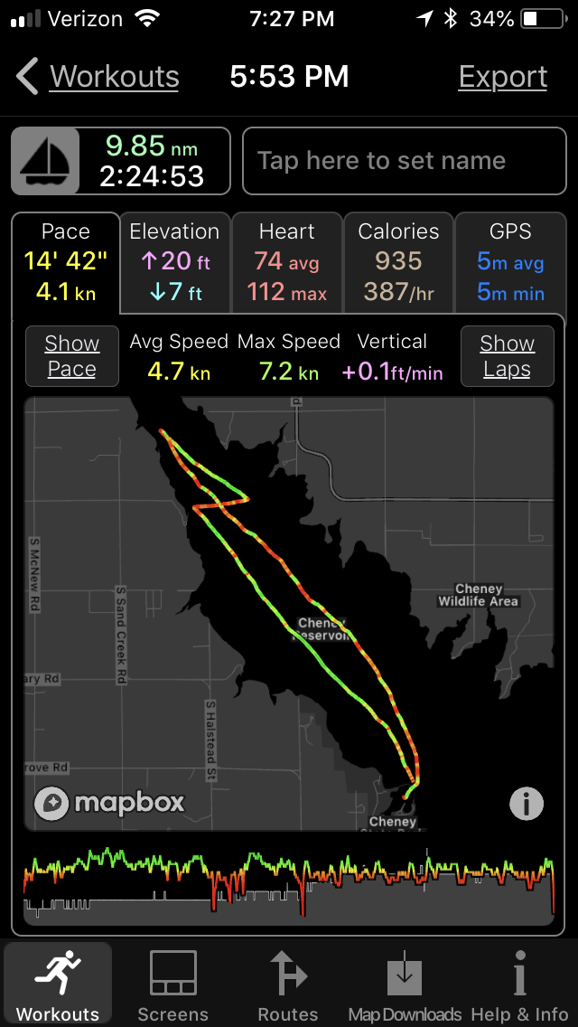

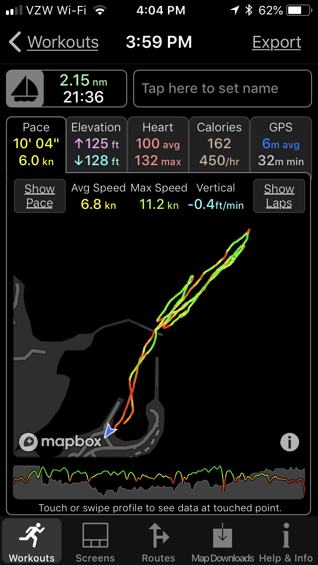

Went sailing today. Did 3 different outings. The app seemed to do well. While I know the lake fairly well, it was nice having the map right at my wrist as we explored the north end. We don't get up there very often.
Looking at my speed, my max was 7.2 knots. I don't think I've ever sailed that fast before on the boat I was on today. I wonder if sudden arm movements could mess with the speed at all?
View attachment 780351 View attachment 780352 View attachment 780353

Glad you like the new features! The maximum speed is based on the current speed provided by Apple from the GPS. This is notoriously difficult for them to calculate given the inherent inaccuracy of GPS, so the maximum can seem a little high at times. For step-based activities such as running or walking the app uses the current speed supplied by the pedometer, which is generally more accurate (but still not perfect).

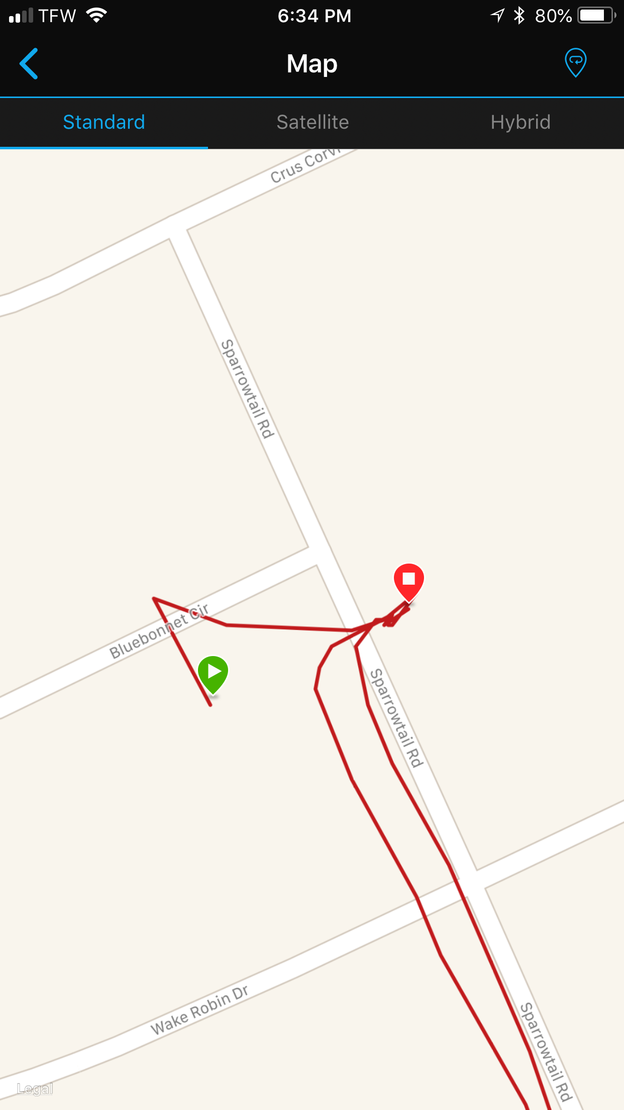

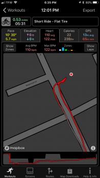

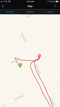

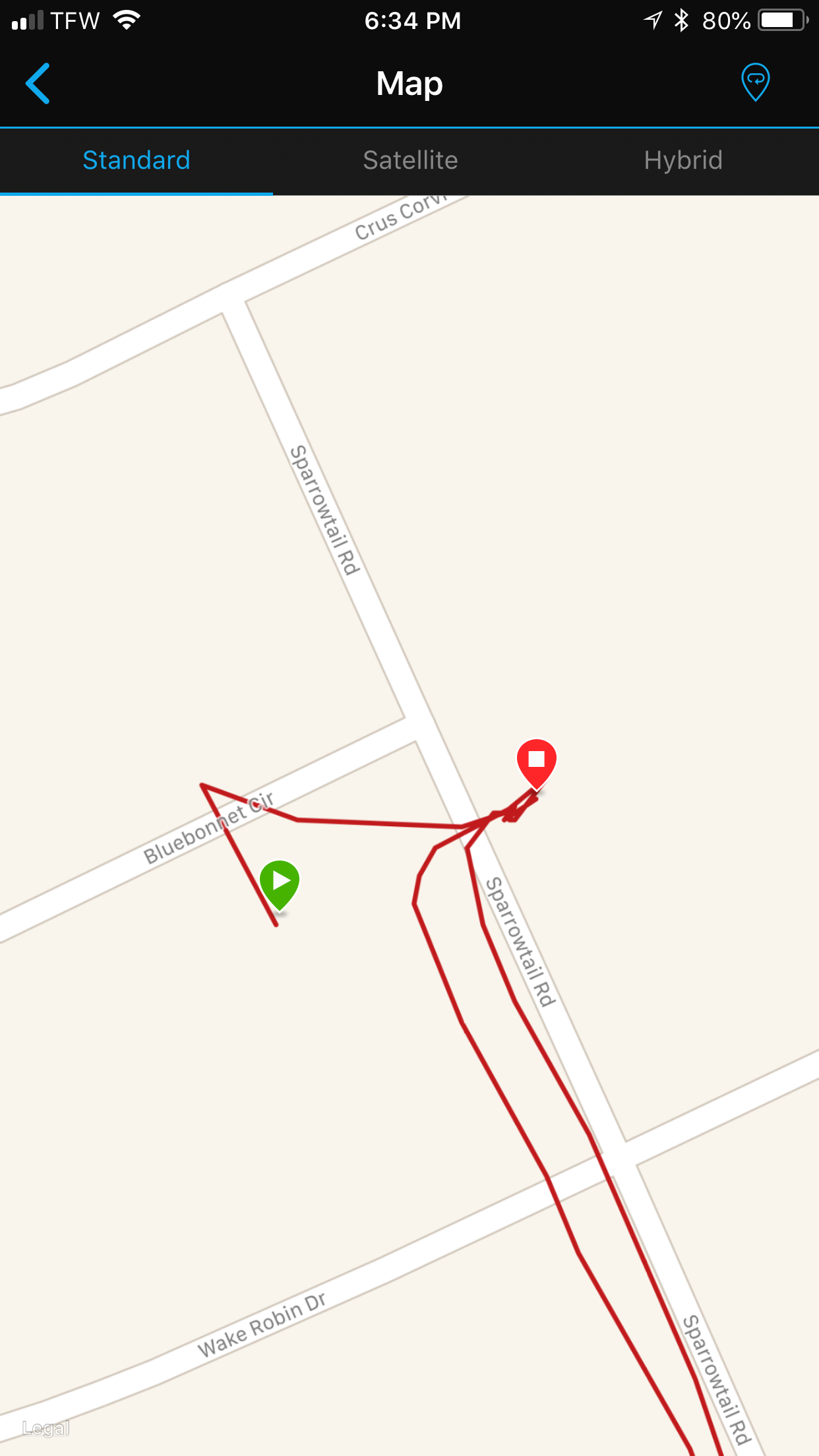

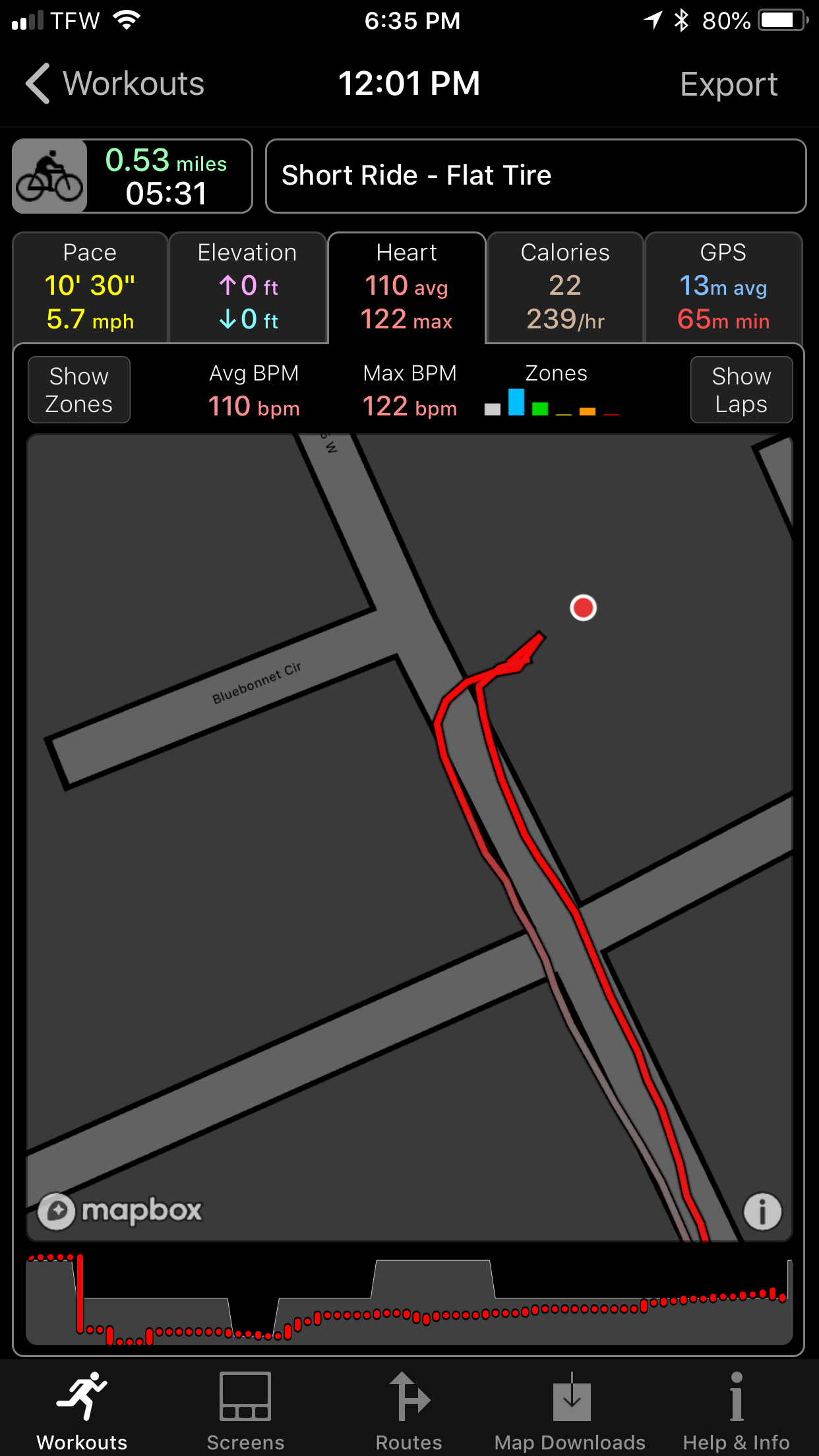

Just discovered something else about the app that I REALLY like. Today, I was going to go for a short bike ride to "test" the GPS, and decided to fire up your app for it, as I like the presentation of all the data. Well, long story short, I discovered my tire was flat 1/4 mile into the ride, so home I came. Now at the beginning/start of the ride, I began the app, and sat on the bike in the driveway, between my car and pickup, waiting for the neighbor to pull out and go down the street.
Track is fine, as good, or better than I expected, but I discovered that apparently there's a bit of "smoothing" of the GPS track that takes place, as you can see between the two screen captures. Where I sat initially, it appears that the GPS "bounced" off the vehicles, and didn't get "on track" until I was going in the street; however in your screen capture, that anolomy is missing. That's a good thing. :) Thanks again for a great app.
Reactions: cfc
Glad you like the GPS smoothing. Each GPS position comes with an indication of how accurate it is, and the app takes that into account when determining the track.
