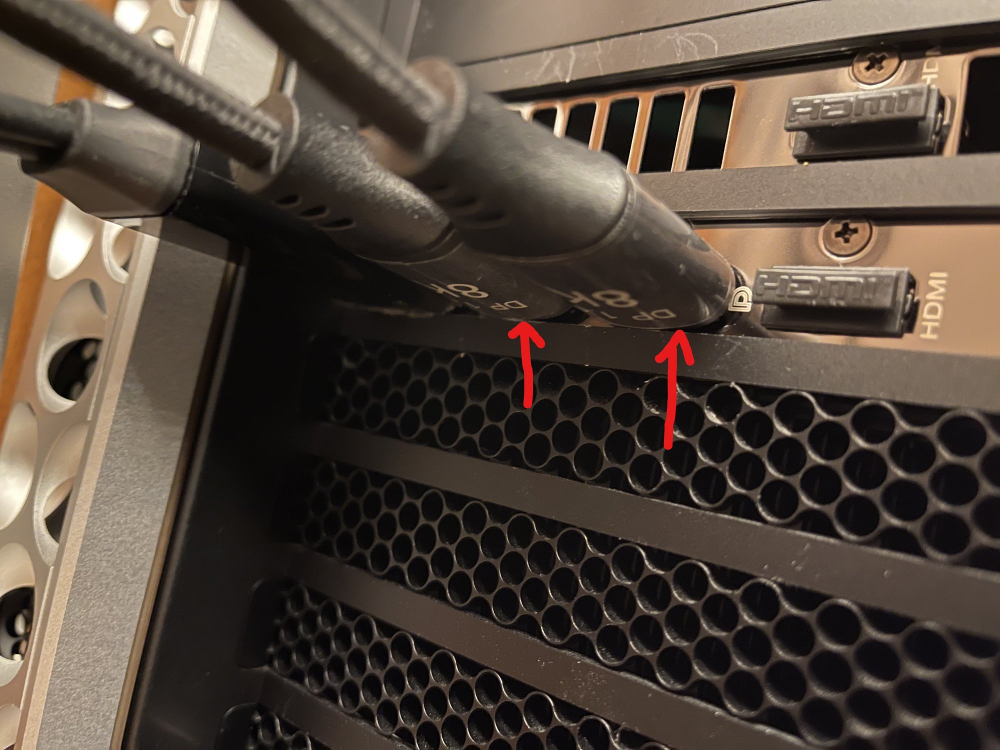

I'm also using the Belkin cable in MacOS Big Sur with an Aorus RX5700XT. Previously used a Monoprice bidirectional cable. I also had to trim trim the DP port to get the thing to work. No boot screen, but everything else works including brightness and it powered the USB ports on my monitor. Why would Belkin build a cable that has to be cut to work? Makes no sense to me.
Lou
I just bought two DisplayPort to MiniDP to connect my other monitors and I had the same problem, so I looked closely to see what's happening. If the cable's plastic casing is too thick, it bumps against the Mac Pro's chassis (the metal part where the PCI covers slide). One of the reasons why this happens is GPU sag. Even when placed in port 3, it sags just a bit, enough to prevent DP cables being fully connected (because they bump into the chassis). I pushed a bit harder and they snapped in.
People had the same problem with the Belkin Charge and Sync cable. Their solution was to shave some of the plastic off. I don't know if it was with the MacPro7,1 though or not.
It seems to me that the MacPro7,1 does have extra thick PCIe cutouts because of the black rear aesthetic?
I remember a similar situation with a two slot PCIe riser that came with an enclosure that fit in a DVD drive bay. My solution there was to file the openings larger to accomodate the USB-C cables because the USB-C ports of the Thunderbolt 3 add-in card were too close to the edge.
https://hardforum.com/threads/use-usb-c-monitor-without-usb-c.1911817/post-1043180044
https://hardforum.com/threads/use-usb-c-monitor-without-usb-c.1911817/post-1043572728

I just bought two DisplayPort to MiniDP to connect my other monitors and I had the same problem, so I looked closely to see what's happening. If the cable's plastic casing is too thick, it bumps against the Mac Pro's chassis (the metal part where the PCI covers slide.
Well I just checked, and you are right. It's not Belkin, It's Apple 13879dunno.gif But, the I have used two previous DP cables on the same card in the same port on my NcMP and they both worked 1387914497.gif

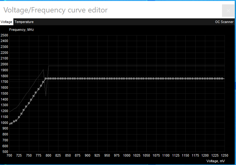

- Underclocked the RTX as shown here:
- Underclocking the RTX made it cooler, with apparently no performance hit. Now the Mac Pro's fan that went to 1600 RPM only went to 1300RPM. The RTX itself was virtually silent (I turned all fans of the Mac Pro to 600 RPM with Macs Fan Control to hear it)

Hi,
This is the voltage/frequency curve I have. I don't know the exact values, but it's similar to the site I previously mentioned.
The card itself is very quiet (if not silent). It's the Mac Pro's fans that make the most noise. Undervolting the 3090 makes the Mac's fans spin much slower. Even then I'm not sure why the Mac Pro's fans ramp up so much, so I used MacsFanControl to see if the system would be stable and silent, and it is. That being said, depending on the game I'm playing and/or that hours I'm playing at, many times I don't use MacsFanControl, because the fan noise is low and easily drowned by a game's sounds.
