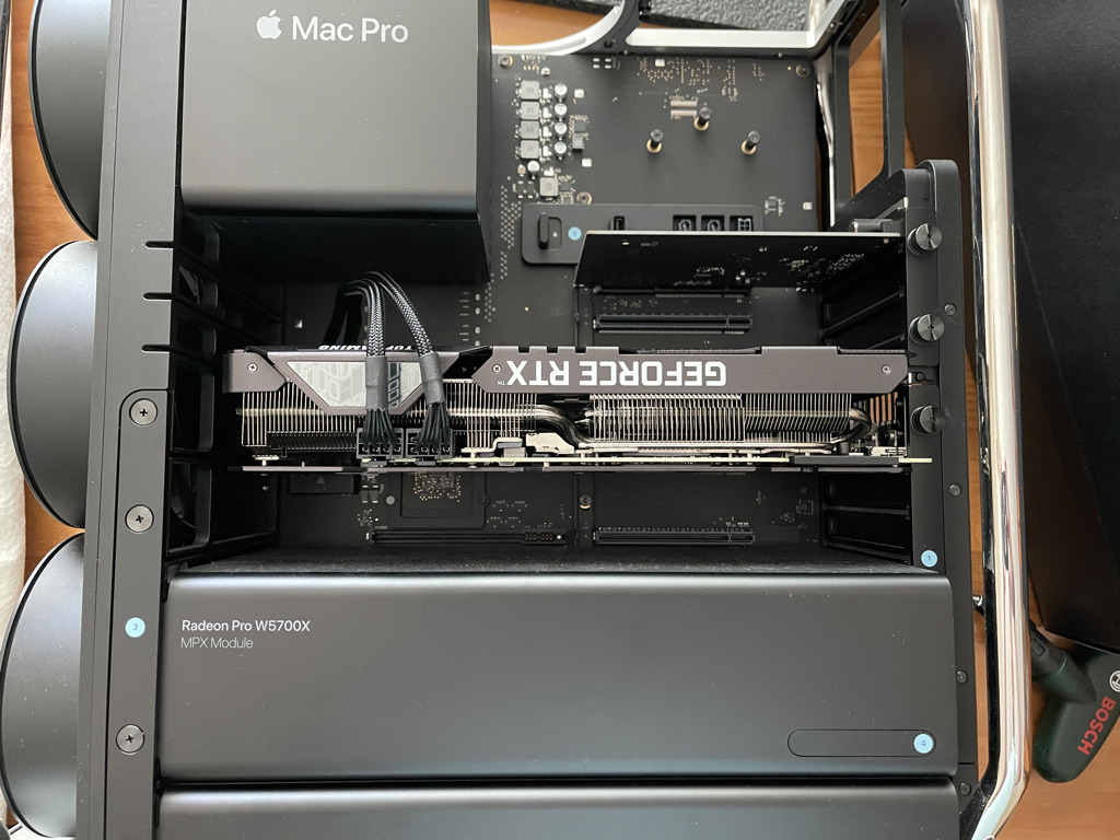

I installed an RTX 3090 in my system, since sometimes I like to game on my PC (mostly FPS that aren't really suitable for consoles, or games that just aren't available on consoles, like Hades) and I didn't want to have another system just for gaming. With Cyberpunk coming out next month, my W5700X wouldn't cut it and Big Navi seems to have some issues with ray tracing.

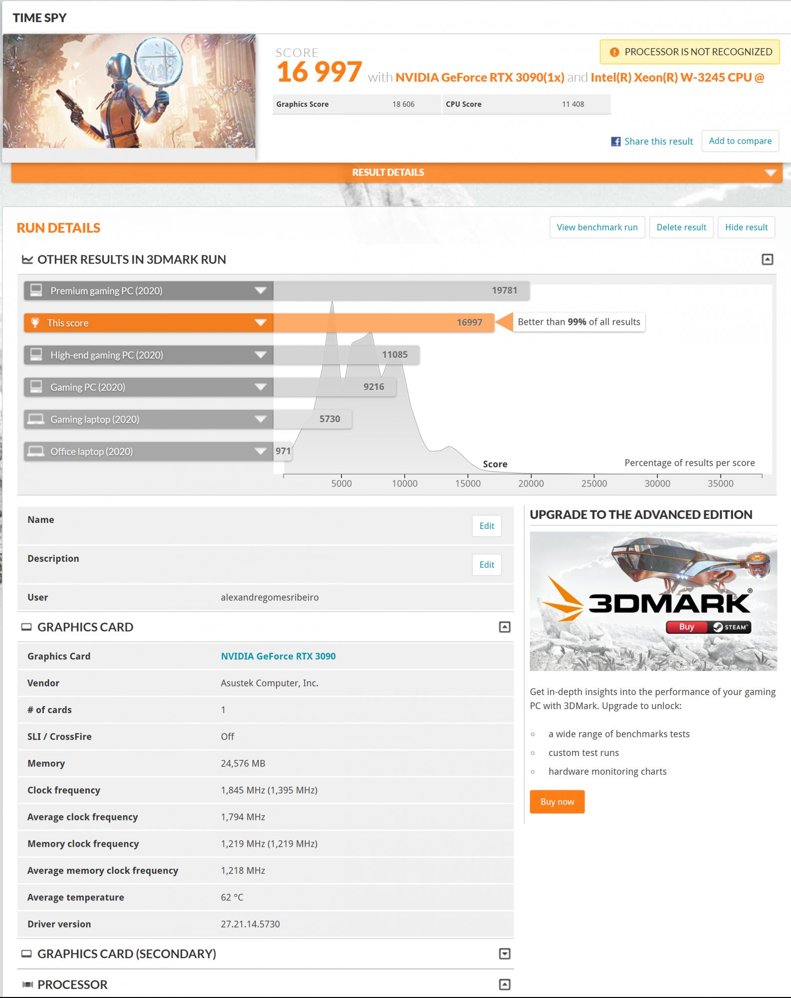

- Ran 3D Mark Time Spy and one of the fans of the Mac Pro ramped to 1600 RPM. It's not overly loud, but for someone that prizes silence like me, it's on the verge of intolerable. The fans of the RTX were around 1200RPM and the card was at around 60 celsius.
- Underclocked the RTX as shown here:
- Underclocking the RTX made it cooler, with apparently no performance hit. Now the Mac Pro's fan that went to 1600 RPM only went to 1300RPM. The RTX itself was virtually silent (I turned all fans of the Mac Pro to 600 RPM with Macs Fan Control to hear it)
- I switched the RTX's BIOS to performance mode, reasoning that if the card itself was cooler, the Mac Pro's fans wouldn't ramp up. I was wrong. The RTX was much cooler, its fans ramped much higher, but so did the Mac Pro's.
- I switched back the RTX's BIOS to quiet mode and I used Macs Fan Control to force all fans to around 600 RPM. Everything was silent. The RTX kept the same temperature and the same fan speed as if the Mac Pro's fans were ramping up. I had no performance hit (the 3D Mark screenshot above was taken with the benchmark running in silence).

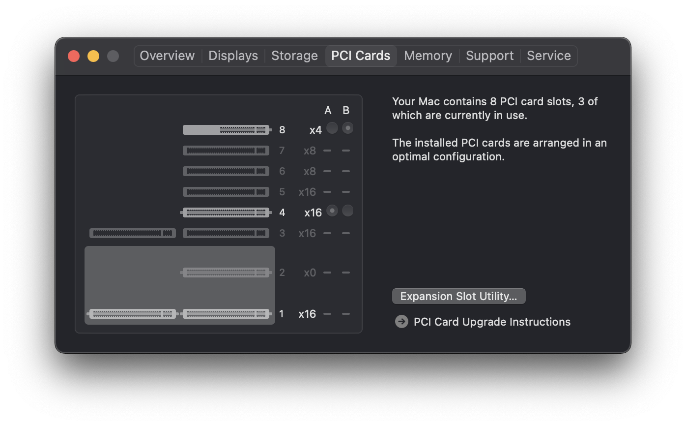

@aagribeiro I personally put it in 3 only becuase I was afraid of sagging as it's a pretty chunky gpu. Have you noticed any sagging at all, or it sits pretty stable in there? If it's stable I'll move mine to 4 to allow for extra airflow as you're saying
This is a very good point. Yes, I noticed sagging, not sure how much. I'll take a look at it today to see if resting it on the W5700X would improve it.
The RTX was sagging significantly (height was 6mm lower at the end of the card). I moved it to slot 3. Temperature and noise is identical.
If it was me, I'd move the RTX to the bottom slot 1. And move the MPX W5700X to slot 3. The MPX module is more structurally secure mounted in a NcMP because of the mounting screws on the left side. This will also allow for more air between the two GPUs. I have remounted my MPX W580X above my RX5700XT for this reason. The 580X is only there to provide a boot screen should I need it.
