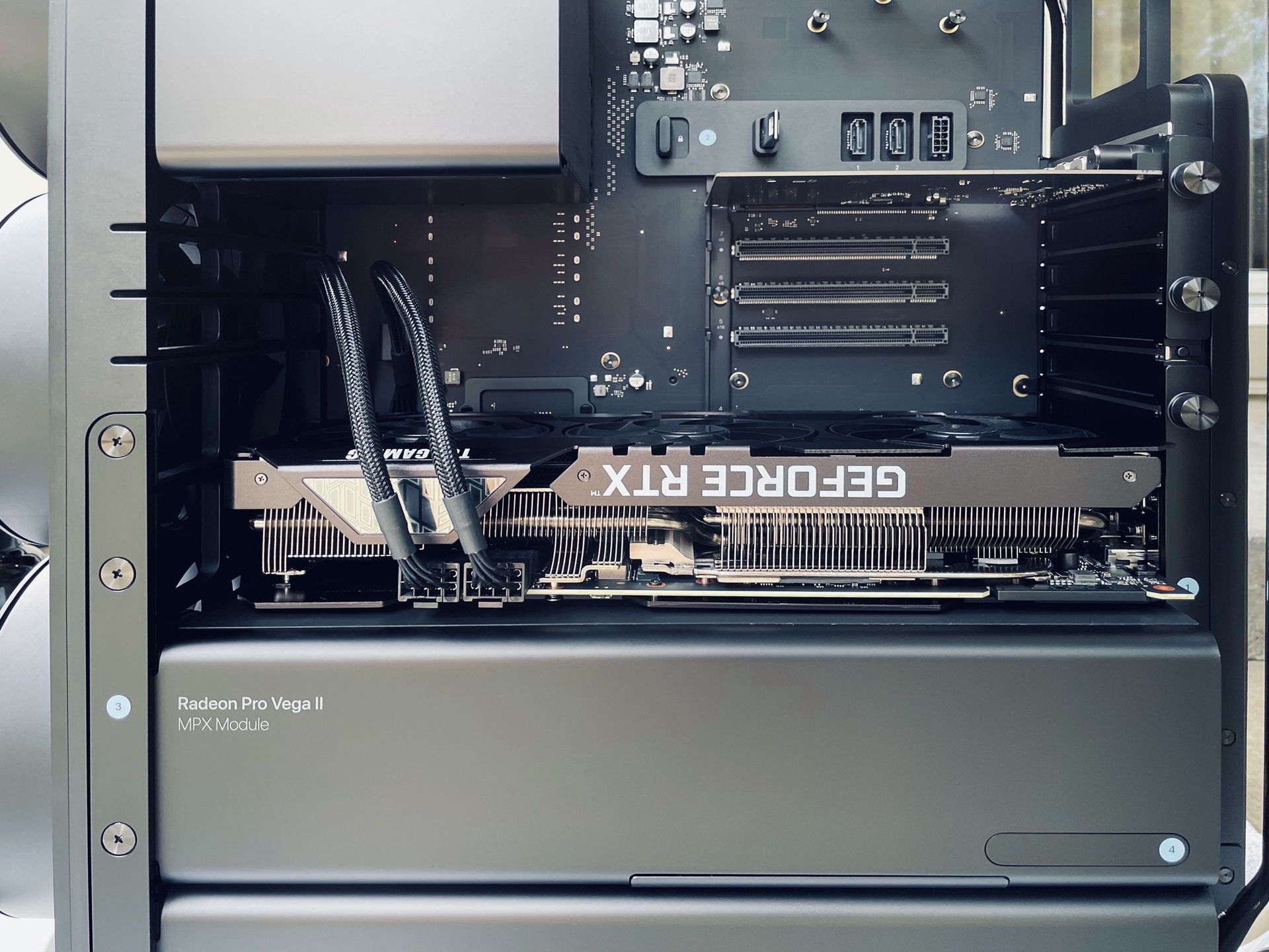

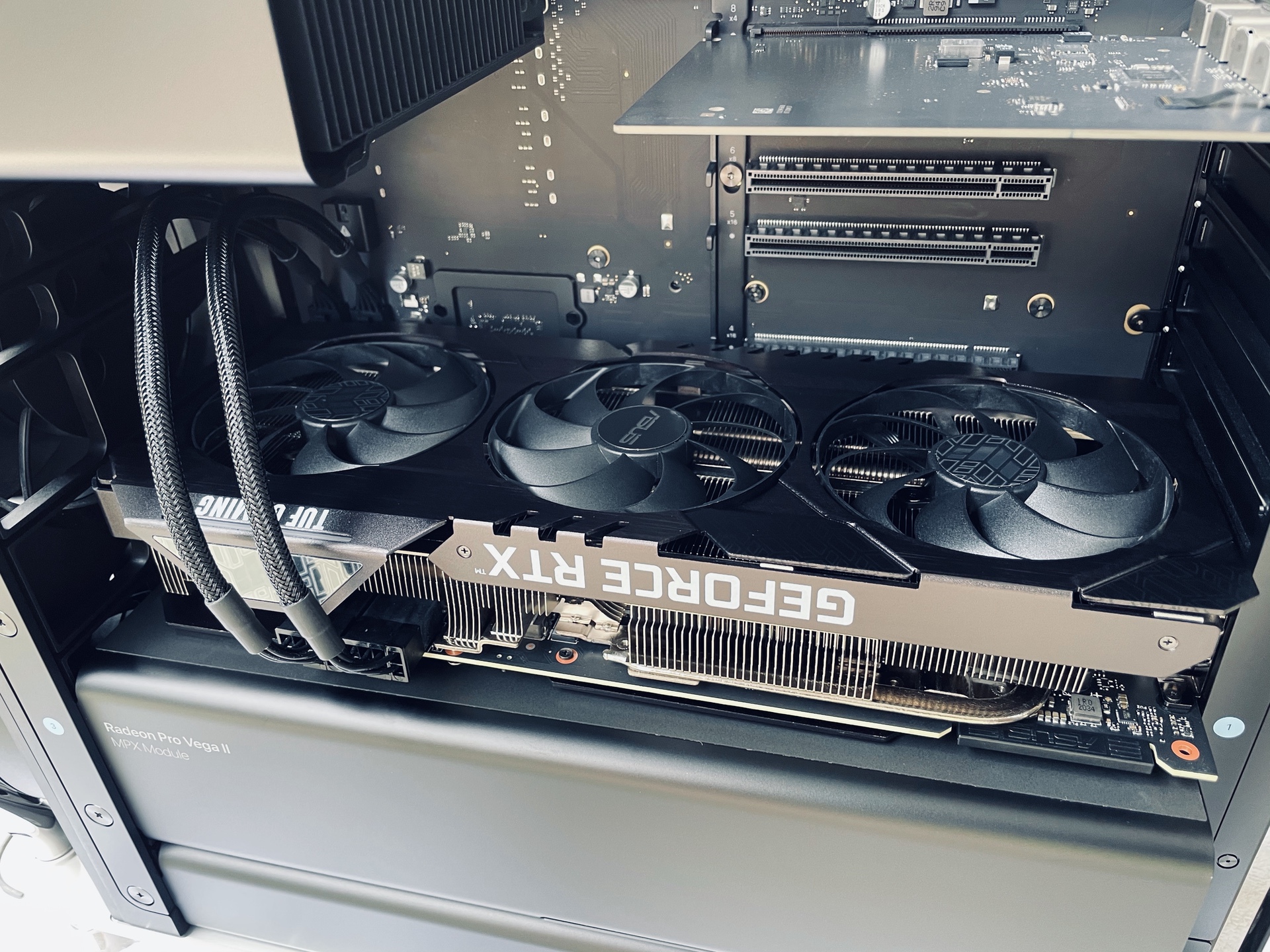

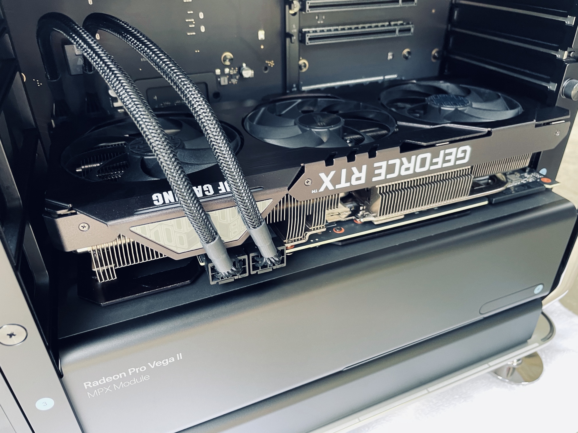

A quick update on my experience so far with the ASUS 2090 TUF OC.
Firstly, it's a nice looking card (as far as PC graphic cards go). Definitely not in the same league as Nvidia's FE, but nice considering it fits beautifully in the case. Really impressed with the build quality. The small RGB light on the card looks like a beating heart inside the Mac Pro, which is kinda cool. I was planning to disable it (if that's possible), but I kinda like it.

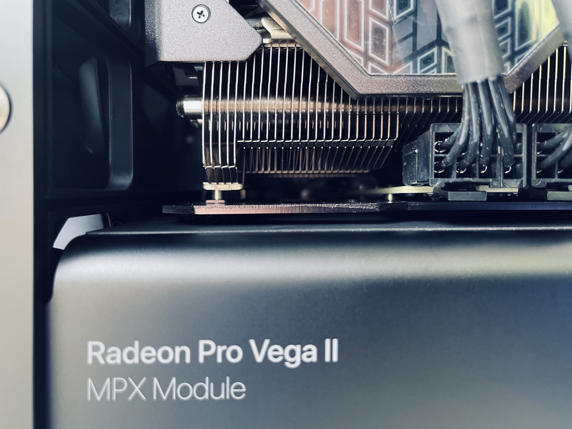

Based on Alex's experience, I opted for Slot 3 - directly above my AMD Radeon Pro Vega II. I chose this slot to avoid the card sag Alex mentioned when installed in Slot 4. This is a pretty heavy card.
Here's the cool part. I added two small spongey sticky circles to the end (at both edges) furthest from the board connector. They were part of a velcro sticky set I purchased a while ago. I used two soft circles. This is to avoid any sag from the card damaging the top of the Radeon card.
As Alex mentioned, there's no real difference in card temperatures between Slot 3 and Slot 4, so I think it makes sense to install the card in Slot 3.

Haha, yeah! It's a neat little hack for sure. You can kinda see it in the close-up shot above the Pro Vega II.

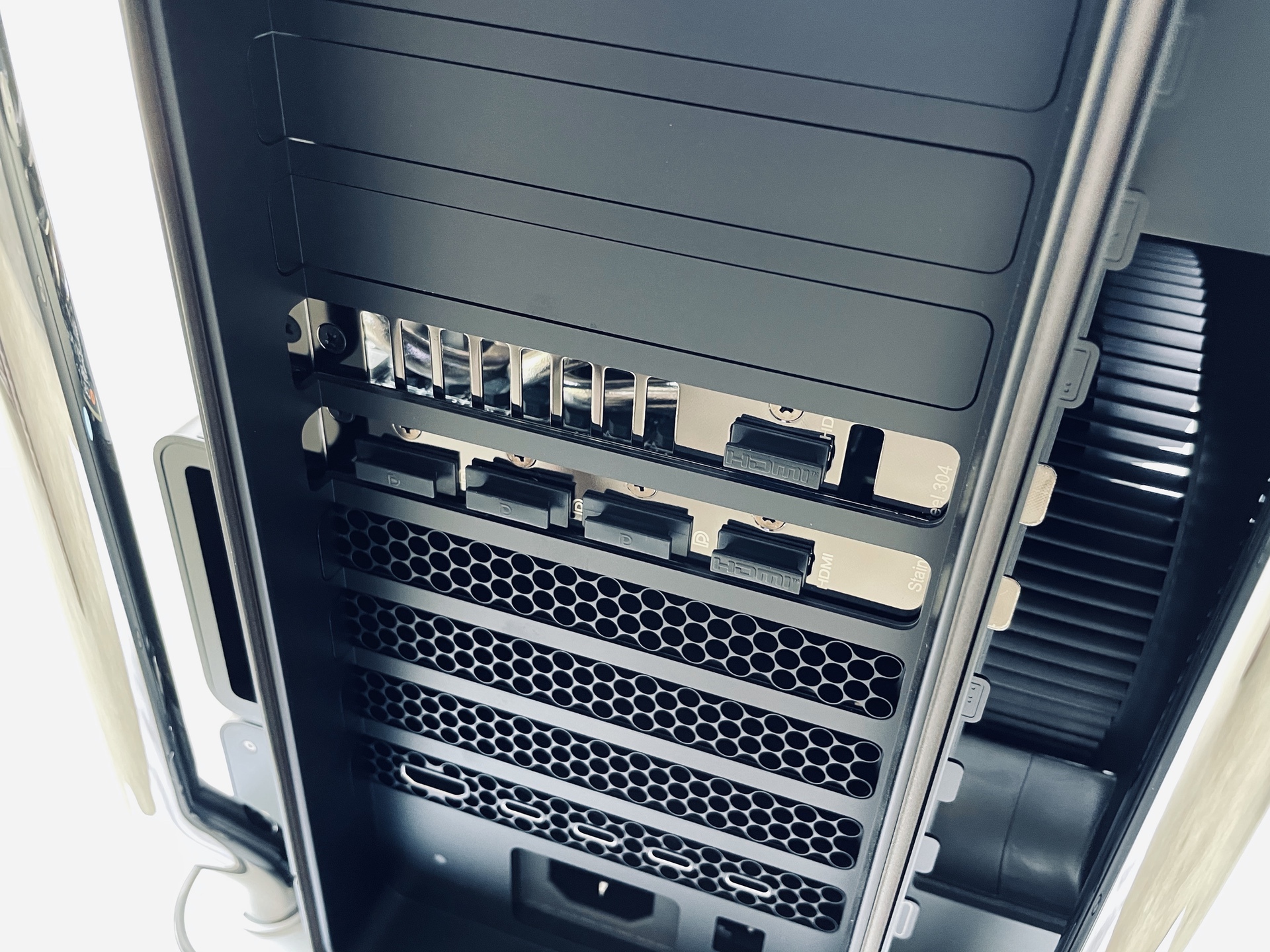

By the way: if someone is interested in running a 3080/3090 with the Display XDR I can recommend this Delock PCIe card. Works like a charm with 6k resolution and full USB support:
https://www.delock.com/produkt/89582/kaufen.html
I also tried the bidirectional AltMode DP <--> USB-C cable from StarTech which works as well, but only without USB support for the Display.
The only thing that's annoying is changing the cables. Has anyone tried these magnetic USB-C cables? That might be an easier way to switch.
