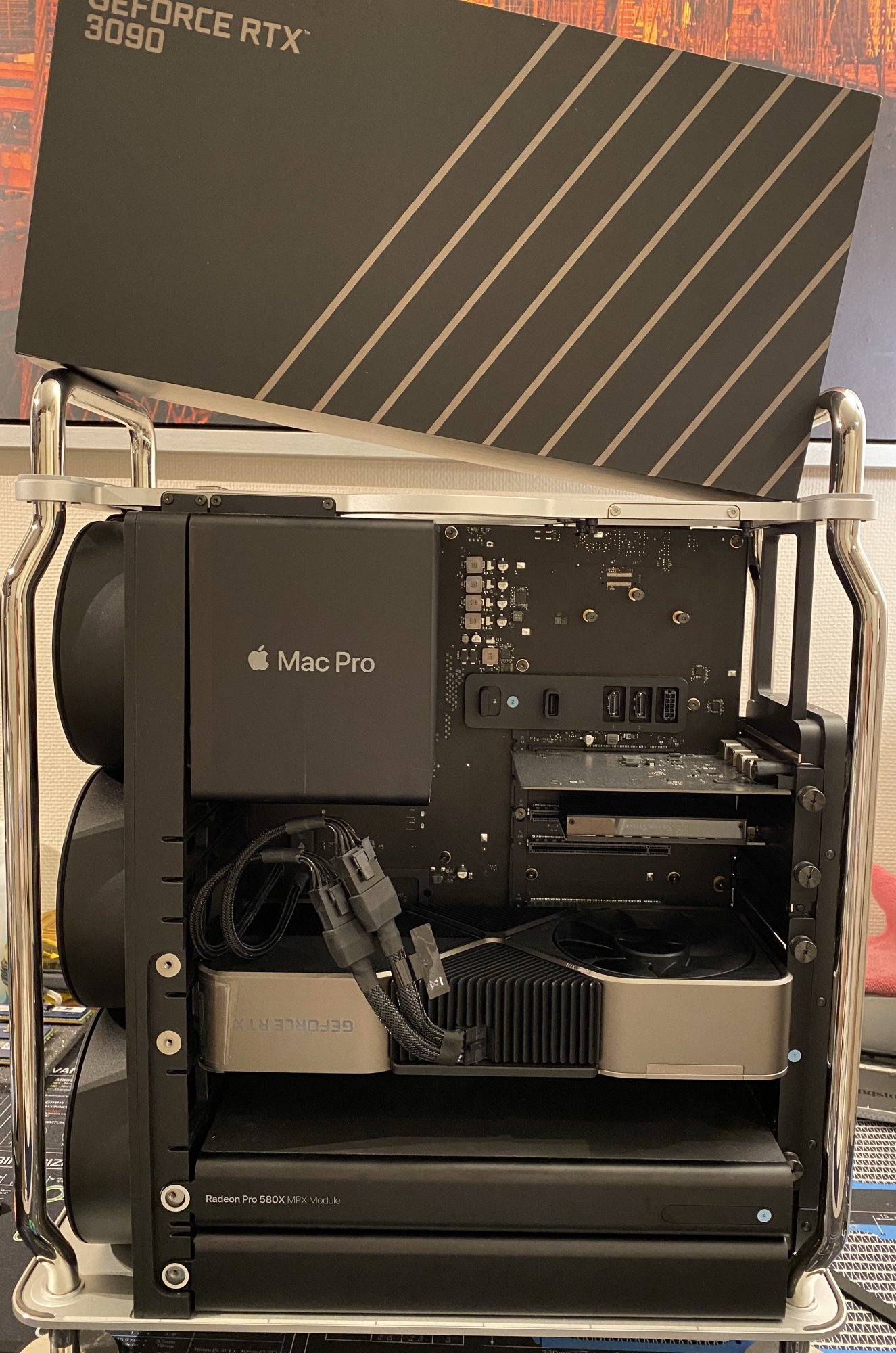

all the bla bla for nothing in the end the RTX3090FE does fit just fine, * without Cutting the FAN Bezel Plastic *
if you read my Post on site 1 or 2, i made clear that if the Sapphire 5700XT Nitro Fits in the Macpro , so will the
3090FE. but even better at the end of the Day without cutting nothing.
STEP 1.Open MacPro Case , take out x 3 slot plates , Remove the PCI SLOT Holder on both Sides.
STEP 2.Put the Mac Pro on a Table so you can work from above.
STEP 3. Take the 3090FE an apply some 3m Clear Transparent Plastic tape to the Back so the Cooler Body doesn´t get scratched when you Put it in.
STEP 4. Bend the Fan Bezel Plastic with your hands dont use to much force it will bent the 3mm needed just so yo can Plug the GPU in its PCI slot .
STEP 5. Leave the LEFT PCI Holder out of the Case.
After 7 Hours of Benchmarks, Gaming Test on Win10 i can says this GPU is fantastic, and Super Silent under FULL LOAD.
I Overclocked the CARD to 400WATT > CHIP + 124mhz >GDDR6x RAM to 600MHz and Power Limit MAX +14%.
both Fans on AUTO.
Full Load TEMP are around >65 to 68 Celsius and this is awesome. compared to RTX2080ti FE
Full Load TEMP of the litle XEON CPU is max 42 celsius )
In Mac OSX the Card behaves Slient and idle is 29 Celsius, Sleep works just Fine.
My Bootcamp Boottime is very Fast compared to the RTX2080Ti , after Power On it takes just 9 Seconds to Boot up Win 10 (Build 2004).
I use a LG OLED C9 2019 Display for Windows.
HDMI 2.1 Setting in Nvidia System Panel to PC Input 4k@120Hz 4.4.4 FULL , with Gsynch OFF ( for now have to wait for LG New Firmware )
Take a look at my Fotos and have fun Trying to get a 3090FE.

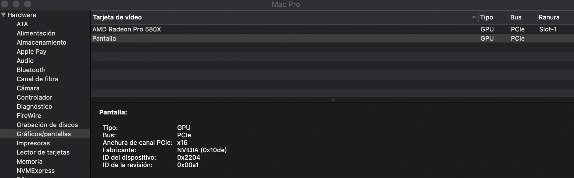

I have the 580X and the new ASUS RTX3090, but 1 week after trying everything you have indicated, I still can't use the 3090 on macos, Catalina or Big Sur. The only way is to boot the system, select the unit with windows and perfect, but I have not achieved anything by following your steps, the 3090 continues without being able to use it in macos. Is there any user who has a new idea that can help us who have this problem.
I have it installed in PCI 4, before in 3, nothing changes, it is a shame not to be able to enjoy it. Thank you very much and you are all great.

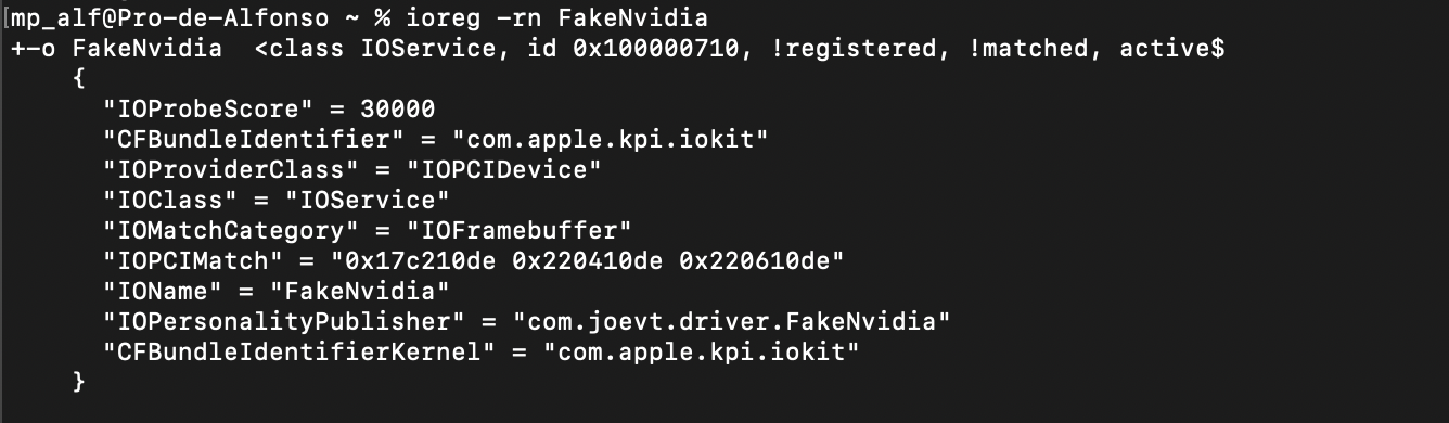

I start in recovery mode csrutil disable
reboot and start normally and now, all your ideas,....
No chance with (from frankiee)
First, copy the kext to "/Library/Extensions", then issue the following terminal commands:
next
udo chmod -R 755 /Library/Extensions/FakeNvidia.kext
sudo chown -R root:wheel /Library/Extensions/FakeNvidia.kext
sudo touch /Library/Extensions
sudo kextcache -update-volume /
or this method (joevt and your kektUil.sh and fakenvidia.kekt)
source ~/Downloads/KextUtil.sh
installkext FakeNvidia.kext
rebuildkextcache
Finally
and the kekt its not loaded and finally sad...and thanks for all your effort.
And don't forget to boot into recovery mode and csrutil enable
And now i have 580 connected by hdmi (for macOS) and the 3090 by DP (for windows).
My monitor is the BenQ EW3270U, just in the case..

FakeNvidia.kext was not created to make Nvidia work. It was created so that sleep/wake doesn't cause a kernel panic while an Nvidia card is installed.
Thanks, but the panic when sleep/wake continue for me with in my case..
I finally opened up and installed RTX3090 Founders Edition on my Mac Pro 7,1. It was hard to put it in as you do need to push the backside's plastic bracket where the 3 fans are. Once it's pushed then you also need to align your card properly beforehand so the slot can be fit in as the GPU slides down. Due to the bracket flexing a little, you will not be able to screw either the back cover or the front cover. I just left them as-is but it works fine.
Overall, I haven't played it on Mac OS yet but at least on Boot Camp Windows 10 it works flawlessly and sleeps perfectly fine (I bought a Gigabyte GTX1050Ti before and when I put it to sleep on Windows 10 the fan will blow furiously).
Just FYI, if you're worried about the plastic fan bracket, it is a one-piece item and that also has some sort of circuitry on 3 sides, meaning it's connected to Mac Pro without wires (just like other Mac Pro parts). Unfortunately, you cannot buy just that part yet so you would probably need to wait until 3rd party starts selling official Mac Pro parts.
