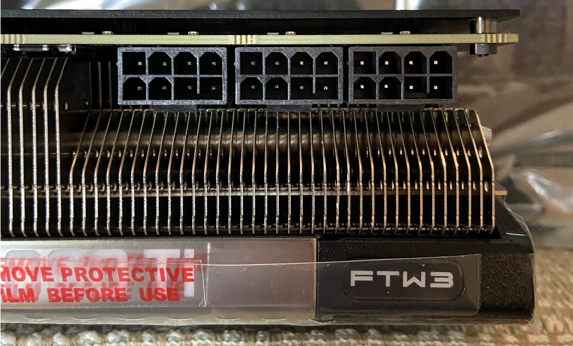

I have not updated to the Monterey beta, but my new challenge is filling these 3 power aux ports from the MacPro7,1...??? I'm getting the feeling this card ain't gonna work in a 2019 :mad:
