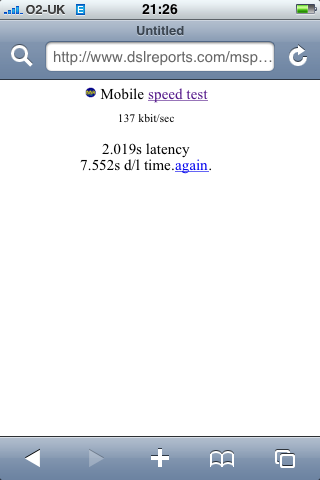

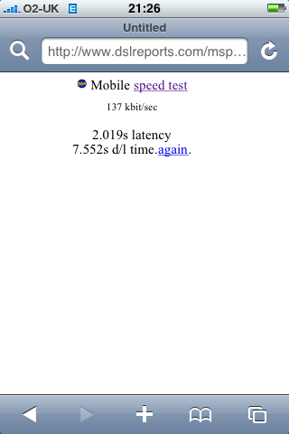

Seems like EDGE to me, I guess O2 must have enabled it for PAYG now! :) The speed test was a 100KB sample.
