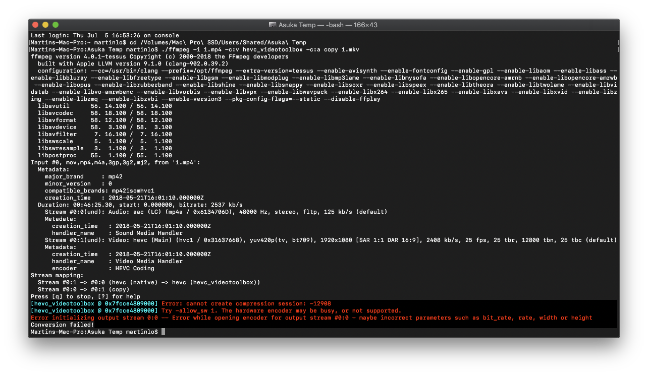

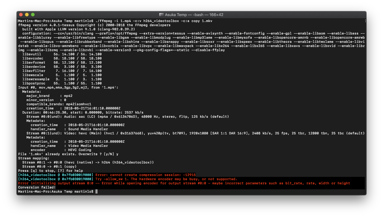

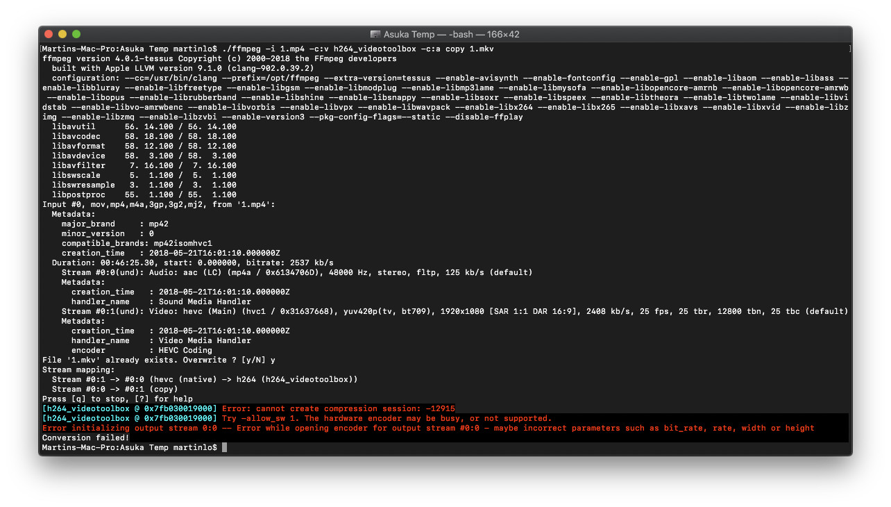

Could you time the encoding process when using the gpu vs cpu?
It could also be checked by using the free ffmpeg from here:
https://evermeet.cx/ffmpeg/ffmpeg-4.0.1.dmg
Once downloaded and copied to any directory, run
./ffmpeg -i "file you want to convert" -c:v hevc_videotoolbox -c:a copy "output name of file".mp4.
This will throw an error if it doesn't find hardware encode support.

Thanks for providing the detailed procedure, will test that and report back later.
Update 1:
Both H264 and H265 hardware encoding are NOT working yet.
Update 1:

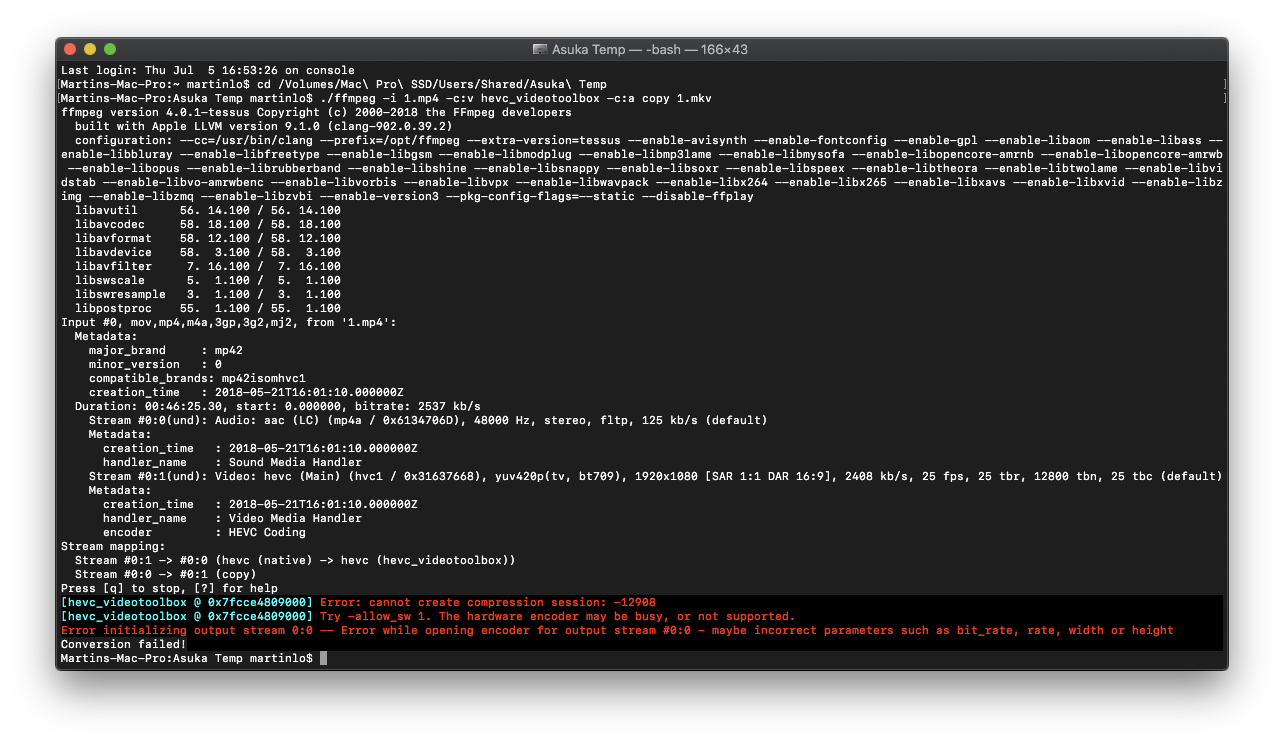

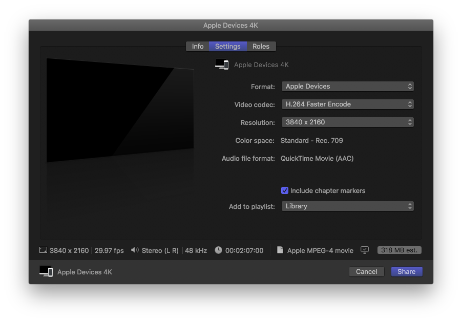

View attachment 769116 View attachment 769117
Many thanks for trying this.
I'm in two minds now. Part of me thinks encode is coming: partly due to the fact that decode is already there, and partly because Quicktime player is failing to encode. The other part of me wonders if Apple will leave it at decode only, so as not to undermine their other, newer machines.
I think the plan is to add dcode/ encode for external gpus as such we should get decode and encode. I’d be pissed if apple didnt add encode support.
