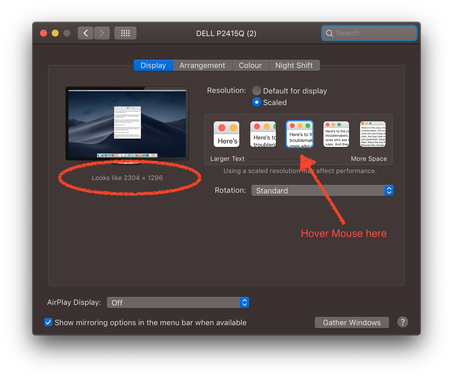

Default for monitor, which for the Samsung display, was automatically putting it at the 'Larger Text' setting, equivalent to 1080p.
Are you sure? At 4K I see "Larger text" is an under-scaled resolution (1504x846), the 1080p setting is one to the right of that.
I'd check that - I see some lag in responsiveness if not using the 'default' (looks like 1080p) with two 4K's, but no lag at all when they're both set to 1080p.
I just checked gain to make sure, on the Samsung 4K I have the default resolution is 'larger text', which is listed as 1920 x 1080. It's the setting on the extreme left.
The setting to the right of that 2560 x 1440.
I'm almost getting the sense from this thread that settings seem different for different people, some are having no issues with 4K or even 2x 4K monitors, while others are having slow downs with one 4K monitor, despite loads of RAM. It's almost worth compiling a list of monitors that are functioning great. Sure would help with not having to keep trialing and returning via Amazon.

I'd guess that the listed resolutions in the 'simple' chooser adapt based on the physical size of the display.

Ok, well the first thing to test, would be trying your iMac's built-in 4K display at a "scaled" resolution. The "2304x1296" I mentioned earlier is 120% of the "native" retina for my 4K's, so to simulate the same amount of "scaling" on your iMac you'd need to set it to something like 2457x1382 - it's possible that exact figure isn't a provided option but there should be something close. Look in System Preferences > Displays > click "Scaled" and see what each entry says under the little simulated display (on the left) when you over over it. I've attached a screenshot to demonstrate where it shows this info.
Thanks -- that's very helpful. So you're saying that my dGPU will help with the scaling and thus avoid some of the issues that the Mac Mini crowd are having? Perfect. I'll see if I can pick up a Dell cheaply somewhere.

Unless. you're happy with either 1:1 ratio (i.e. the native 4K resolution, so stuff is tiny on screen) or "looks like 1080p", you're going to have lag without an eGPU.
The mini can drive multiple 4K displays in the default scaling mode ("looks like 1080p") because it's an "efficient" straight 1:2 (aka @2x) rendering. If you want to use e.g. "looks like 1440p" (which is what the iMac 5K defaults to, i believe?) that's going to be too much on two screens for the iGPU, and no amount of memory helps (I have 64GB and can't set my 2 24" 4Ks above "lools like 1080p" without some issues. The higher the "looks like" resolution, the worse the issues are.

4k on 27" means lower PPI, and IMO it means it's impractical to use the "default" scaling in macOS.
