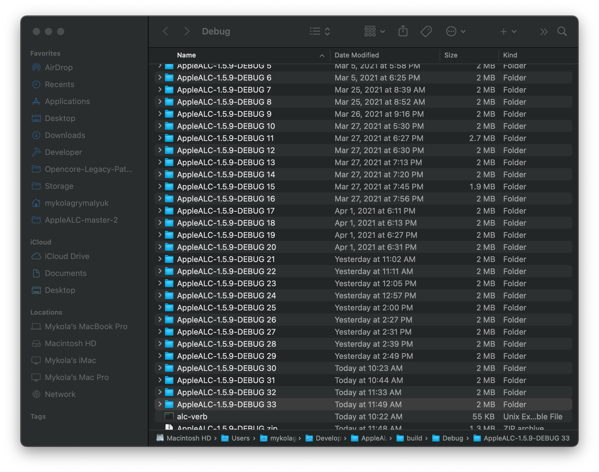

Oclp 0.0.22 installed 20D80 and "ota" updated to 20D91 (2.44GB update) with onboard audio working. Big thanks to everyone involved.
Saw that they finally cracked this.

This is very good news, Dayo! I look forward to these fixes rolled into the next iteration of ConfigFactory. Would you know if this is to be implemented in OC v0.6.9?
using the AppleALC 1.5.9 combined with OC 0.6.9, latest lilu and weg but still got no sound.
calling alcid=x but neither one of the 1,12 or 15 layouts function.
