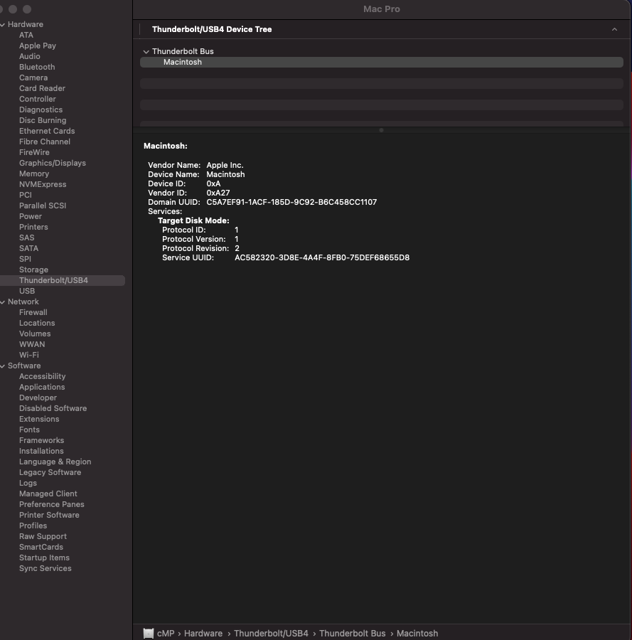

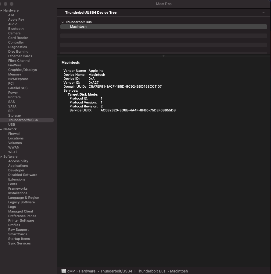

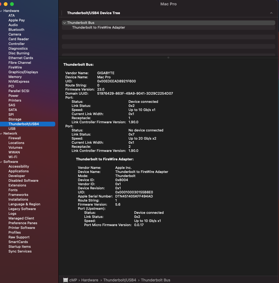

I have been using OCLP 0.2.2 from dortania to run a cMP 3,1 (see signature) on both Big Sur and Monterey successfully. I just added an eeprom flashed Titan-Ridge Ver 2 TB3 AIC to the cMP3,1 and although it shows up correctly in System Information-Hardware-PCI and Thunderbolt/USB4 for both TB and USB 3.1 with loaded drivers, and I can also see it in IOReg PCI (see attached files) Thunderbolt and USB disks, as well as TB-to-Ethernet adapters, etc. don't mount/setup correctly. It seems I need to create a SSDT file and edited config.plist to add this functionality. I have such files from a cMP5,1 installation that are said to work for the Titan-Ridge but they clearly they need mods for the 3,1. I've tried several times using using Open Core Configurator to make the mods but just end with a frozen boot each time!
Is there someone here familiar with how to mod either the existing booting config.plist or the 5,1 version and creating the correct SSDT for installing in the EFI folder generated by OCLP?
I'll attach the booting config.plist now working on the 3,1 as well as a copy of the above-mentioned EFI folder for the cMP5,1 said to add support for the Titan-Ridge Ver 2 TB3 AIC, and the IOReg file generated from the 3,1 booting with non-functional Titan-Ridge card.
Thank you for any advice and help you can offer. I'm not asking for someone to fix it but rather to teach me how to fix it.

Thanks Inspector42. I used those German sites to do the original flash of the eeprom on the card. The card is seen correctly in the IOReg Device Tree and if I connect another Mac in target mode using Thunderbolt cable it sees the Mac (see screenshot) but not the SSD which does not mount on the cMP3,1 as an external disk. Similarly, if I connect a Thunderbolt-to-Ethernet adapter or a Thunderbolt to Firewire adapter, it shows up in System Reports-Hardware under Thunderbolt/USB4 but the adapter cannot be set up in Sys Pref. I am fairly sure the issue is to do with PCI ports and requires an SSDT file in ACPI and a modification to the open core config.plist in the OC folder in the EFI folder created by OCLP. Last screenshot shows Mac connected in Target mode but Mac SSD does not show in list or on cMP desktop.
The problem is I don't know how to make the modification.
It has been a while that I looked into DSDT/SSDT and I am far from being savvy in the iASL language that they are built of.
It is my understanding that most SSDT modifications started by comparing the ACPI file from the Mac with those of a recent UEFI PC.
There is a repository for the ACPI files extracted from basically every Mac Model but I can’t find the link anymore. If you could get the ACPI files from one of the systems I linked before it might give you an idea what is missing. As the devices show up in the registry and even have drivers attached to it, it likely goes beyond just adding the device or enabling it through a SSDT.
Let’s hope someone with more ACPI knowledge can chime in here.

Also when I open the SSDT-TBOLT3.aml file with the Maciasl tool and immediately try to save it without making changes, I get compiler errors! Does this suggest that the file is corrupt or that the tool corrupts the aml on opening?
Udpating MaciASL from Ver 1.4 to 1.6.1 solved this problem, but still no cigar; I tried recompiling the SSDT for the cMP5,1 using the IOReg Thunderbolt output for the cMP3,1 — there were no compile errors and the cMP still boots but no change in the TB hardware status. All devices (Target-mode MBA, TB to Ethernet and TB to FW adapters) connected to the TB3 ports are seen in System Information – Hardware, but are not functional.
Driving me nuts; has nobody got a working OC folder for the EFI folder for this card in the cMP3,1?

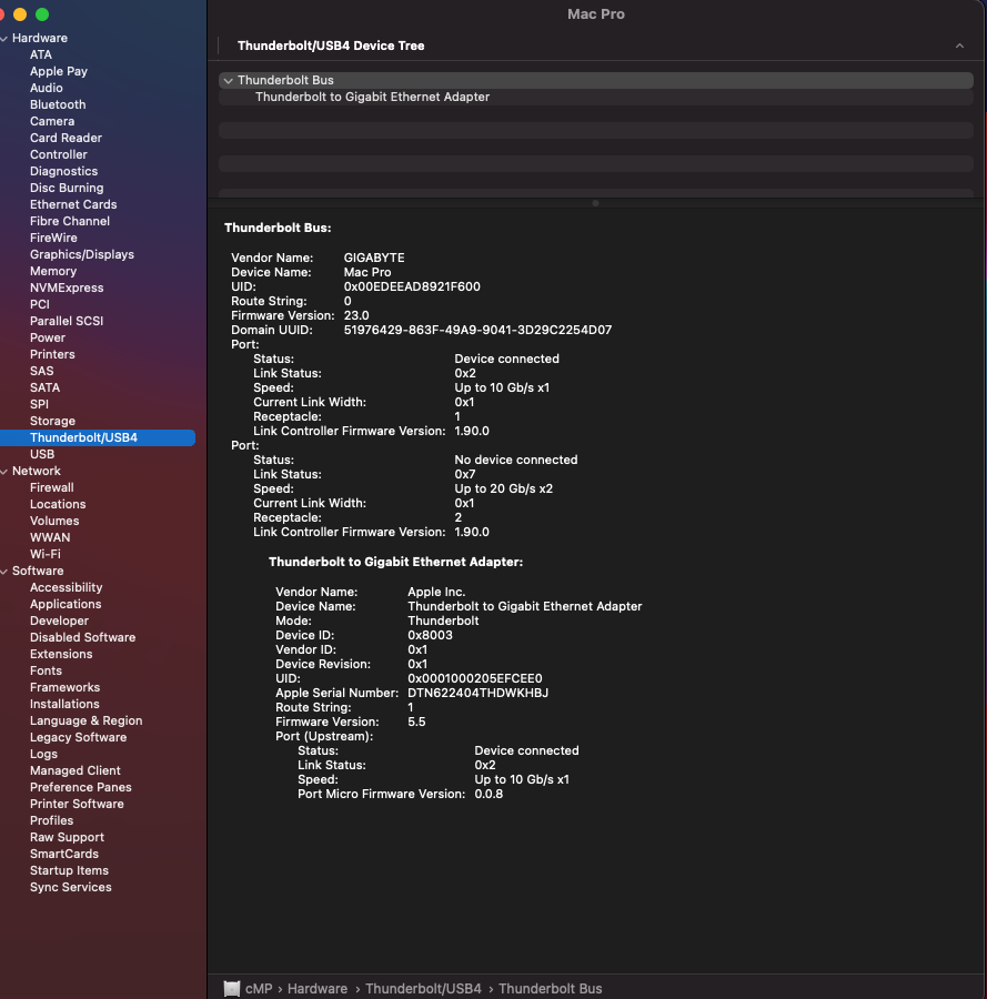

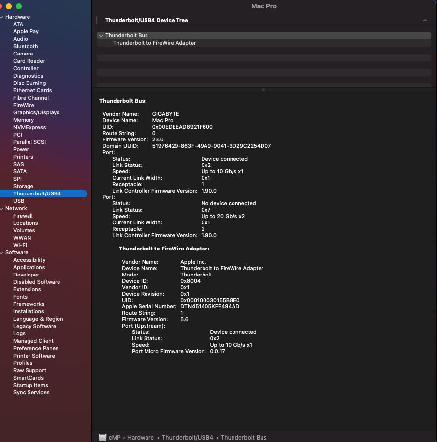

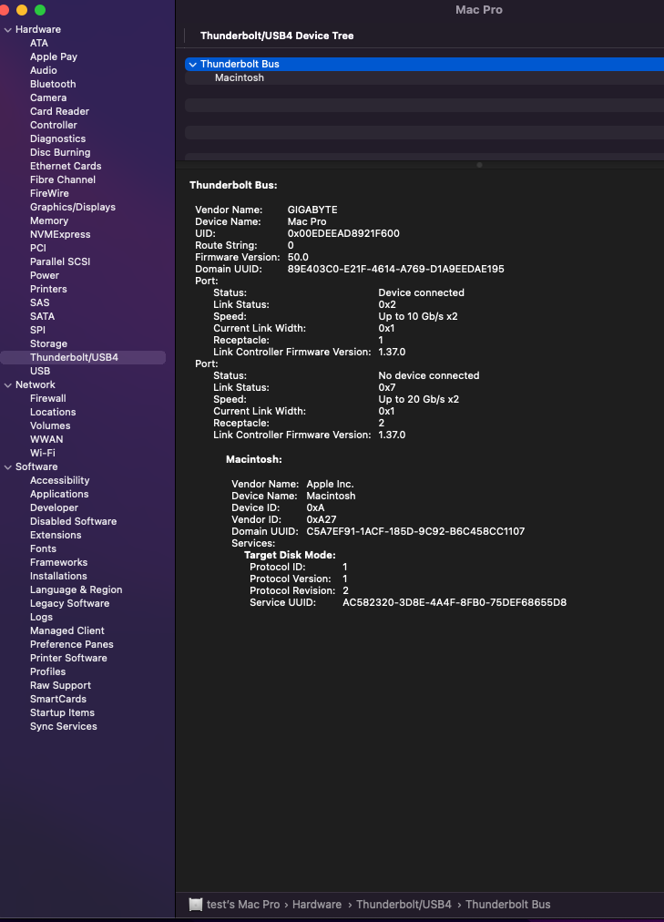

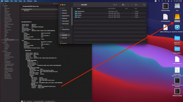

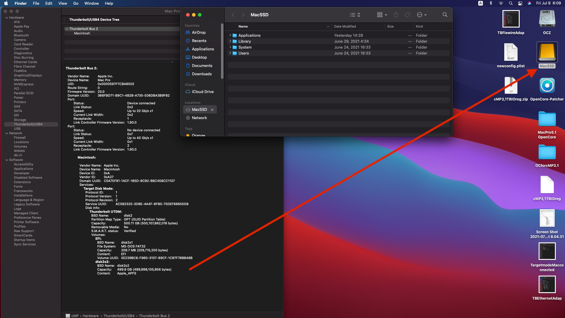

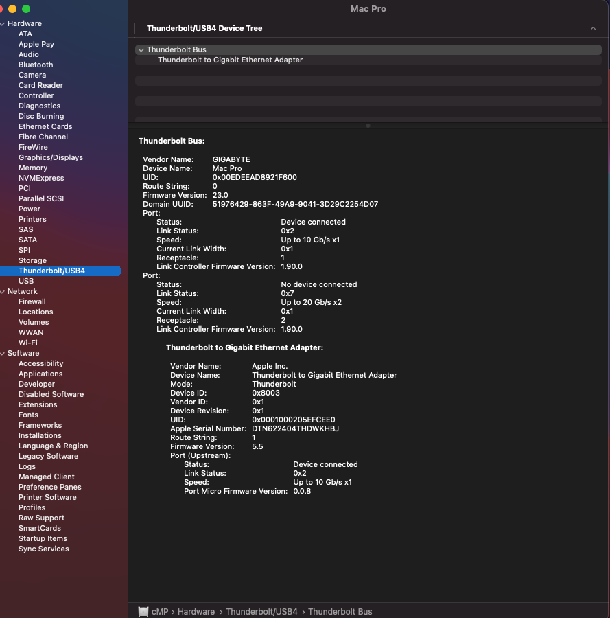

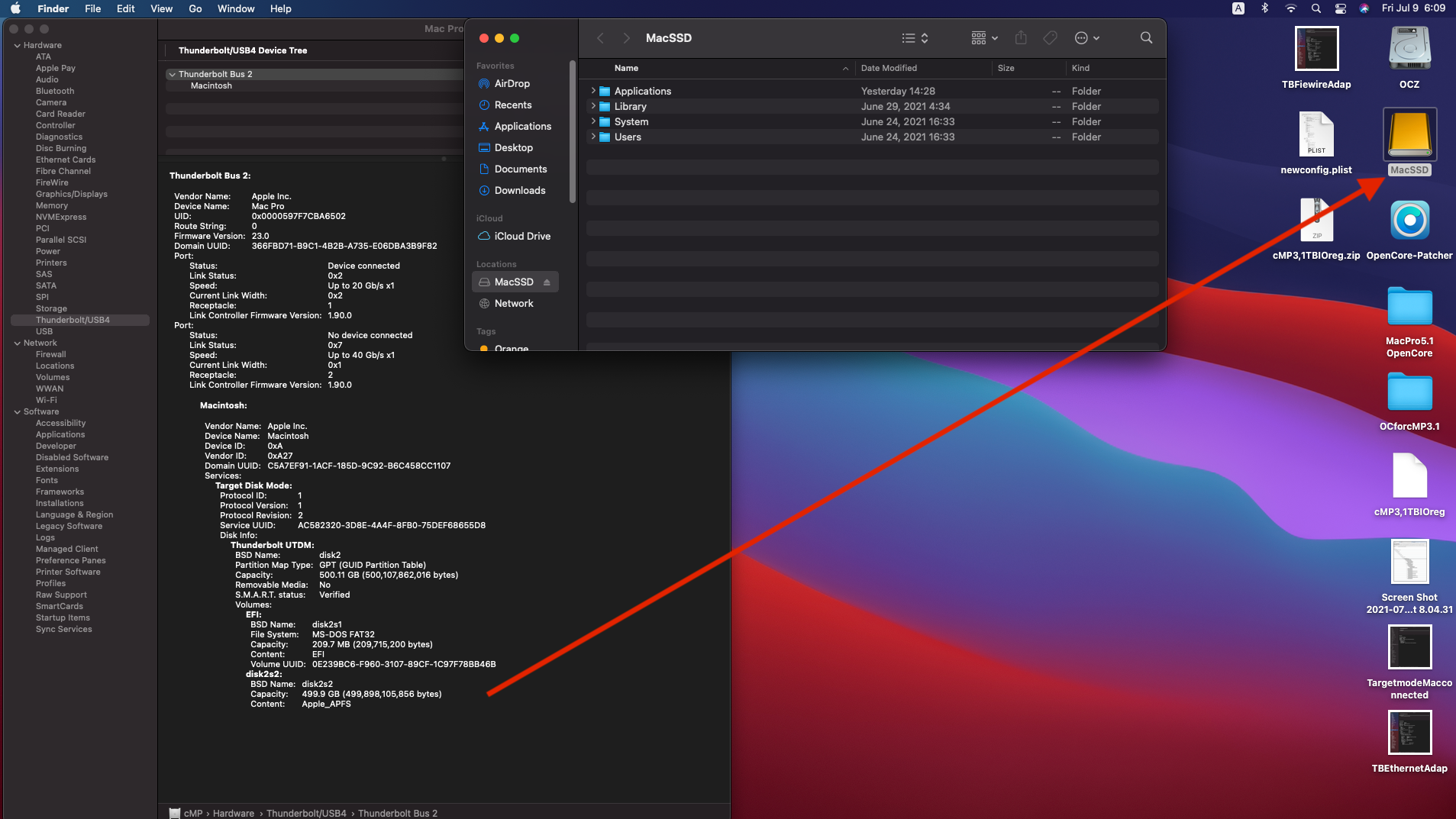

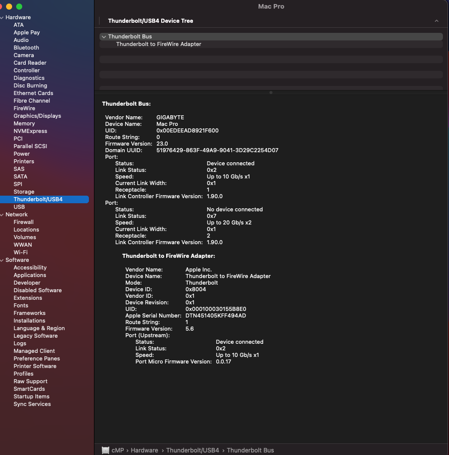

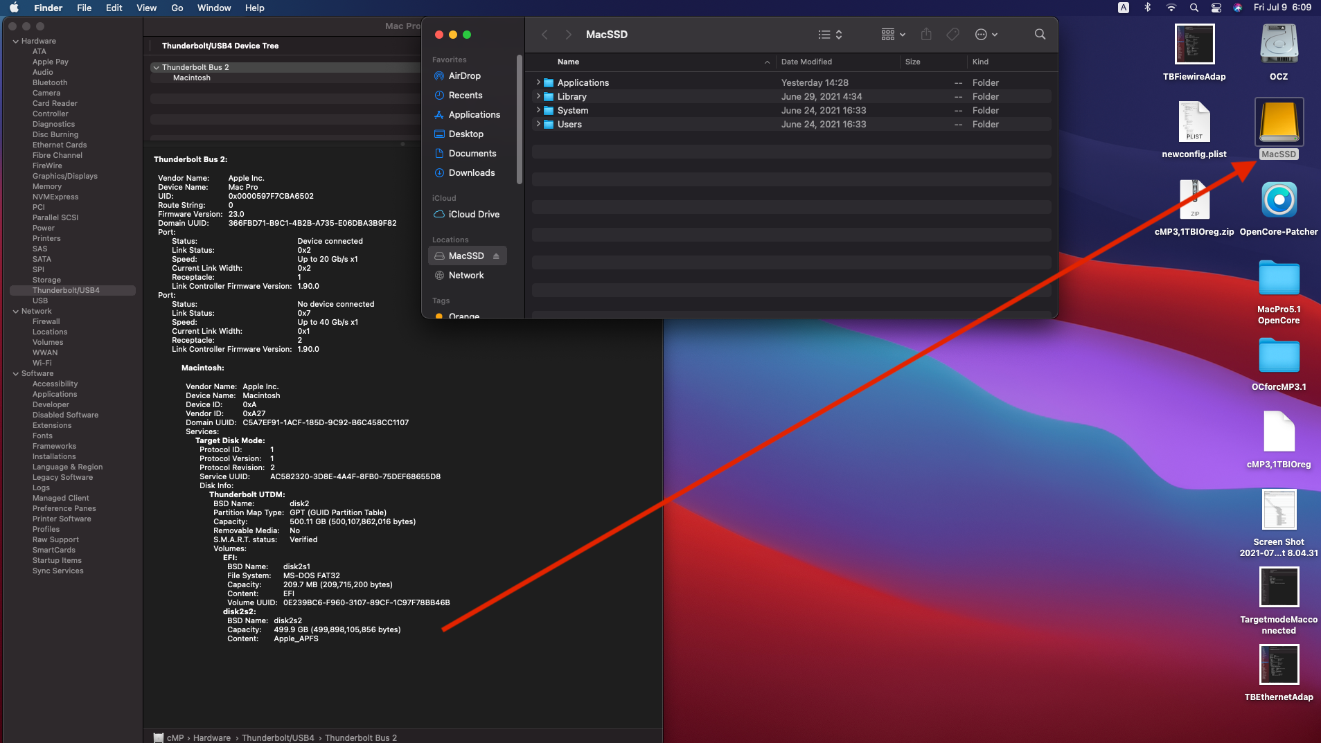

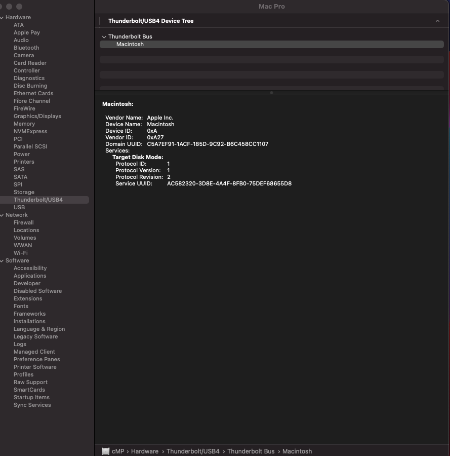

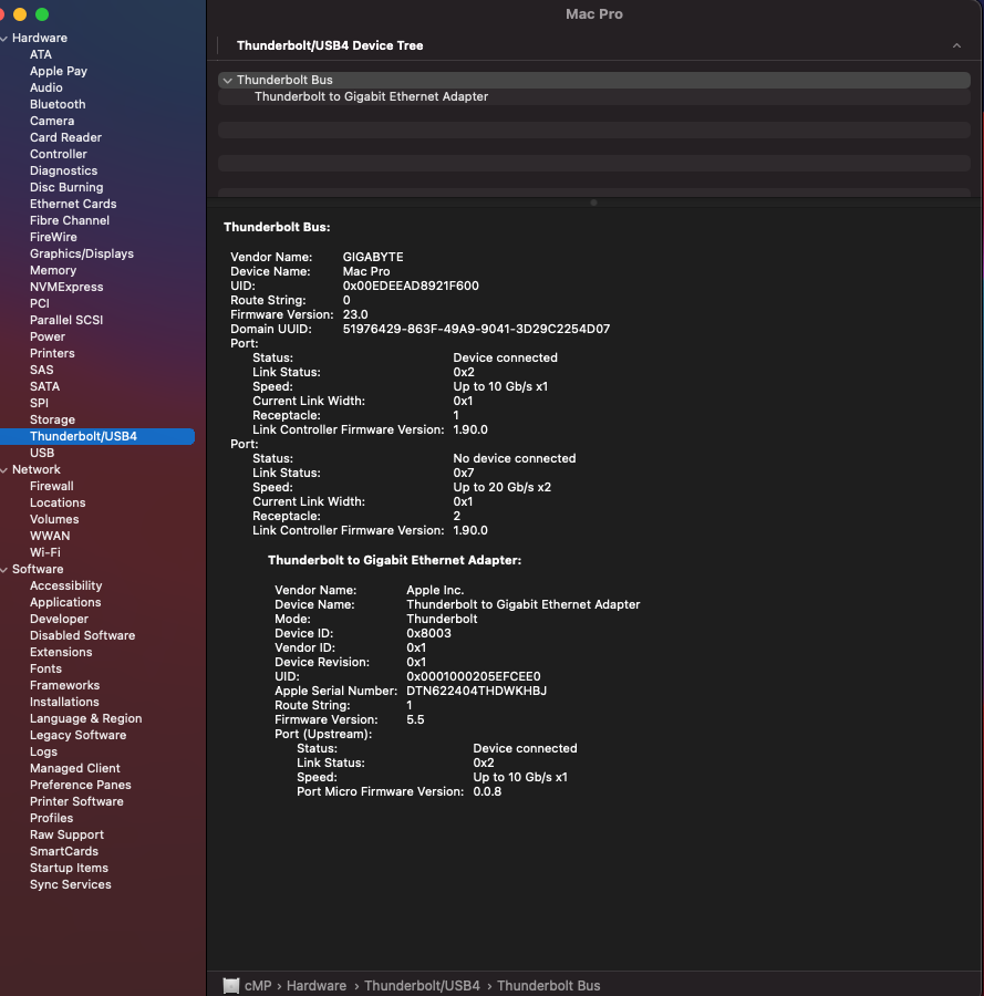

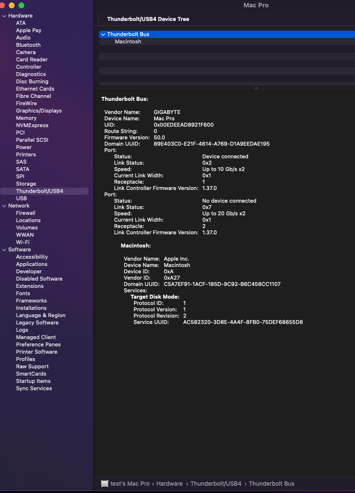

Success—in addition to recompiling the SSDT-TBOLT3.aml from D2M2 for my cMP3.1 IOReg TB path, I also added some lines to the config.plist generated from OCLP for the cMP3,1 and it came good.
If people here want to do this for the cMP3,1 I'll post a blow-by-blow description of how I did it.

Congratulation ! I have considered Thunderbolt for a short while but could not see the value it adds. Considering MacPro3,1 is limited to PCIe 2.0 (x16 slots) and PCIe 1.0 (x4 slots) what is the actual throughput you achieve ? My NVMe SSD in slot 2 has appr. 1500 MB/s, which would be around 10 GT/s.
I also need to force PCIe 2.0 mode through a Lauch daemon. It the flashed Titan Ridge natively negotiating 2.0 speed ?

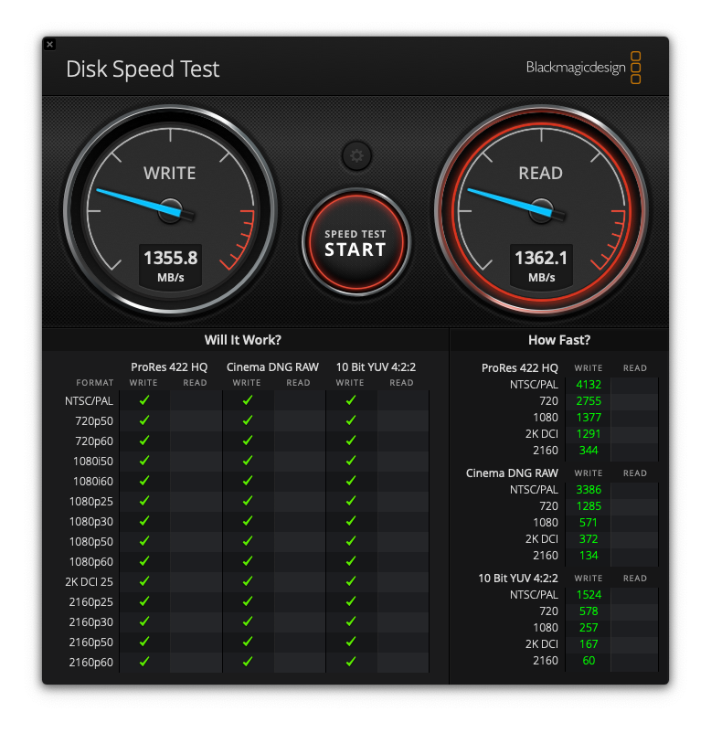

It is showing 20 Gb/s on the connected TB port and 40 Gb/s on the open port.
I haven't clocked the true speed yet.

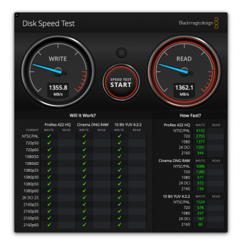

The boot NVMe Samsung SSD in the HighPoint 7101 uses the AIC's own PCIe Gen 3.0 chip so it gets much better speeds.
