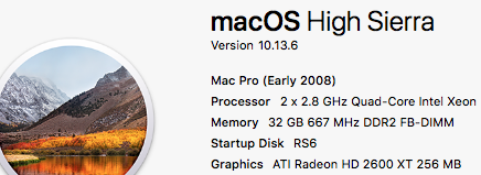

Was gifted a 3,1 from a friend and am now down this path.
In 3 days it now has 32GB of RAM (Have 64 to install but it doesn't see it so I removed) up from 2GB, is now on 10.13, up from 10.5 when I received it, and now has an SSD.
Running into some random issues but so far so good. I seem to be missing a step on OC setup using the tutorial, but hope to figure it out. My 5,1 is running solid on OC, so I just must have missed some steps! Screen Shot 2022-11-02 at 9.30.13 PM.png

My issue seems to be different and could be due to my actual memory.
I am running 667 MHZ 8GB Modules which is not the desirable speed of 800 MHz. I know I am taking a speed performance hit with that, and there may be other compatibility issues from running RAM of that size at the wrong speed.
As the memory was free to me, I am fine with only 32gb if that is the limit in this configuration. It is far better than the 2GB that came with the system.
Status as of now
- Mem slots 1 & 2 occupied on both cards with 8GB Modules - Boots, sees correct 32GB of RAM
- Mem slots 1 - 3 occupied on both cards, Boots, only sees 32GB of RAM
- Mem slots 1 -4 occupied on both cards, boots to grey screen and stops.
I haven't had time to boot Verbose or do other deep dives yet, I am simply happy where it is at as I work on getting OpenCore setup, and my new ATI graphics card situated for Metal support. I hope to dive back into this memory mystery at a later time.
The point was that 64gb should show up albeit best at 56 or limiting to 62. I forget the 62gb limit command now though.
Perhaps an issue with the riser? You could try Slots 1 and 2 on one and 1 to 4 on the other

Yeah I will look into this further and appreciate the tip. I saw the command in one of the threads so should be able to try it out next time I have available.
It might be just booting really slow. How long did you wait? 64GB causes slowdown which you can fix by telling the OS to use only 62GB.
You should install 32 GB, boot, add maxmem=63488 to boot-args, shutdown, install 64GB, boot.
https://forums.macrumors.com/threads/mac-pro-3-1-nvme-support-upgrade-guide-questions.2194878/
https://forums.macrumors.com/thread...ns.2194878/page-2?post=28026180#post-28026180
I put 64GB of RAM in my 3,1 today which slowed down everything. I followed your instruction and put maxmem=63488. Now my 3,1 runs Ventura, 2 x 3.2 GHz Quad-Core, AMD Radeon RX 580 8 GB, 62 GB 800 MHz DDR2 FB-DIMM. -- Not bad for this old fellow.
