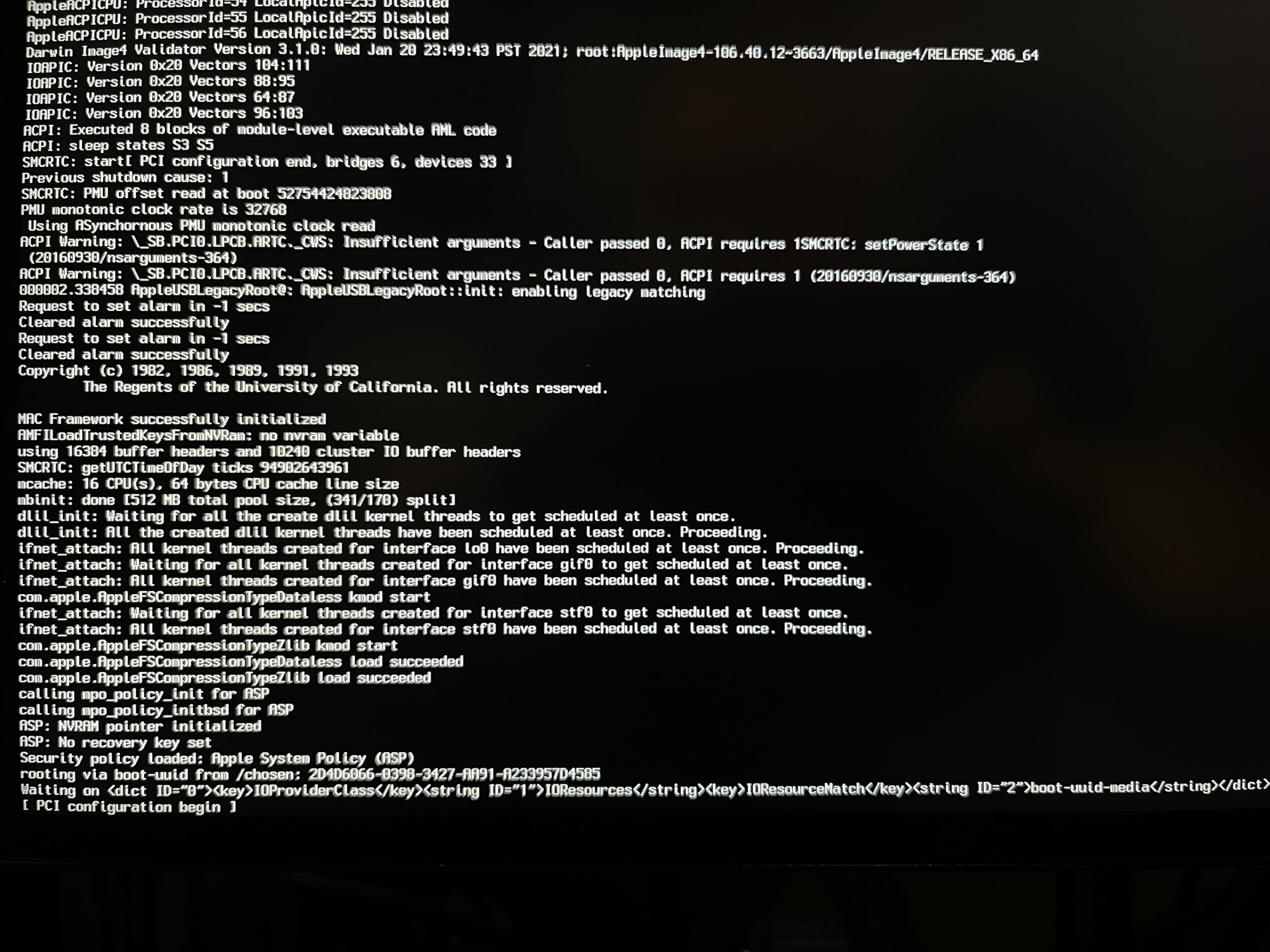

Hi all,
I currently have a Mac Pro 7,1 running Big Sur and Windows 10 on separate drives. I use an RTX 2060 GPU on the Windows side for the NVENC video encoder when live streaming. Unfortunately, while this is okay in macOS, it is breaking my Sleep/Wake functionality. I would like to hide it from macOS entirely.
This is where OpenCore comes in. I believe this is something I can do with OpenCore via an SSDT patch. I have had some success booting to recovery with DBG-066, but outside of that I have had issues with either IOBCC not responding (which I believe is a bridgeOS error - the T2 chip) or I get forced into recovery with every boot.
Can anyone help me understand how I would setup the configuration?
I also want to understand:
  • Do I need to use kexts like Lilu and WhateverGreen?
  • Do I need to patch anything in my SSDTs given its a real Mac?
  • Is this supported at all by OpenCore? Can I get the Mac to run like stock on OpenCore, but with the benefits of some modifications?
I really appreciate any help people can give me. I really am not sure who to ask!
Cheers!

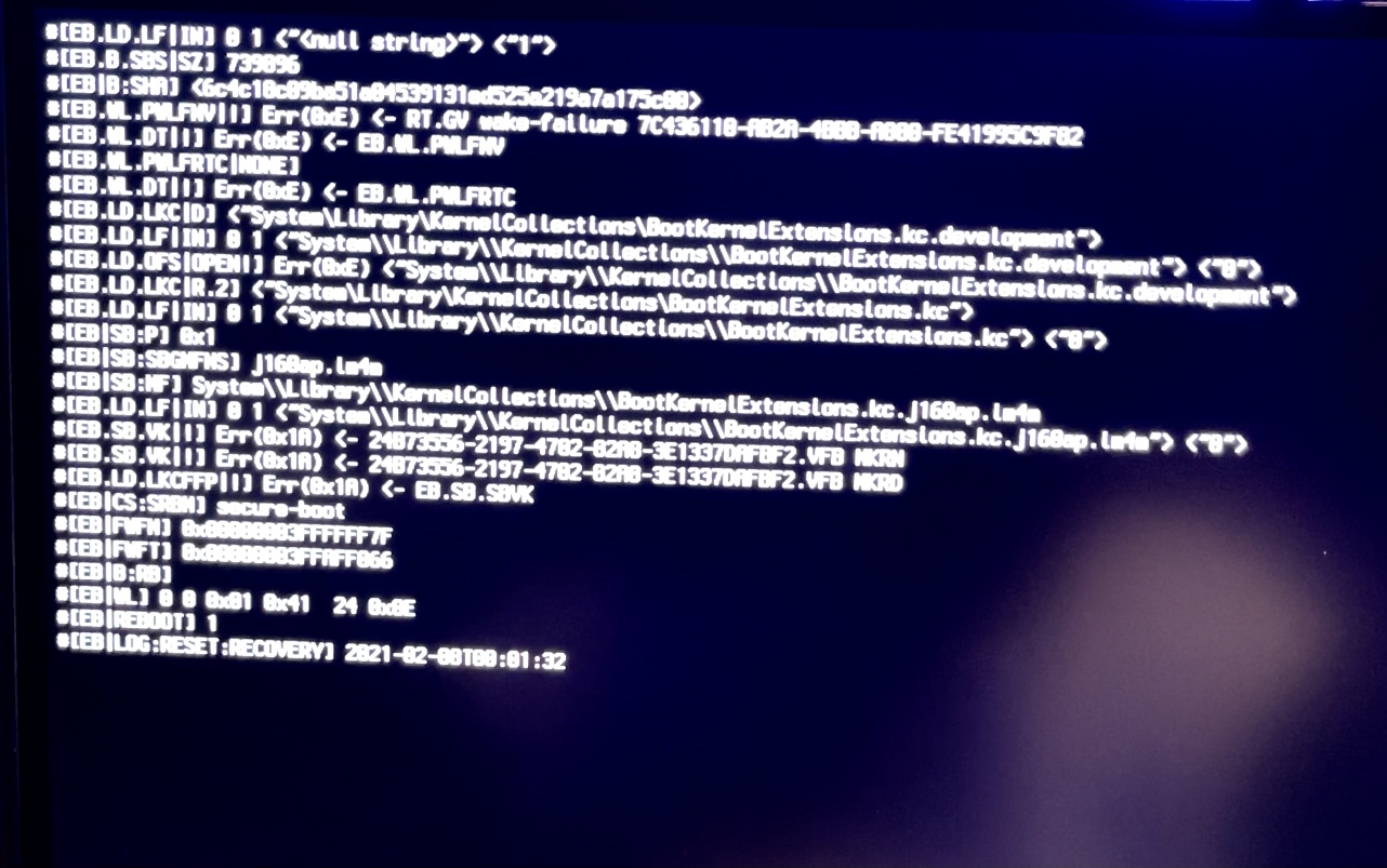

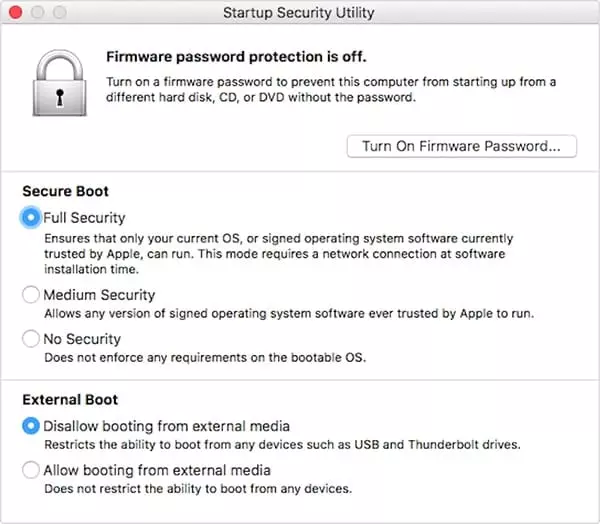

Do you recall what you had to set in the config file? I get further when I have AppleSecureBoot turned on, but it pushes me into recovery every time and I am abit confused about it to be honest!

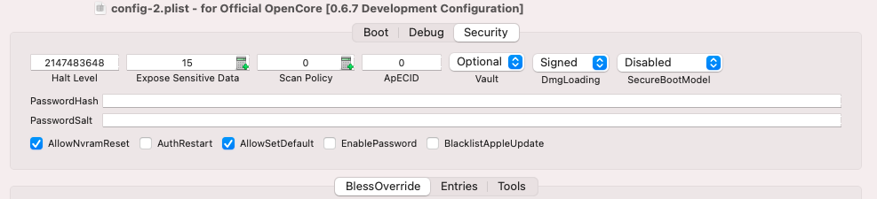

Can you share the config file you use? What are your settings in the Startup Security Utility?
I set it to No Security and Allow External Boot, but you can try Medium security if you want.
Misc -> Security -> SecureBootModel set as j160

I had the Firmware Settings to No Security and Allow External Boot already, but I will try to match your config there and see if that helps. I wonder if I need AppleSecureBoot enabled if it is off in the Firmware Settings? Interesting...

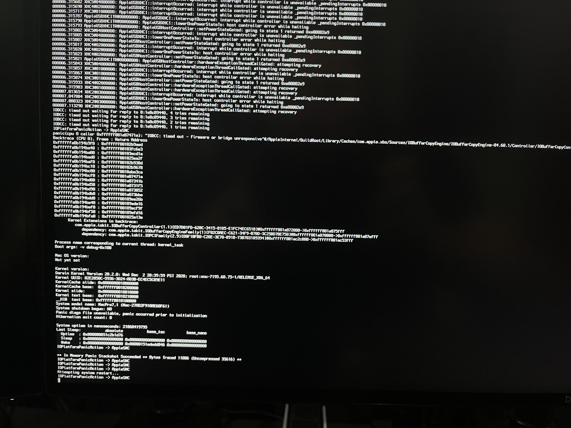

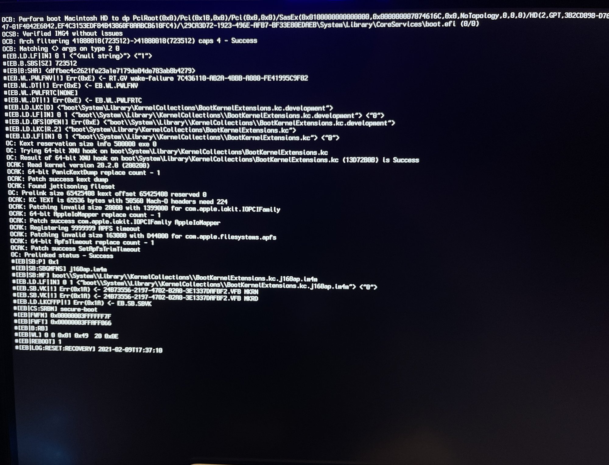

Okay, so with this config, I get a boot hang at [PCI Configuration Begin]. Testing now with AppleSecureBoot protocol override on.

Okay, so a new update. AppleSecureBoot being enabled in the ProtocolOverrides pushes me straight to recovery with this message:
Removing this gets me further into the boot process, but I am hanging at PCI Configuration Begin again like this:
I shall continue to dig. Still fairly confused ?

macrumors member
Feb 7, 2021
43
10
Okay, so debug version is on. Here is the output to the text file, and the current plist. With SecureBootModel set to j160, I get pushed to recovery straight away. Let me set that back to disabled and the AppleSecureBoot back to disabled also and see if I am still getting the IOBCC panic.
  • opencore-2021-02-09-161557.txt.zip
  • config.plist.zip
trus0und
macrumors member
Feb 7, 2021
43
10
When this happens, after I select the partition to boot it runs through so EB values and says RESET:RECOVERY. I dont ever get into the normal Verbose Output or see an Apple Logo.
trus0und
macrumors member
Feb 7, 2021
43
10
Okay, same deal with the SIP disable config. This is the last thing I see before it reboots to recovery:
Sorry, I feel like I am very little help here!
