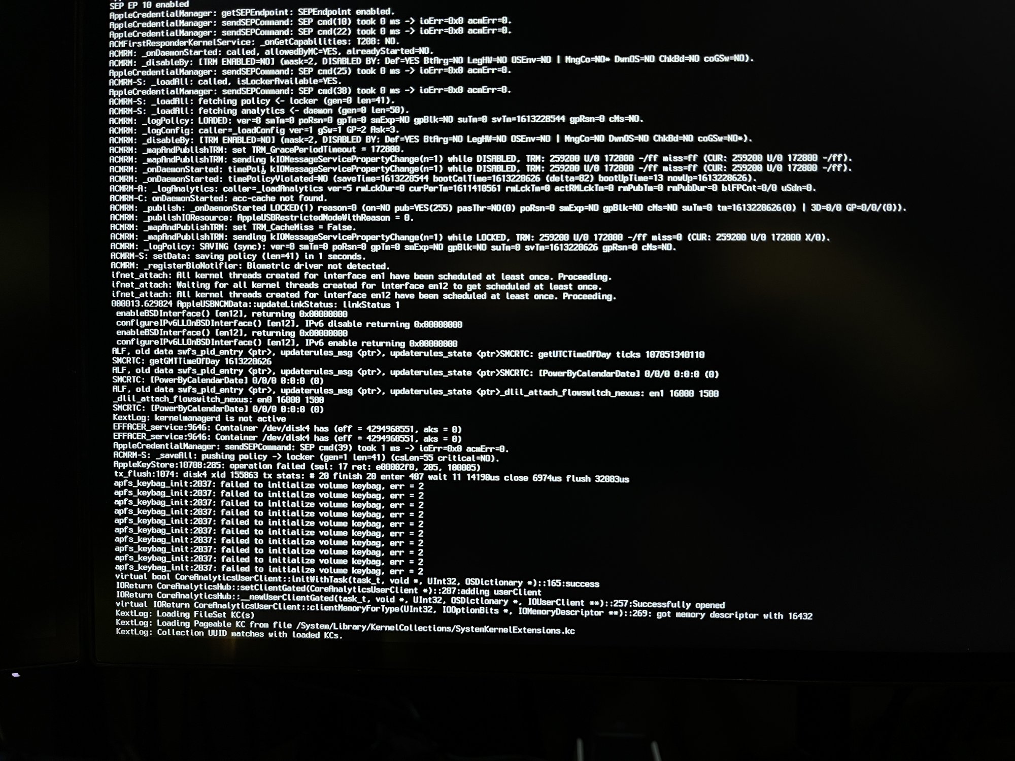

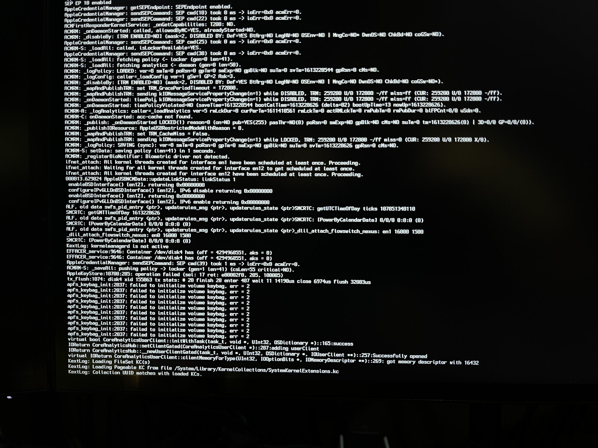

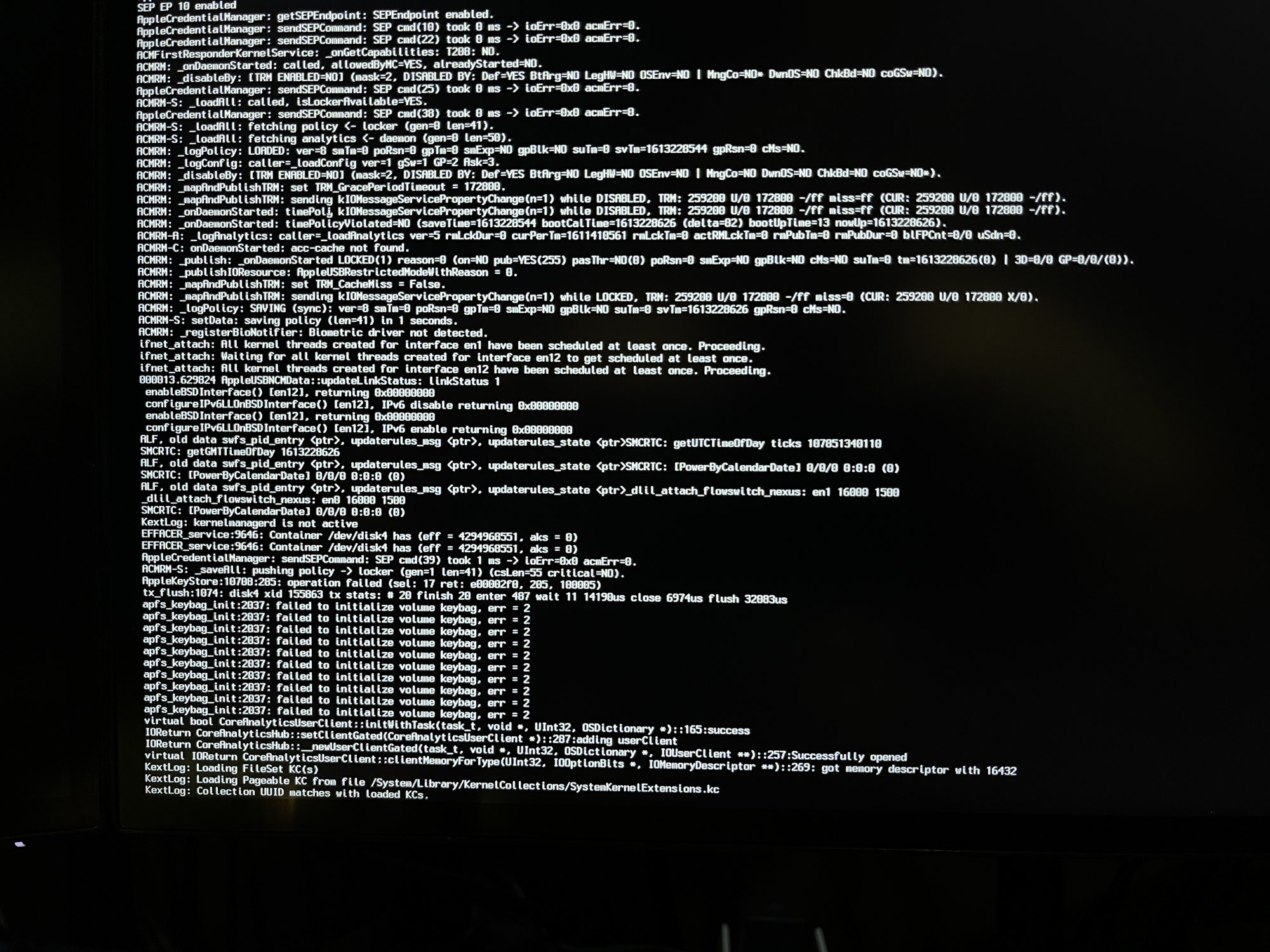

Getting a hang near the end of the boot process with the current AML file I have made (attached).
Originally thought this was related to the apfs_keybag error, but noticed it on normal boot too so unlikely related.

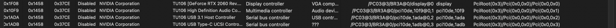

Finally have had another chance to jump into this, but am still having a few issues understanding why this isnt disabling. This is what I can see in Hackintool:

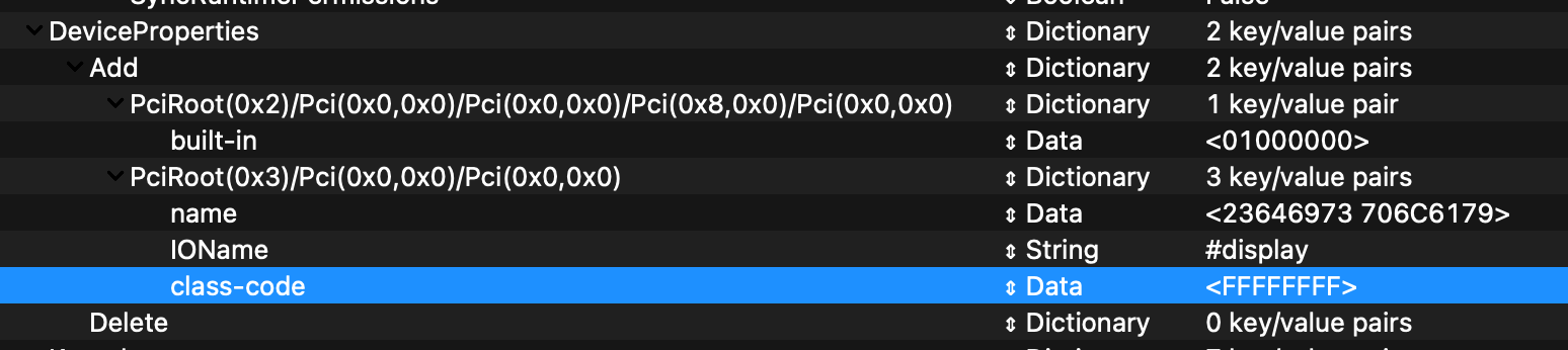

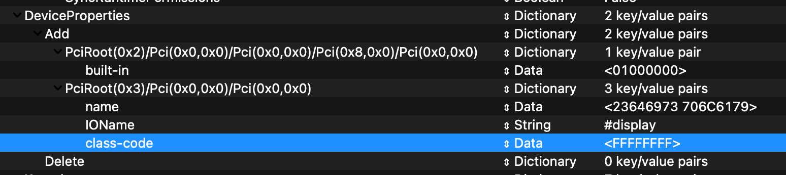

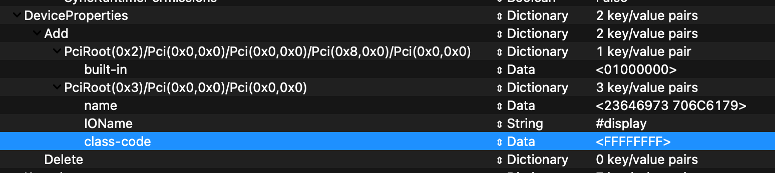

I believe the PciRoot is correct, and gfxutil does show the same thing. This is what I have added to the DeviceProperties in OpenCore:

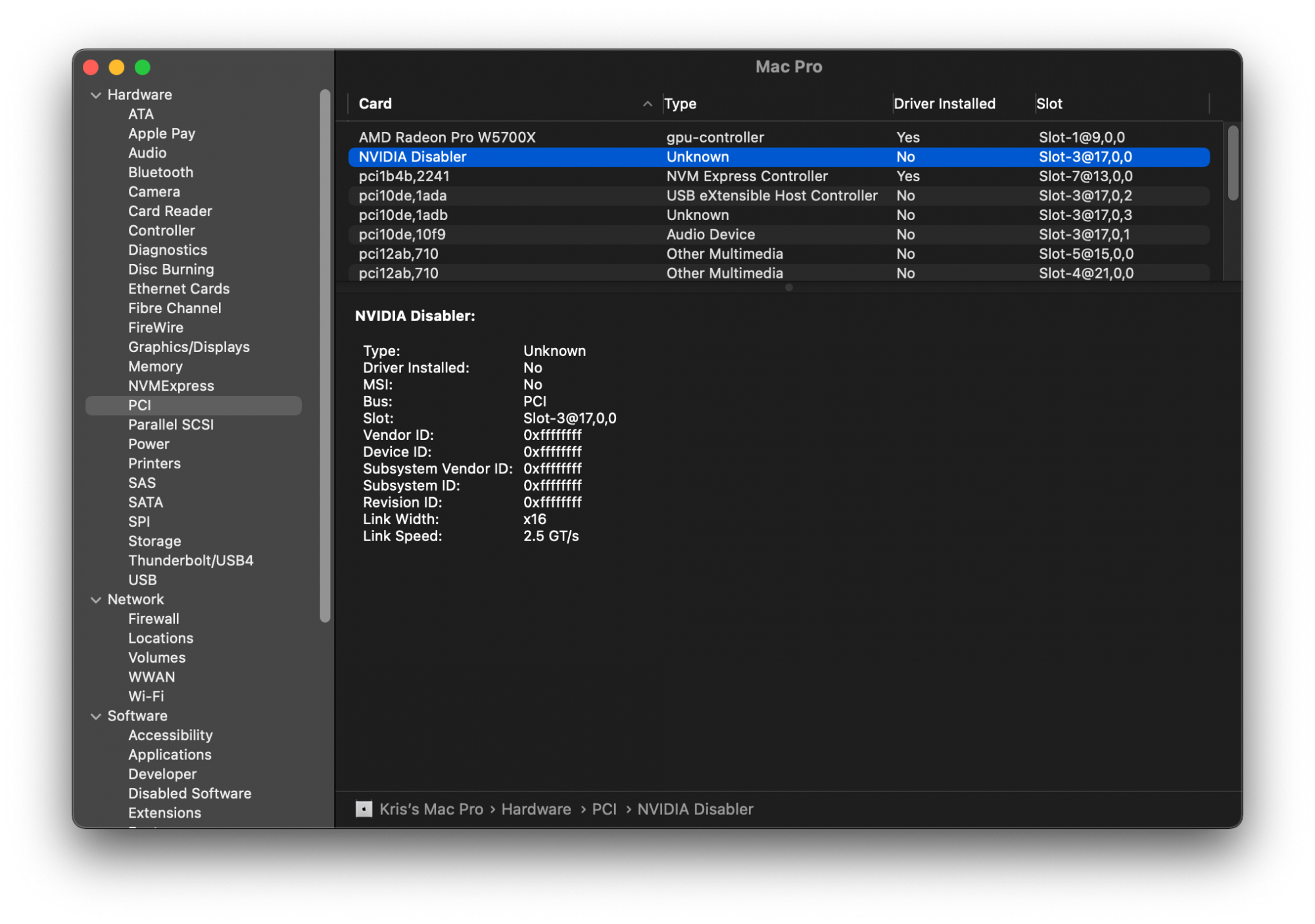

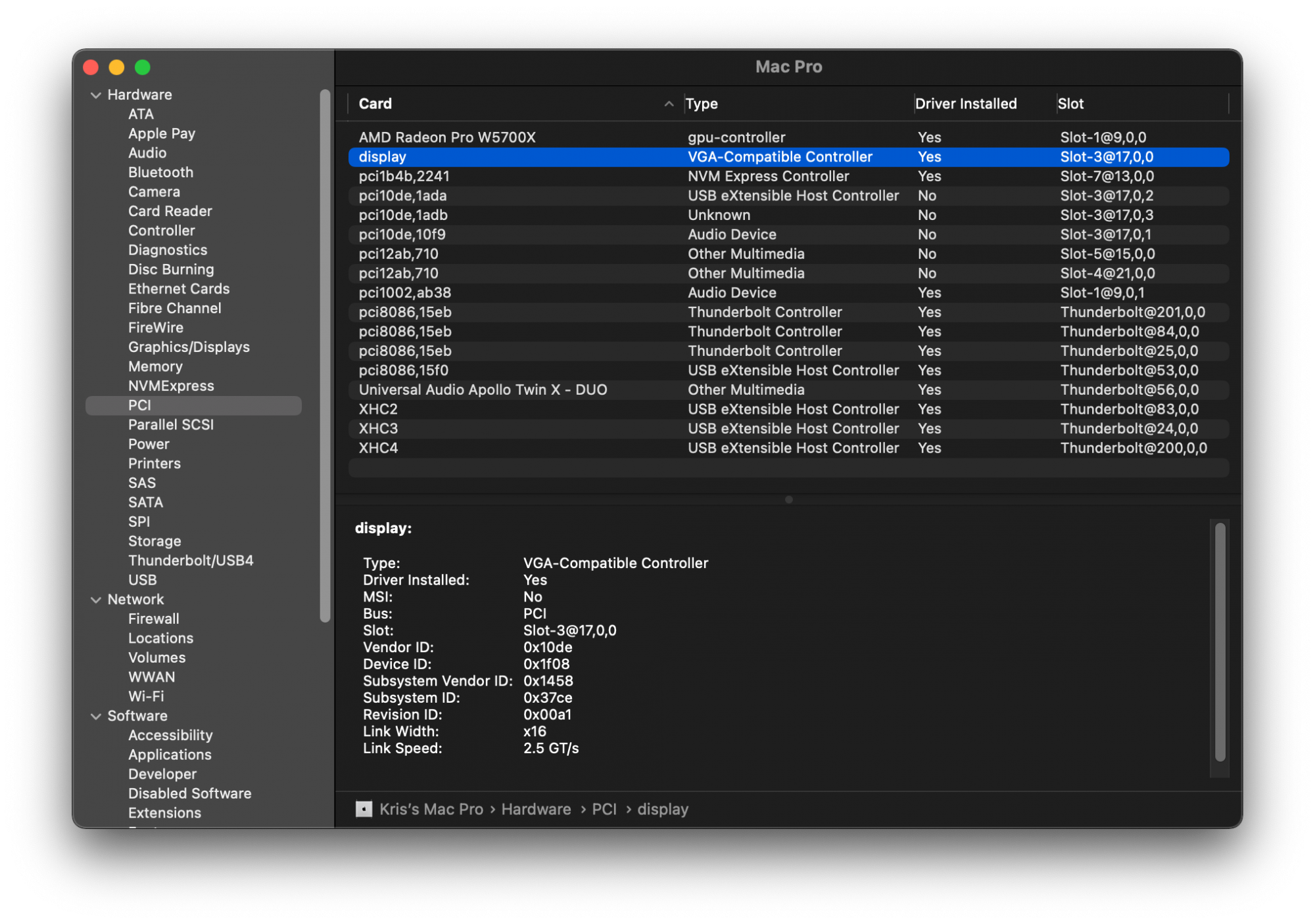

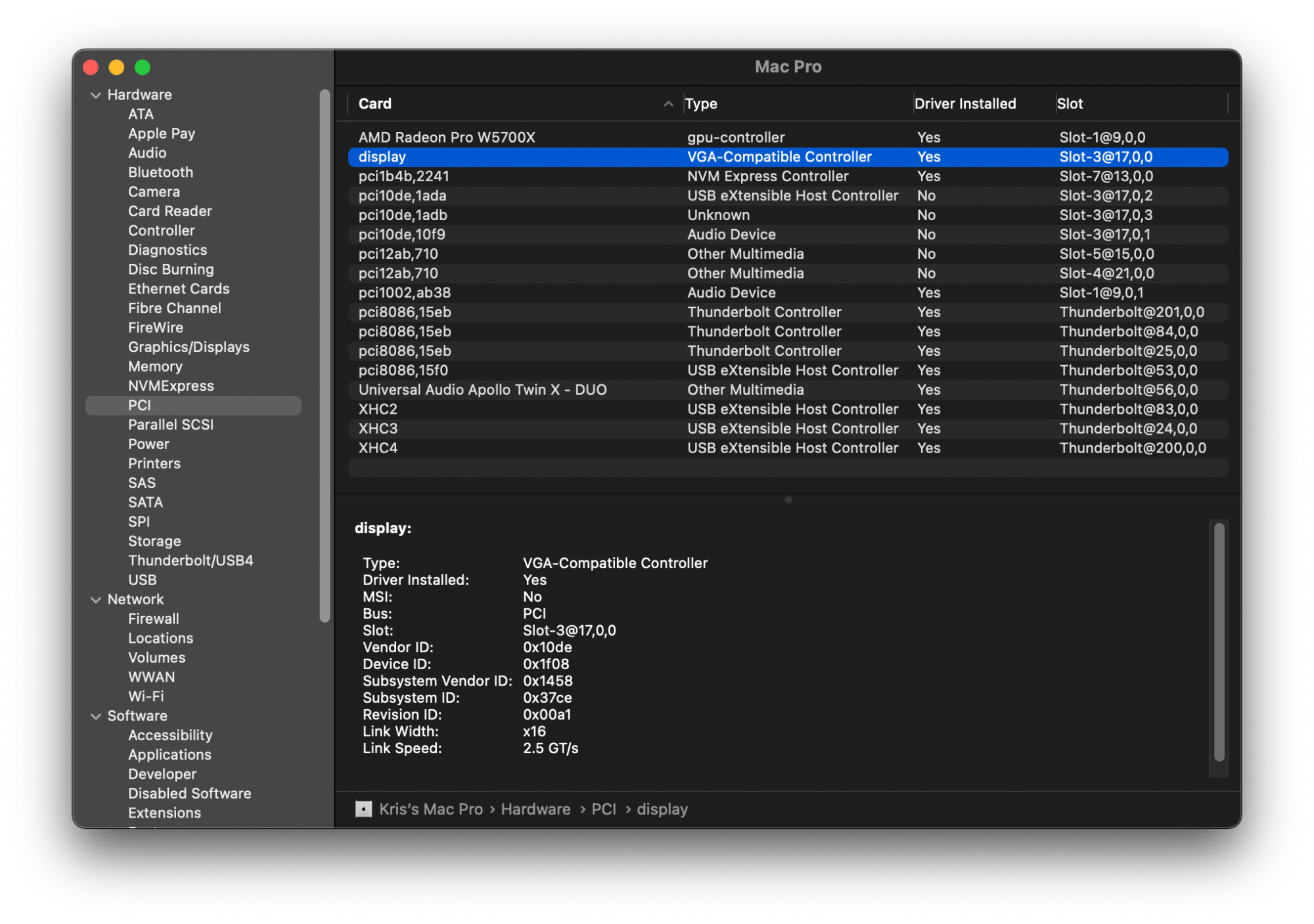

This does not work, and after the reboot I can still see the additional GPU in the System Info. Also this is how it displays in the PCI Devices:
If anyone can point me in the right direction here I would be very grateful!

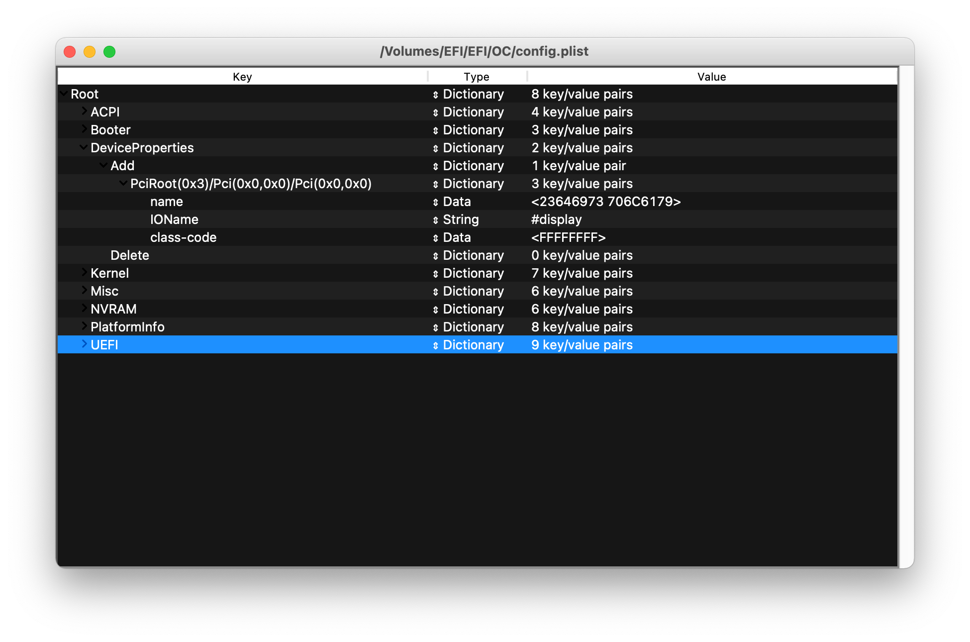

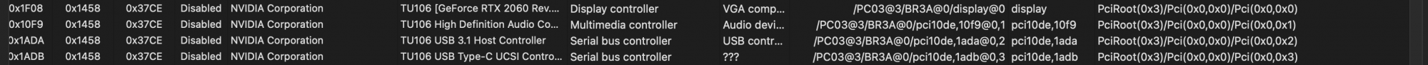

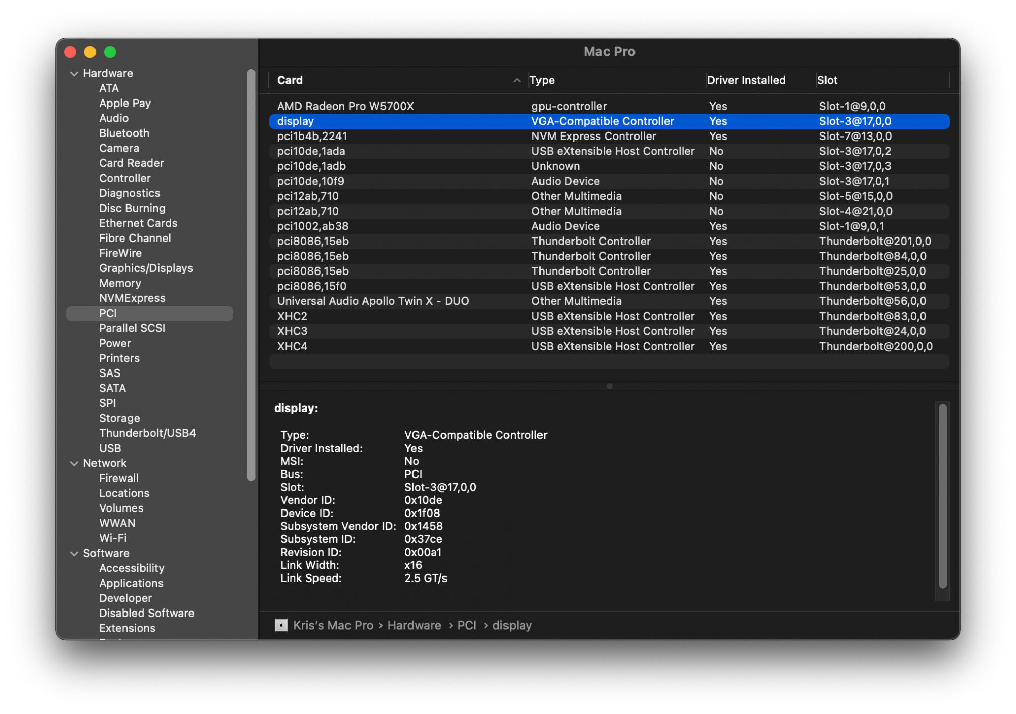

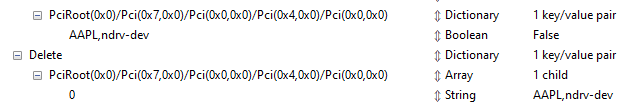

When you add properties you have to also delete them if they already exist.
Reactions: trus0und

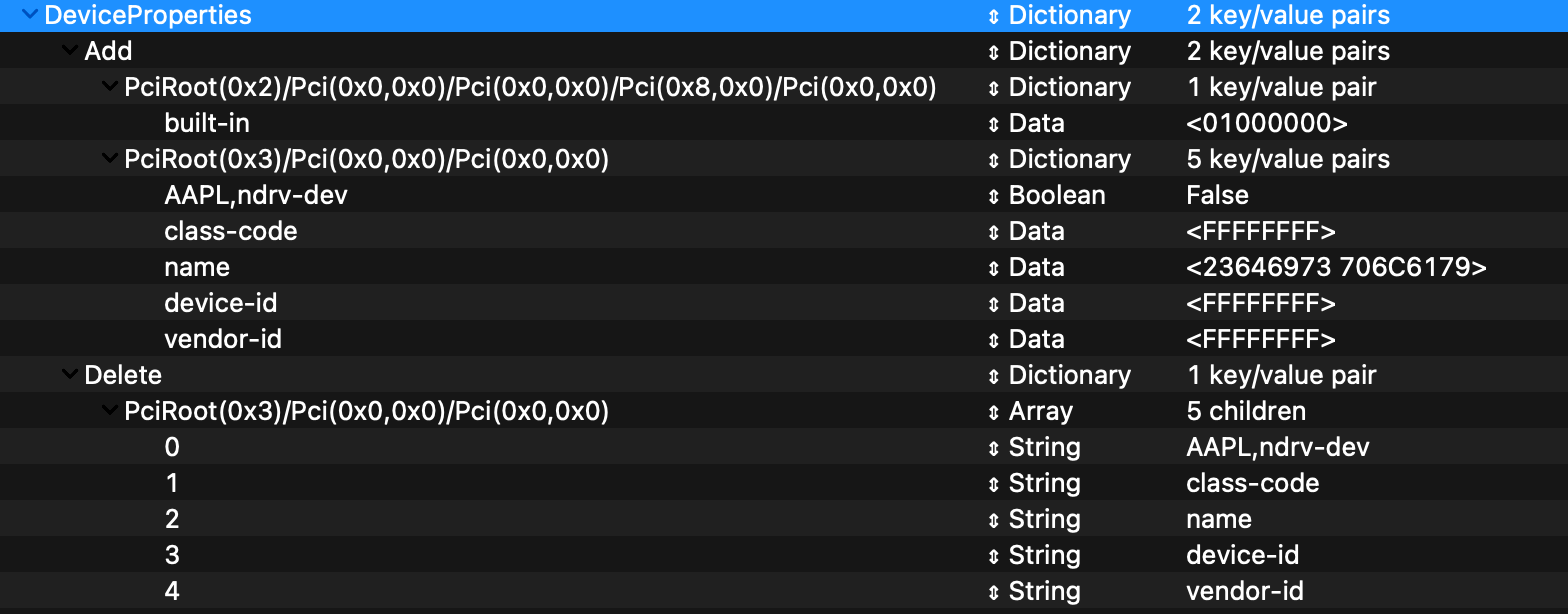

@startergo Thank you, I have attempted adding the properties like this but have found very little on whether I am doing the delete part correctly as I am finding very little in the way of info on that.
This is where I am at, but it just seems to be injecting nothing at all. I wonder if the PciRoot is incorrect?

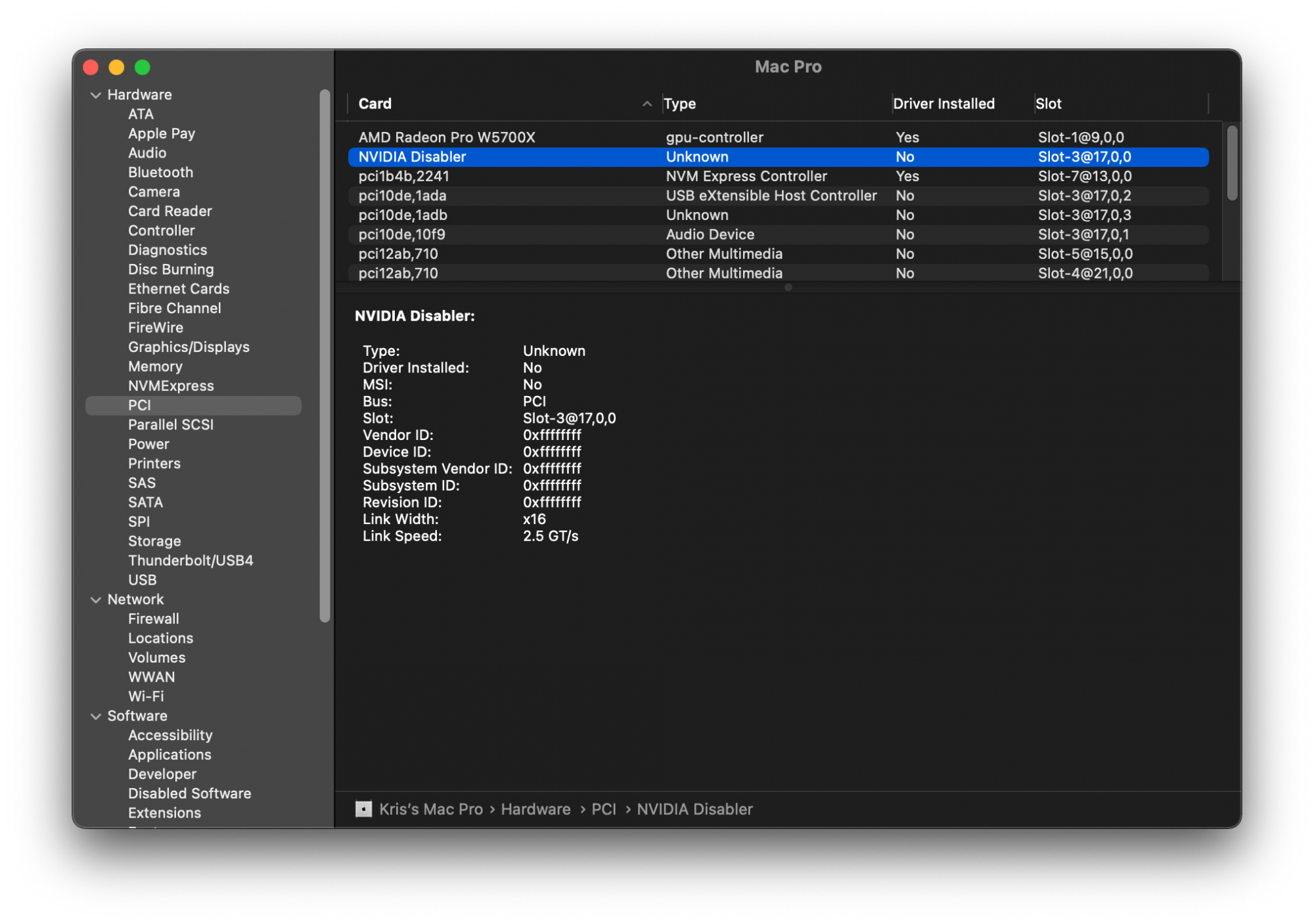

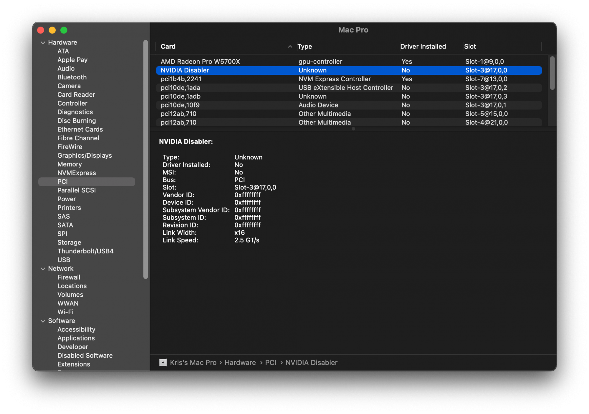

Made some great progress tonight! With the help of MaLd0n, we have lift off! Was even able to customise the DSDT Patch a little:
Sleep/Wake is working again. My drives show as internal. I have OpenCore on the internal EFI and OpenCapony is setup so I have a boot picker! Success!!!
He made a DSDT patch for me which disables the GPU only on Darwin. I can share it if you want to see how it was done. I am not really sure how he did it because he added a DGPU section and then inside that he added some injects that look alot like the SSDT injects.

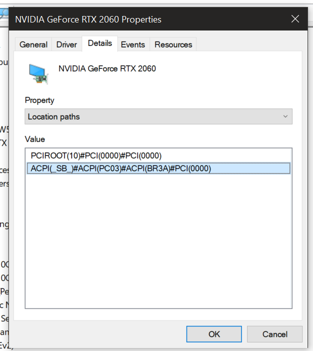

@startergo My apologies, been a busy couple of days! I did use that guide, and from the Windows side it appears my path is _SB_.PC03.BR3A. So in saying that, I modified the SSDT to this which I believe is correct:

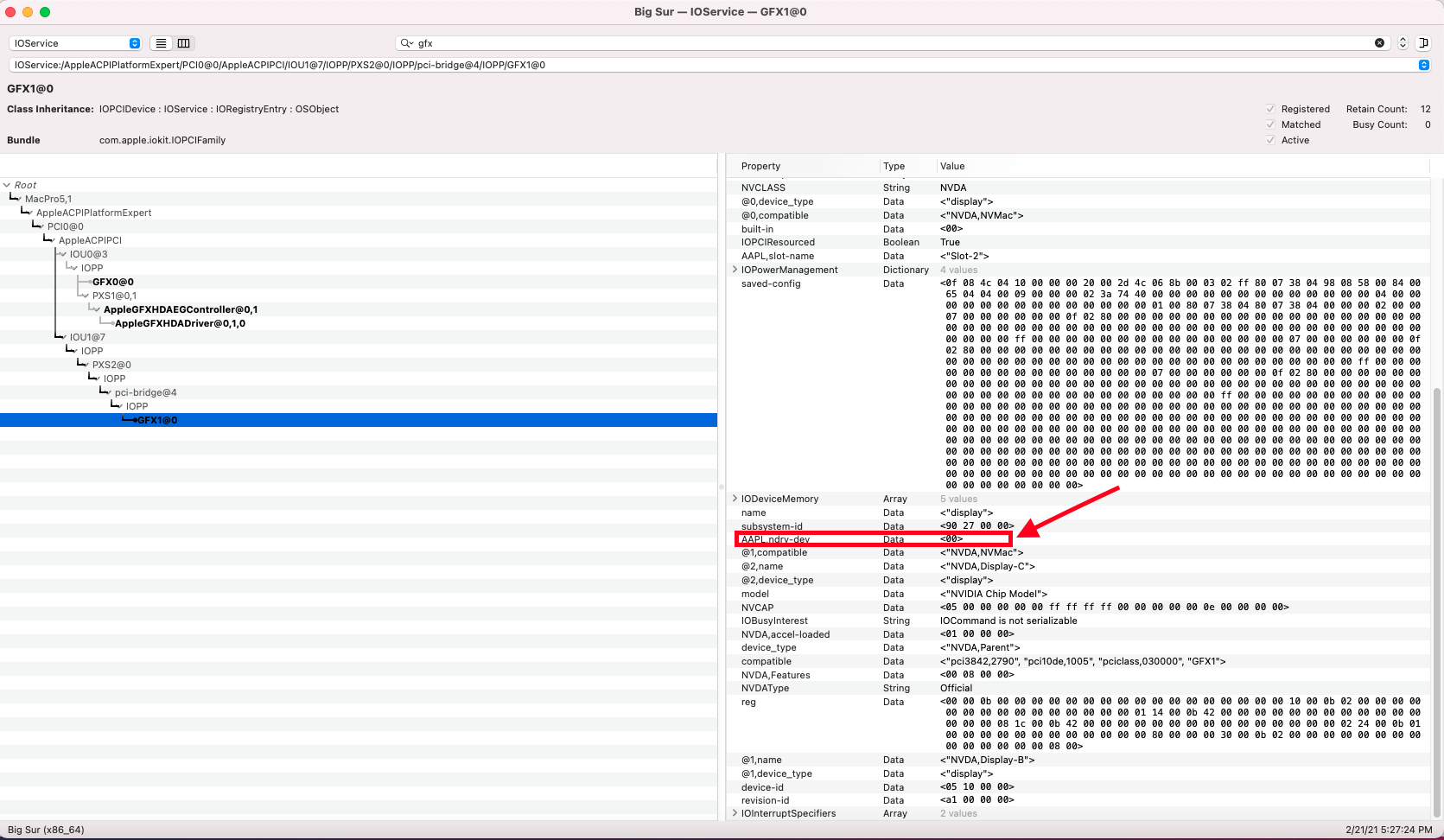

I see, and the AAPL, ndrv-dev setting disables the loading of the driver? Seems the driver that loads for me without the DSDT is IONDRVSupport I believe and that is what isn't loading with the DSDT patch.
