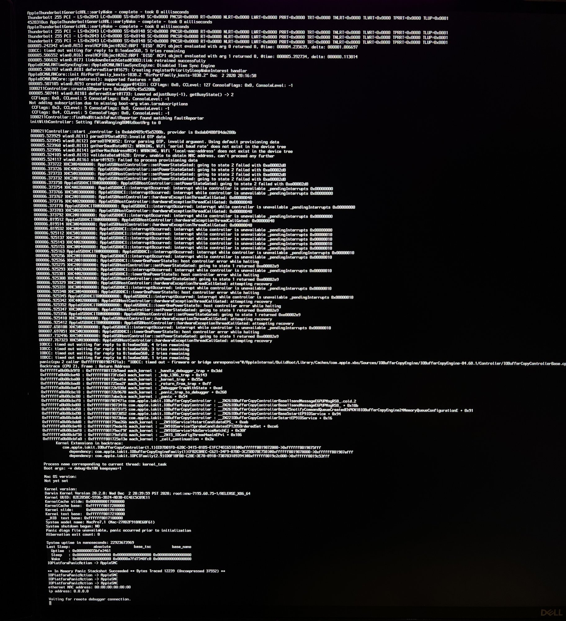

So with Secure Boot disabled I do get to the normal Verbose output, but I get the IOBCC Panic as seen here:
Attached debug log also!

No difference unfortunately, but I feel more confident now. I am guessing we arent going to get OpenCore to boot with AppleSecureBoot on, but surely it cant be impossible to get past the IOBCC panic...
If you have a debug OC version the log should be in the EFI folder. Try this.

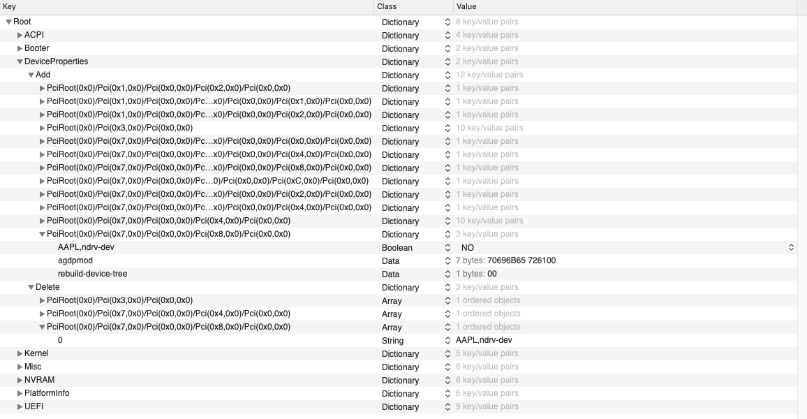

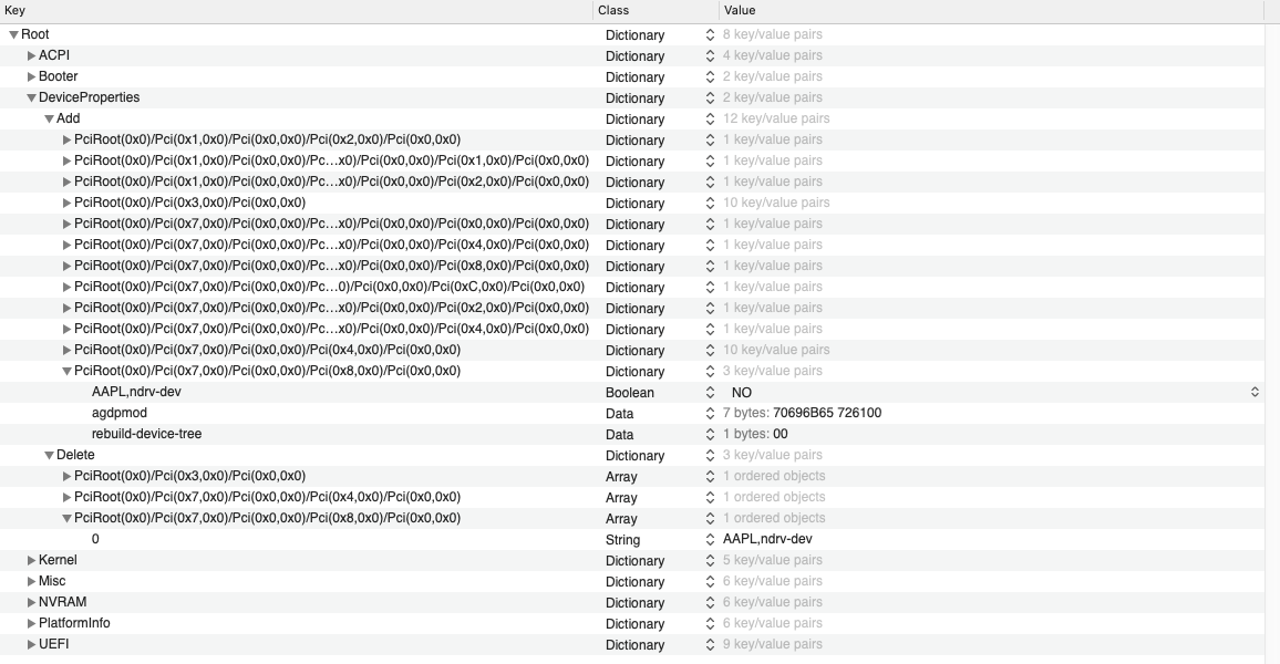

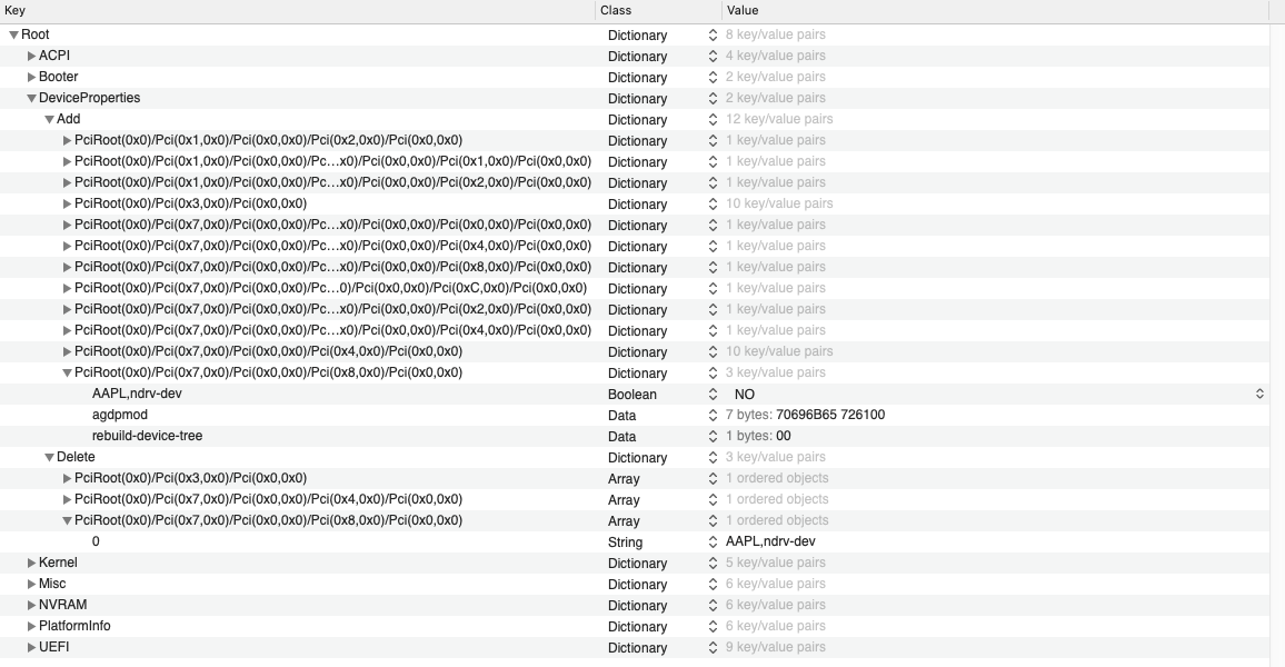

@startergo Yes, I was able to boot Big Sur from Preboot from rEFInd! If this would help me to disable the Nvidia card, and I can flip the drives I want to Internal with Innie, then we may have a solution!
Try this config. @vit9696 said if rEFInd boots there is an error in the config.
  • config.plist.zip
