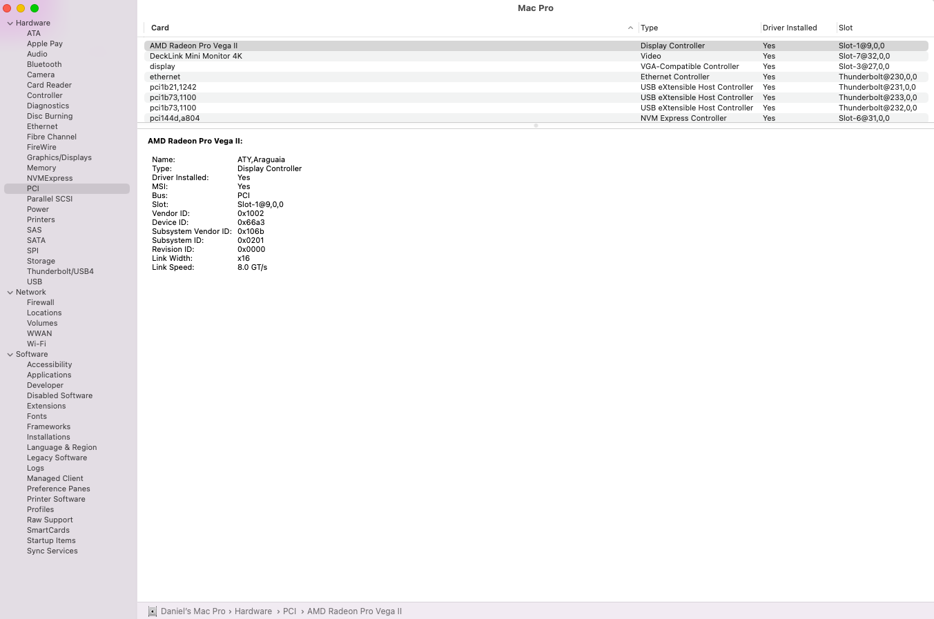

I own a Mac Pro 2019 28core and I am currently using the MPX Vega II. However, I just got my AMD RX 6950 XT reference card and I realize that the update/support for the card (although 6900 is supported) can take some time. As I am eager to use my card asap, I am wondering if anyone here can help me (i can pay) to spoof the ID using open-core, tricking my mac to think it's a 6900 XT for the time being. I have absolutely no experience with this, but hopefully, some kind soul knows how to help me out 🙂
I also have some issues with the 6950 XT in BootCamp with the MPX installed (it's fine when MPX is out). But perhaps spoofing in Mac OS will solve this as well, I dunno.

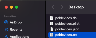

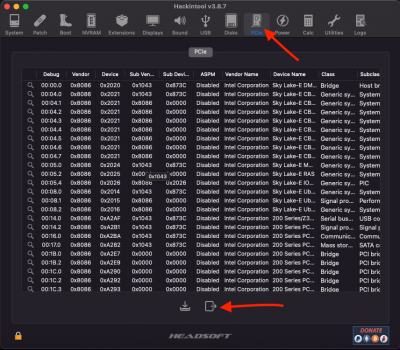

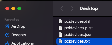

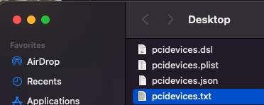

Can you please create a backup with

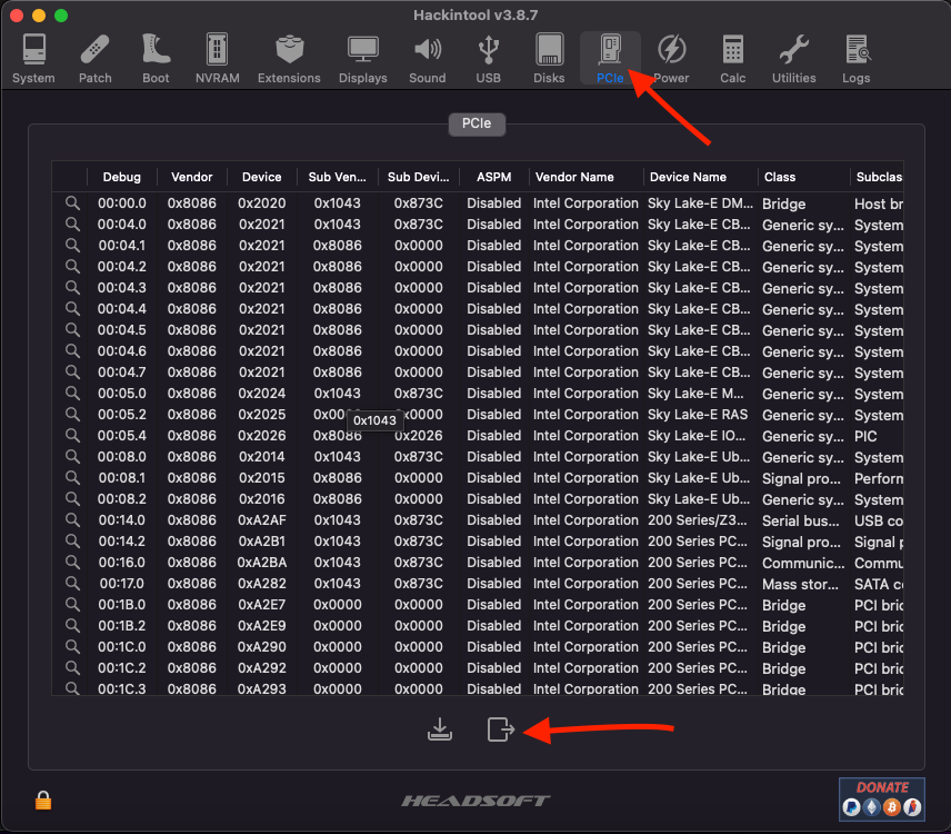

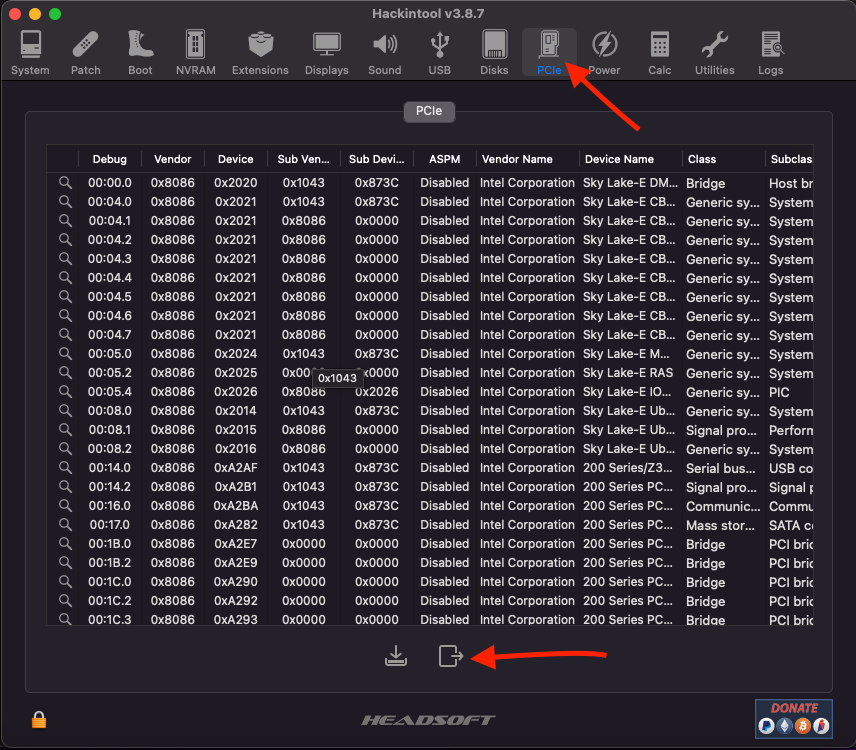

And download Hackintool. In the PCIE tab click export and attach the 4 files created on the desktop.
Hi mate,

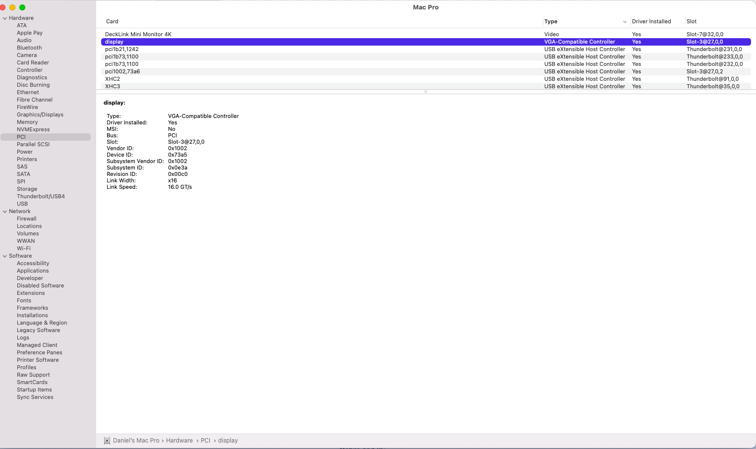

I did download IO explorer and made a backup. However, I don't have much success with Hackintool, as I don't know where to start 🙂 Thank you though.

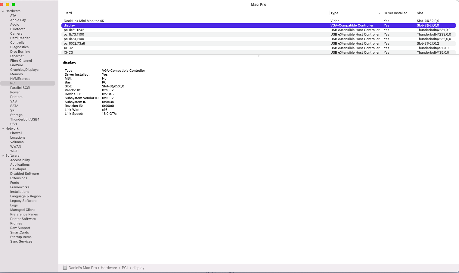

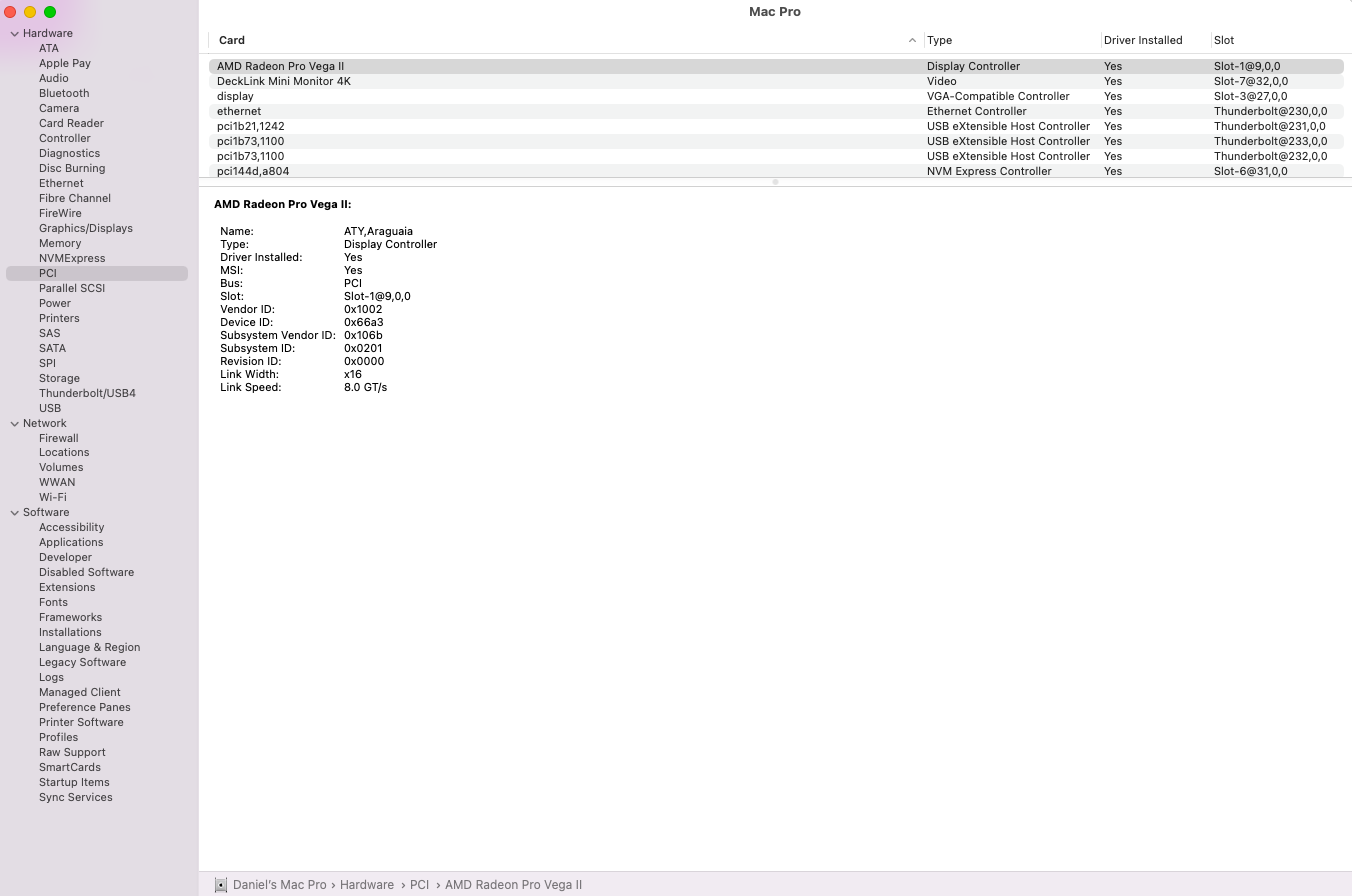

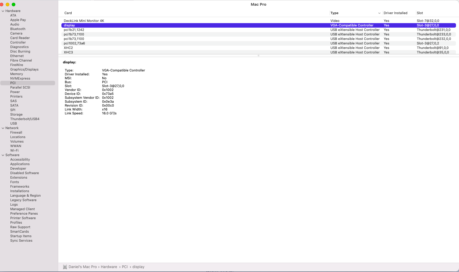

Strange the 6950 XT is not even detected in the registry. Are the fans spinning? Can you attach a display to it?
Make a screenshot like this:
Ok We need to spoof to this device-id:
