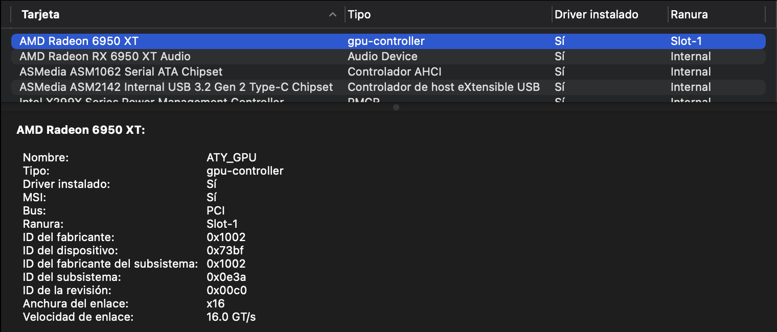

Ok so we tried making 6950xt work unsuccessfully:

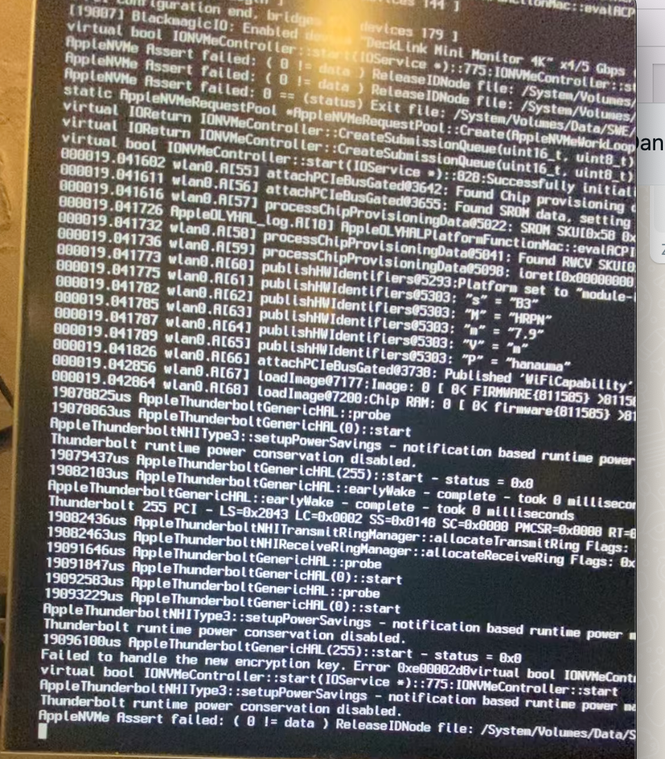

So it reboots with this error:
It is kind of strange as it reboots at AppleNvme Assert failed (although this is probably misleading).
Anyone has any ideas? Attached is the 0.80 OC folder

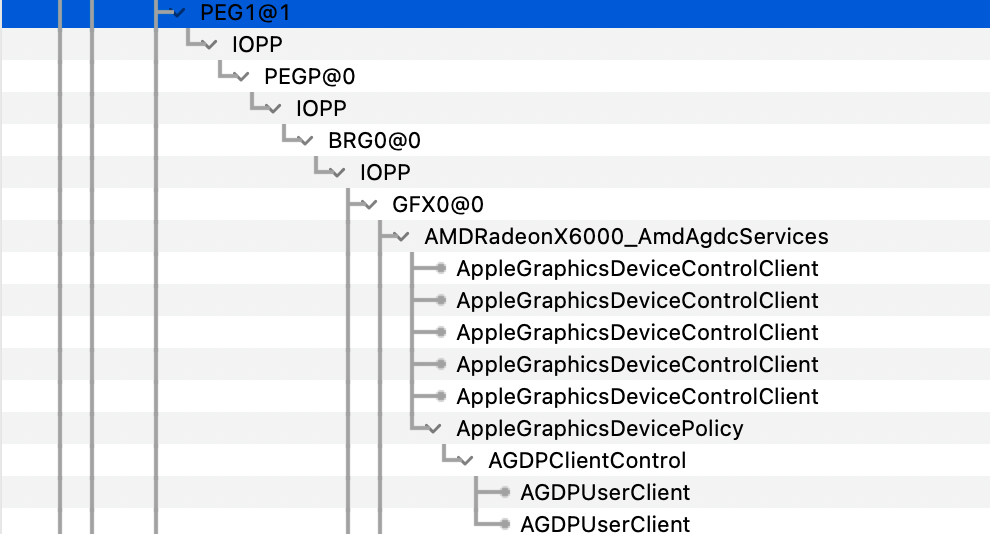

Ok. I made 6950xt work in Monterey with an SSDT on a a x299 mobo. It should be possible for the Mac pro 7,1 or cMP to work too. So as a proof of concept spoofing device-id is enough.
Another solution is to add the device-id to the driver's plist.
screenshot-2022-05-22-at-14-29-18-png.548152
screenshot-2022-05-22-at-14-31-33-png.548153
screenshot-2022-05-22-at-14-39-25-png.548154
screenshot-2022-05-22-at-14-40-34-png.548155

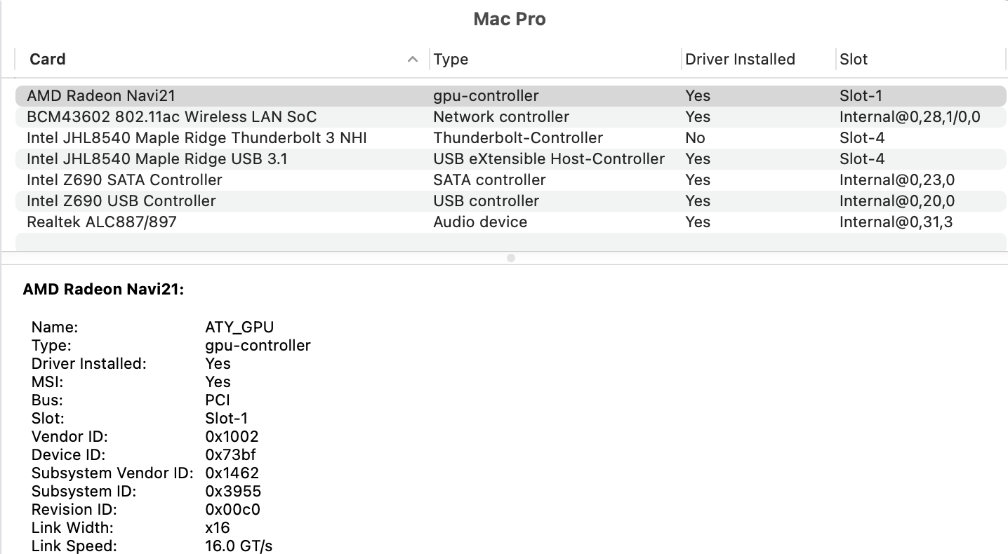

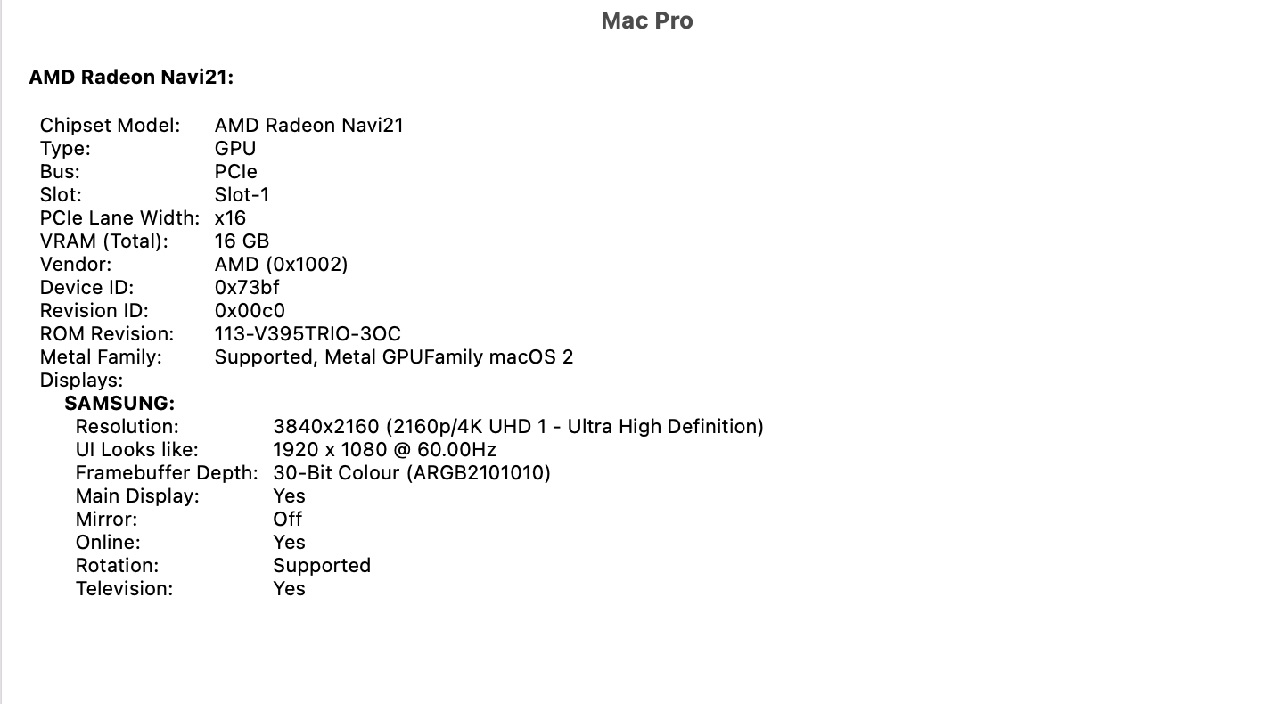

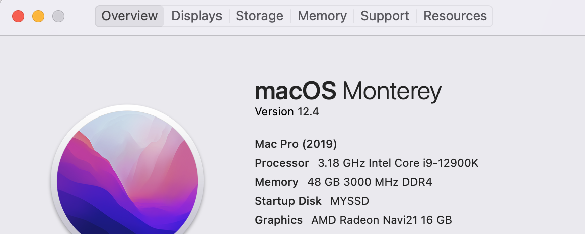

Another PC:
captura-de-pantalla-2022-05-22-a-las-17-40-32-png.548163
captura-de-pantalla-2022-05-22-a-las-17-37-13-png.548164
