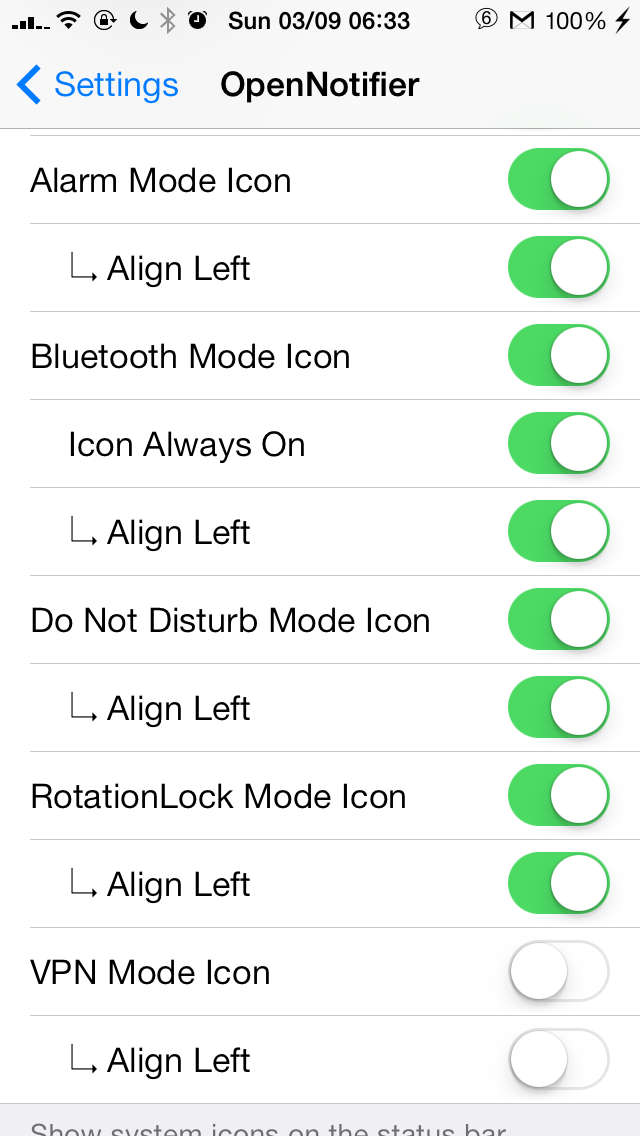

I probably shouldn't do this, in case I fail horribly and can't get the bugs worked out, but here's a preview of what I am trying to get working for the next version.
Alarm, Bluetooth, Do Not Disturb, Rotation Lock and VPN icons can all be aligned right or left. Since they will (hopefully) be controlled by OpenNotifier you will be able to manually replace the icons and hopefully (although definitely not in the next version) one day replace them through the OpenNotifier settings panel.
Also, possibly add Airplay and Airplane mode to the above list.
Icons with numeric counters that match the badge count (the speech bubble with the #6 in the screenshot below). I plan to include a counter icon for speech bubble and probably also one for mail envelope (depending on how it looks) and there will be a way that 3rd party icon pack creators can add new ones. It will allow numbers from 1 to 9. Anything greater than 9 will say 9+.
By nature of the size of the statusbar, though, the number is a little small when viewed on an iPhone.

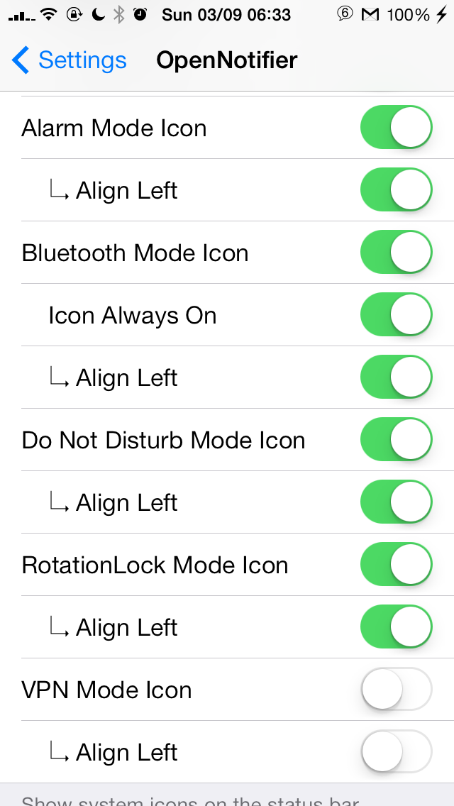

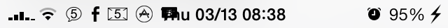

How do you get the signal bars like that on the top left of the status bar, can you share the name of the tweak please?

might be "Bars"
Yes. It is Bars. And I have a modified icon and Bolt handling the charging icon on the far right.
Does this happen to anyone else: if there are too many icons in the statusbar, they overlap with the time? I am guessing it happens to everyone. I can see exactly where it happens in libstatusbar. libstatusbar is supposed to stop adding new icons if it overlaps the time but, for some reason, it fails. I have a funky, hacked together patchwork fix that seems to maybe, kinda, sorta work.
