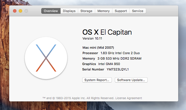

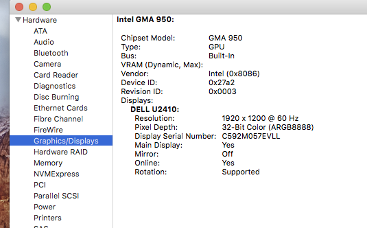

Quick update, put the GMA950 64bit Kexts from 10.6.2 into the El Cap on Mini 1,1 and they did their usual magic.
Not full acceleration, but better then nothing. Definitely sped things up. In System Profiler it now knows it is GMA950, but doesn't list a quantity of RAM. Will add screen shots later.
So if someone figures out USB thingy, will be as good/bad as past couple OS's.

Here are shots of GMA950
Hey, are you trying to use USB to create SATA or other way around?
Do you have a link?
I don't think they go that way but would be happy to be wrong.
View attachment 591298 View attachment 591297
