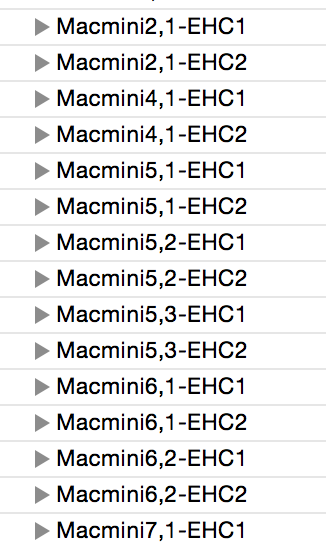

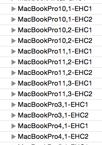

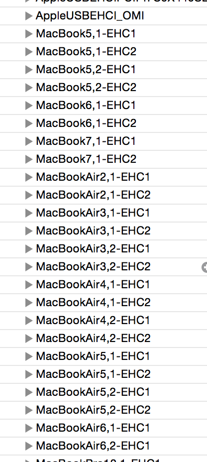

Answer to USB issue is likely here:
http://www.insanelymac.com/forum/topic/306777-guide-usb-fix-el-capitan-1011/page-1
I had a look in the kext, it lists all sorts of Macs and their USB ports. The first Mini in the list is 3,1.
In the images I have changed that to 2,1 but so far still no luck. (also changed name match inside kext to 2,1 as well)
But then I noticed that the 3,1 has 5 USB ports so using it's section is bad idea since 1,1/2,1 have 4.
Anyhow, a curious question is why the Mac Pro seems immune to this issue as it isn't defined in the kext either but works fine.
I would be happy to work with someone else on this, but tricky part is getting one of the EFI32 machines into csrutil disabled mode when you can't boot to recovery to initiate it in first place. This is the Catch 22 I mentioned earlier.
