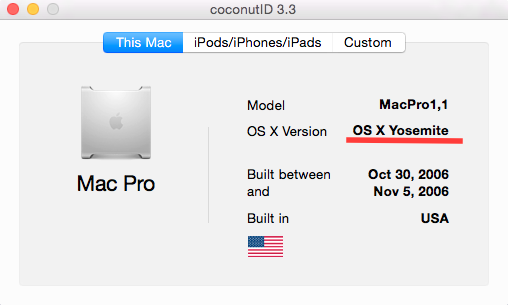

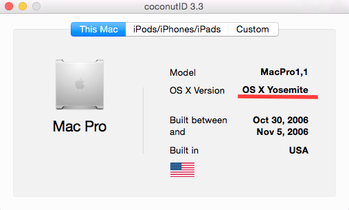

Talk about arriving late to the party (Mac Pro1,1 party) that is. :)
Just picked up this machine last week and after upgrading the memory and video card I spent a few days scouring the web and this forum mainly for info and how-to's.
Well here is my pride and joy as it sits today.
Thanks guys 'n' girls for all the helpful information on bringing this wonderful machine forward into this decade.
Runs very silently with dual SSD's in it.
Edit: Yosemite is my operating system of choice, I'm aware that El-Cap will also work.
