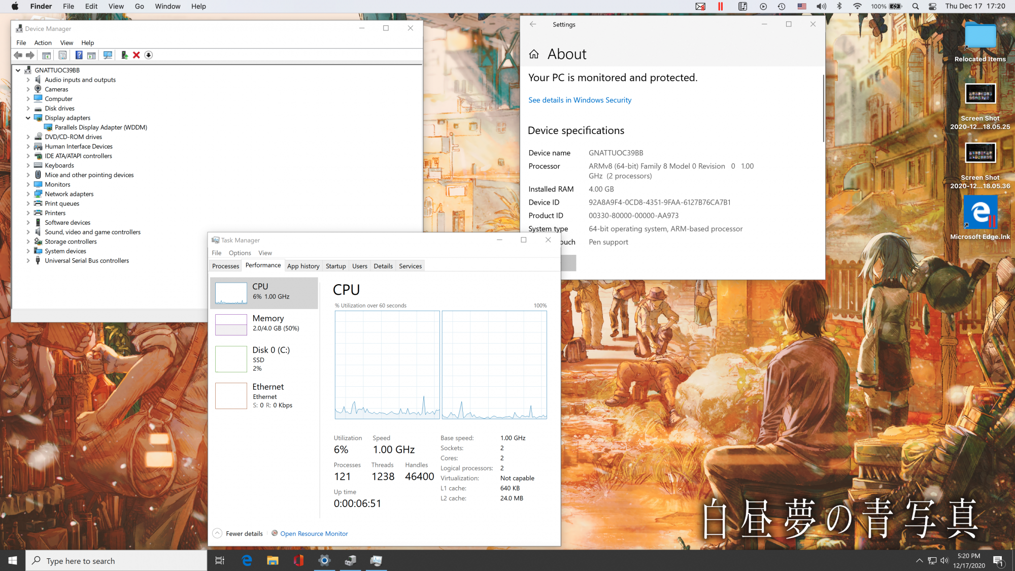

gpu acceleration?
Tried. Windows worked ok. My Arm64 Ubuntu 20.04 server it thought it was intel version.

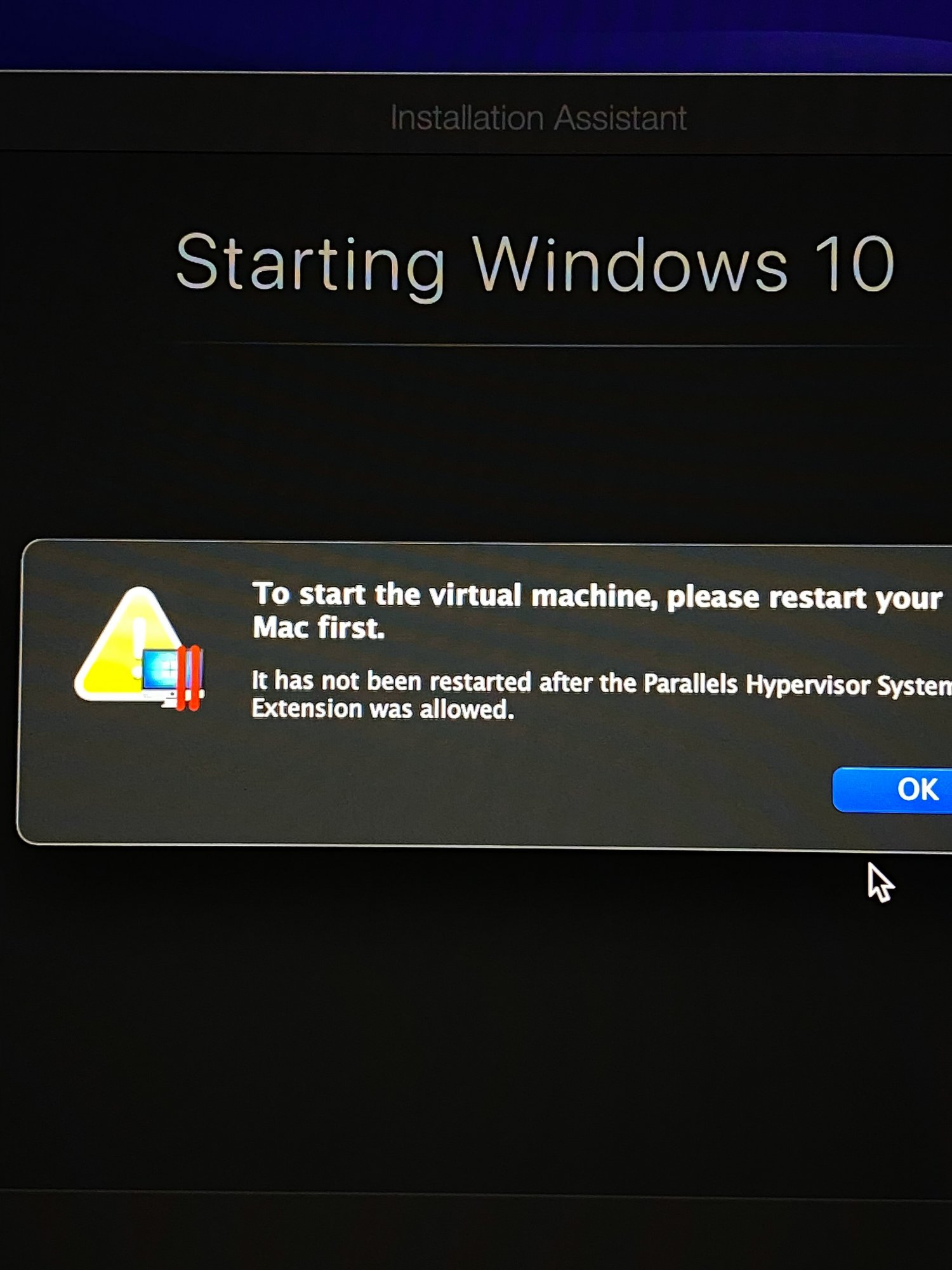

Has anyone succeeded with this (setting Parallels hypervosor in settings)? Restart does not help. Extensions are allowed.

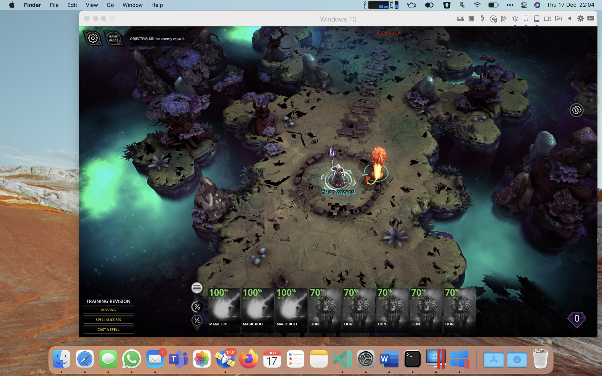

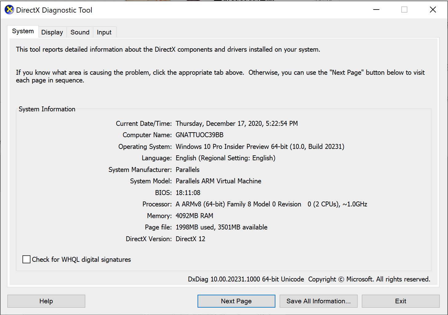

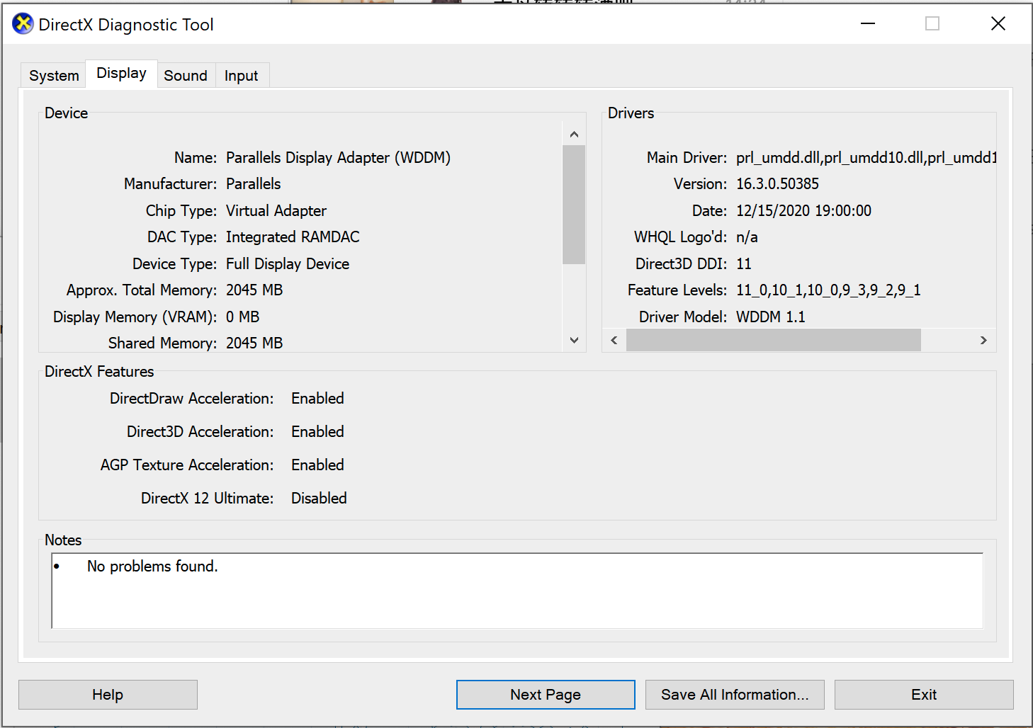

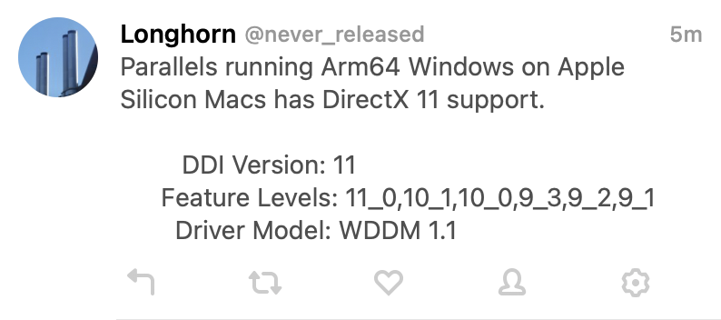

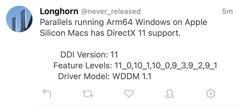

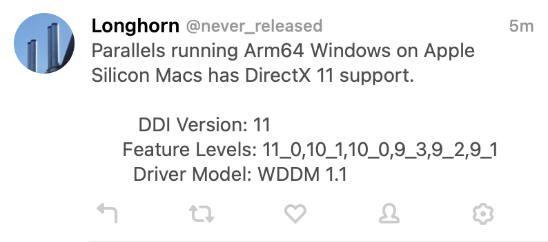

I don't know about performance(yet), but we do have DirectX acceleration
