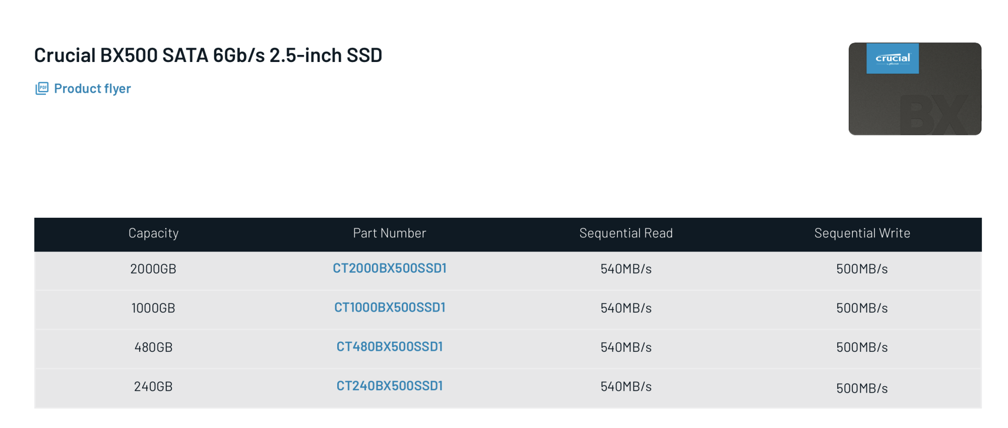

Corrected my read MB/s expections at #3,298 . Basically, the g2x1 controller will limit a 540MB/s SSD slightly (down to 450 MB/s) so maybe it's not too bad?

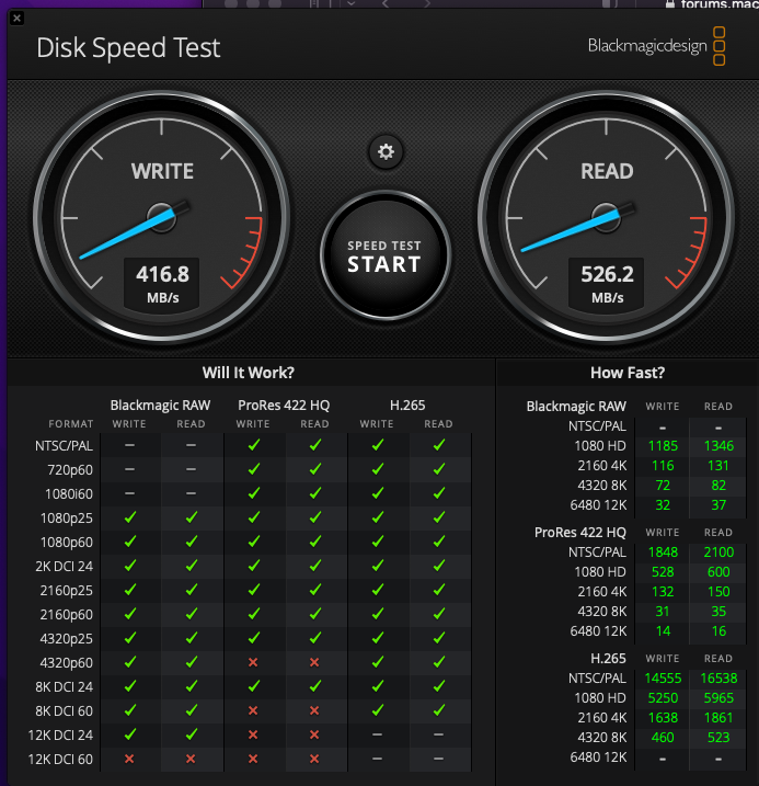

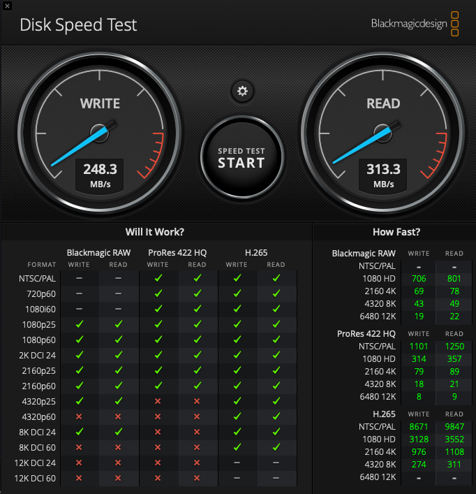

What does the Blackmagic speed test show for each disk?
313 MB/s is less than the 450 MB/s I expected but I think it's reasonable for the broken gen 2 x1 SATA controller. AmorphousDiskMark.app would return slightly higher numbers. If you can't replace the card, then maybe resoldering can work.
