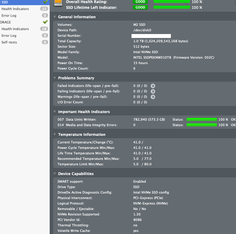

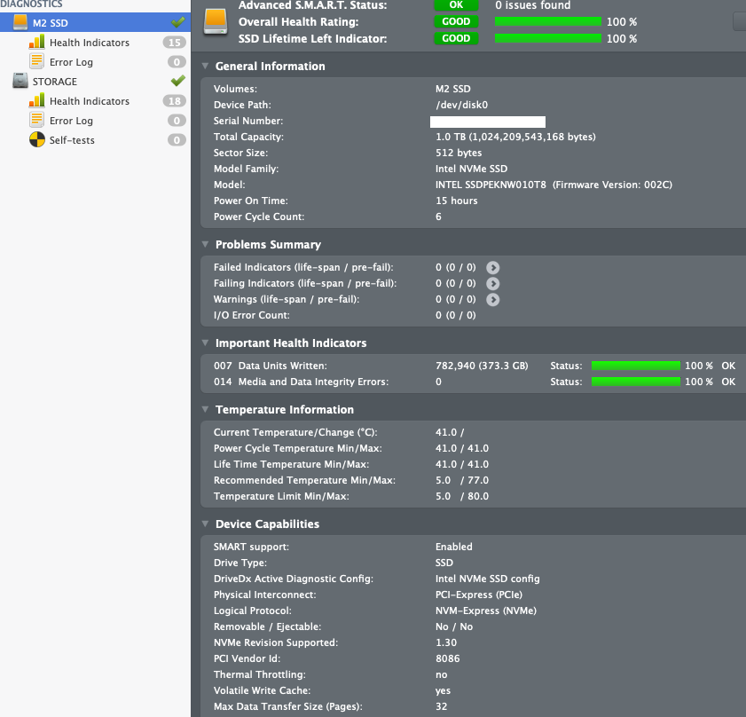

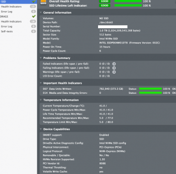

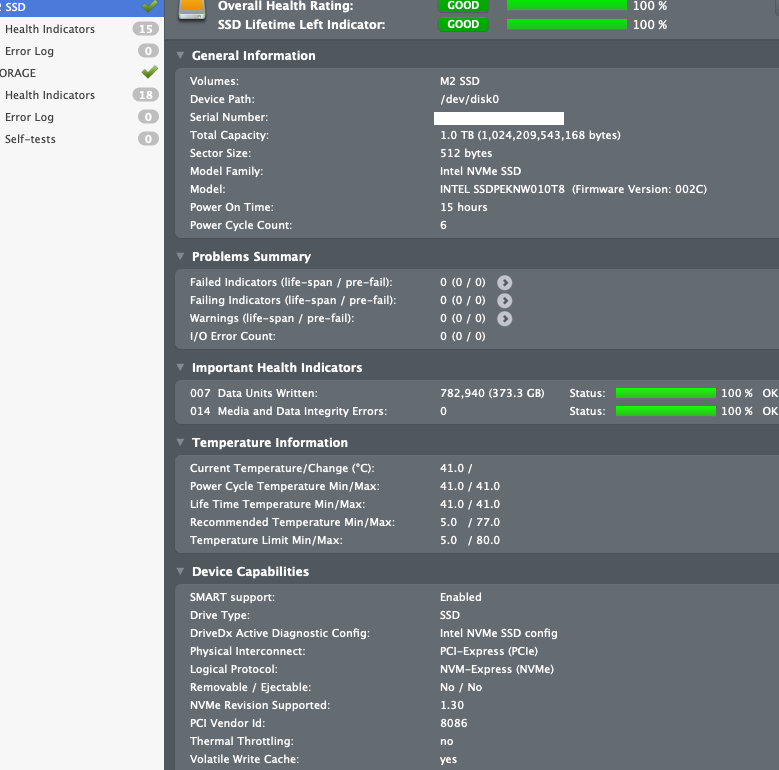

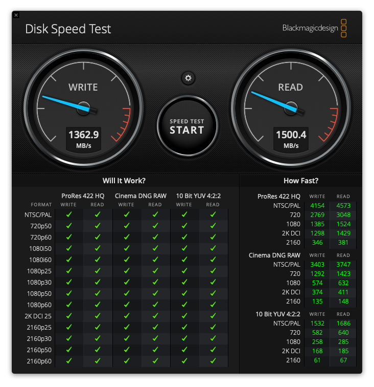

Saw a deal on Microcenter for a 1TB intel NVME blade for $110 that I couldn't resist.
https://www.microcenter.com/product...80-pcie-nvme-30-x4-internal-solid-state-drive
Picked it up because my Crucial P1 500GB NVME was filling up fast due to my Bootcamp partition. Newegg seems to be matching Microcenter's price if anyone wants a budget 1TB blade.
Running in Mojave on 140 bootrom using the Lycom DT-120 controller for about 2 days with no hiccups. The only notable difference between the Intel blade and the Crucial P1 is that the Intel is able to write about 500 MB/s faster than the Crucial P1 but the Intel blade runs 4 C hotter than the Crucial P1. Temperature readings taken after doing transferring 210 GB of data using Migration assistance from my Time machine backup.
Reactions: dabotsonline

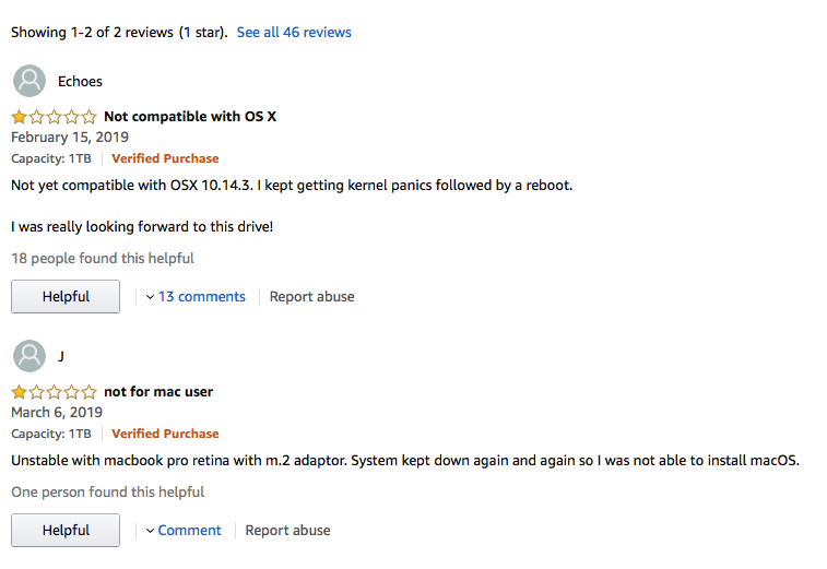

There are only two reviews referencing the macintosh on Amazon. I will be adding a third:
And with the second review, it's now apparent that it's not just the cMP 5,1 that's the issue.
Lou
