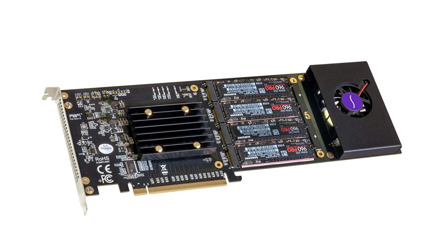

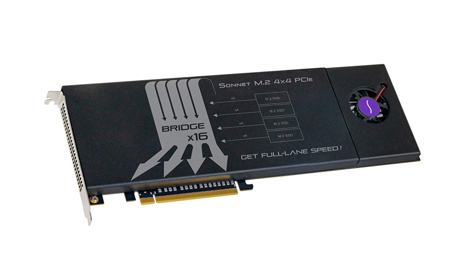

Hey guys, Sonnet has a new PCIe quad m.2 carrier on their site. I just noticed this. It's simply called Sonnet m.2 4x4 PCIe card. It's a PCIe 3.0 x16 card capable of 12,000 MB/s. I'm guessing it has a PCIe switch because the are targeting classic Mac Pro 5,1 along with PC desktops and Thunderbolt Chassis Mac/PC. They are saying it's compatible with 10.14.4+ only but I'm not sure if that's really BootRom related more than OS related. I'm hoping that if someone took the 140.0.0.0.0 update that it should work with High Sierra too. We won't know until someone can confirm that. I'm actually in the market for a new carrier and was set on the 7101A but I may step back and wait for someone on the forum to test the Sonnet card for performance and compatibly. If I can purchase it from somewhere with a return policy I'd be willing to test it and share the results, unless someone beats me to it.
Seems weird that they don't support dual side M.2 blades. My SM951-AHCI are dual sided, for example.
I didn't even notice that. I also have a few SM951-AHCI. If I get my hands on the card I can test if it's just "unsupported" or if it really doesn't work.
Can someone explain this line:
"When installed in a Windows PC’s PCIe 3.0 slot with four SSDs formatted in a RAID 0 configuration, the card is capable of 8,500 MB/s transfers. Aggregate transfer speeds from four non-RAIDed SSDs of up to 12,000 MB/s are possible!"
Shouldn't RAID 0 and Aggregate be the same?
I think it only uses software raid? Doesn't the Highpoint 1701A have hardware raid (only useable in Windows)?
They made the card full length (longer than the Amfeltec gen 3 carrier and the HighPoint 1701A) - probably longer than it needs to be - makes it slightly more difficult to install, takes more room, but gets extra support from some PCIe slots that have the full length support slots (like in the Mac Pro, or in the Sonnet Echo Express III-D).
They haven't posted a manual so I don't know what the inside looks like.
I think the card should work as well as any other M.2 carrier with a PCIe 3.0 switch chip. So the MacOS version shouldn't matter and it should work in the MacPro3,1 (with the work around to enable PCIe 2.0 speed as discussed in the amfeltec and Highpoint threads).
B&H has preorder at $400:
https://www.bhphotovideo.com/c/product/1449881-REG/sonnet_fus_ssd_4x4_e3_fusion_ssd_m_2_4x4.html
Hard to tell without more info, but from photos/renders it does seems they tried to keep this as "slim" as possible. Wonder if that was for any particular reason. Most PCIe TB enclosures have plenty of room, so do PC desktop towers.
https://www.sonnettech.com/product/m2-4x4-pcie-card.html
Sonnet made some very weird design choices here, starting with no support for dual side M.2 blades and the length of the card.
Seems that the blades don't have a heatsink, with only the PCIe switch having one. If so, the fan will have to move much more air, with more noise and less durability. I don't like it. Manual shows that the blades have a heatsink, but it's not integrated with the cover, like High Point cards.
