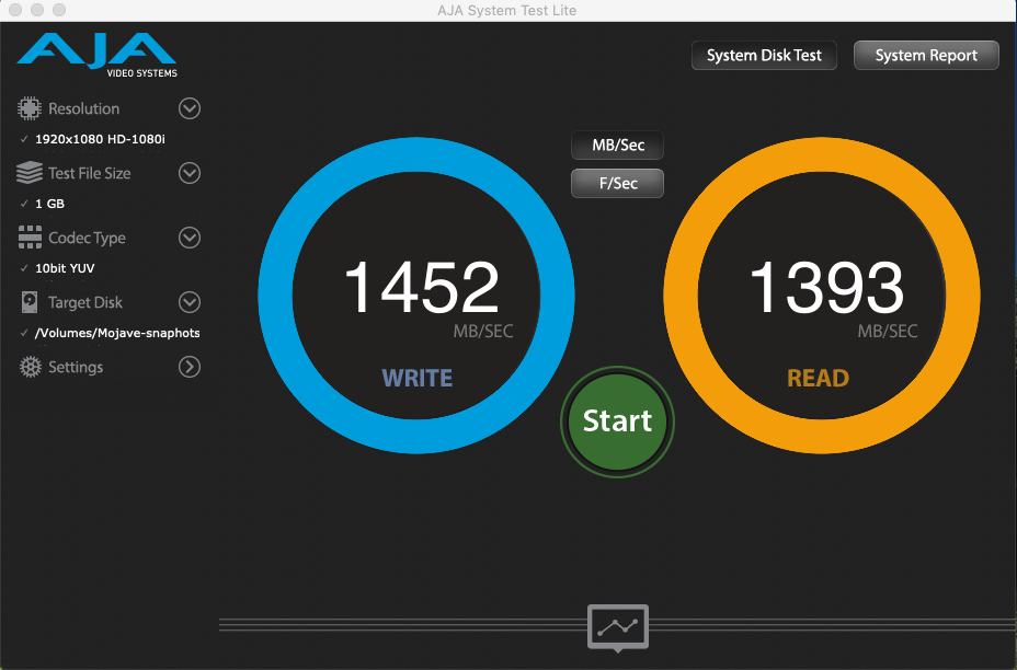

My new sabrent blade looked really good at first, until I installed a system on it.
newly partitioned..............................................................................new Mojave install...
View attachment 849470 View attachment 849471
Let the drive idle a bit. Sometimes a fresh install needs time to index. Also, make sure you have Trim enabled and showing for the new SSD.
After all that rerun the test. Also, download and run AmorphousDiskMark instead.

Initial cache/indexing of NVMe can take awhile. Even from clone it is usually at least partially rebuilt. Regardless of spotlight enable/disable, there is indexing that takes place within the OS. Leave running for 2-3 hours and then re-benchmark. Every single primary OS SSD I've setup (SATA, PCIe SATA and PCIe NVME) all show better results after whatever background indexing takes place.
2-3 hours, how about almost 24?
Write speed is still piss-poor compared to the first few tests.
