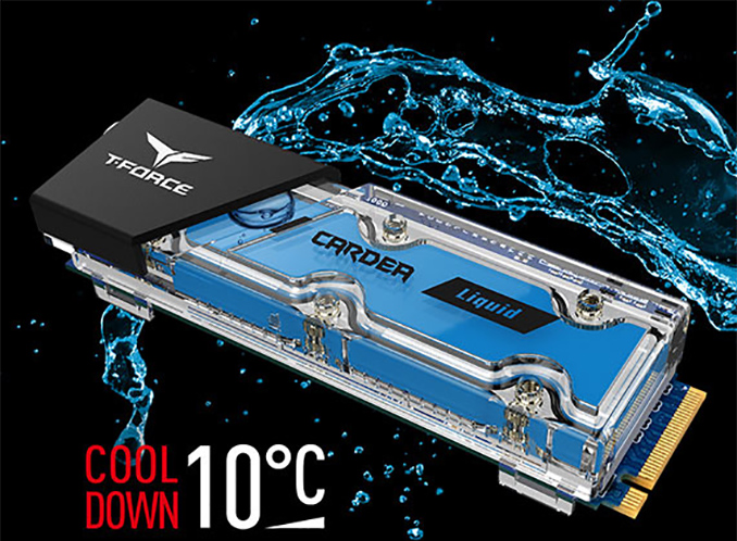

Stupid SSD of the day, TeamGroup closed loop water cooled M.2.
Now you can brag that you have a M.2 closed loop water cooled SSD. Enormous 10ºC down compared with a M.2 without any heatsink.
Team Group’s T-Force Cardea Liquid: A Liquid-Cooled M.2 SSD

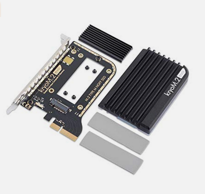

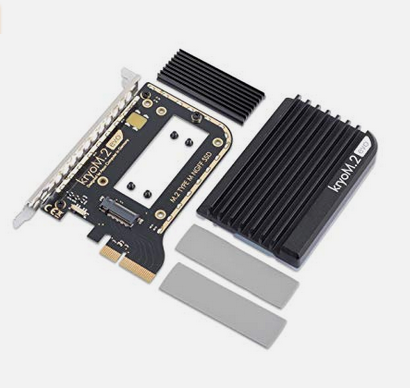

Btw, AquaComputer has a open loop version of kryoM.2: kryoM.2 PCIe 3.0 x4 adapter for M.2 NGFF PCIe SSD, M-Key with water block

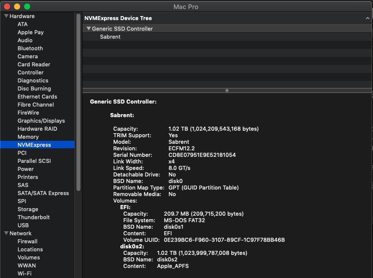

Another stupid question. Can someone explain how when I do a systems report and look at NVMExpress that is has the NVMExpress Device Tree and has two volumes: First Volume is an EFI: with MS-DOS FAT32 for 209.7MB and another volume which is 1TB and Apple-APFS? What is the Dos Volume for?
EFI partition.
Reactions: yukdave

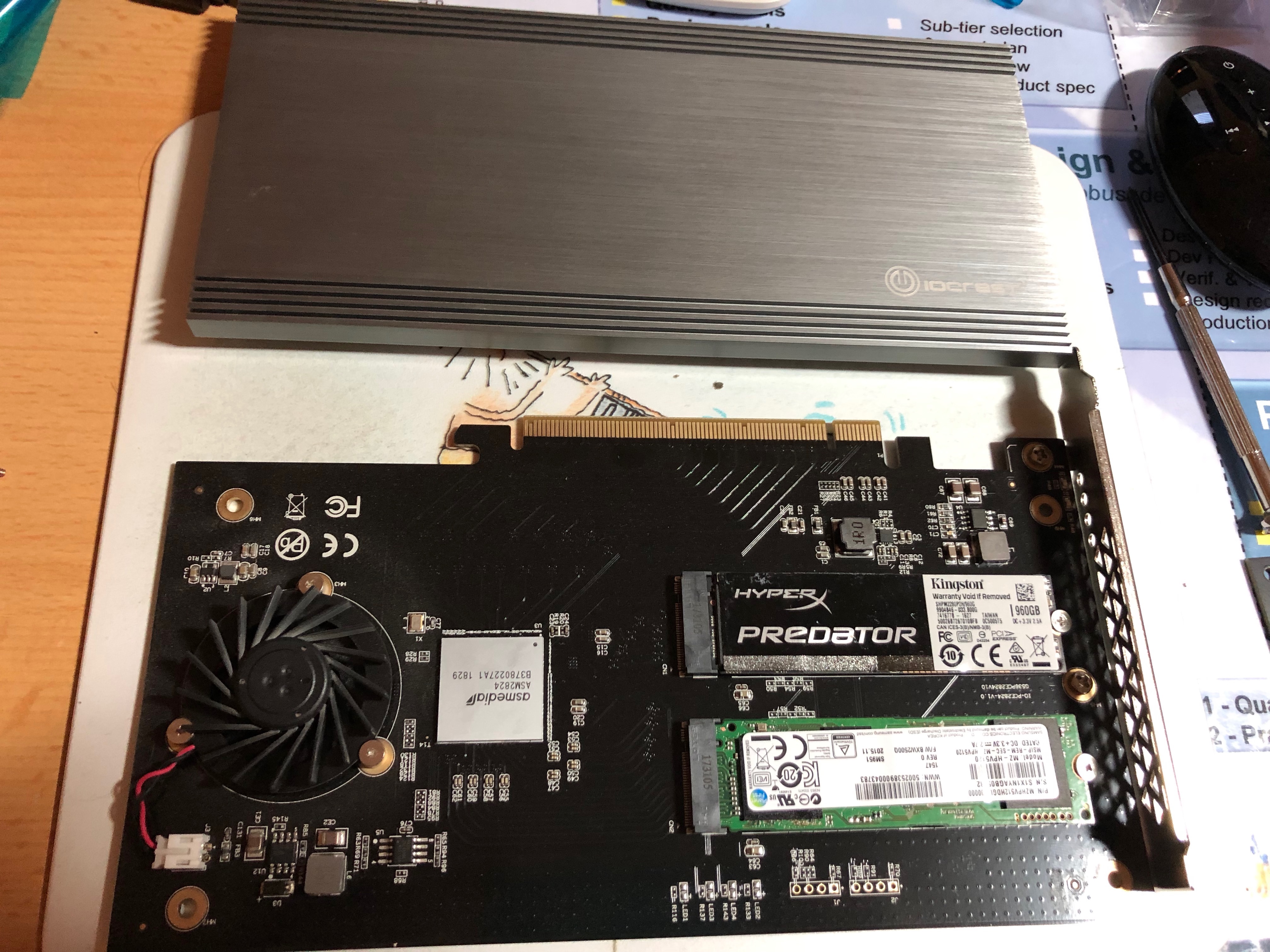

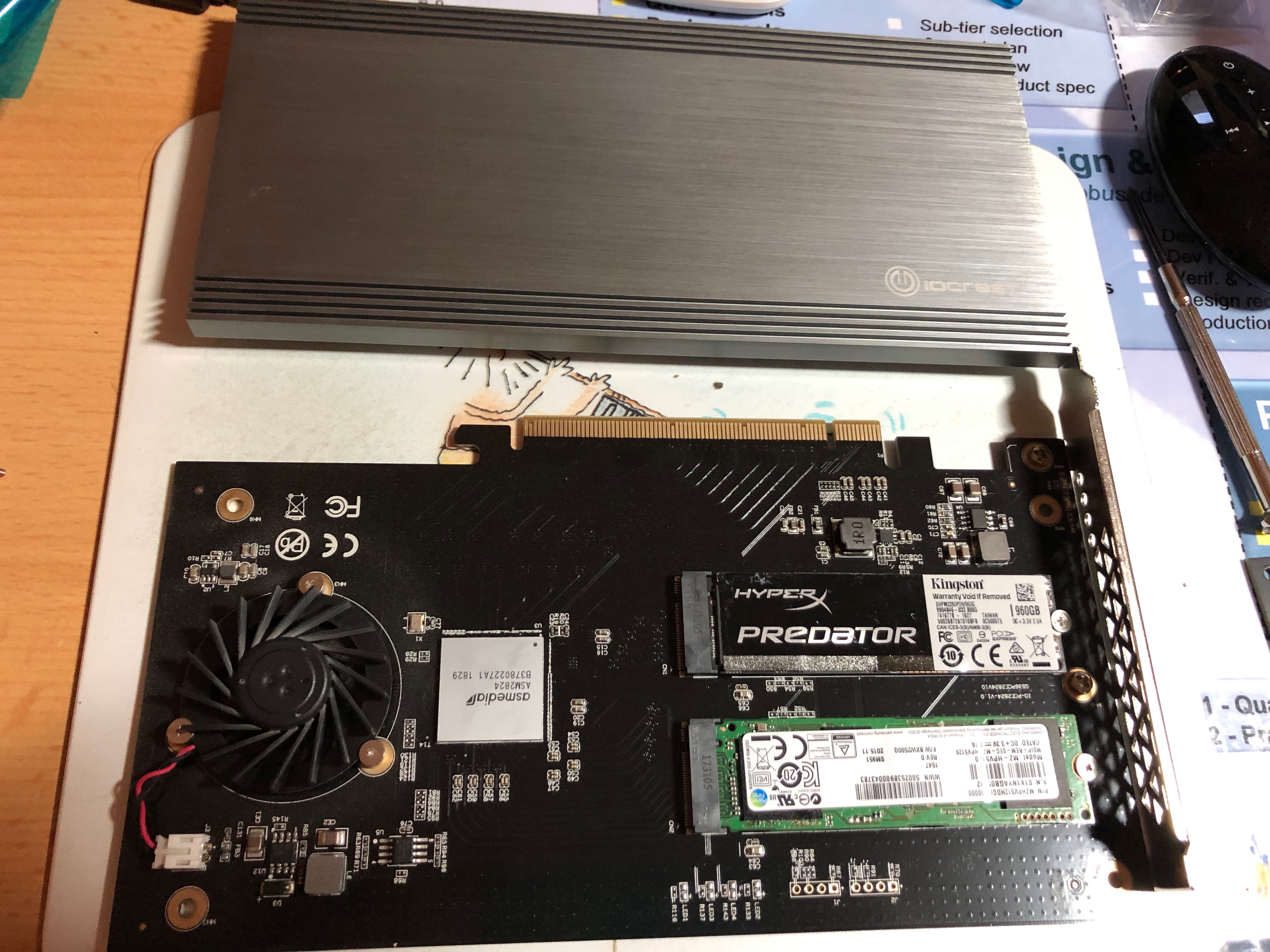

I run a dual AHCI Blade setup for more than a year now. The most important findings are:
#1 Although very reliable so far, those blades produce a big amount of heat. Only go with an adapter card that has a large tricked out heat sink/cooling system or upgrade it yourself.
#2 With limited PCI slots in the tower, chose at least a dual-slot card if possible. My choice was this card here, I can vouch for it working flawlessly in my 5.1 as a boot volume.
https://www.sybausa.com/index.php?route=product/product&product_id=992
more reading just in case
http://www.xlr8yourmac.com/feedback...rds/Syba_Dual_M2_NVMe_PCIe_MacPro_Review.html

I combined both information and ended up buying a 512GB XP941 with a Aqua Computer kryoM.2 evo.

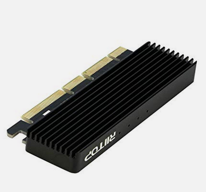

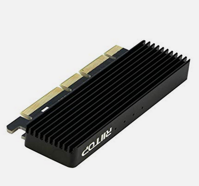

I can also recommend this inexpensive PCIe NVMe adapter with integrated heatsink from Riitop, $18 on Amazon. If you're considering a Lycom DT-120, this seems like a better cooling alternative. The PCB has gold traces underneath where the SSD blade mounts, for heat dissipation on the back of the blade. It includes 3 thicknesses of thermal pads, which I cut up to mix and match over various height chips on the blade. (The Inland's controller chip is a little thinner than the memory chips). The heatsink doesn't clip or band onto the blade, it comes in two pieces that bolt together around the whole PCIe adapter and blade. The back of the heatsink rests directly on the back of the PCIe adapter PCB, and bolts to the front side of the heatsink, which has very tight tolerances in between the blade and the inside of the heatsink front piece. It doesn't bolt onto a PCIe rear slot cover, but uses the full x16 PCIe slot length and the locking bar for full-length PCIe cards to stay in place. Feels secure enough to me. It has a row of 4 dim blue LEDs that all blink simultaneously on drive activity. No switch to turn them off, but they shine through small holes drilled in the heatsink that could be easily covered up if desired.
For around $130 all-in for 1TB, I'm quite pleased with this crazy-affordable Mac Pro NVMe upgrade!
I've employed your advice and got the Riitop adapter and an Inland Premium drive. Mine is only 512GB, but it has the same controller as the 1TB model. Whole kit was around $80. Will be dropping it into my cMP 4,1 --> 5,1 when it arrives. My existing SATA SSD is rather anemic by comparison. It's pulling about 250MB/s w/r. I'm hoping it picks up the pace on my photography hobby. Paging through 20MB RAW files is pretty sluggish right now.

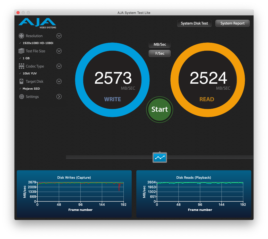

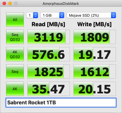

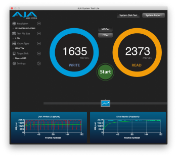

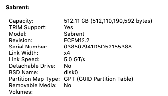

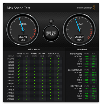

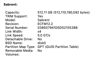

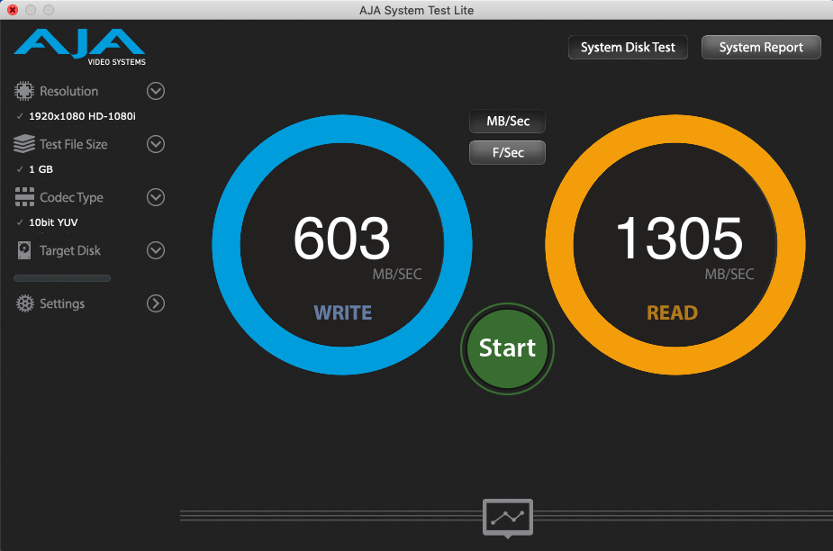

My new sabrent blade looked really good at first, until I installed a system on it.
newly partitioned..............................................................................new Mojave install...
View attachment 849470 View attachment 849471

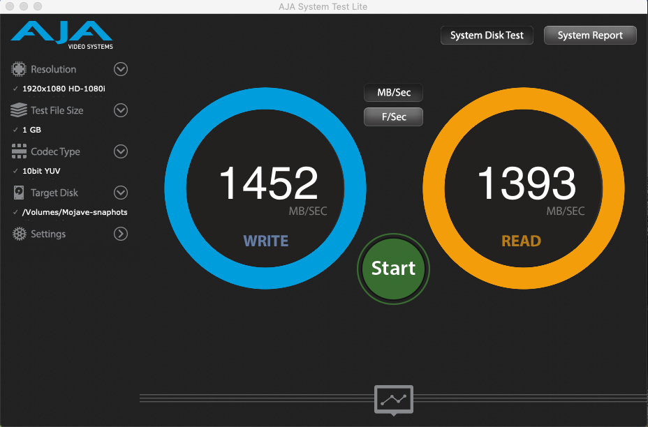

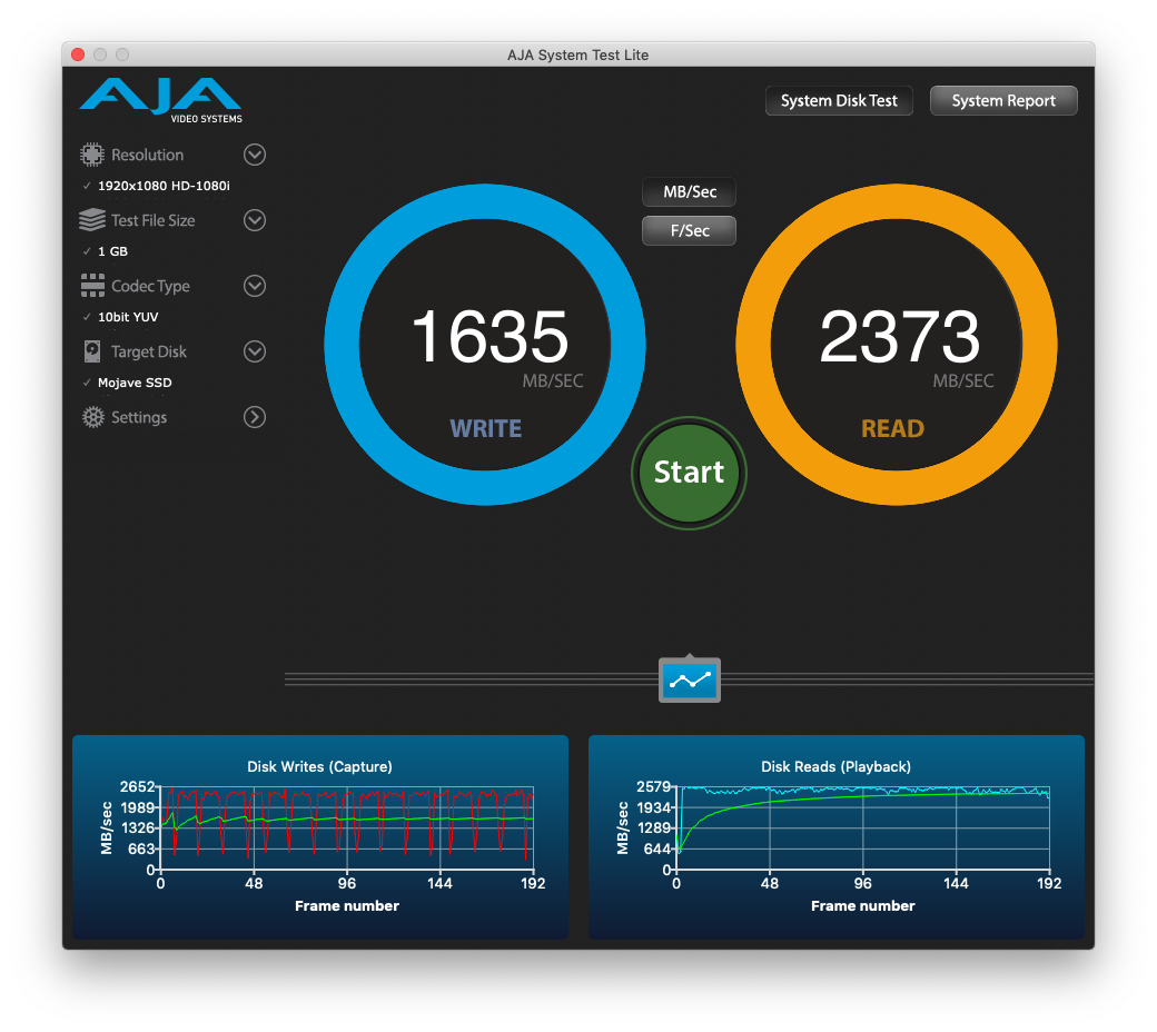

I just got the Sabrent Rocket 1TB too, I also see similar variable speeds if I repeatedly run the AJA test. I wonder why...
(Notice the spiky writes graph on the slower one.)

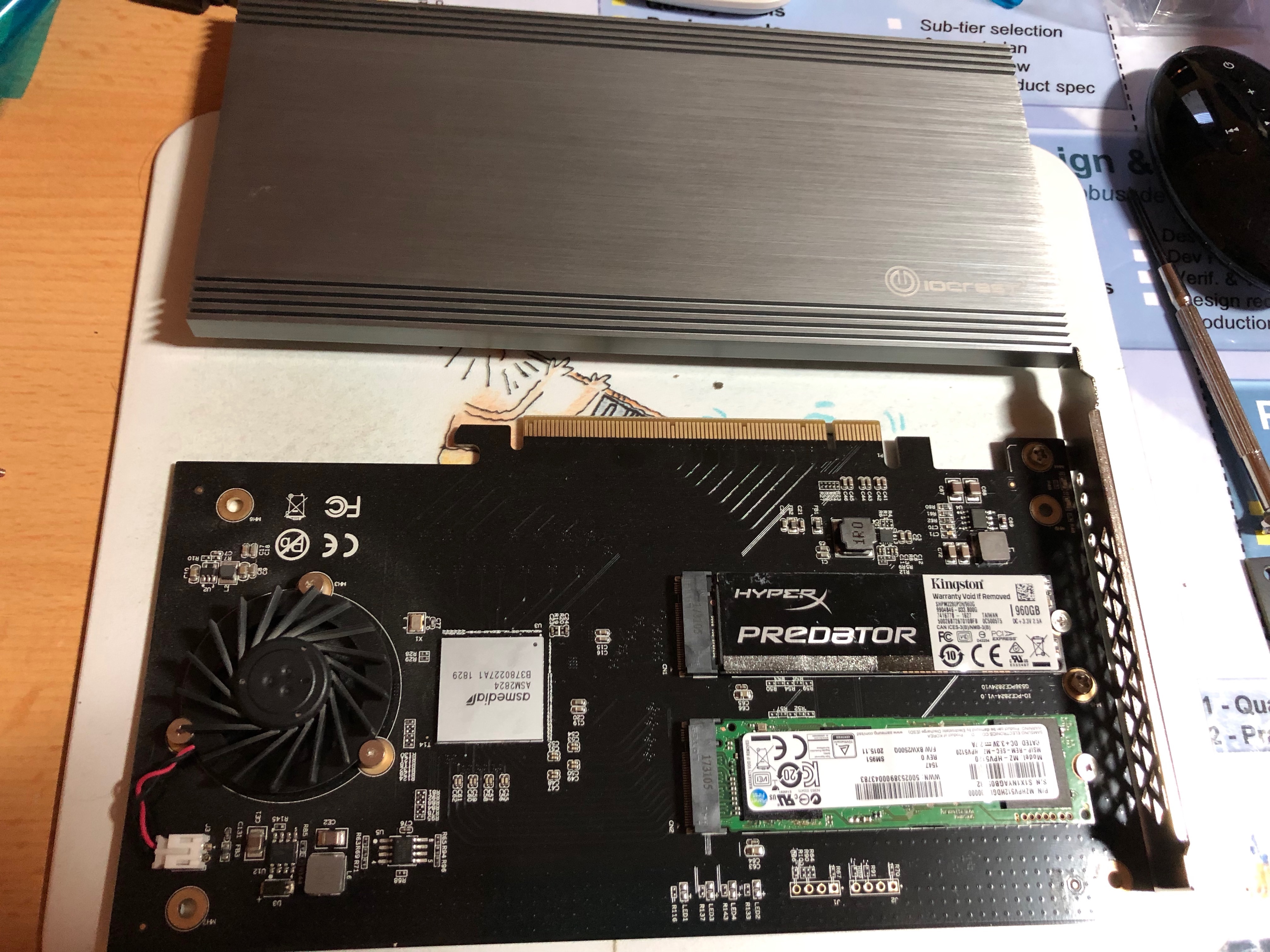

Regarding your other question about faster adapters, this is with the IO-Crest SI-PEX40129, I found one on eBay for $140. It uses x8 PCIe lanes for double the max speed of a basic x4 adapter.
Because it uses TLC NAND with a large cache of faster memory to achieve the fast speeds. AJA uses a continuous barrage of writes that fill the cache memory faster than it can dump to the NAND. This is when the speed drops. Once the cache is fully dumped, you should see the speed increase again. I doubt you are experiencing thermal throttling but that too may be happening, keep an eye on your temps to verify there isn’t going to be a problem with this.
I don’t like AJA because it wears out the TLC NAND cells while all this is going on. TLC isn’t designed to be used like this...
Test your TLC blades with AmorphousDiskMark. It’s free and uses short bursts that don’t exhaust the cache so relentlessly. You shouldn’t be doing a lot of benchmarking with TLC NAND in my opinion.
MLC NAND like that in the Samsung 970 Pro won’t show this fluctuation but it costs a lot more. Even so, you still shouldn’t be using AJA excessively on any type of SSD. Stick with AmorphousDiskMark, Do each test independently (instead of selecting ALL), write your numbers down and put it away for later use if needed.
An initial test is fine for a new piece you just added, and again after you have loaded it up (for comparison). Then leave the benchmarks alone unless you need to check because of a problem you have noticed and it’s part of your diagnostic process...
MLC NAND like that in the Samsung 970 Pro won’t show this fluctuation but it costs a lot more. Even so, you still shouldn’t be using AJA excessively on any type of SSD. Stick with AmorphousDiskMark, Do each test independently (instead of selecting ALL), write you numbers down and put it away for later use if needed.
DISCLAIMER:
I’m a user, not an expert. My opinions are my own. Someone around here will invariably jump in to tell you how wrong I am. For that reason, instead of arguing with me, just respect that this is my personal experience and opinion on the matter. Take it or leave it...

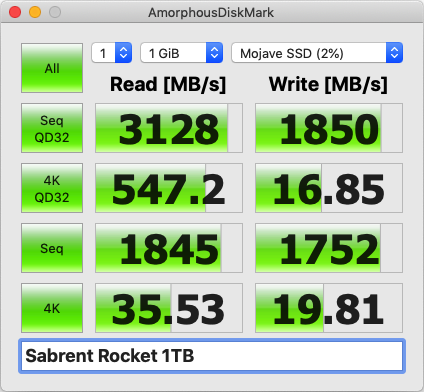

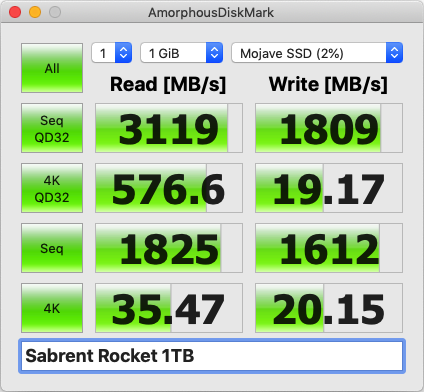

Thanks for the tips, it makes sense. I ran AmorphousDiskMark twice (I promise I'll stop after that) and got pretty consistent results.
Planning to keep this TLC Sabrent as an OS / apps drive and hopefully add an MLC Samsung 970 Pro for media / scratch drive for video editing.

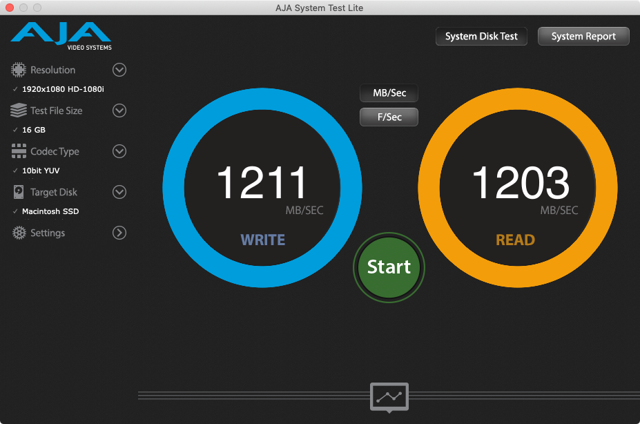

happy to report that I fitted a Sabrent Rocket 1TB NVMe M.2 SSD to my MacPro5,1 via a M.2 adapter without any issues yesterday :) I was able to clone over my Mac OS install from my old 64GB SATA SSD and it booted right up without any issues (running the 144 BootROM on my MP5,1 of course)
the system has been booted since I installed the drive last night, doing relatively IO intensive work as I moved and migrated my data around (I Have moved my 300GB Virtual machine library onto the drive) and nothing has crashed so id call that a success :)
heres the speeds I get on a 16GB file size
im very happy with everything especially as I was coming from a rather slow 64GB SATA SSD!
