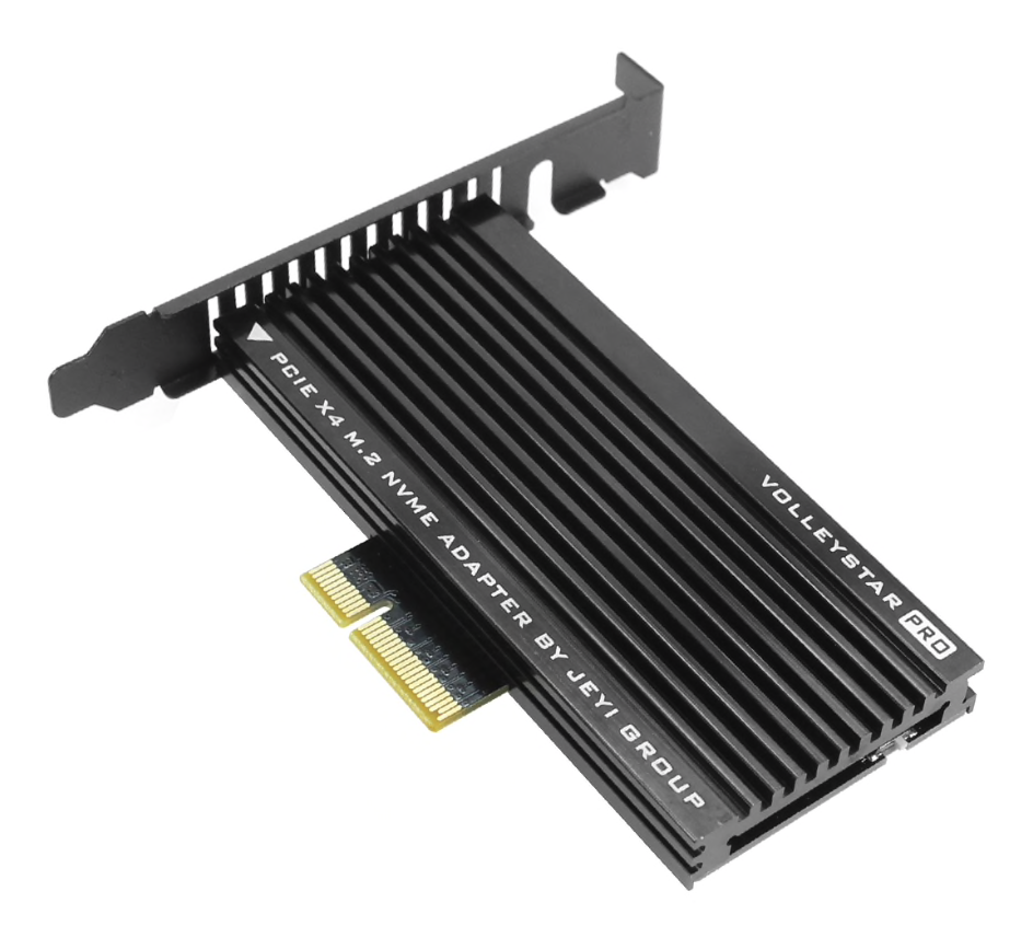

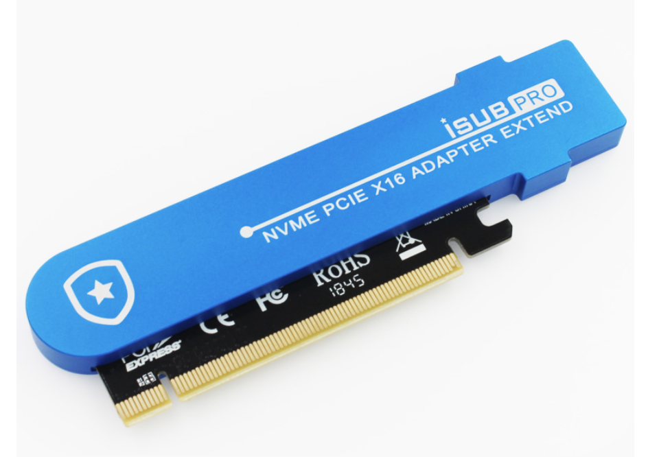

I will test an 970 EVO with these adapters, just ordered them.
JEYI VolleyStar-PRO
https://www.aliexpress.com/item/32888030841.html?

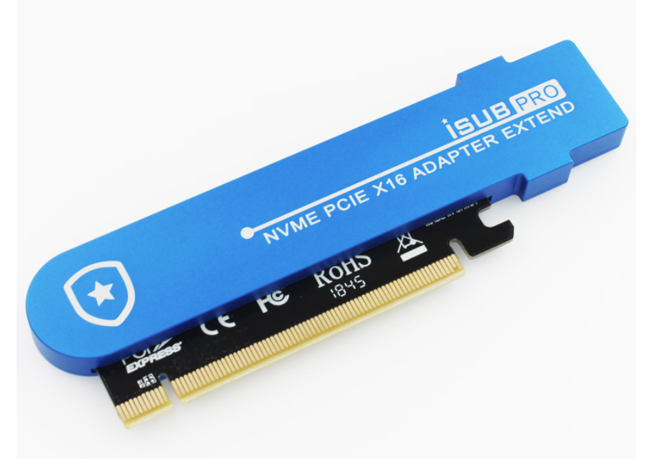

JEYI iSUB PRO
https://www.aliexpress.com/item/32958058657.html?
Suitable for not touching the Sapphire RX 580 fans. The PCI connector is compatible with an x16 slot, but it does not have x16 functionality. The only pins connected on that adapter are for PCI 4x.

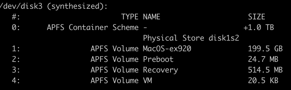

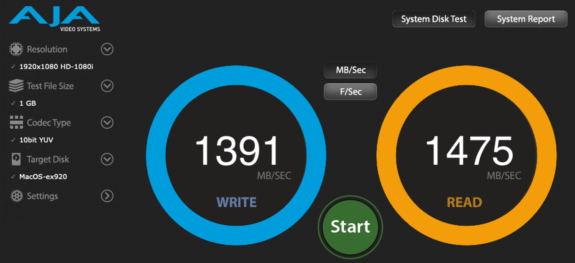

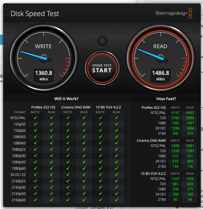

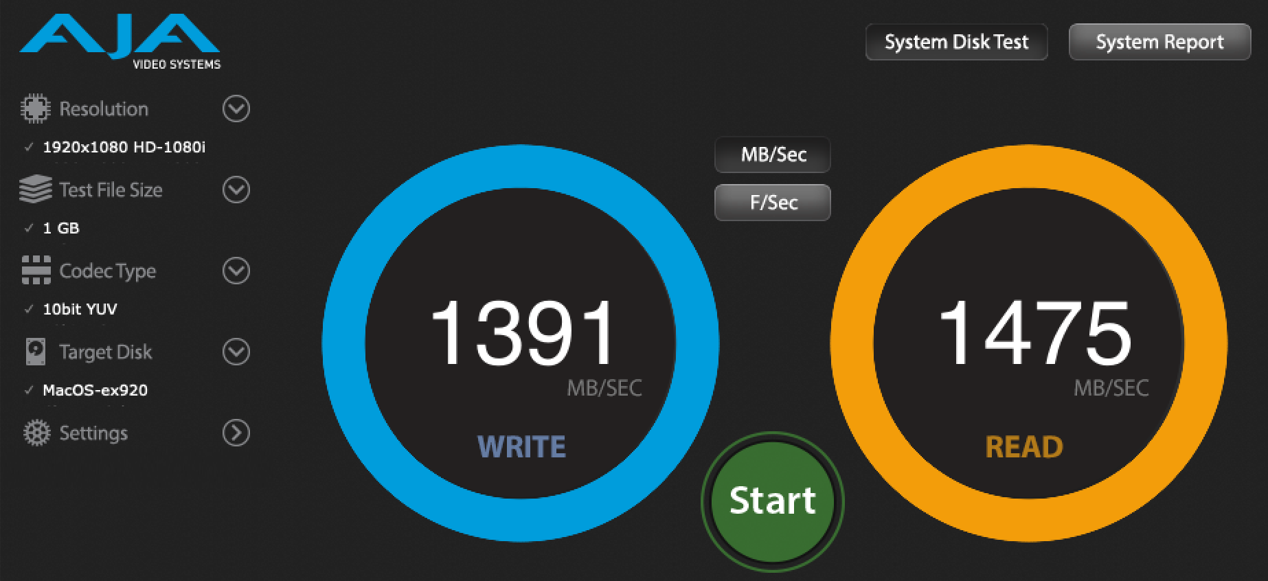

I've just install HP ex920 1TB (~109 USD from Amazon) with RIITOP (~18 USD).
I use carbon copy cloner to clone Mojave from my SATA SSD (MX500 1TB) and CCC automatically create recovery partition:
So far the temperature are good:
I use the thickest thermal-pad provided by RIITOP on top of the ex920 sticker (I didn't remove the sticker).
I remove the bottom metal plate (from RIITOP) to let some air cool (through the PCB holes) on the other side (opposite of the sticker) of the SSD which has some NAND flash.
Thank you for all who provide excellent information in this thread.

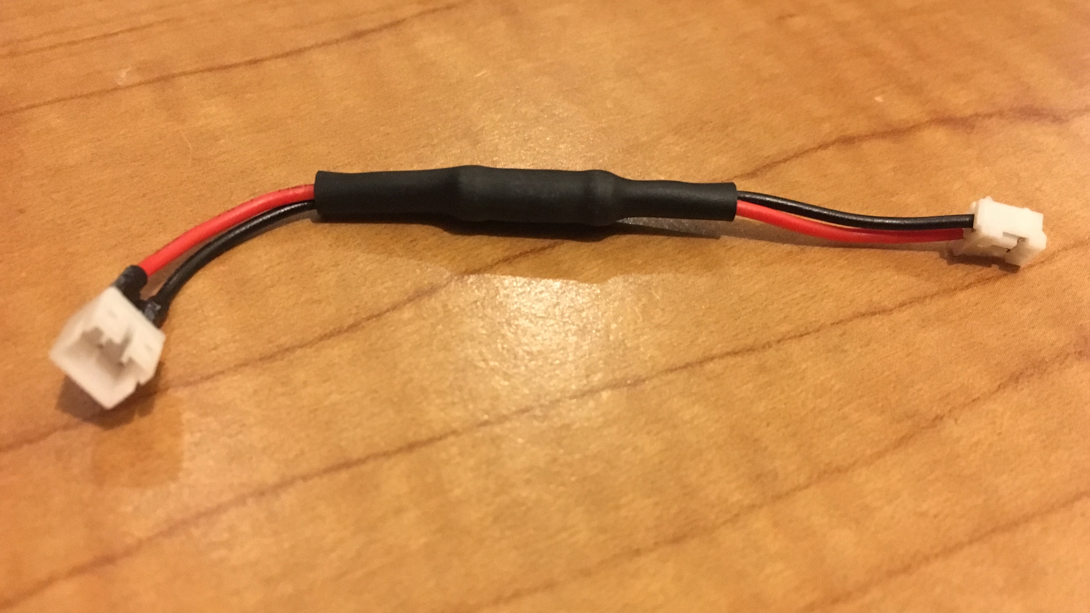

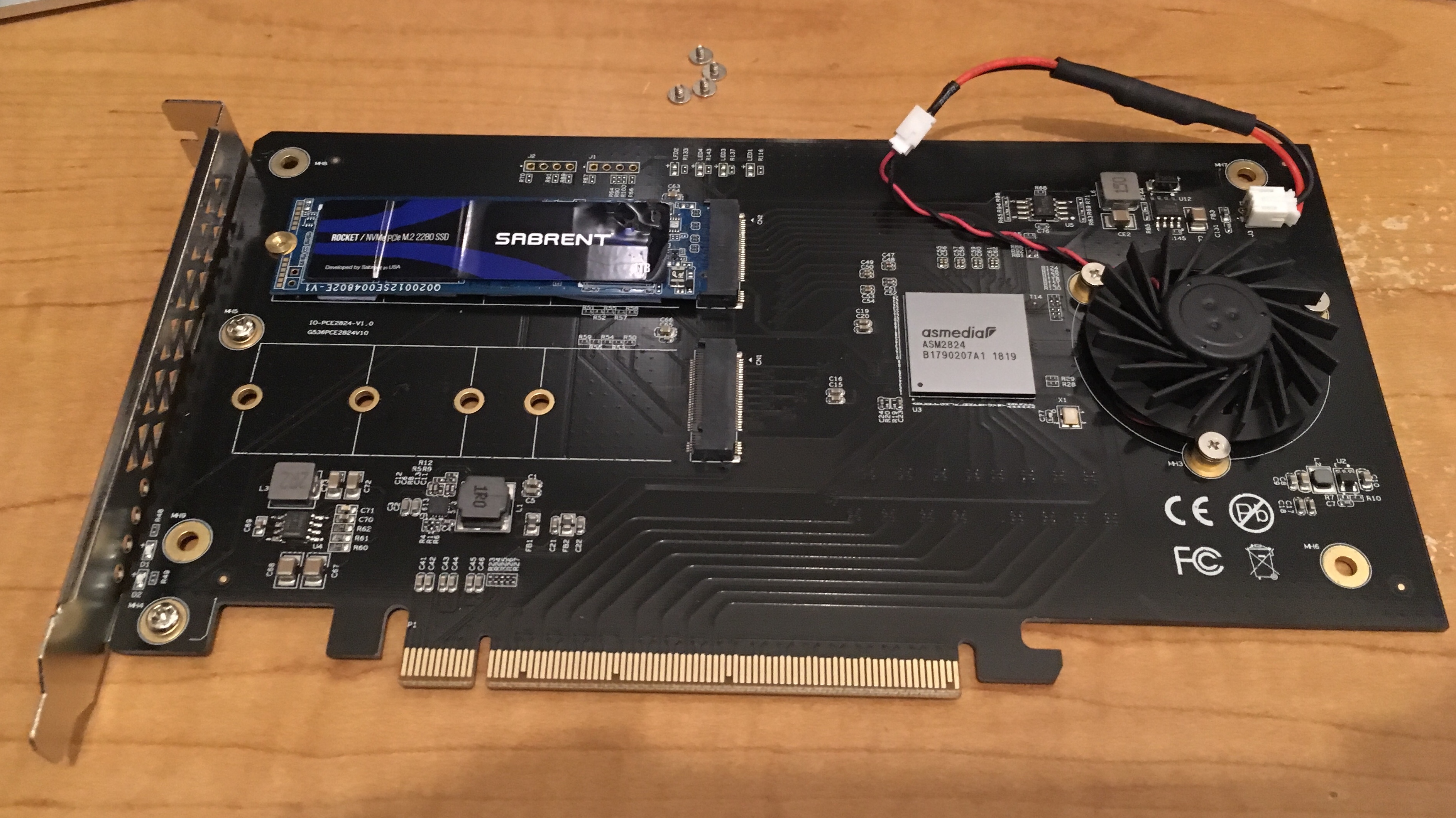

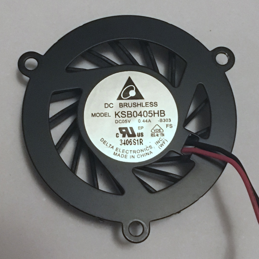

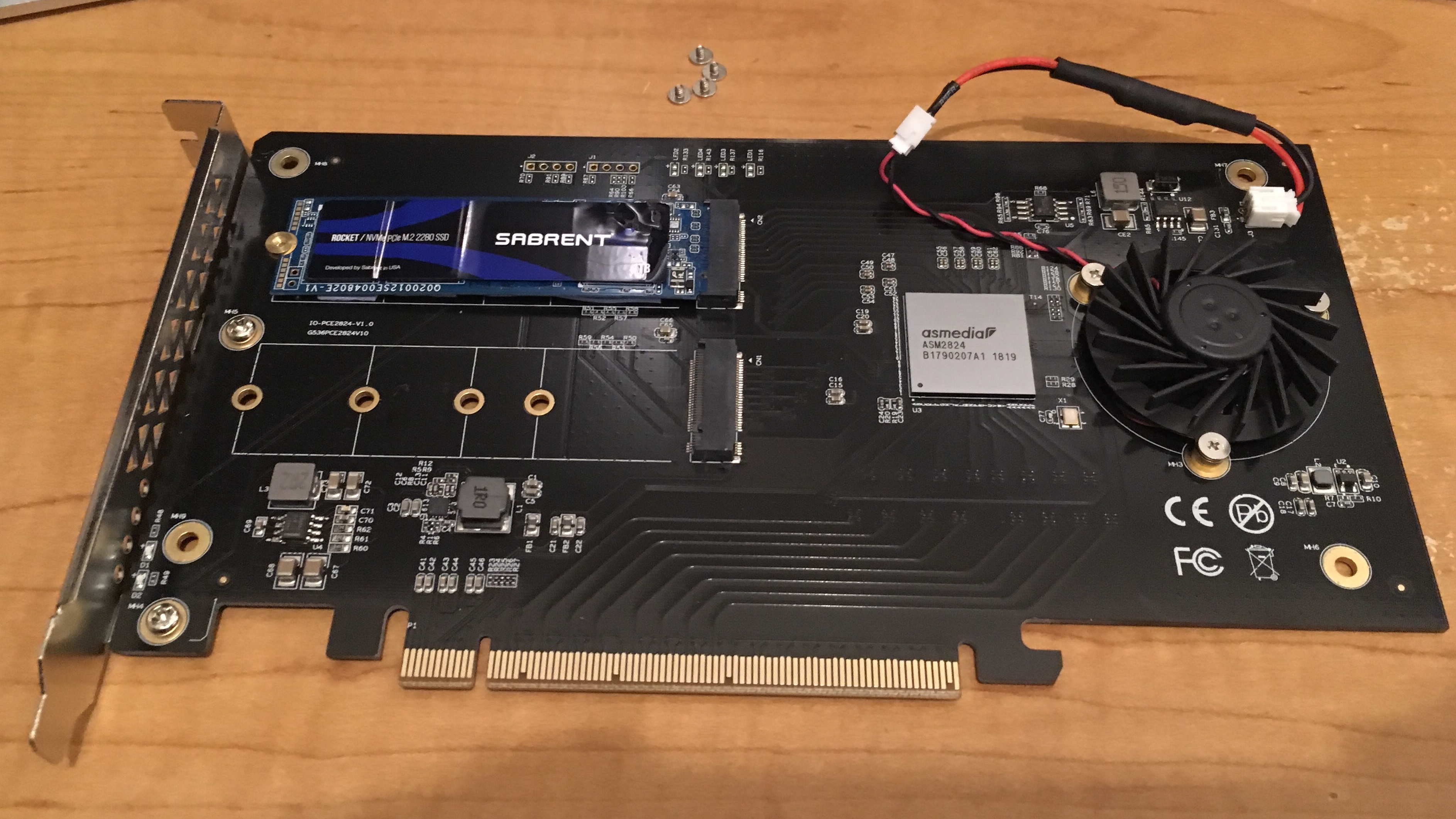

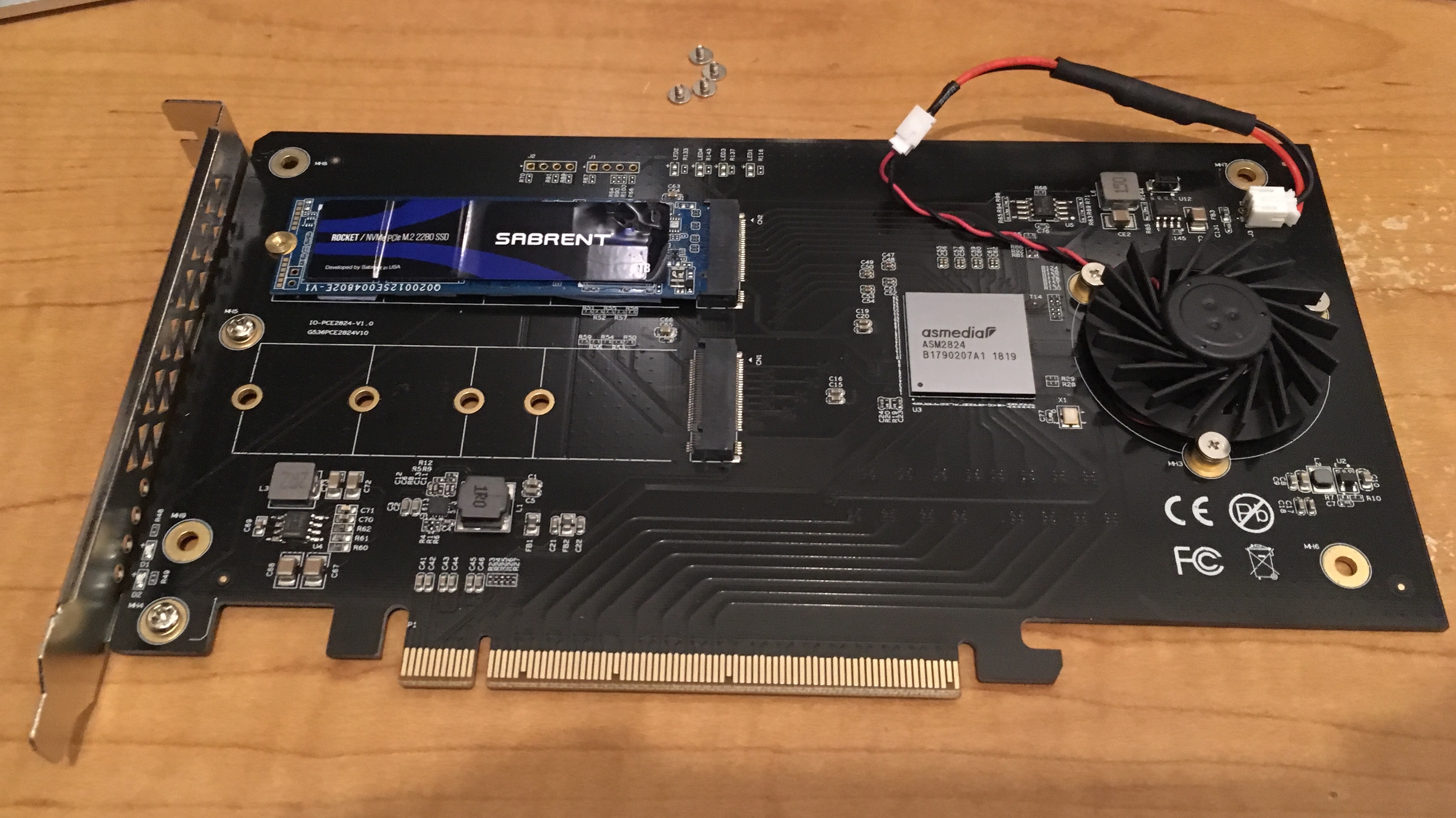

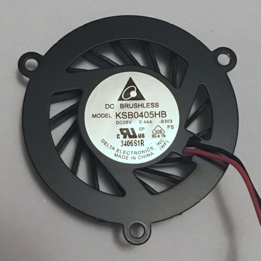

I was thinking of the Syba / IO-Crest SI-PEX40129 two-blade card which also has a noticeably loud fan. You've inspired me to open it up and see what part # the fan is. It turns out it's a Delta KSB0405HB, which is 40mm in diameter, 8.5mm high, with a triangular mounting bolt pattern. (datasheet)
A quick search of that very useful Digi-Key site doesn't turn up an alternative fan option of the same size. I wonder if anyone has looked into this...

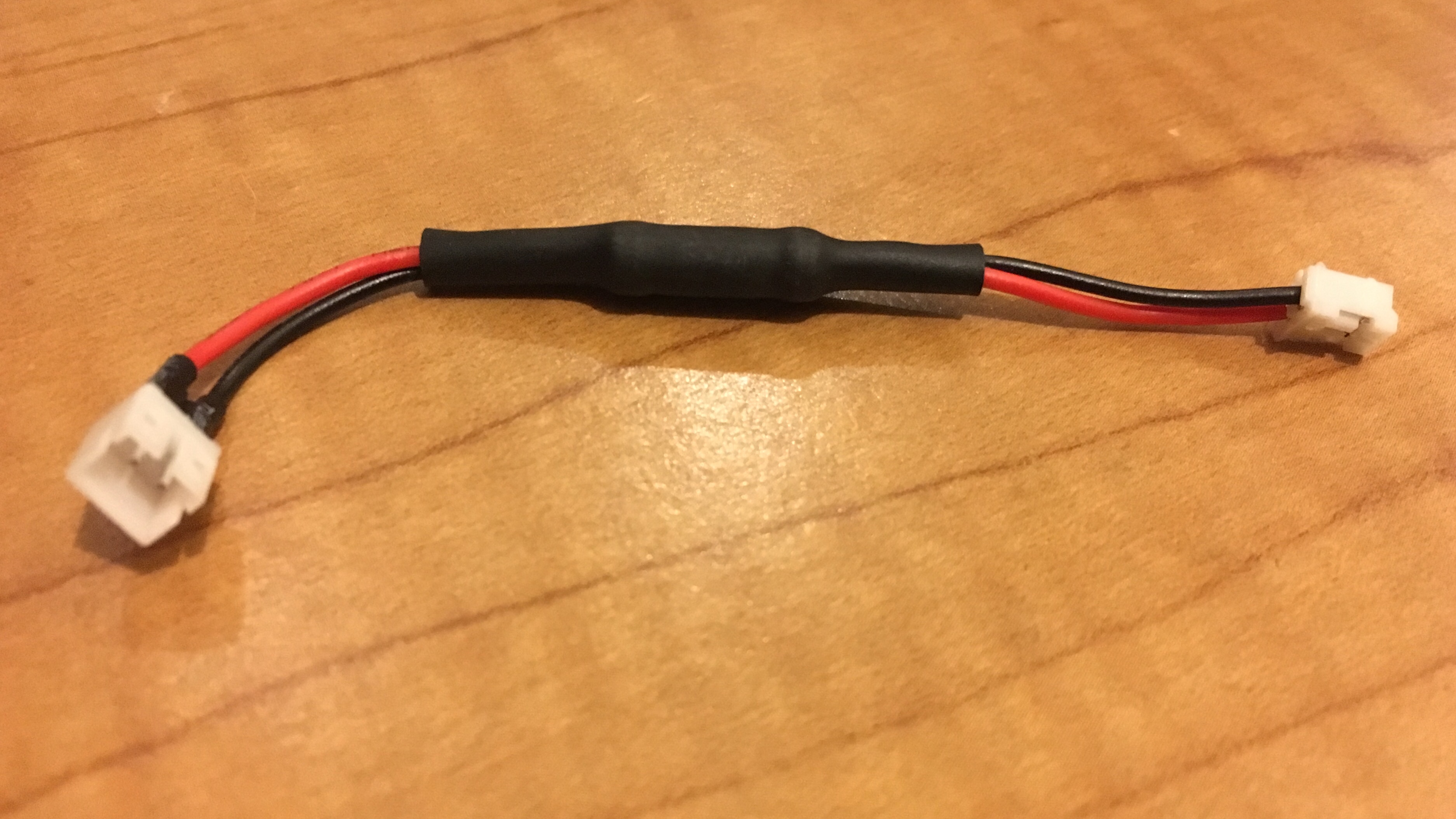

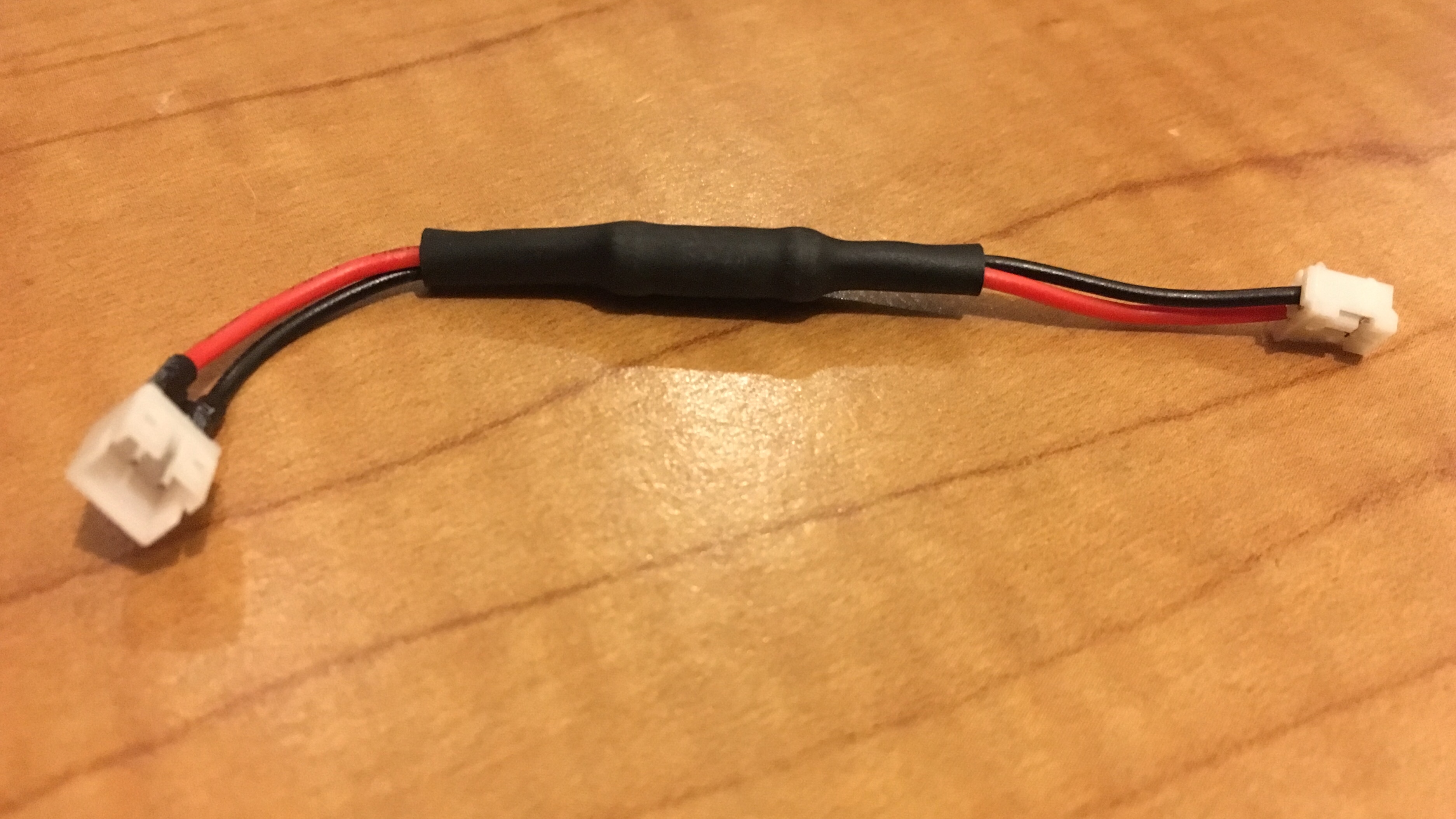

Here’s my solution to the noisy fan in the Syba / IO-Crest SI-PEX40129. It’s a 2-pin extension cable with an inline resistor to reduce the voltage going to the fan to make it run slower and quieter, supposedly by 30%. Only cost $5 for a set of two on ebay and arrived in ten days.
It works great, the fan noise is now effectively imperceptible over the case fans. So relieved. The thickness of the resistor and connector wouldn’t quite fit under the heatsink so I had to route the fan cable so the resistor was outside the heatsink, only minor quibble to an otherwise perfect solution.
Surely SSD temps will be a little higher than before, but I expect still better than most NVMe adapters with no fans at all! The case fan in front of the PCIe slots could be cranked up to compensate too.
4CD4F6CA-D488-40A7-BE0D-E4D1234CE03C.jpeg 542AC3E2-4445-4804-80F4-53A83DF1BE71.jpeg
View attachment 853918 View attachment 853919
