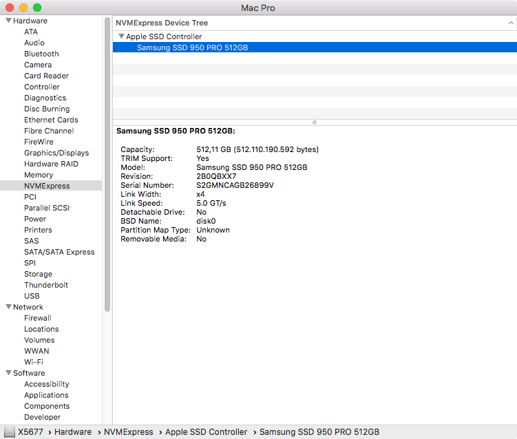

Just to remember:
Samsung 950PRO 512GB is NOT compatible with Mac Pro as a boot disk, only as a data/scratch one. Not even with the most recent firmware (2B0QBXX7).
The 950PRO incompatibility to MP5,1 is so weird that if I do clear the NVRAM, I have to remove the PCIe adaptor from the Mac or I can't boot from the other disks. If you set another disk as the boot drive, the 950PRO can be used as a data drive - until you need to clear NVRAM…
Another thing, if the 950PRO is installed, boot picker stops working, just a white screen - and that happens even if you don't have the NVMe EFI module injected.

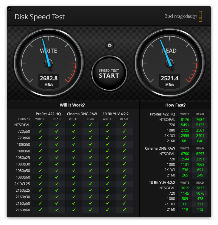

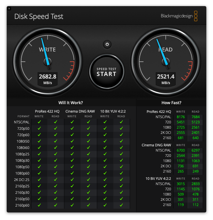

Sabrent 1TB NVME + IO CREST fitted, results for 5GB file below.
Reasonable speeds I would suggest, anything that I should adjust tsialex to gain any further improvement?
Fan is a bit loud, but have seen people replacing that or disconnecting.
I think you already at the limit with this blade with TLC NAND, a Samsung 970 Pro can get you to the limit of the ASMedia PCIe switch, around 2950MB/s to 3000MB/s.
Thank you, that's what I expected - not bad from the Sabrent and not sure the additional £160 is justified given the modest gains.
