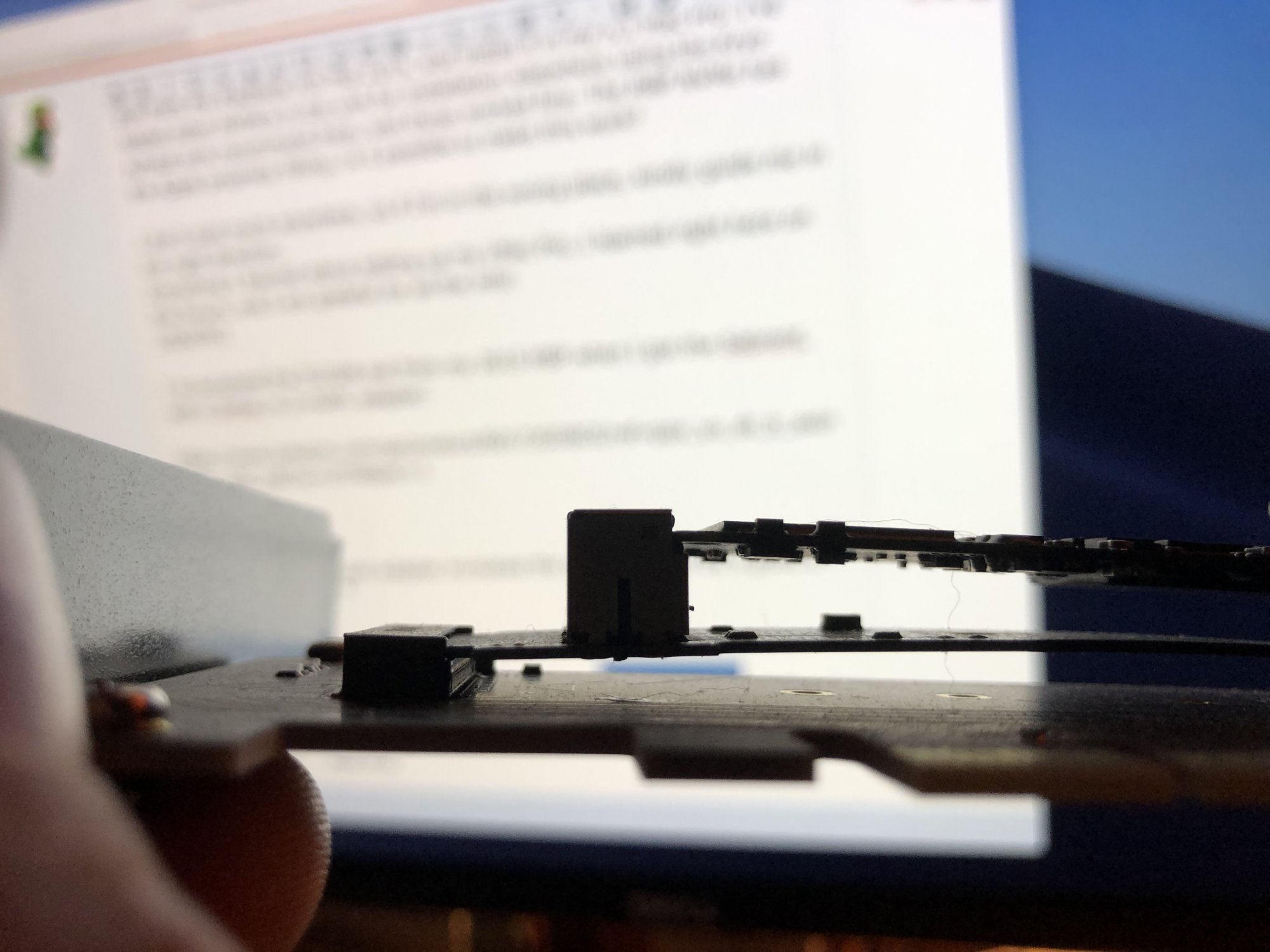

Only caveat is that said adapter increases the vertical height by almost 9mm:
In this photo, the m.2>12+16 ssd adapter is attached to a EZDIY-FAB m.2>pic-e 4X adapter...

I do not know 'why' said m.2>12+16 interface needs-be twice the vertical height of the {industry} standard m.2 interface, that's just the way it (currently) is ;(

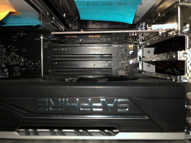

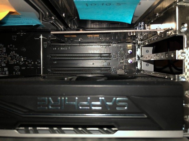

Thank you for the info, splifingate. Much obliged. Now I know it is technically possible, I will have to see if It will be physically possible using the EZDIY-FAB card in the PCI bay with my current configuration. I have a Radeon RX580 Sapphire video card, plus a usb 3.0 card installed in the 4-slot bay. The video card is in the bottom slot and, because of it's fans located on the top of the card, pretty much invalidates the use of slot 2. I might just order it and see if I can swap the USB 3 card into 2nd from the top and put the EZDIY-FAB card in the top slot. Thanks again for the valuable information!
DJView attachment 879198
Just a question I cannot resist to ask. But why does it seem that you have post-it notes in the internals of your Mac-Pro?

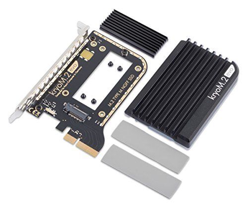

I need 1Tb and I have the Aqua Computer kryoM.2 evo PCIe 3.0 x 4
I only need the drive for storage not OS. What is the most know working drive with the above adapter in Hi Sierra & Mojave?

Note that the slot speed is limited to 1500 MBps. Doesn't matter how fast the SSD is. The only way to improve that is with a switched adapter. Pricey (er).
Hiher priced SSDs, like Samsung and WD Black, seem to go for reliability (more TBWs), which come with certain technologies. But with a relatively simple set up, like the Kryo, the max speed is 1500 MBps.

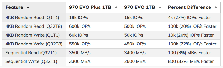

So there is not net gain going for the EVO Plus over the EVO on a cMP 5,1 with a Aqua Computer kryoM.2 evo PCIe 3.0 x 4?

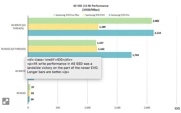

I bet you couldn't see any difference without carefully benchmarking or measuring your daily tasks. But there are differences of course. They just happen to be so small, and in both directions.
If googled: EVO vs EVO plus, you can see that besides max speeds EVO Plus has got better IOPS numbers than EVOtoo (approx. 20%).
Then again, in some tests plain EVO wins by a little margin.
When last time buying a NVMe, I chose EVO, because I would not want to worry about any firmware flashes. There's not so much of a difference there, but then again - there might be a difference for some folks.
Yeah I went for the plain 970 EVO. Couldn't be bothered with flashing for no net gain and more $ on the Aqua Comp Kryo.
