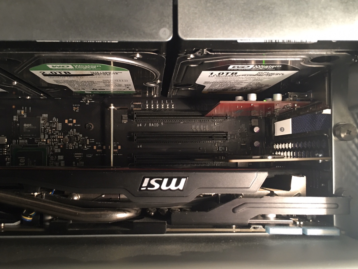

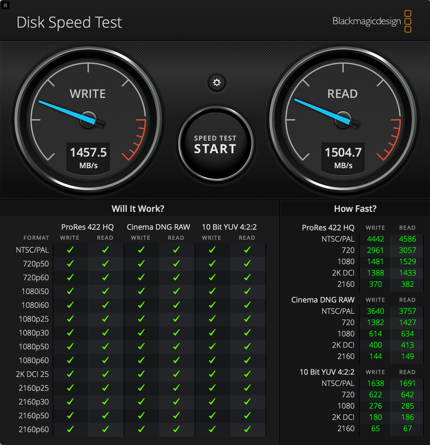

Slots 3 and 4 share bandwidth, is just 4 lanes of PCIe 2.0 (~1500MB/s) available for both slots.
A better approach is to move your GPU to slot 2, will lose access to slot 3, and install a switched adapter like the Syba/IOCrest on slot-1. This way you will have around 3000MB/s. If you need even more, look at HighPoint SSD710x cards.
You will need to upgrade your BootROM to 144.0.0.0.0, see the sticky thread about Mojave/BootROM upgrade.
With a good NVMe blade like 970 EVO Plus you have enough bandwidth to keep system and user/data files inside one blade, but maybe it’s better to have a separate scratch disk for your audio work, you will have less latency and more bandwidth.

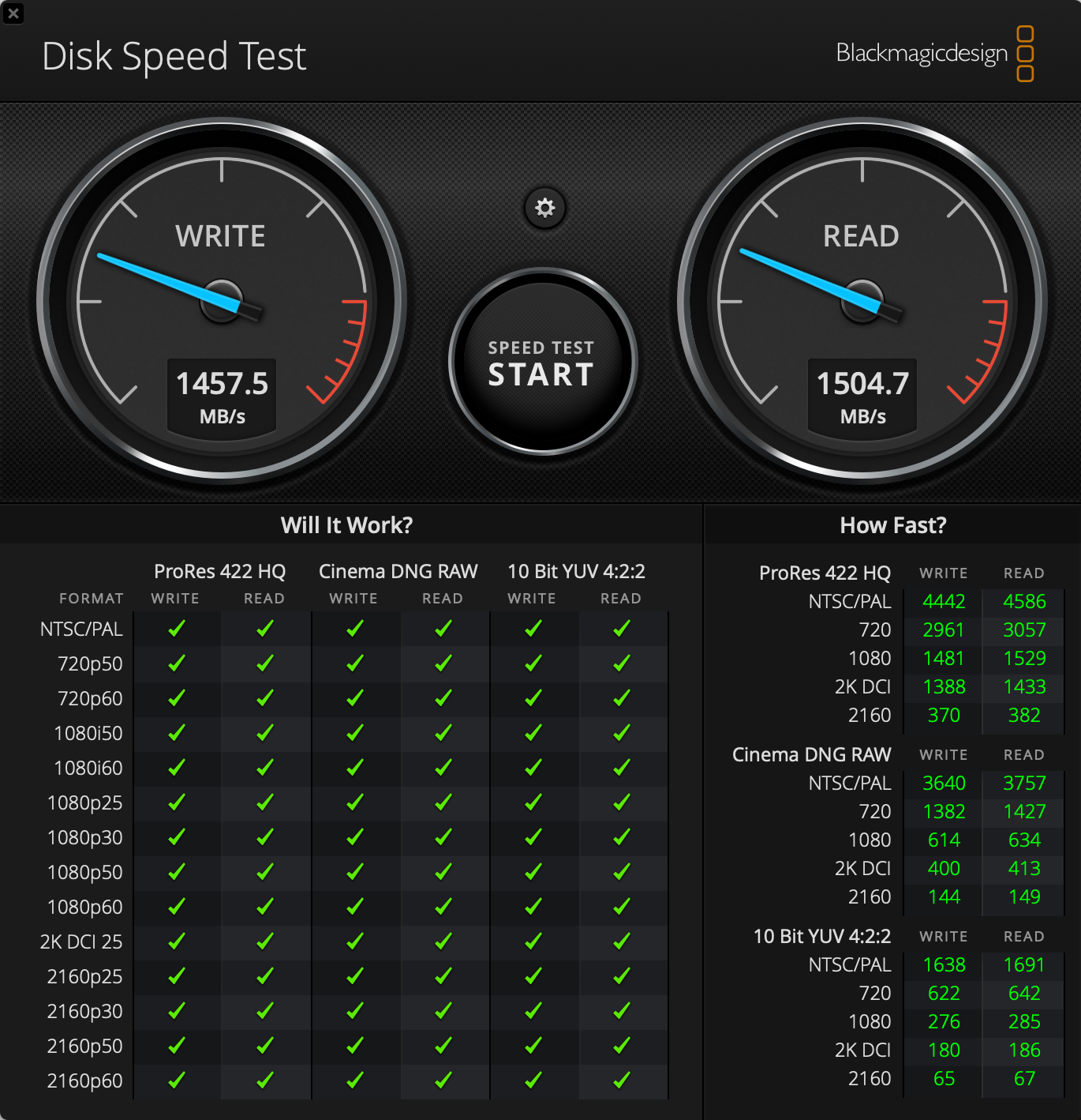

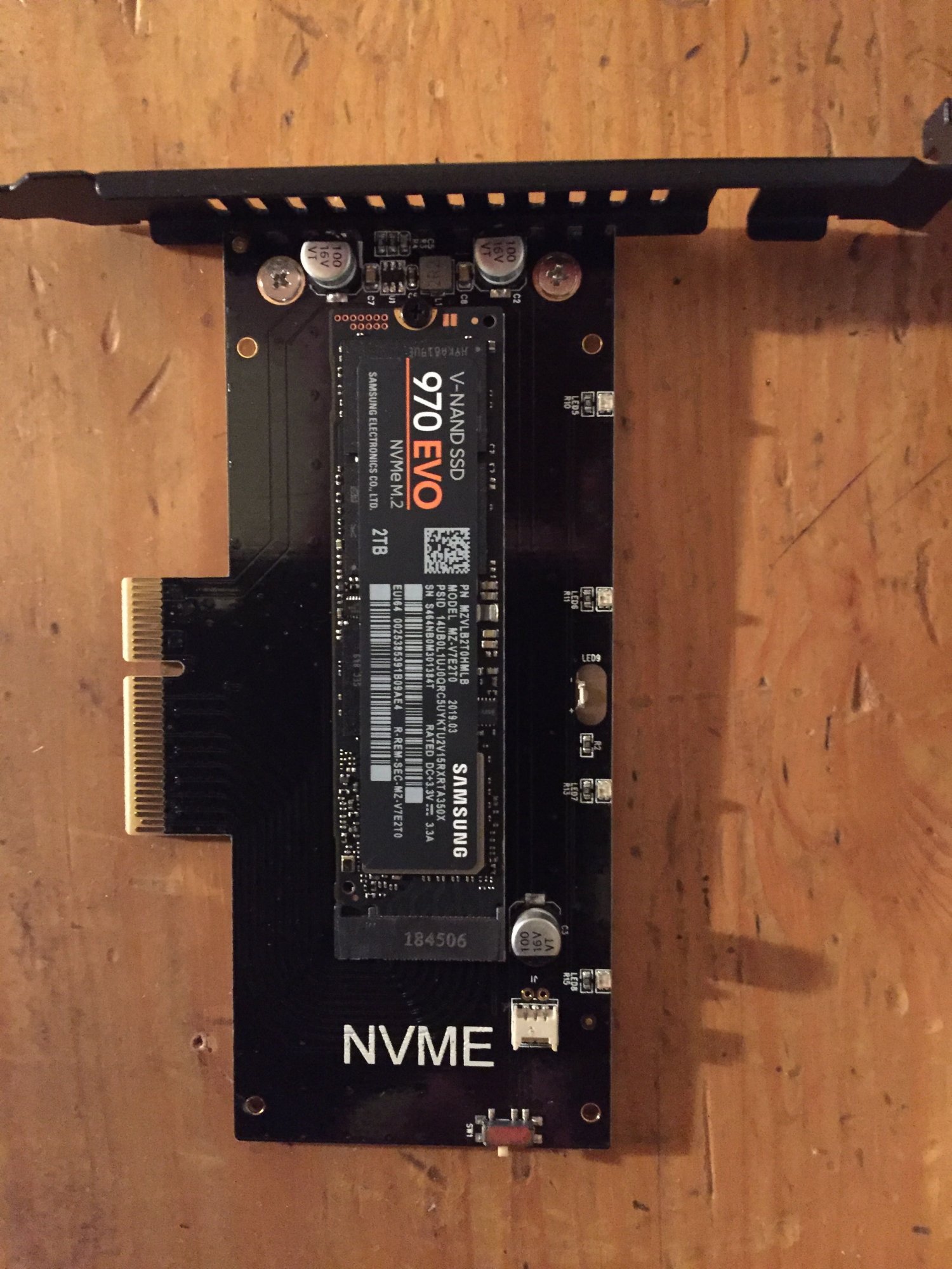

Based on your idea (and reality=my bankaccount) I came up with the following scenario:
Since you mentioned the BootROM ,I understand that with this you can move the GPU from slot 1 and still the MP boots (which I thought impossible).
Then as a Low Budget version I could put:
Drive1- slot 1 Max. speed of the 970 EVO/Kryo
Gpu- slot 2
Drive 2- slot4 Speed limited to 1500 R/W 970 EVO/Kryo (scratch Disk/Audio)
MIght this work as well ?

No, you are missing the fact that a M.2 blade is a PCIe 3.0 x4 device, when you are using it with a MP5,1 you are limited to PCIe 2.0 x4 with any slot.
Slot-1 or slot-4, will never change the fact that it’s a x4 device.
Only a PCIe switched card can overcome this, converting x16 or x8 PCIe 2.0 into x4 PCIe 3.0.
Don’t do it this way, wait until you have the money and buy a switched card.

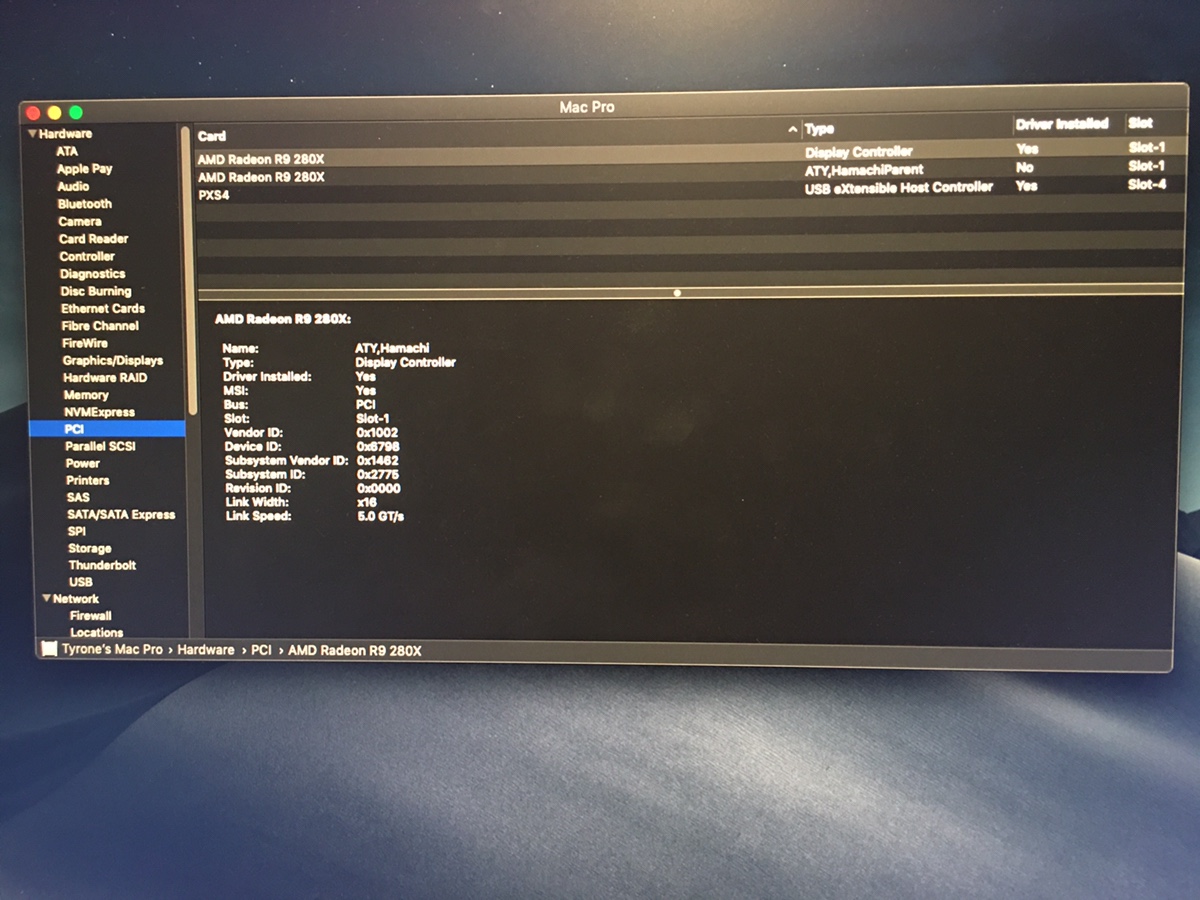

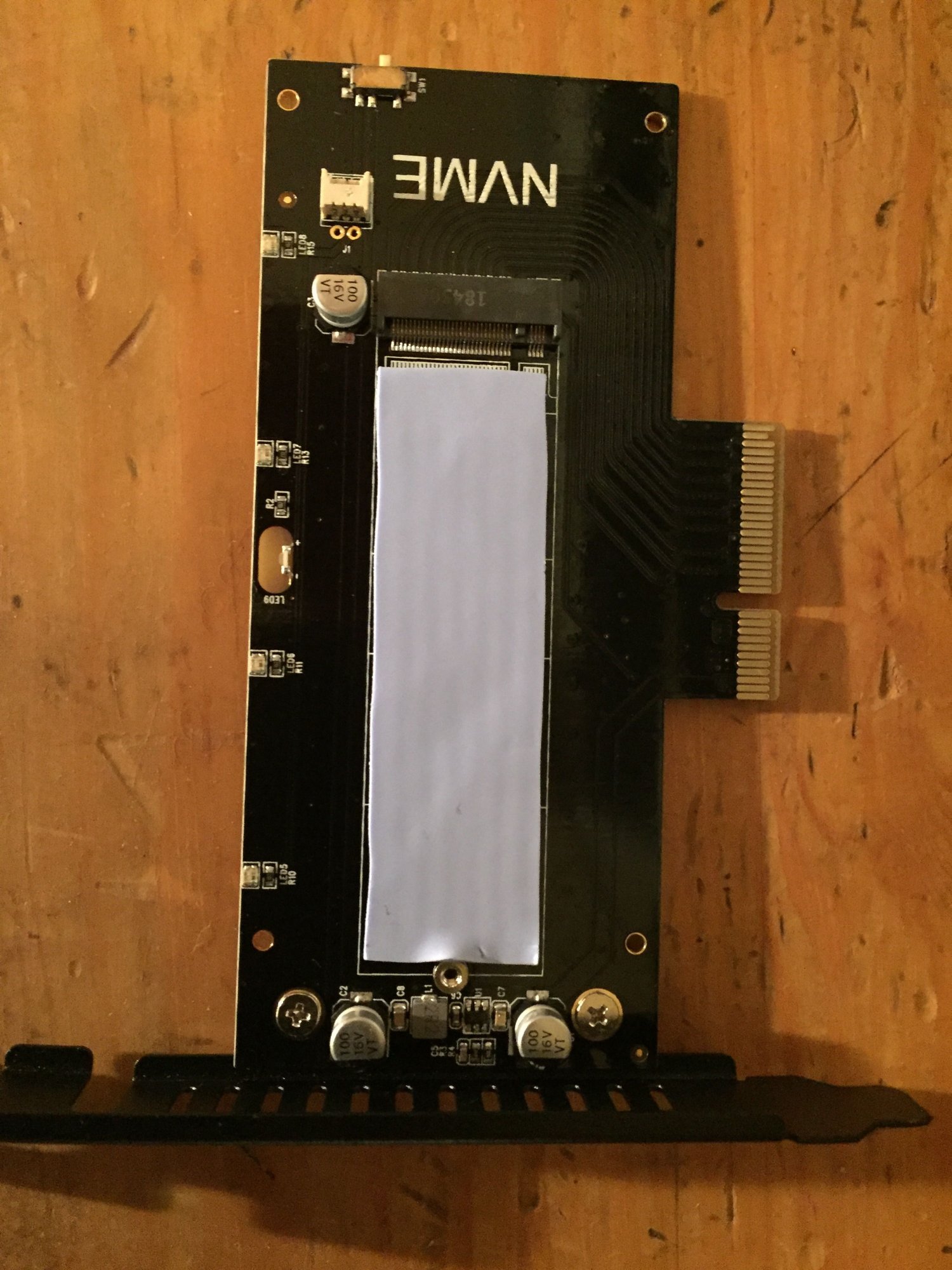

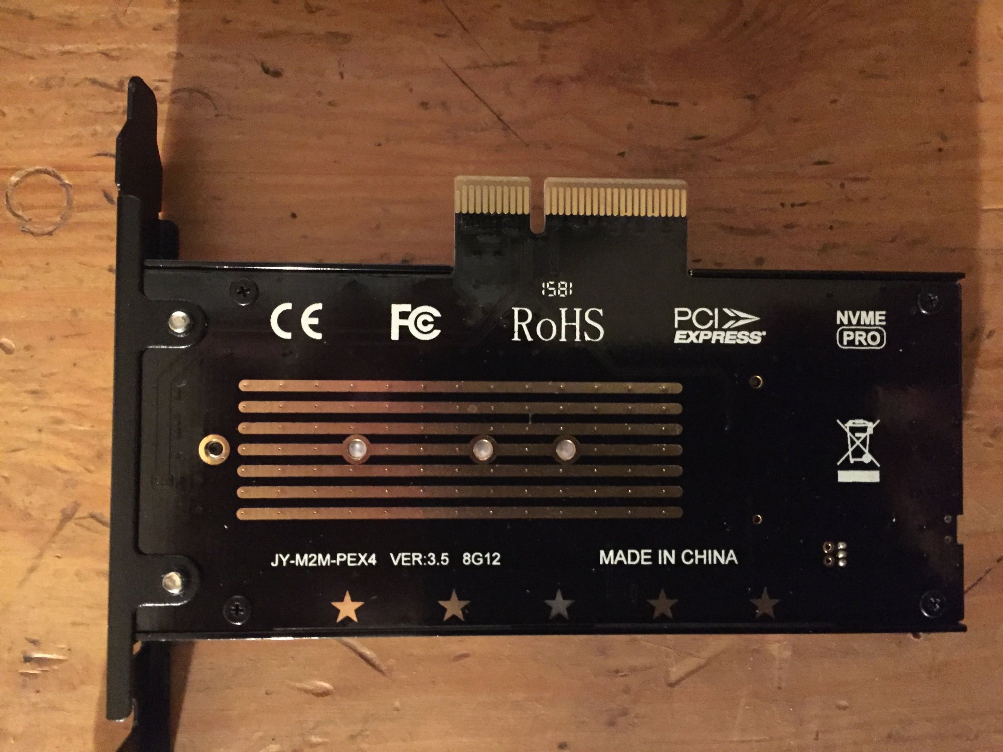

Dear readers,
Can anyone help me with the following issue.
Got an issue with a new bought kryoM.2 PCIe 3.0 x4 Adapter for M.2 NGFF PCIe SSD, M-Key controler card that I can’t get working with a Adata XPG SX8200 PRO NVME 1TB M.2 SSD
Issue steps:
1. Kryo with Adata slot 2 => No screen after startup into Mac OS Mojave
2. Kryo with Adata slot 2 => Blue screen after startup into Win10 Pro
3. Kryo without Adata slot 3 => No screen after startup into Mac OS Mojave
4. Kryo without Adata slot 3 => No screen after startup into Win10 Pro
5. Kryo without Adata slot 4 => No screen after startup into Mac OS Mojave
6. Kryo without Adata slot 4 => No screen after startup into Win10 Pro
7. Kryo without Adata slot 2 => Starts up into Mac OS Mojave, but in System Report , the card not been identified
8. Kryo without Adata slot 2 => Starts up into Win10 Pro, but in Device Manager , the card not been identified and also can’t find an error of a device not having the right drivers or having trouble to start up
The Kryo card: https://www.amazon.de/kryoM-2-PCIe-Adapter-M-Key-Passivkühler/dp/B01H0BC8FG
The Adata 1TB NVME: https://www.megekko.nl/product/5093/1019906/SSD-M-2/ADATA-XPG-SX8200-Pro-NVME-1TB-M-2-SSD
System: Mac PRO 2012 64GB with a MSI AMD Radeon R9 280X Metal card EFI Bootscreen Bootrom 140.0.0.0, Mojave and W10 Pro both on two separate disks.
Objective: Have the Kryo + Adata 1TB properly running on the system and then clone W10 Pro system to the Adata NVME.
Any help into the right direction or guidance is highly appreciated.
Thanks!!

Anyone an advise how to proceed? I’ve seen with some adapters that they state Windows compatible e.g. Highpoint SSD7x0xx , so I don’t get it that Windows on an NVME is no option. Does this count also with a bootcamp installed Windows? Bare with me that I’m no expert like some of you are. I just rely on your expert judgment and thank you for your voluntary support.
Its not the adapters, it’s Mac Pro 5,1 firmware/BootROM. MP5,1 firmware is too old and never was intended for Windows NVMe support.
BootCamp is CSM, not UEFI and cant boot from NVMe.
There’s no workaround, if you use Windows 8,1 or 10 installed with UEFI mode, required for NVMe boot, you risk a brick.

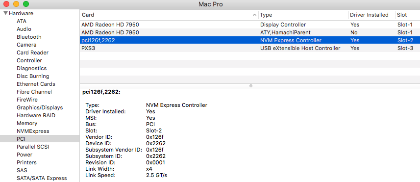

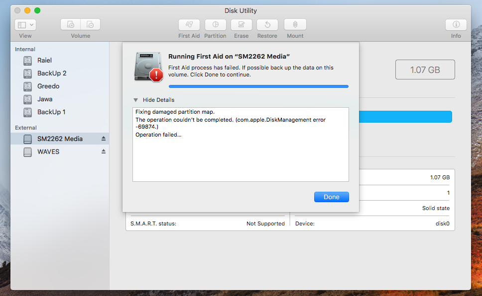

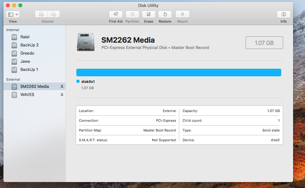

I just got a Aqua Computer kryoM.2 evo PCIe 3.0 x 4 ( Double sided version) adapter and a >>>
HP SSDs:
EX920: SM2262 controller: NVMe, M.2 blade
3D TLC
Available in 256GB, 512GB, 1TB, and 2TB
PCIe 3.0 x4
Speeds: up to 3,200 MB/s read, up to 1,800 MB/s write (1TB)
Datasheet
Compatibility status: Good
Can't get it to work. I've managed to get it to be seen in disk utility twice but it shows up as 1.07GB drive and has a few errors. See pictures.
Is the SSD faulty or am I doing something wrong?

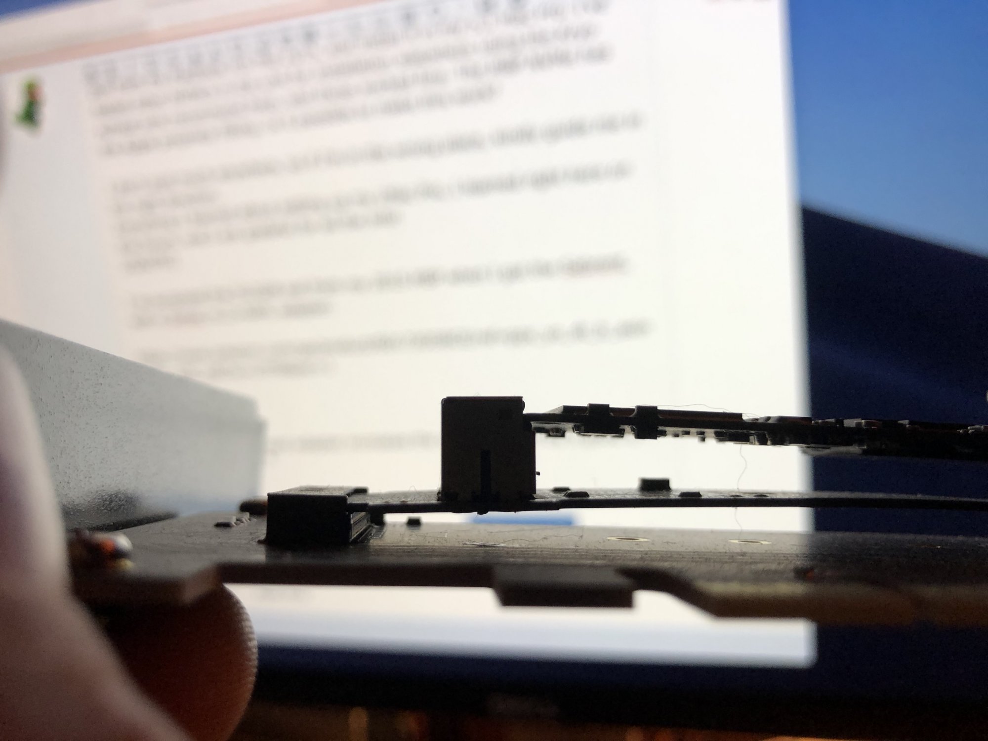

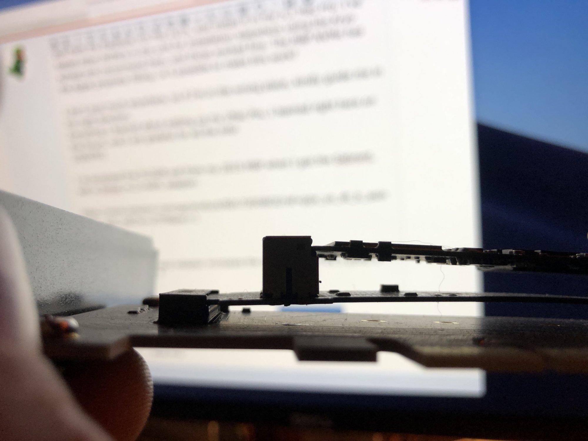

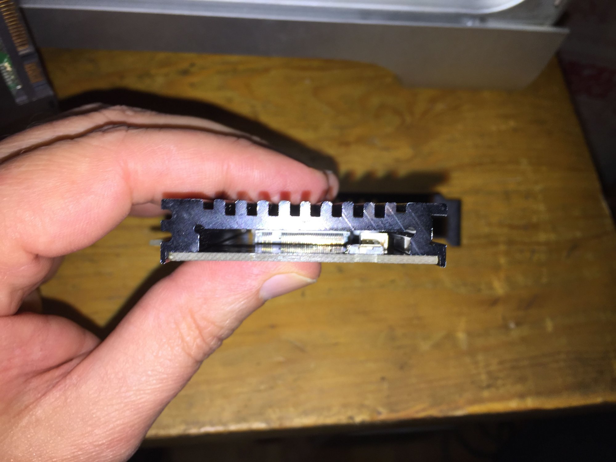

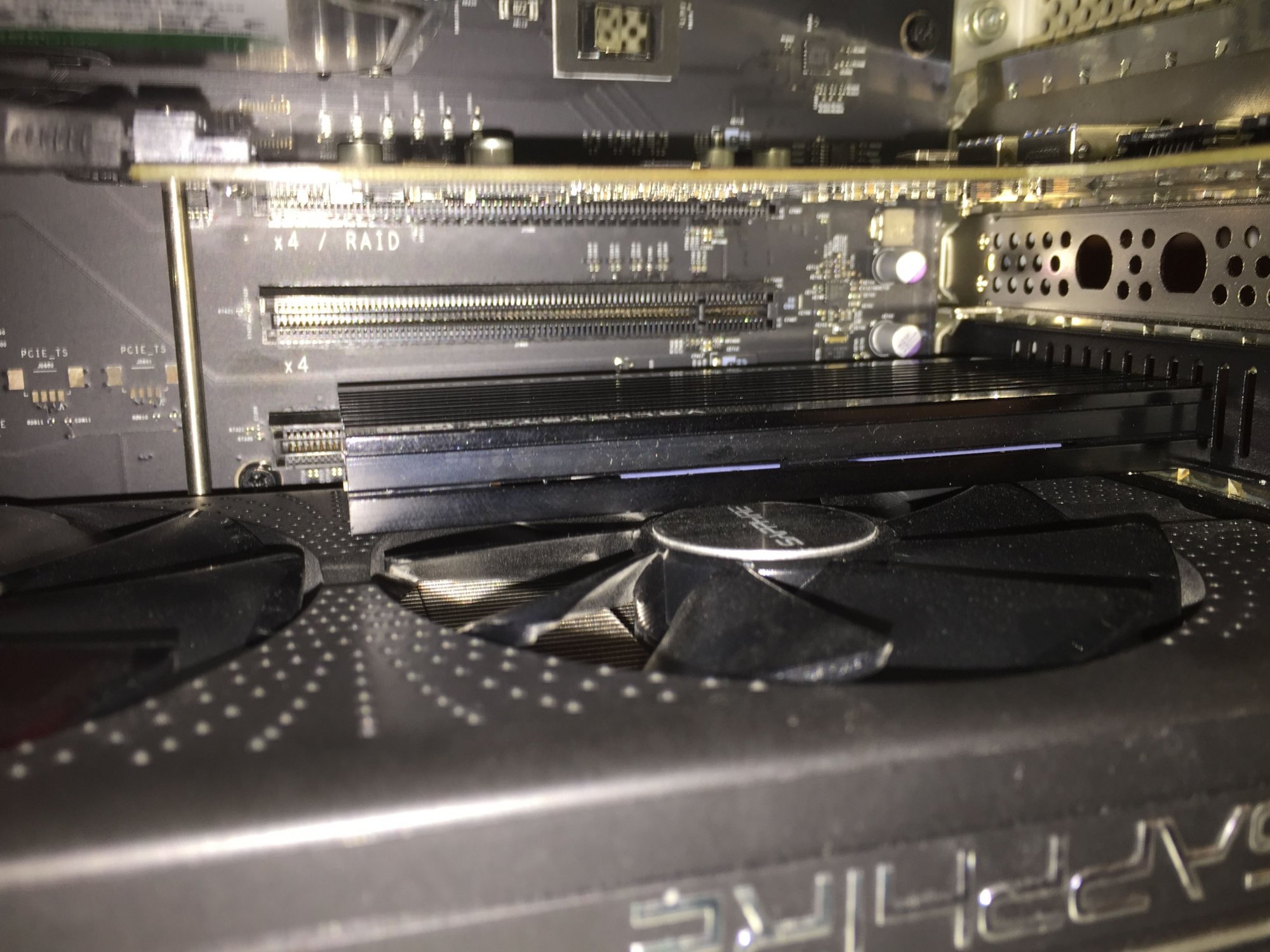

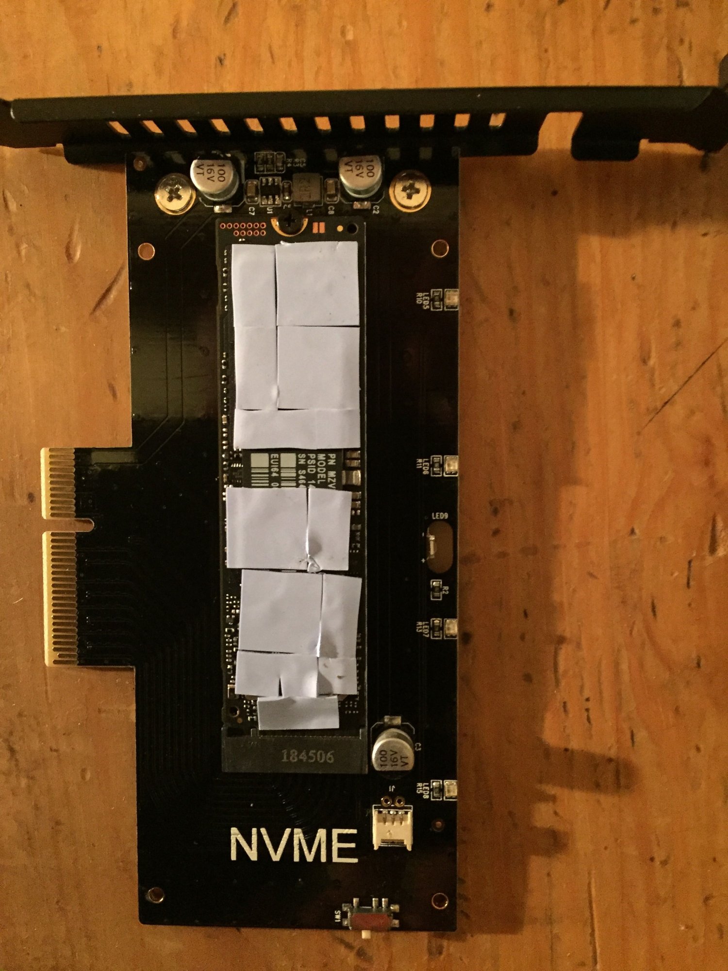

I re-purposed the 512GiB ssd from my 2015 MBP when I got the Sabrent, with a Sintech m.2>12+16 adapter:
https://www.amazon.com/gp/product/B0173ODBCE/ref=ppx_yo_dt_b_asin_title_o05_s00?ie=UTF8&psc=1
Only caveat is that said adapter increases the vertical height by almost 9mm:
In this photo, the m.2>12+16 ssd adapter is attached to a EZDIY-FAB m.2>pic-e 4X adapter...
https://www.amazon.com/gp/product/B01GCXCR7W/ref=ppx_yo_dt_b_asin_title_o06_s00?ie=UTF8&psc=1
It gets the Job done :)
I do not know 'why' said m.2>12+16 interface needs-be twice the vertical height of the {industry} standard m.2 interface, that's just the way it (currently) is ;(
There are multiple options for the m.2>pic-e variants, and I've had no failures with any of the ones I've purchased/used.
hth
