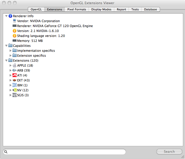

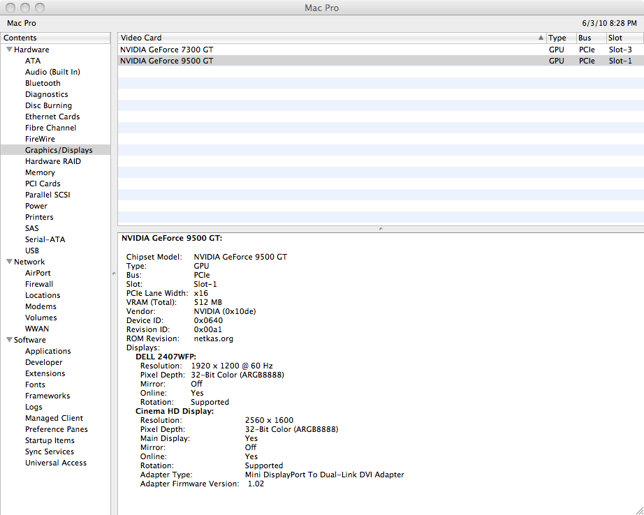

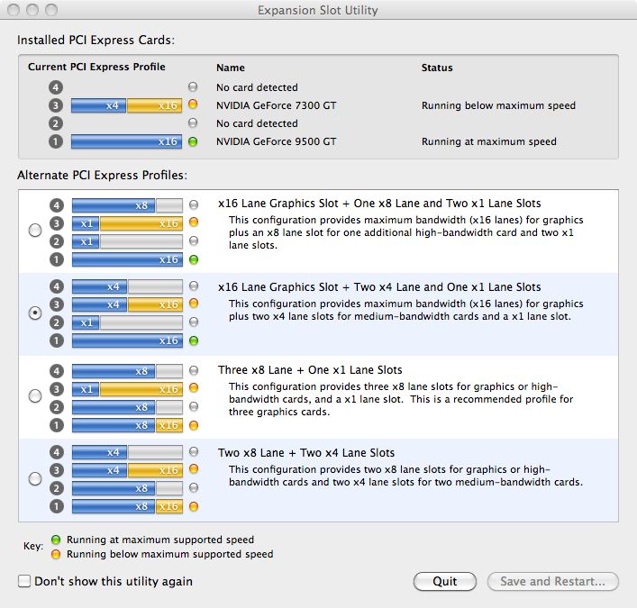

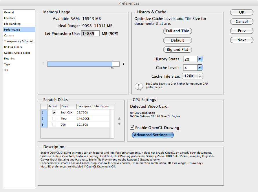

Works for GT120 in 1st Gen...cheapest way to do 24" LED via MDP
Came across a GT120 and tried it out in my 1st Gen.
Using Netkas little hack, it functions beautifully.
A little too well, perhaps.
While Apple would REALLY like to call it a GT120, it's own System Profiler calls it a 9500 GT. Yet other software sees it as a GT120.
Note that 30" Cinema DIsplay is running via MDP to DVI DUal Link adapter.
I don't have a genuine Apple LED 24", but the fact that MDP to DVI DUal Link adapter works seems to indicate that it would run a 24" LED Cinema Display.
Thanks again to Netkas. So, if somebody REALLY wants a 24" LED CInema and has a 7300GT now, here is cheapest way to get there.
Bioshock wasn't really playable at 30" res with candy turned on.

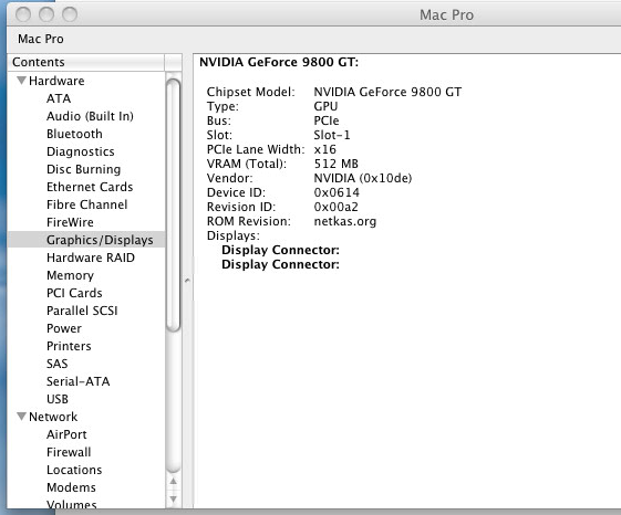

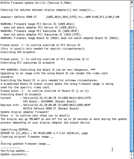

New, interesting discovery & first unasisted OSX Nvidia flash
Just made another interesting discovery that makes me think Netkas was closer than he knew to getting PC Nvidia cards to work WITHOUT an EFI assist card.
I discovered that if I have a PC 9800GT in slots 1 and 3, using ATY_init makes card in slot 1 WORK !!!
That's right, neither card has an EFI ROM. So, whatever this gag gets from 2nd card, it has nothing to do with "EFI helper card" as was originally thought. Oddly, no matter how many lanes the card in slot 3 is allotted, it only seems to be using 1 lane. I tried multiple resets and reboots with the Expansion Slot Utility, always came back with 1 lane for card in slot 3.
Sadly, I don't have any other PC Nvidia cards at the moment, but I can also tell you that using a PC 9800GT in slot 3 allows me to use a Mac EFI64 GTX285 in slot 1 of 1st Gen Mac Pro.
I found this intriguing so I tried to let it boot with only a 9800GT in slot 1. Nothing came up on screen, so I tried the volume button ....and it worked.
I fired up MacBook and logged in via Screen Sharing. There was a desktop of 1280x1024.
I was able to open terminal and FLASH the 9800GT into a Mac 8800GT for EFI32, via the Macbook and the NVFlasher util.
Sure enough, when I clicked on "Restart". up it came !!!
So I am quite certain that this is first time a PC Nvidia card has been flashed in OSX without an additional EFI helper card.
This means that if Cindori ever comes back from his LONGGG WEEKENDDDD, he could make Zeus able to flash MANY PC Nvidia cards using this same Screen Sharing method.
I am also hopeful that Netkas may find some piece of info here that wouyld help make ATY_Init work WITHOUT a helper card, whatever the helper is doing.

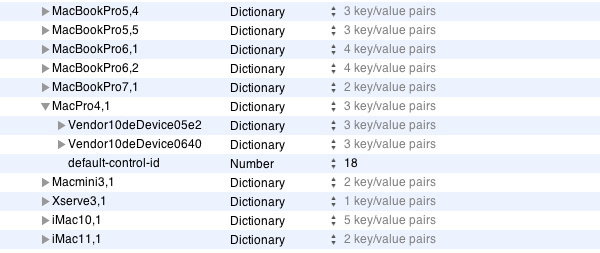

Typo / Bug in GTX285 Drivers?

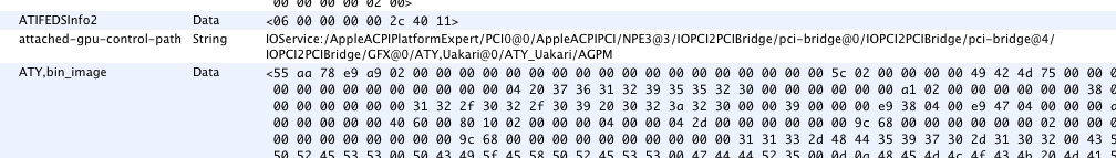

My tireless and tiresome efforts to get 5870 working have led to a small discovery.
I was using Spanky Deluxe's Ioregistry Report to see what differed from his WORKING 5970 versus my BUGGERED 5870 install.
I noticed that the control path for mine was some ACPI dealie, and his a completely different thing...."attached GPU control path." If you look at that piece, you see that it ends with AGPM.
AGPM is a kext from Apple. It stands for "Apple Graphics Power Management."
I decided to dig into it and see why it was loaded on Spanky's machine but not mine.
I noticed that the only Mac Pro in the profiles is the 4,1. And then below that are 2 cards listed, the two Nvidia cards. I decided to try to get this kext to connect with my GTX285. I modded the profile to be for Mac Pro 1,1 and it still had no effect. Then I had another look at those device ids. 0640 is the GT120 and then the 06e2 must be the GTX285, yes? But then I realized that my GTX285 has id of 06e3.
Turns out 06e2 is for a GTX260, not the 285.
So, I modded that string as well and restarted. And something DID change. The screen came up at a different resolution and the fan stayed running high well until after desktop loaded. Never seen that behavior before.
I was not able to see the AGPM anywhere in the system info however, though it may not work well considering that the rest of ICs and controllers it is looking for are likely not there.
But very interesting anyway.
I looked at older versions of the kext...all had 06e2 instead of 06e3.
And then I remembered all the fuss about how early GTX285 reports were that it was doing weird throttling.
I find it hard to believe that if this is actually a mistake that NOBODY has caught it in all this time. I imagine that this is some leftover strings and that AGPM is run from somewhere else.
Also curious ow the AGPM is working in a Hack to run 5870 when 5870 isn't even mentioned in the kext. So, obviously there is more going on behind the scenes.
If there is someone with a Mac Pro 4,1 and a GTX285 and some time on their hands, might be interesting to see what modding that string does.
Possible that early development for GTX285 was done with GTX260 and this is leftovers from that time and completely nonessential. Would be interesting if next OS update fixed it......
And I would still like to figure out if this will be needed to make 5870 work properly.

Sadly, the 7300GT requires the cable switch at boot, or you need to add another monitor.
Yeah, I kinda figured. My work around is to just use a DVI-VGA adapter on the 7300GT, DVI on the GTX260, and have both cards connected at the same time.
To do this you have to set the displays to mirror, is this going to result in a decrease in performance?
If it does, I guess maybe a cheapo DVI switch would work as a cable switch...
