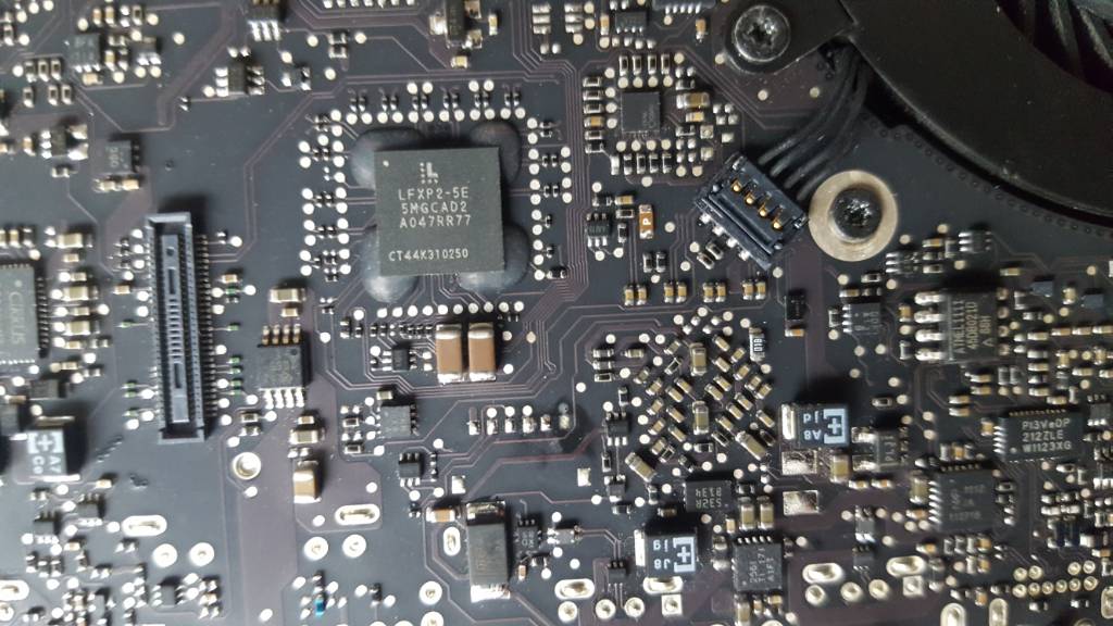

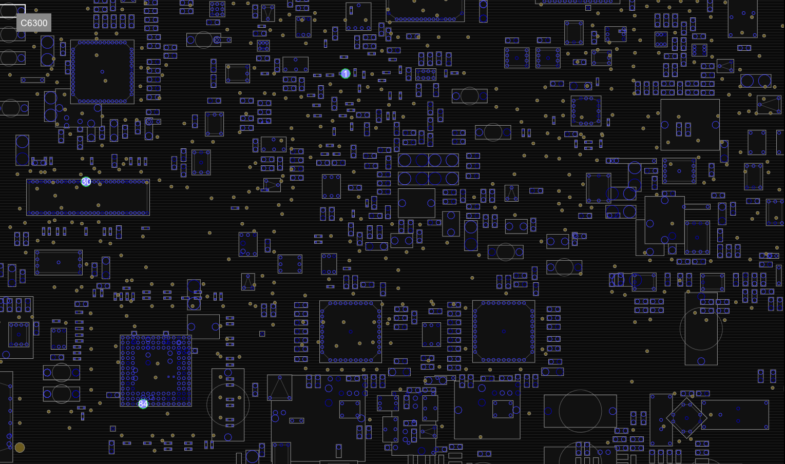

F***k...
Killed tck on a 15" board...
o.k.
but where is it!? ;-)
do you have a picture from board itself?
Bist ja auch deutsch...
Wo sind die Punkte?
Hast n Foto vom Board mit den Punkten?

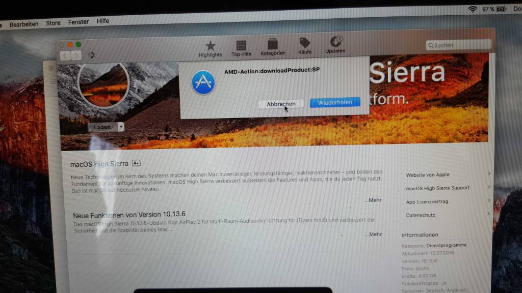

O.k. downloading high sierra from appstore not possible.
Now i cant Upgrade efi bios to boot from apfs....
use high sierra patcher from dosdude.
with high sierra patcher can download install image and make install usb stick.
benutze den high sierra patcher von dosdude. damit kannst du das install image herunterladen und z.b. ein install usb stick erstellen.

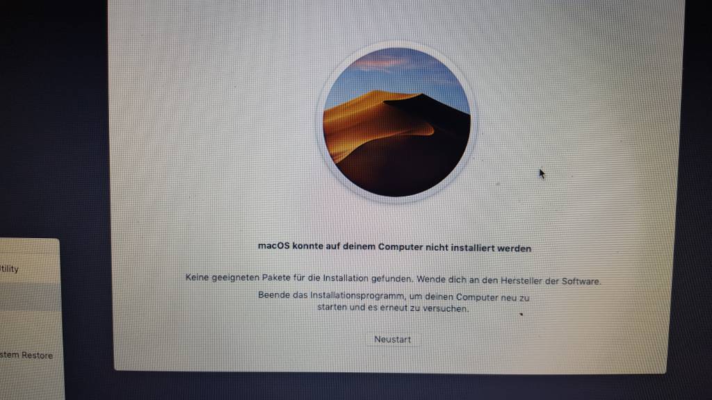

But i cannot install mojave with patcher.
And after formatting disk with apfs from diskutility in patcher it isnt recognized during boot whil press option key.
And this is the error i get:
No packages found...
Update done.
Apfs is here and high sierra converted my hdd to apfs.
Check the system date and time.
