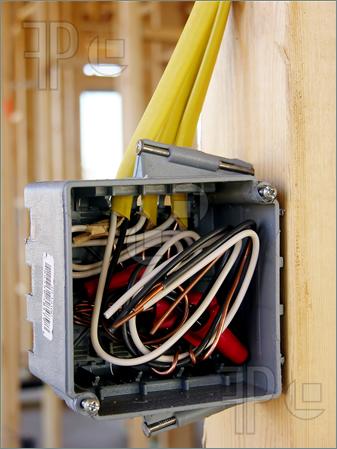

The wire running underground into the garage (as well as ALL wiring in the house is identical to this:

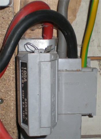

The main wires (from the meter also to the range) look like this:
You said "like this" and posted two very different pictures.
So now, is the wire running underground to the garage like the yellow wires in the first picture? Is it just one wire? And it's connected directly to the 60A main?
The 1st wire is the kind this house has 12 gauge i believe 3 wires, and the same kind rand to the garage.
The second picture show how beefy the wires from the meter are.
So, you have one 12-guage romex run underground connected to a 60A fuse and feeding a breaker box with four breakers between 15A and 20A?
Pretty much. I wouldn't be able to begin rewiring any of the house.
Jesus H. Tapdancing Christ on a Ritz Cracker.
There is nothing even close to code about that. Not now, not ever in the history of electrical wiring. Even electrical engineers in King Tut's day would have said no to that. A 12AWG wire connected to a 60A fuse then run underground? There is nothing even remotely safe about it. No wonder your garage isn't working. You are lucky as hell no one has been electrocuted in your house and yard.
Reactions: MacNut
