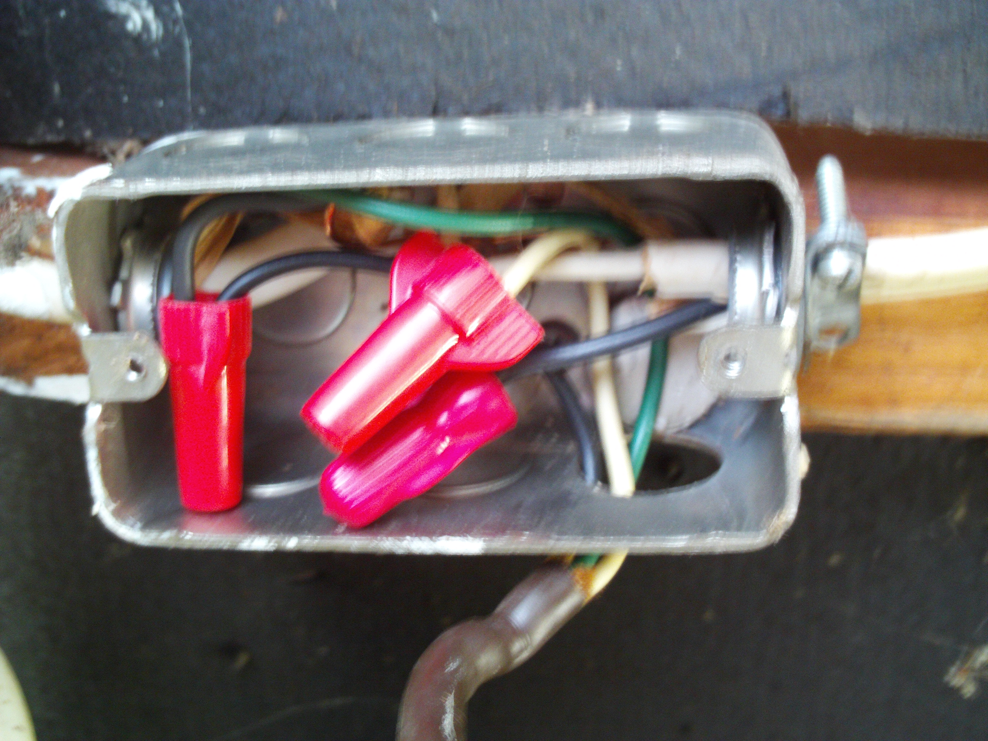

no metal conduit at all just the standard electrical wiring burried 6 inches down.
Who wired that? Any electrician worth his certificate wouldn't bury a bare Romex cable only 6" down (or bare Romex PERIOD). Also, the whole thing would have had to pass a code inspection in most locales before it was energized the first time.
Just from a common-sense thought process. There should be a circuit box in the garage, fed from the power feed prior to the breakers/fuses in the main panel (or however a remote panel is supposed to be run). I'd have the compressor on its own circuit, the lights on another and the outlets on at least one more. There are SOO many better ways to have that garage set up compared to how it was working before the current failure, and those ways are probably much closer to (if not actually) the way it's SUPPOSED to be by code.
1. I'm not being a dick, I'm speaking assertively. I'm encouraging you to analyze this situation a little more thoroughly.
2. Then clearly you didn't look too hard. It's a standard practice. Again, good luck finding a mechanic that will do a single brake pad. You can do single caliper, but pads definitely and rotors should are done in pairs. I've never seen them sell 1 set of brake pads. What do you think happens when one brake stops harder than another?
3. Your best solution would have been to run outdoor extension cords suitable for your appliances. Not re-wire things.
Oh PS, while its normal not to encase electrical wire underground, isn't it 24" without A conduit? Something less if their is? If power was 6" below the surface, I'm pretty sure there would be a lot more electrocutions with people digging around.

Did you disconnect the original wiring in the garage to hook it to the cords? You re-wired it.
Not in this case. We installed some railings on the steps leading down to the garage for my disabled mother. As my grandpa was digging the holes for the railing posts he struck the power line to the garage with the shovel. It shocked him and shot sparks. Power to the garage was sill there so we went and got some electrical tape and taped up the wire. Most likely the area he nicked with the shovel several years ago is the area of problem now hence why I said i'd dig up the wire to take a look. Mostly likely that entire section of wire needs to be replaced.
I'm not sure what to say to this. That is NOT what electrical tape is for. That wire should have been replaced at the time of the incident.

Basically what everything the previous user said. I'd be surprised in 1994 if 6" was acceptable for electrical wiring without a conduit. I can't imagine building codes have changed that substantially in that regard. I thought you said your house was not up to code?
What you have preformed sounds like the definition of "re-wiring". Or did you choose to go with the male to make plug?
Well a shock puts anyone at risk for electrocution. An old man with a bad heart or a small child with a small body is at a higher risk of death. Getting shocked may not kill you, but it can certainly cause long lasting nervous system side effects, not to mention burns and scars... Or even starting a fire.
It sounds like this cutting that wire could easily be the cause of this problem. Checking wire would be a very reasonable place to start. I still think you just have a blown fuse ;)

I didn't do anything other than run 2 extension cords. Unless you consider adding a power cord to the lights to power them "re-wiring". We already checked the fuses. If we had a blown fuse something inside the house would also be without power. EVERY circuit in the house has power and every spot in the fuse box with a wire tested 115V. yea My house ISN'T up to code for the stardards of 2015. Technically speaking, any house with fuses instead of breakers is considered out-of-code. (Makes me wonder they they still uses fuses in cars rather than mini or micro breakers.) Or why they still use carburators on small engines rather than Fuel Injection. (those are topics wondering off topic though).
That would be the definition of rewiring.
If it's a blown fuse you should be able to tell just by looking. When you're using the multimeter in the fuse box What two points are you testing?

Tested all "Hot" or black wires from the fuses with the white ground wires on both top and bottom of the fuses wouldn't house fuses be cheaper and take less space too?

This is false. An extension cord does not need to "get hot" to be a fire hazard. The type of insulation jacket matters as well. I knew a guy who used speaker wire for extension cords. You know, the clear gold speaker wire. Yes, it is copper cord. Yes, it is capable of carrying voltage. However, the jacket is not suitable for any sort of wear and tear. And if anything cuts into that jacket, it has little chance of surviving. With audio, this is not a big deal. With 120v, that can burn a house down.
The images you have posted in this thread show extremely light-guage cable with thin jackets powering a garage and being run across a yard for extended periods of time. There is nothing safe about this for any extended period of time. Maybe a couple of days in an emergency.

Uhh, wrong. The breaker on a power strip is not designed to the same specifics as an actual breaker.
I don't over work the circuit, The garage runs off one of the 30A circuits for the clothes dryer. When using the clothes dryer I unplug the cord to the garage. the other side of the dryer circuit powers the fusebox the the outside centeral AC unit. When I use the air compressor in the garage i unplug everything and just run the compressor on the extension cord.
So, what you're saying is that you have what looks to be a 14-16 AWG extension cord protected by a 30A breaker.
I didn't do the wiring. It's not wired to the plug for the dryer its wired into the dryer's fuse box.... Again, house came that way. I know enough to unplug the garage before using the dryer because when i used to have m bedroom in the basement having m computer plugged in would blow one of the fuses whenever I ran the dryer. some one thought it was a brilliant idea to wire the outlet to the heating side of the dryer's circuit. Why the AC wasn't wired on it's own indipendent line rather than on the dryer's power side is beyond me. Sure wouldn't think the company that installed It would wire it like that. Just like the company that installed our furnace had to run a ground wire, claiming the furnace wouldn't function without a ground wire. Surely wouldnt think a old metal sewer vent pipe would be an adaquite ground.....

There is nothing about any of the situations you have explained that was "up to code" in 1994. All this crazy 30A breaker stuff powering numerous side-wired boxes all over the place and cable run 6" underground? Not even close to code in 1994.
This is where it just gets silly. So, you repaired underground wire with some electrical tape? And now you're actually questioning what could be wrong?

pictures of all sorts of very unsafe wiring
View attachment 558143 This is the junction box I tapped into for the lights. I removed the line coming in from the breaker box and attached this power cord (brown) in it's place.
