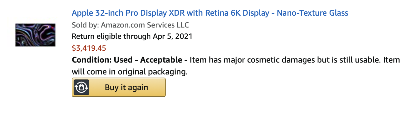

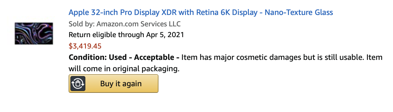

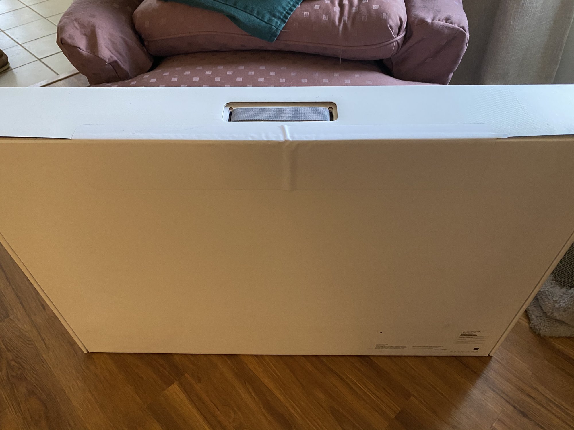

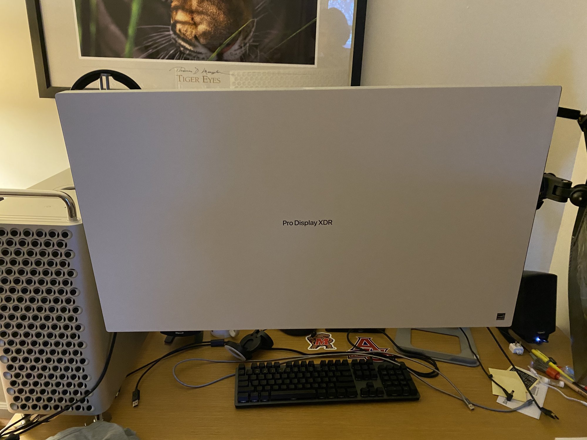

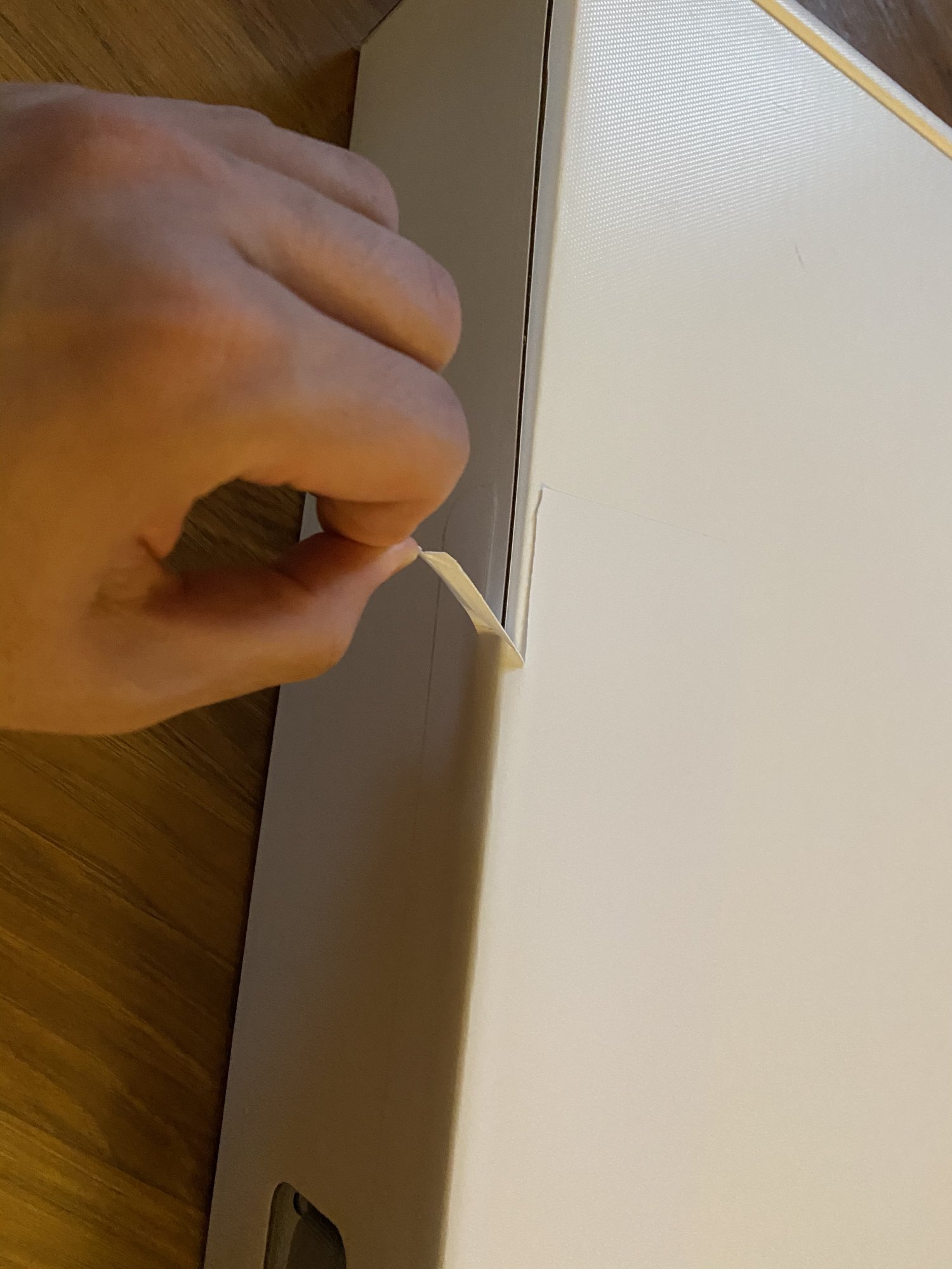

So I took a gamble from Amazon for an open box Pro XDR display that stated it has major cosmetic damage, I figured if it was on the screen, I would just return.

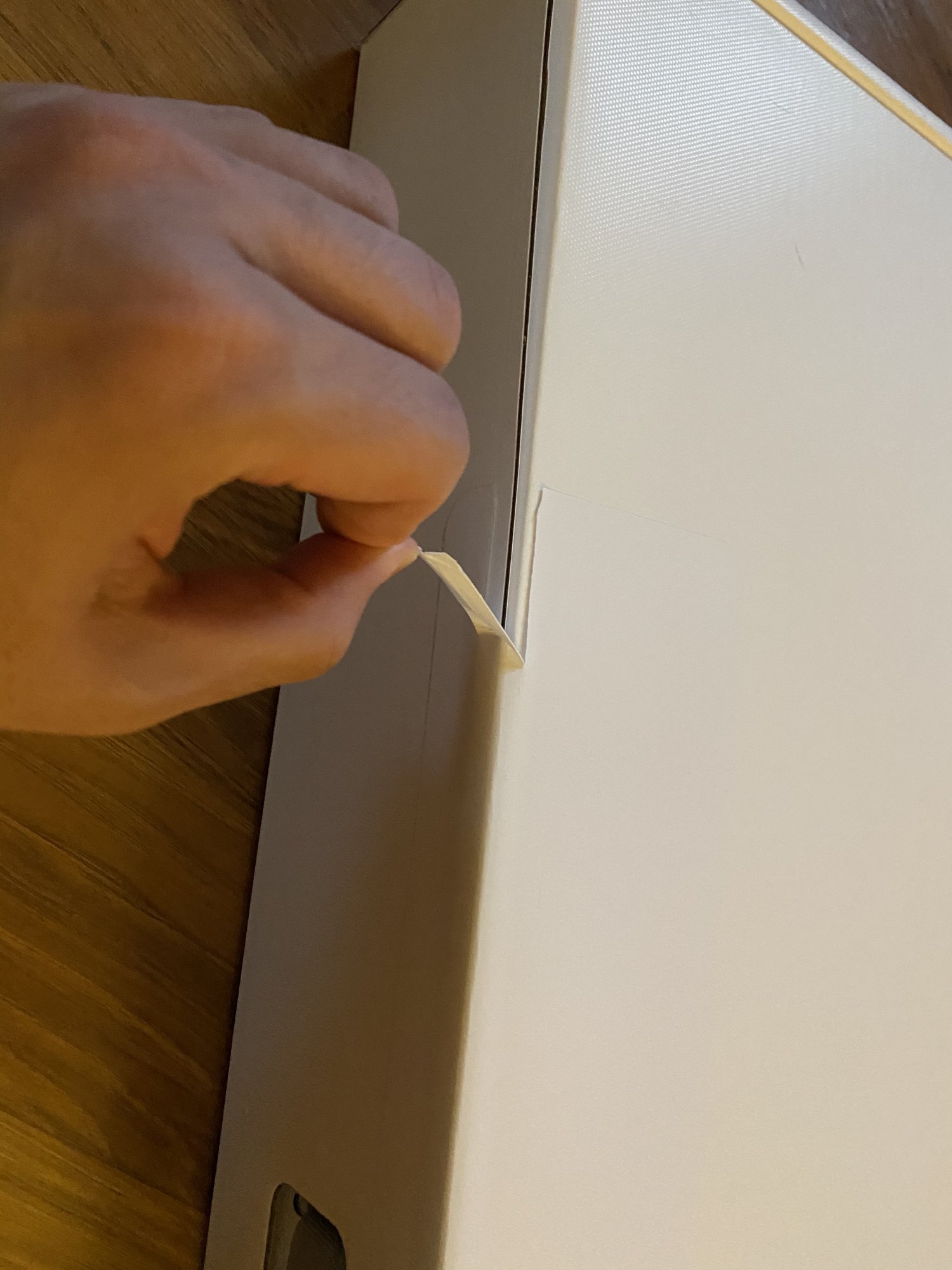

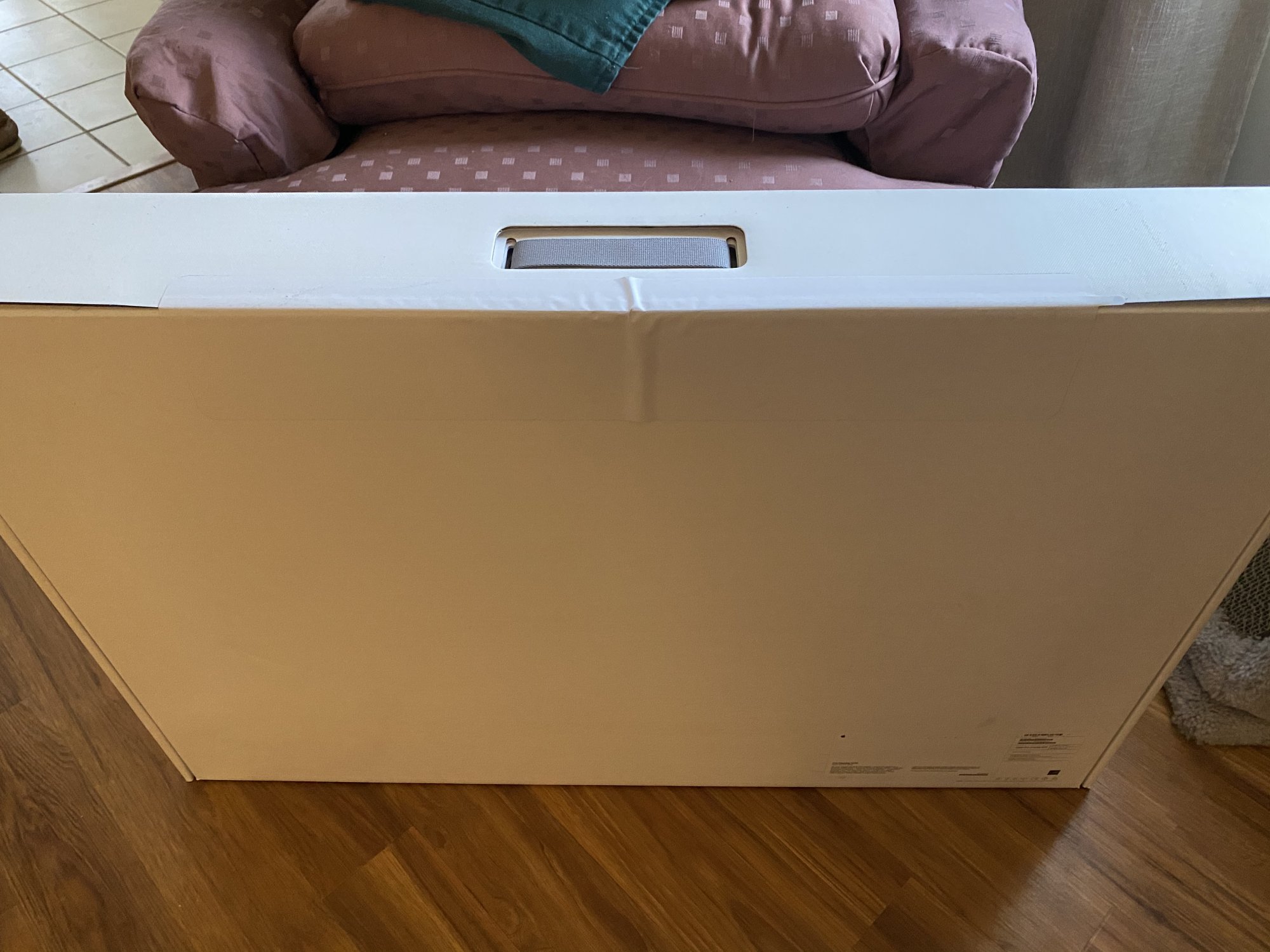

It came in a really beat up brown box which was the original Apple brown box with foam inserts and well....
Guess my gamble paid off, it was brand new and sealed...... I'm guessing the major cosmetic damage was the brown box it came in??

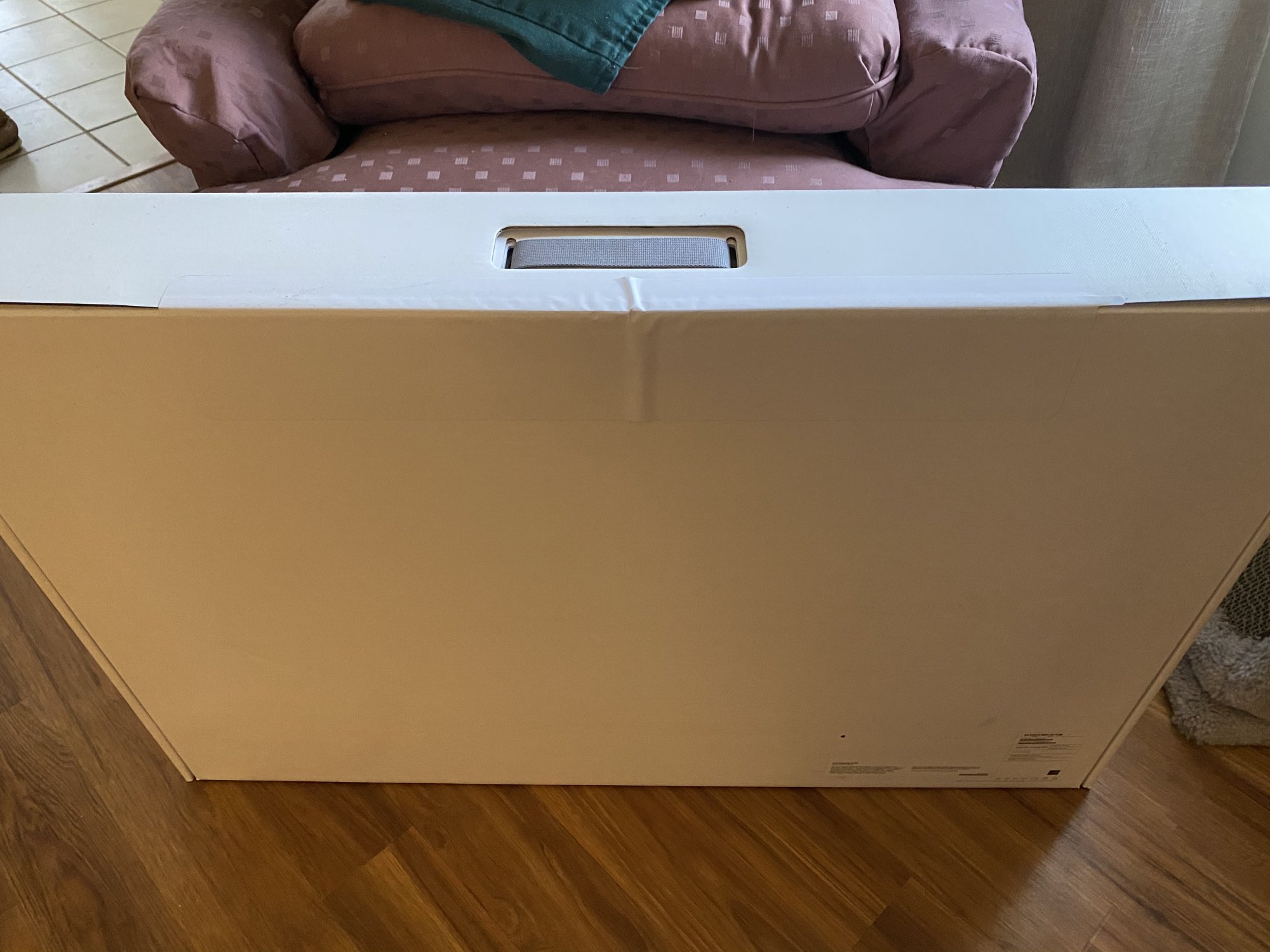

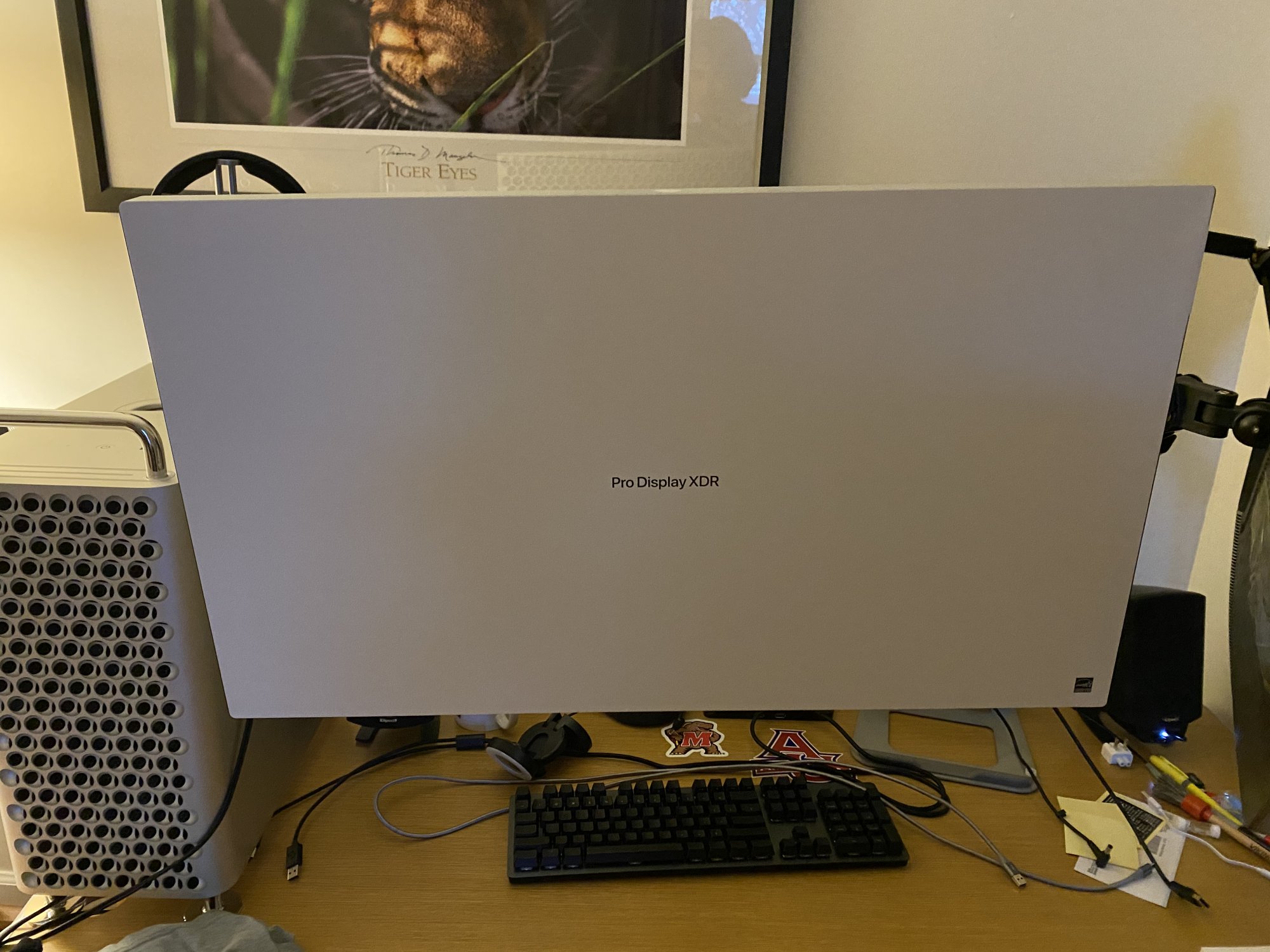

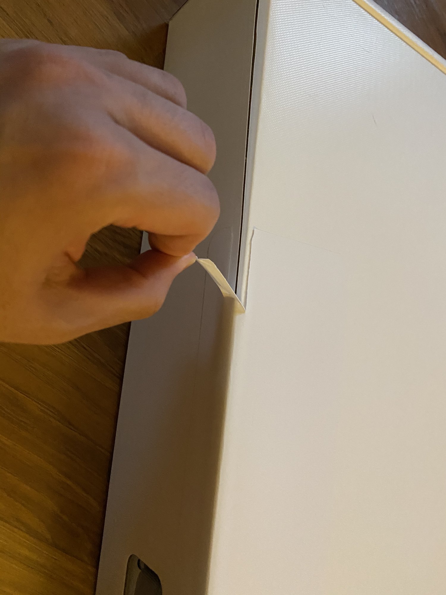

Looks like a major score.
I've seen this beat up brown box issue a few times--mine had the same problem. I think Apple designed the brown enclosure box in a way that is not super compatible with whatever loading tools are common by shipment companies.

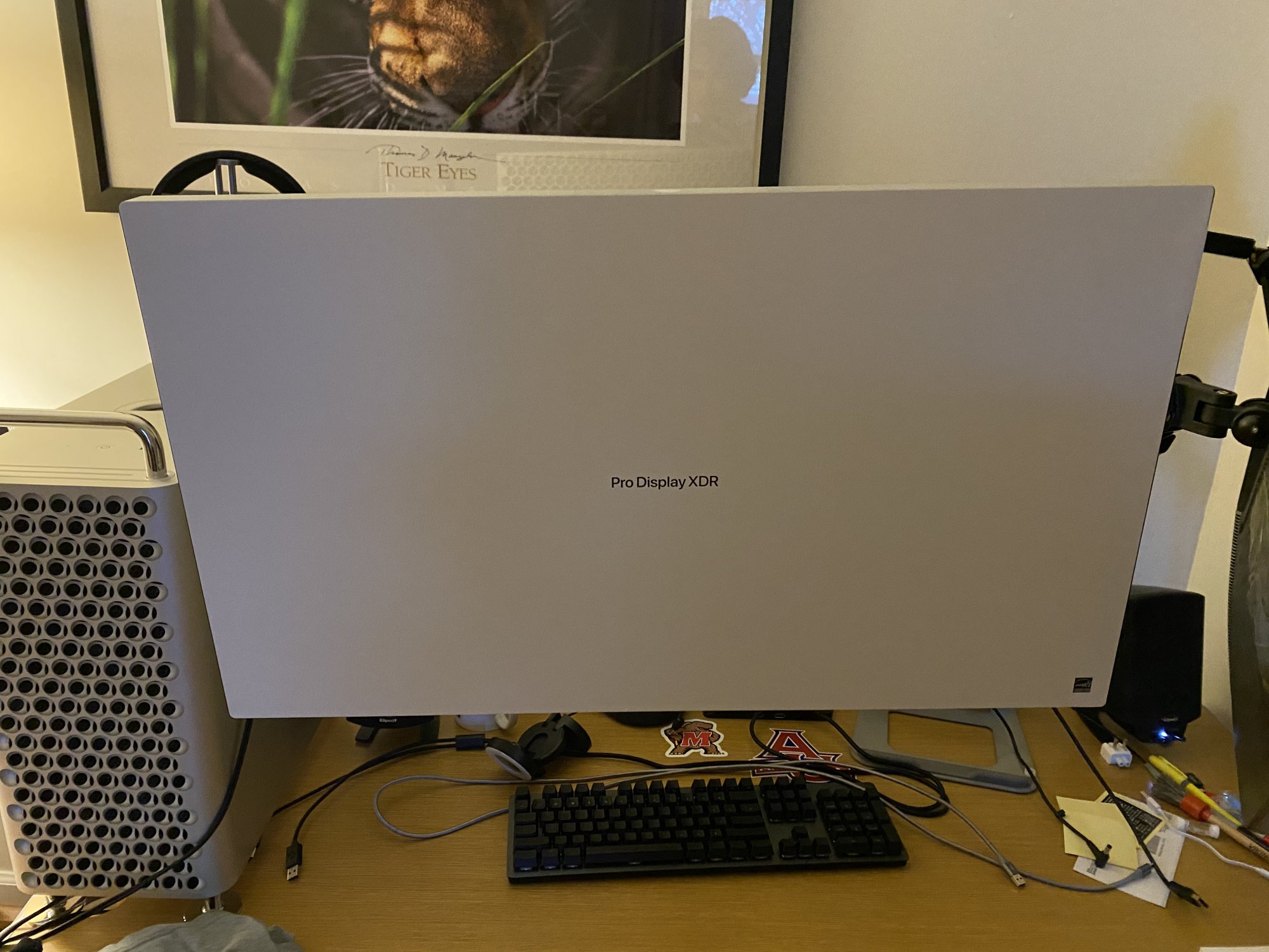

After 10 years of reading macrumors I finally created a account.
i like to have the one XDR display to replace my LG 5K ultrafine. I see my local Apple reseller have a huge discount this weekend on all XDR displays. Are there signals for a new version?
