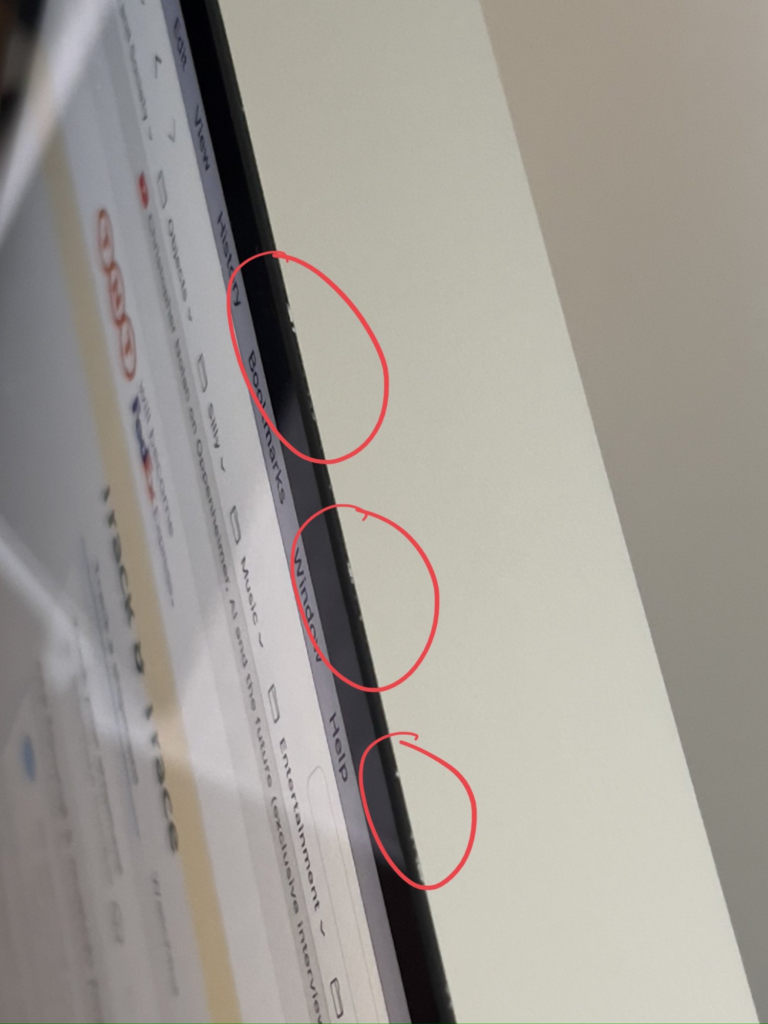

Here’s an image of the peculiar ‘between glass and body’ glue issue. Different from 1st display I received where the glue was black/grey and poking out. This is between the aluminium body and glass. A small / insignificant issue, but having had several iMacs and displays since 2005 for work and personal, an issue I’ve not encountered before the XDR:

Thanks. That's unacceptable, I'd return it. In the end I don't think I'll be buying an XDR, unless I get it cheap, but seen the issues, even getting it cheap wouldn't solve all the issues it's got.
It's just going to be a headache, so I'll stick with the ASD I think.
