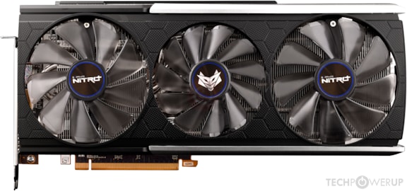

I Found this non-reference Card
Sapphire Nitro+ Radeon RX 5700 XT Special Edition, 8GB
Base Clock 1605 MHz 1840 MHz (+15%)
Game Clock 1755 MHz 1965 MHz (+12%)
Boost Clock 1905 MHz 2035 MHz (+7%)
Memory Clock 1750 MHz 1800 MHz (+3%)
Clock speed has about 10% improve than the reference card
it also has bios switch, which can back to normal reference clock speed.
Very curious When using on Mac Pro, will it have a 10% GPU performance improvement?
Is there any history that an aftermarket card added extra V RAM than a Reference card?
