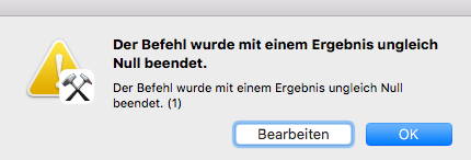

Trying to move my ESP to a single nvme ssd which is on a high point ssd7101A.
DeployESP and TweakESP give me the error "The command ended with a non-zero result. (1)"
what does this mean?
if i install it there manually and blessing it works. Then the tools are unfortunately useless for me.
Looks like a bug. It should either tell you it can't access that location or just access it.
Pending investigation, you will need to either run it from a location where it works, run it manually or remove the whole thing.

The reported error is not in ConfigFactory.
This message is from a generic shell error that can come from any of the many shell commands failing.
Will wrap them to give more meaningful messages in future version.

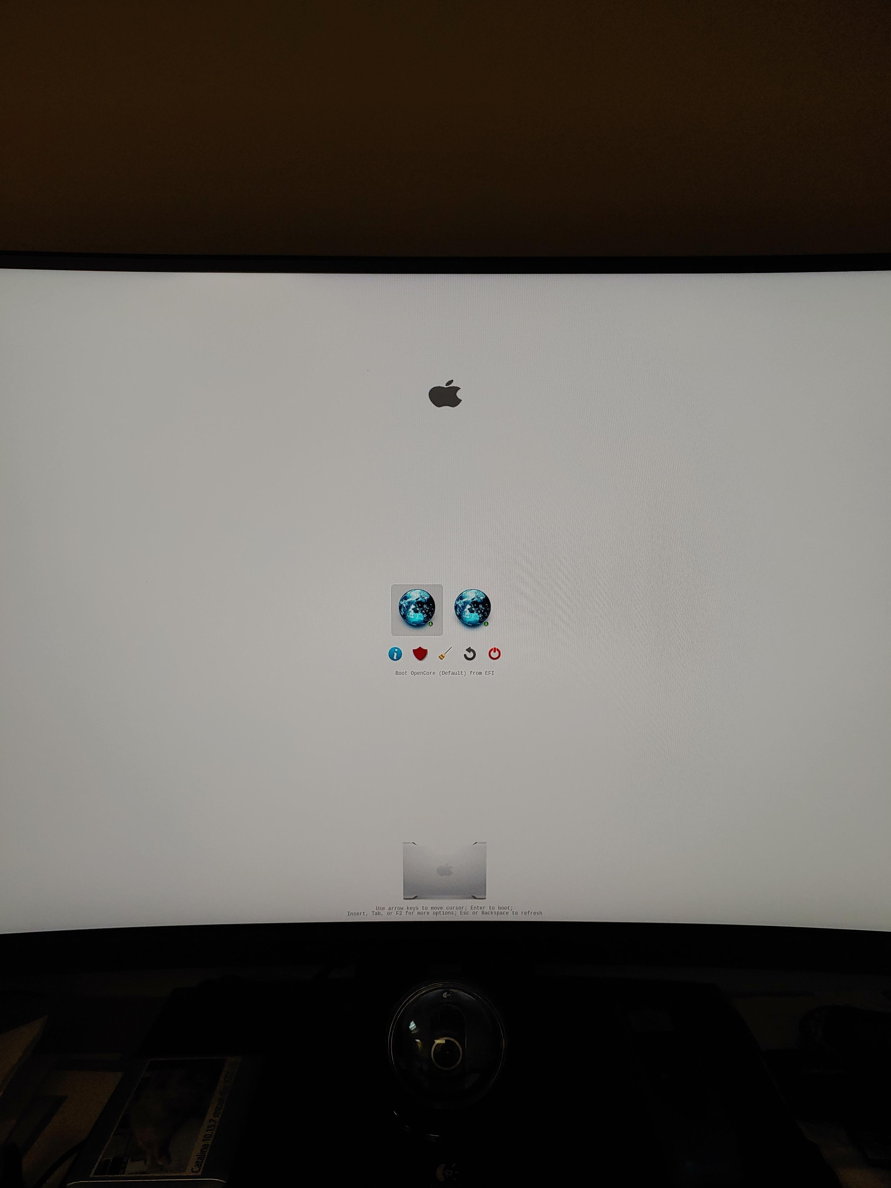

Sorry to trouble again, but I finally got around to installing rEFInd on my 5,1. My computer has dual 3.5ghz processors, 128gb of RAM, Vega 64 GPU, 4 internal HDs, and two OWC PCIe 6g SSD drives. Mojave is installed on one of the OWC cards.
I installed rEFInd/OC chainloader as instructed. I used one of the internal HD's formatted in HFS to store the EFI files. I selected ESP during the configuration. Once done, I Soft bless and a reboot brings me to the rEFInd boot picker. Here is where things are a little strange. I only see 2 OC options (regular and alternate). I do not see the Mojave volume. How can I configure rEFInd to show the non-OC Mojave volume? (I used Inni to make both OWC PCIe SSD cards show as internal volumes - and that works fine in OC Mojave as per Disk Utility).
Also, I tried both Radeonboost and no Radeonboost activated. Can't seem to tell a difference. Is it still needed with 10.14.6? I do confirm with either setting that VideoProc shows H264 and HEVC active whereas non-OC Mojave shows not active.
Finally, booting into OC Mojave, I do see the Apple boot sequence after picking Mojave in the OC boot picker. However once it gets to the login window, I sometimes lose video out of the Vega64. I have to disconnect and reconnect the HDMI cable or HDMI to DP adapter to get video back. Any suggestions there on what may be the issue?
Apart from the above, OC validation tool reports back as successful. Everything within Mojave OC seems to work fine.
I presume you actually mean "RefindPlus" when you say "rEFInd" ... They are one but not the same.
Do you mean you only see the OC options and nothing else which is what "I only see 2 OC options" suggests?
Or does your Catalina volume show up but you also want Mojave to show up? (Your signature says you are running Catalina but you don't refer to this so not clear).
If you ran ConfigFactory from Catalina and selected the option to limit booting into Mac OS from RefindPlus to the current instance, then only Catalina would show up since that would be the current instance in that case.

I only see two OC options. I do NOT see native Mojave installation.
It should appear by default.
Please raise an issue on the GitHub repo about Mac OS Volumes not showing up in RefindPlus and provide the information outlined in the issue template. I'll take a look at it later as it is late for me now.
Link:
Link:

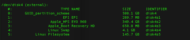

This is what I see after Soft Bless reboot:
I had a similar problem when I upgraded to the most recent RefindPlus. In my case, I disabled an option in the override.conf file, which suddenly made all my volumes appear on the next boot. I do not know if the option itself was causing the problem, or somehow something need to flush some cache somewhere or something weird like that. I mentioned it in an earlier post, you can look for it.
But really to debug the problem you need to take a look at the conf files you are using for RefindPlus as first step prior to assuming its a bug. I do think there might be some kind of bug though based on my previous experience mentioned earlier on this thread a week or two ago.
