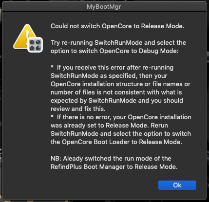

@Dayo - just installed MyBootMgr again. Finalized settings in ConfigFactory and told it to build. Result was the following error message:

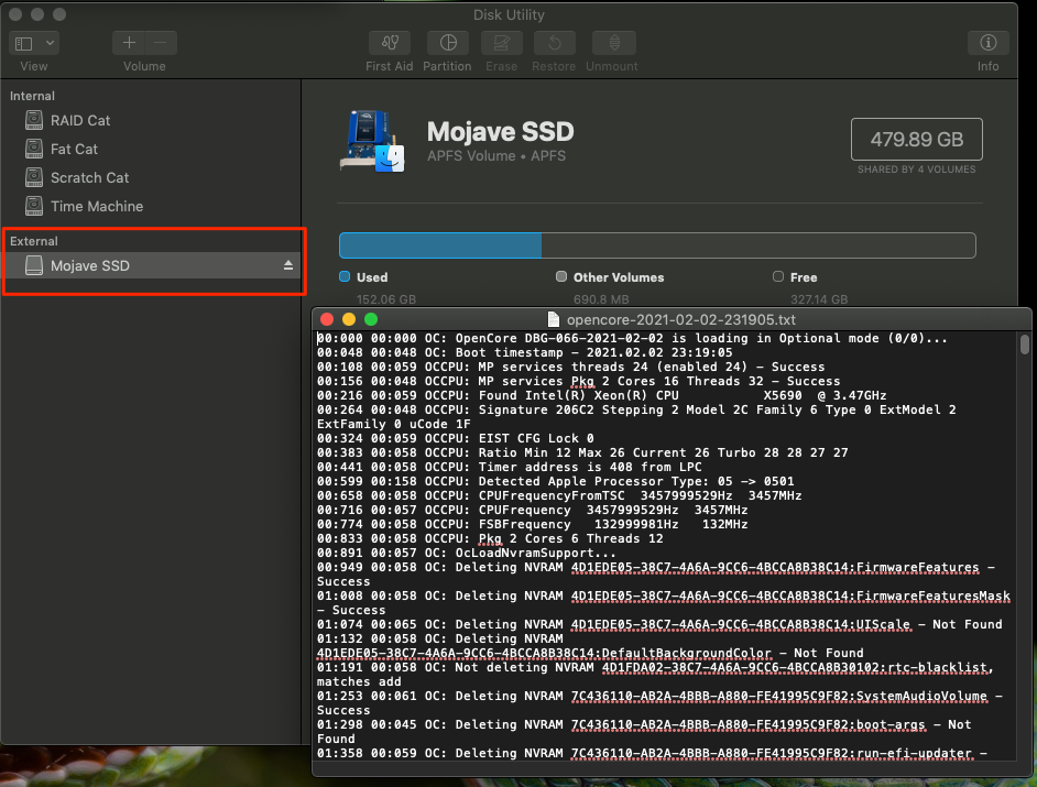

Didn't work. I grabbed Innie.kext from v065's backup OC and OC ALT folders and dropped them into EFI folder for v066. Now instead of just 1 PCIe card being shown as internal and the other external, both are now external. AFAIK, LILU is running.

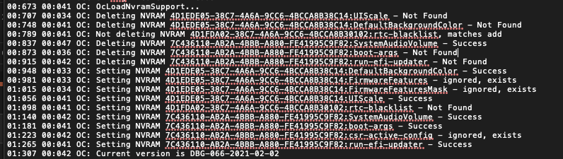

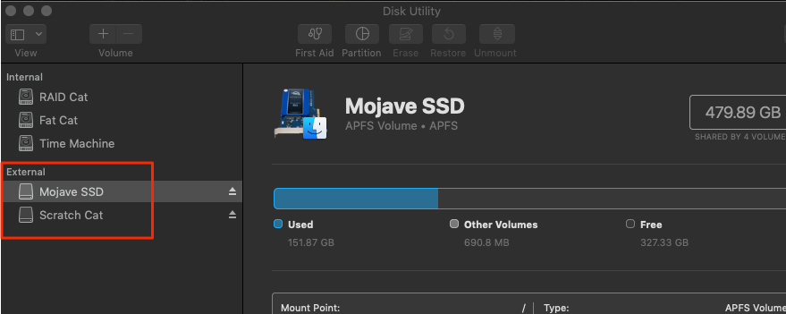

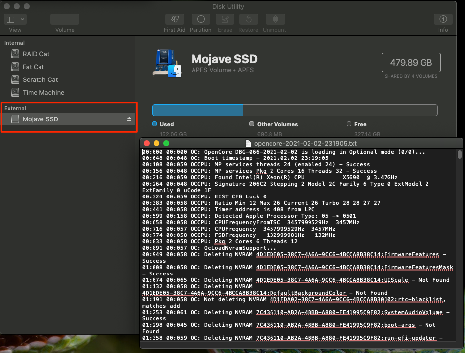

Running 066a now. Installed without a hitch. Innie still isn't working correctly though. I'm back to having one of two PCIe SSD's still identify as an external rather than internal drive. I'll give ConfigFactory's alternate solution a try.
P.S. Since NVRAM keeps getting written and deleted; will it actually wear out or is RefindPlus/OC doing some sort of "soft writes" instead?
OK. So that now looks like an innie Issue but attach one of your OC config files to make sure.
If otherwise ok, I will drop back to previous Innie version.
That's how OC works. No idea on the implications. Best to ask cdf on the main thread. Curious myself.

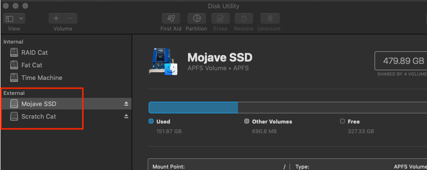

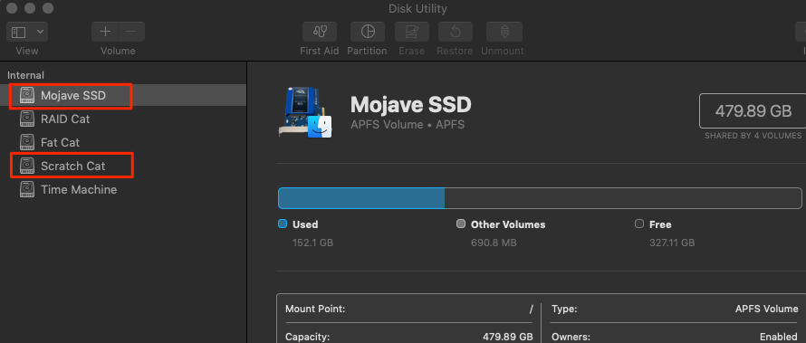

Definitely an Innie issue as ConfigFactory's alternate solution to use AHCI works just fine. Both PCIe SSD drives are now identifying correctly as internal devices:
Here's the current config.plist (using AHCI alternate rather than Innie - let me know if you want me to run configfactory again with Innie instead):

One other issue I've discovered; can't seem to switch to release mode. Tried going into debug mode and couldn't do that either. I keep getting the following error messages depending on what I choose:
Well, since we were talking about Innie, was expecting output related to Innie.
As side note, can you add such long items like config files and logs etc as actual attachments as opposed to pasting directly in threads? Saves having to scroll forever to get past them ... especially when browsing on a phone.
For the one already done above, please put within "Spoiler" tags.
One other issue I've discovered; can't seem to switch to release mode. Tried going into debug mode and couldn't do that either. I keep getting the following error message:
That's usually due to you manually switching the files and getting some of them out of sync (Changed some but left some unchanged).
Just keep switching back and forth with the tool until they are all synced again and do not manually switch again as there are a few files involved which all need to be changed together.
Go back and forth several times.

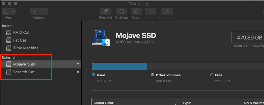

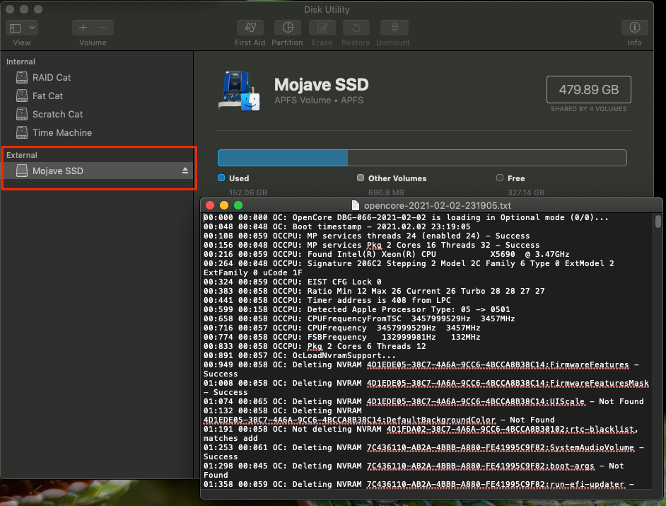

This is what I'm seeing on mine, and it's the constant deleting and setting that has me a little concerned. Depending on where and how it's stored, I'm sure write and erase cycles are finite.
Code:
02:415 00:148 OC: OcLoadNvramSupport...
02:582 00:167 OC: Deleting NVRAM 4D1EDE05-38C7-4A6A-9CC6-4BCCA8B38C14:FirmwareFeatures - Success
02:740 00:157 OC: Deleting NVRAM 4D1EDE05-38C7-4A6A-9CC6-4BCCA8B38C14:FirmwareFeaturesMask - Success
02:907 00:167 OC: Deleting NVRAM 4D1EDE05-38C7-4A6A-9CC6-4BCCA8B38C14:UIScale - Not Found
03:083 00:175 OC: Deleting NVRAM 4D1EDE05-38C7-4A6A-9CC6-4BCCA8B38C14:DefaultBackgroundColor - Not Found
03:258 00:175 OC: Not deleting NVRAM 4D1FDA02-38C7-4A6A-9CC6-4BCCA8B30102:rtc-blacklist, matches add
03:419 00:161 OC: Deleting NVRAM 7C436110-AB2A-4BBB-A880-FE41995C9F82:SystemAudioVolume - Success
03:575 00:155 OC: Deleting NVRAM 7C436110-AB2A-4BBB-A880-FE41995C9F82:boot-args - Not Found
03:749 00:174 OC: Deleting NVRAM 7C436110-AB2A-4BBB-A880-FE41995C9F82:run-efi-updater - Not Found
03:906 00:157 OC: Setting NVRAM 4D1EDE05-38C7-4A6A-9CC6-4BCCA8B38C14:DefaultBackgroundColor - Success
04:065 00:158 OC: Setting NVRAM 4D1EDE05-38C7-4A6A-9CC6-4BCCA8B38C14:FirmwareFeatures - Success
04:223 00:158 OC: Setting NVRAM 4D1EDE05-38C7-4A6A-9CC6-4BCCA8B38C14:FirmwareFeaturesMask - Success
04:399 00:176 OC: Setting NVRAM 4D1EDE05-38C7-4A6A-9CC6-4BCCA8B38C14:UIScale - Success
04:566 00:166 OC: Setting NVRAM 4D1FDA02-38C7-4A6A-9CC6-4BCCA8B30102:rtc-blacklist - Not Found
04:732 00:166 OC: Setting NVRAM 7C436110-AB2A-4BBB-A880-FE41995C9F82:SystemAudioVolume - Success
04:908 00:175 OC: Setting NVRAM 7C436110-AB2A-4BBB-A880-FE41995C9F82:boot-args - Success
05:057 00:148 OC: Setting NVRAM 7C436110-AB2A-4BBB-A880-FE41995C9F82:csr-active-config - ignored, exists
05:241 00:183 OC: Setting NVRAM 7C436110-AB2A-4BBB-A880-FE41995C9F82:run-efi-updater - Success
05:407 00:166 OC: Current version is DBG-066-2021-02-02

@Dayo - even after redeploying a new EFI configuration, I am still unable to switch to release mode. Been alternating back and forth with the SwitchRunMode tool with no success.
EDIT: will try v066b.
If you edited the file names and used names the tool would not use, then yes, it will not be able to reset things back as it uses and looks for specific file name patterns. You will have to reset things manually as the error message says.
If you did not edit the filenames but getting those errors (not clear from your posts) then that is a different issue that needs looking into.
I did not edit any filenames. I even went so far as to run a new configuration and redeploy; still got the errors.
I see. Will have to check what might be behind that. No changes were done to v066b on this front so expect the same results.
Just ran RunSwitchMode again without any errors. An edit of filenames is the only thing I can think of but let's see if someone else has the same issue.

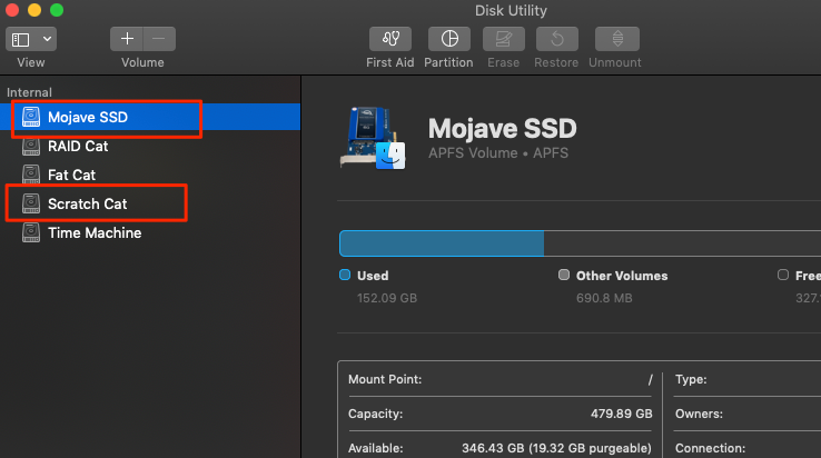

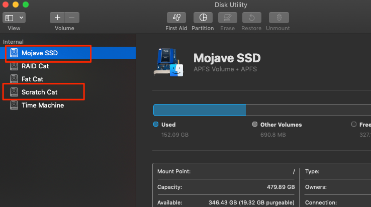

Good news. v066b using older version of Innie works perfectly. All PCIe SSD drives are identified as internal devices.
I was also able to switch to release mode without problem.
