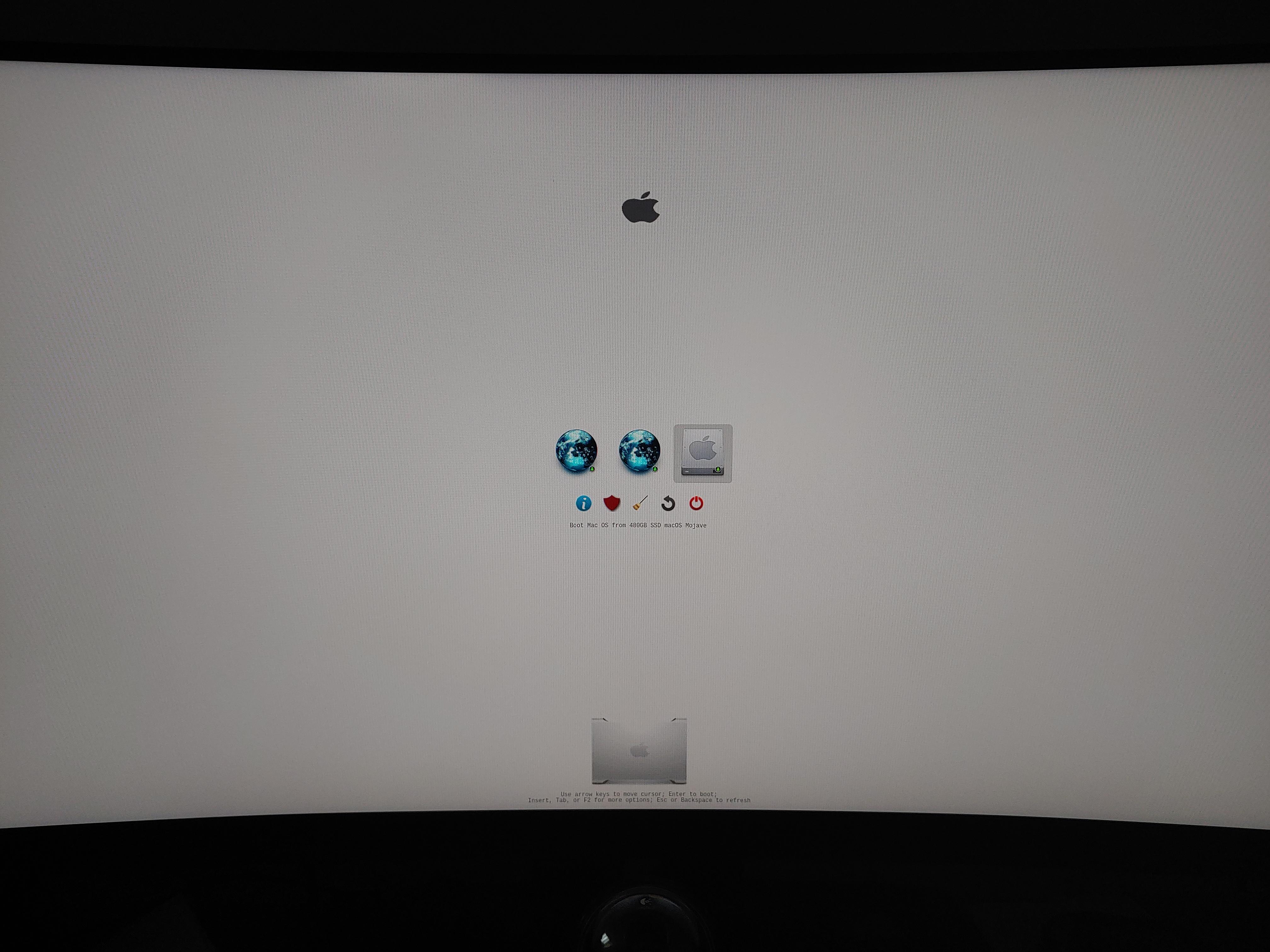

I had a similar problem when I upgraded to the most recent RefindPlus. In my case, I disabled an option in the override.conf file, which suddenly made all my volumes appear on the next boot. I do not know if the option itself was causing the problem, or somehow something need to flush some cache somewhere or something weird like that. I mentioned it in an earlier post, you can look for it.
But really to debug the problem you need to take a look at the conf files you are using for RefindPlus as first step prior to assuming its a bug. I do think there might be some kind of bug though based on my previous experience mentioned earlier on this thread a week or two ago.
Thanks for your feedback. I'm attempting to give @Dayo all the information he needs to help me solve this issue, but since I'm a total newb to all this, am unsure where to get the RefindPlus log files - or even how to enter debug mode. I'm searching the forums as well as this thread, and am having difficulty gleaning this information. Would you be so kind as to tell me where the log files are located?
EDIT: NVM. I used the FetchESP tool to get the logs from my EFI volume. Sorry guys.. I'm learning this as I go.
As I said, you should start out by reading the post#1 on this thread completely and thoroughly, which is exactly what Dayo is going to tell you also. Try that and see if you get a working system. If so, then save and if you want to custom configure either RefindPlus or OpenCore on your own you can branch off and do that, but Dayo has worked out a lot of details and so first I recommend you follow the instructions exactly with MyBootMgr and see if you get a working system. If you are unable to get that working then its a good time to figure out why before trying to manually install RefindPlus and OpenCore. You might even just decide to use the MyBootMgr setup exactly as is..which is a very good configuration.
I've read post #1 about 50 times thoroughly over the past two weeks. I've followed Dayo's instructions to the letter. Everything works as far as seeing the RefindPlus bootpicker on my non-EFI Vega 64. I can also launch an OpenCore instance of Mojave and again, everything there runs fine. I just cannot see the native Mojave installation in the bootpicker, which according to Dayo, should have appeared automatically.
Not sure what you changed on MyBootMgr 065a, I will check that out anyway. However I did seem to solve my problem by removing an old entry in the RefindPlus overrides.conf file, which was from a month ago when we were playing around with HiDPI stuff...when I remove the following option, suddenly scanning worked:

I just read all of your posts related to my issue up to the one quoted above. I've tried configuring RefindPlus set to either hidpi or non-hidpi. Neither setting has resolved the issue.
MyBootManager was configured on a fresh Mojave install. Only thing I can think of is that non-OC Mojave sees it's boot drive as external since it's on an OWC 6g PCIe SSD instead of a drive installed in a sled. Perhaps that is why RefindPlus doesn't see the Mojave install within the picker?
BTW, where would the option to boot into the Mojave restore volume reside? Should it be listed as one of the boot options in the default OpenCore session? I don't see it in RefindPlus picker or OC hence my question. Selecting the default OC session only gives one option:
*1: Mac OS Mojave (or something to that effect)
Ok, I don't know what I did because I'm exhausted. I changed some parameters in MyBootManager. Now I'm seeing the non-OC Mojave installation. I'll upload the config and logs tomorrow.

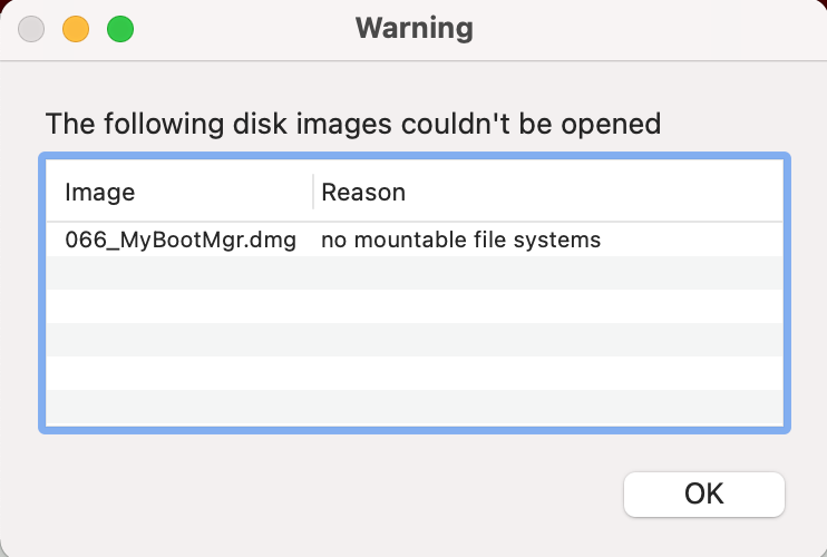

Typo in the installation script.
Delete current, give it 15 mins and download again.
PS: Make sure you shut down your browser completely and reopen before attempting to download.
You can also use another browser or private browsing mode.

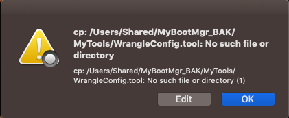

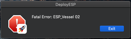

Also, I ran into this after running ConfigFactory then attempting to DeployESP:
Edit: good news is that it appears EFI folders were copied anyway. Seems like I was able to boot into OC v066 just fine.
Trash any previous and download again.
I had forgot some issues with running from OpenCore dealt with now
Corrupted cache on my server after swapping the package .... issued a reboot to clear it.
Need to make a checklist to follow for various actions.
