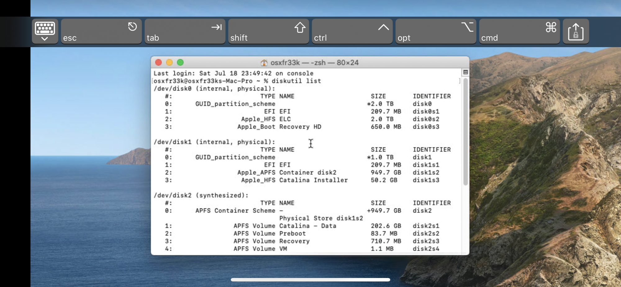

Actually there is more to this. My other drive is El Captain HFS+ while my SSD is APFS Catalina so from the ELC boot screen after holding down the option key it shows Catalina as EFI and then when it boots I see an EFI shell script run then it boots to Catalina. This is before installing rEFInd. There is also an APFS.efi file in the root of the Catalina volume EFI.
Also just to make things clear rEFInd is being installed on the SSD drive Catalina. MacOS ELC drive will be left alone.
Diskutil list labels the APFS physical disk as Disk1s2 as Container Disk2, and not Catalina?. I have to assume I need to put that in as the volume name in the two scripts we run?

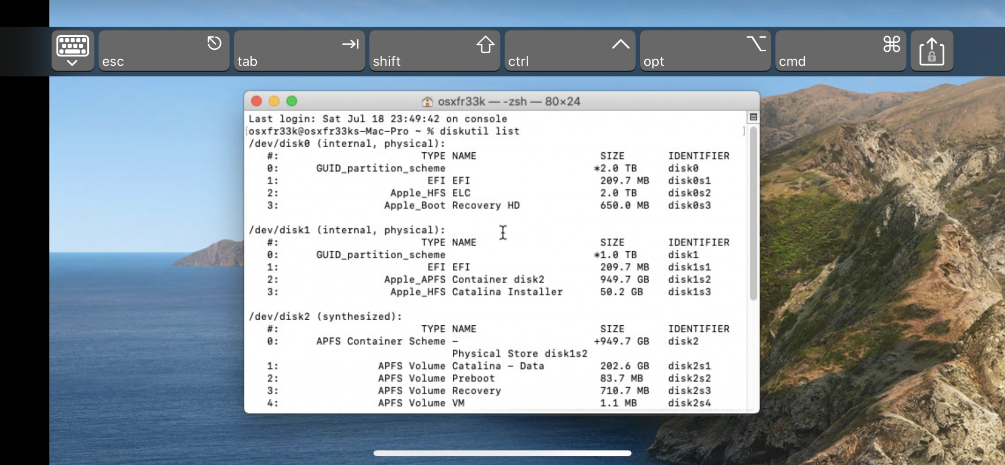

Here is a screenshot:
Sorry, I got a bit lost in between the various drives mentioned but the guide should tell you what exactly you should be blessing.

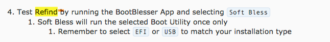

Actually as far as I can see the guide does not tell you which to bless. I don't see that bug your speaking of. From the rEFInd boot screen when I click on Open core it loops back to the rEFInd boot screen.
Is the above not clearly referring to RefindPlus enough or is there another part you mean?
I can make it more explicit if needed.

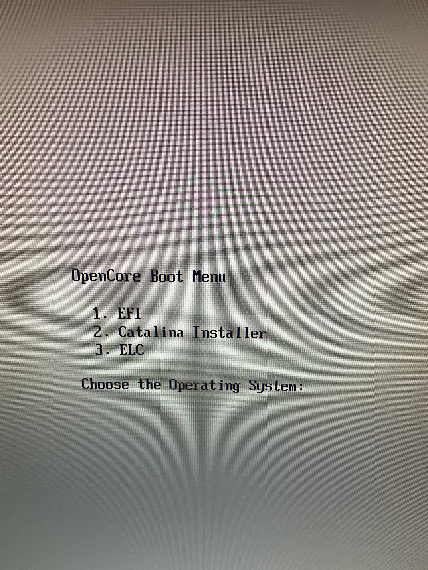

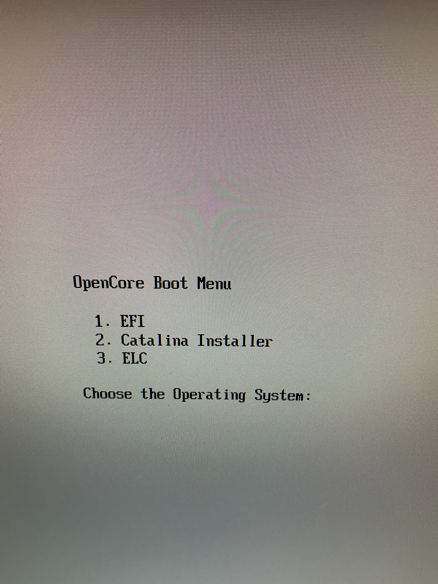

Not right ... Suggest you reset startdisk, reset NVRAM and start over.

Is the above not clearly referring to Refind enough or is there another part you mean?
If still an issue after, there is a chance of a problem I can think of but try again before I look into investigating it further.

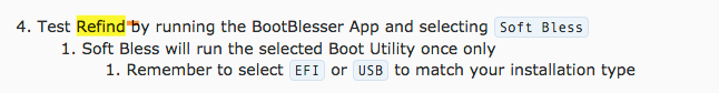

Ok will try that. I think you should say test rEFInd choose rEFInd from the bless utility.

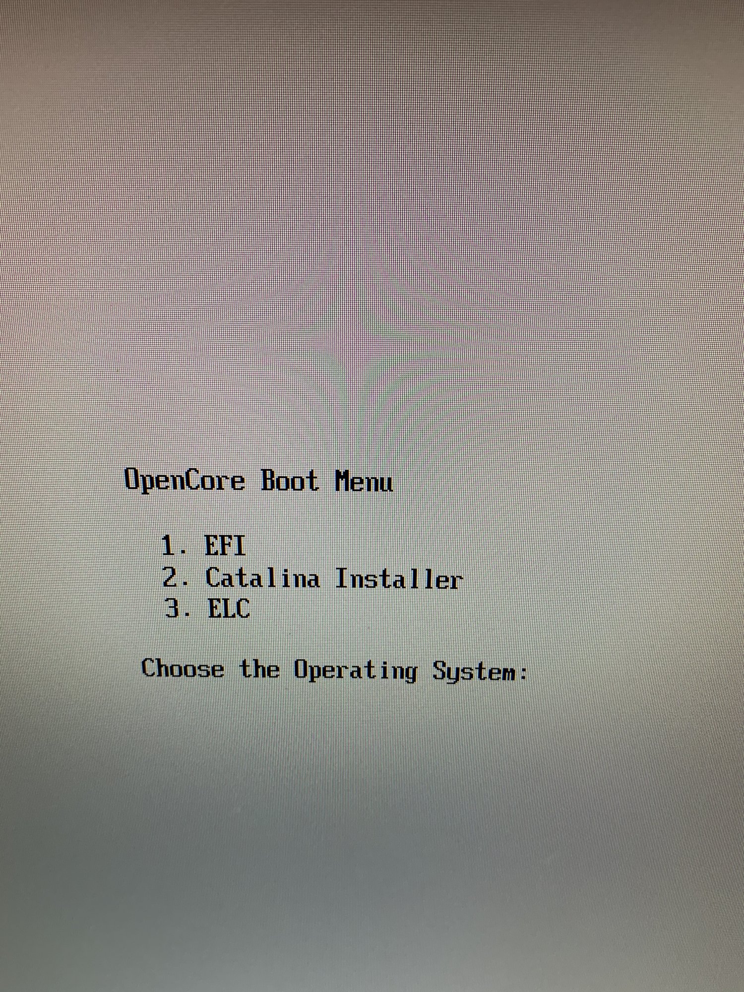

can you tell me what the volume should be from my screenshot?
You said you installed Mojave using the dosdude1 patcher I am sure its APFS, can you see if your EFI contains an APFS.efi?
see the two screenshots my APFS Catalina volume does not show up only the EFI which if you read my post about the drives and explanations you will see that EFI is the actually volume name I don’t know why?
So when I choose EFI it loops right back to the rEFInd boot screen
Amended the text
If you add a volume name to the DiskLabel.scpt file as explained in the guide, you will not need to use diskutil list.
Note that I have just updated the package to myBootMgr-059a which addresses this issue.
Assume you are on a 3,1. Mine has the APFS ROM Patch applied, so it boots APFS natively. I can see that not having this might be a challenge and that you probably need to add the APFS.efi driver to Refind. A bit of a hole in the guide.
Amended the text
Ah Ok I did apply the APFS rom patch on the 2nd reboot right after the install was complete I booted back into the Dosdude1 installer (Recovery) and applied the ROm patch and assumed it placed the APFS.efi into the EFI, let me re-apply that patch and remove APFS.efi to see if that fixes things or not. I think Catalina is the challenge or APFS not sure?
Ah Ok I did apply the APFS rom patch on the 2nd reboot right after the install was complete I booted back into the Dosdude1 installer (Recovery) and applied the ROm patch.
If using the APFS ROM Patch, then you shouldn't install the DosDude APFS Patch ... APFS.efi is placed in the efi by the DosDude Patcher if APFS patch is selected.

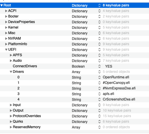

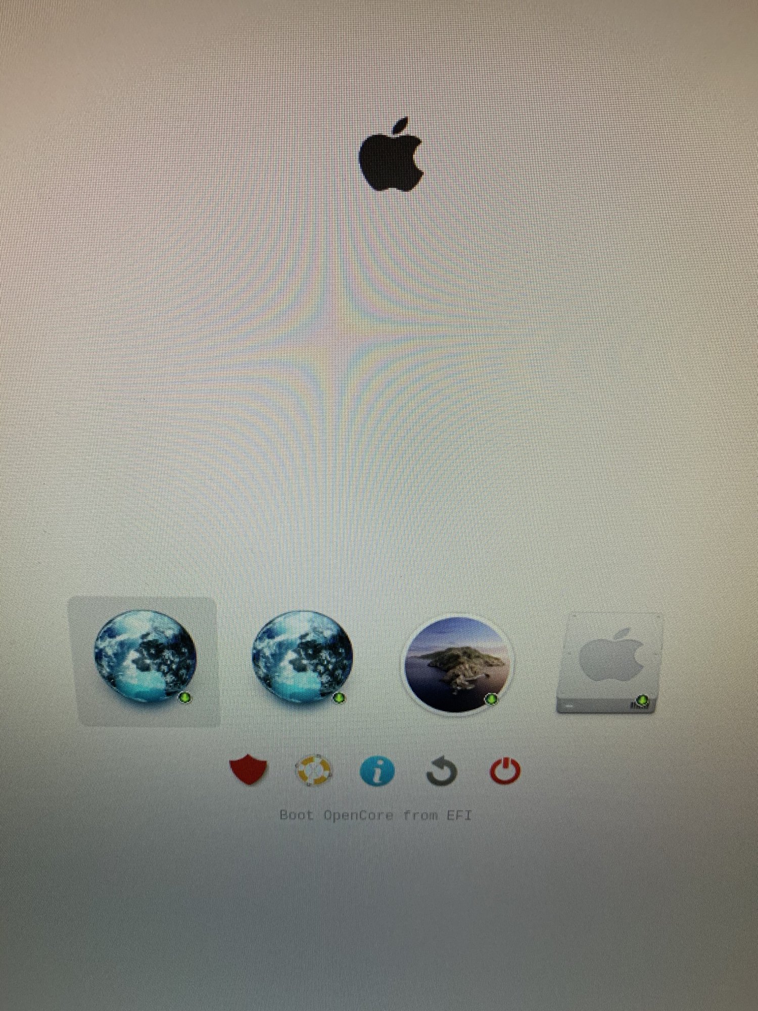

Problem Solved placed the apfs.efi into the OC/Drivers folder updated the config.plist file to include the apfs.efi in the EFI section/drivers. Catalina is now displayed when I choose OC from the rEFInd boot menu, its listed now as number 4.
I am thinking of displaying Canopy with the resources not sure if that will work to give a second GUI screen?
I think I forgot what the APFS ROM patch is versus Dosdude1's APFS patch? I don't think I ever applied the APFS ROM patch? Is there a link to that?
All working now thanks!

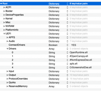

I made a change to the key order under kernel/drivers in OP config. LILO should be first and whatevergreen should be second, something I read in the OP manual.

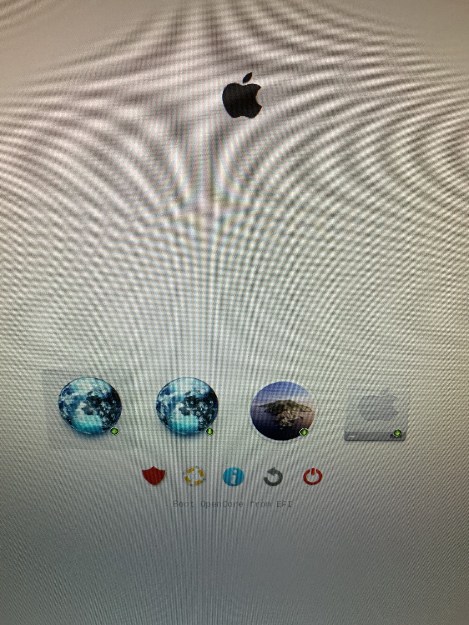

Can’t get it to show the Boot GUI when canopy is enabled. Maybe the resources I grabbed are not correct for macpro3,1? Is that universal for Macpro5,1 and Macpro3,1. It could also be something related to the rEFInd GUI then launching a 2nd GUI just might have issues. I have to search to see if anyone has been able to get this working and the settings they may have done for the rEFInd conf and OP config
The Config posted in the OP is perfectly fine and is tried and tested. Don't change it based on misinterpretations of the documentation.
What the OpenCore docs actually say is equivalent to: "When reciting the alphabets, 'D' should come BEFORE 'F'".
What you have interpreted that as is: "When reciting the alphabets, 'D' should come FIRST and 'F' should come SECOND".
It is universal. It would be pointed out if not.
There is nothing in this setup that stops any OpenCore feature from working. No interrelationship in this respect.
Most likely a misconfiguration on your part. Ask for help on OpenCanopy config in the main OpenCore thread.
Again, note that the fact of chainloading from Refind has no relationship with how you configure OpenCore apart from the one item in the guide about ProtectBoot.

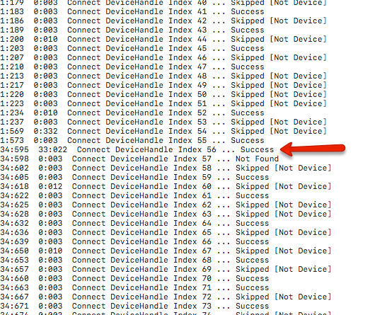

OK. On my rig, Refind typically shows the boot screen in 6 secs. However, it sometimes takes 30 secs. When this happens, a drive connected to a PCIe slot does not load and this intermittent PCIe Slot drive issue is well known.
Also affects direct OpenCore boots but not yet figured out. See: https://github.com/acidanthera/bugtracker/issues/861#issuecomment-616344925
The image below shows the boot log from such an instance and it is something I need to look into further (It is intermittent as said):
Having said all that, your issue seem to be totally different and I can't give suggestions on it.
Refind does have a 30 Sec delay issue which might be your issue but AFAIK, this is not intermittent as you say yours is.
