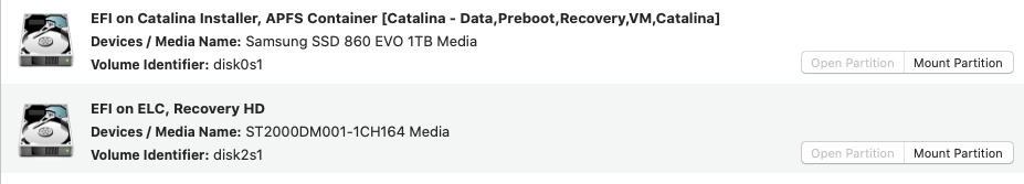

I posted the question over to Catalina on Unsupported Macs no one replied maybe my question did not have enough details. Let me bring this up here again the volume "Catalina" boots to prohibitor sign but "Preboot" does boot to Catalina. I removed do not scan volumes "Preboot from the Chainloader Config. Just can't figure out why the Volume Catalina won't boot yet Preboot does boot into Catalina? The volume for Catalina on the SSD drive where I placed rEFInd EFI to that drive looks to be volume name Catalina but when I go to mount the EFI I see this string of volumes from Clover Configurator see below. Catalina Installer is a HFS+ partition off the SSD. Something is throwing this off maybe the HFS+ partition is?
Edited:
It looks like the volume name is Catalina Installer am I correct in this? I don't know why it does not say EFI on Catalina? For the Samsung SSD drive EVO 860, Disk Utilities shows 1 APFS container Disk1 with two volumes, both Catalina and Catalina - Data and a 2nd partition Catalina Installer HFS+ partition. Clover Configurator Mount EFI details make it look like EFI is on Catalina Installer? I'll remove the installer partition see what happens.
Removing the partition did not resolve it.
Edited Again:
Is rEFInd working in Catalina 10.5.6?
Edited 8-2-2020 19:46:
Everything working now, I installed 10.15.6 reset P&R cleared and refreshed EFI re-blessed and now the Catalina Icon from rEFInd boot menu boots to Catalina finally!!!

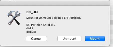

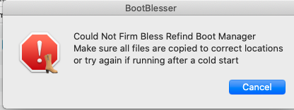

I thought I read that here must have it confused with another guide. Your EFI mounter and Bless tool is not working!
They work for me. Perhaps you've mixed something up.

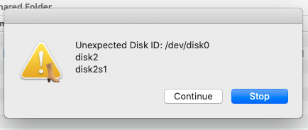

Nope nothing different here. Its confused about the physical mount versus the virtual volume same issue with EFI mount tool. No issues mounting EFI with Clover Configurator Mount EFI. I'll have to try using the terminal command to bless the volume I guess.

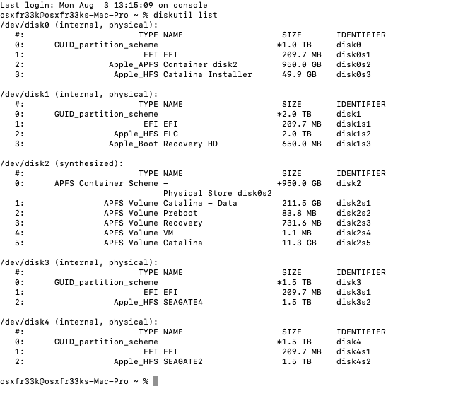

Share screen shot of list of disks you get to select from

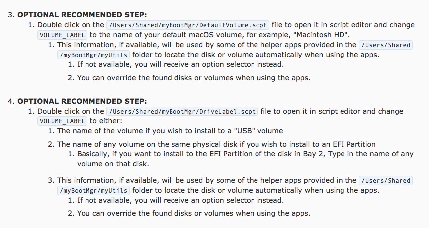

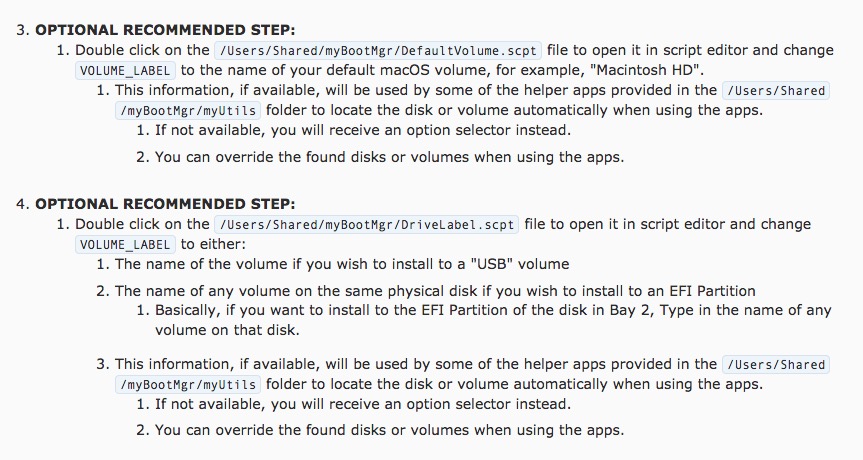

However, why aren't you using the *scrt file approach recommended in the guide?

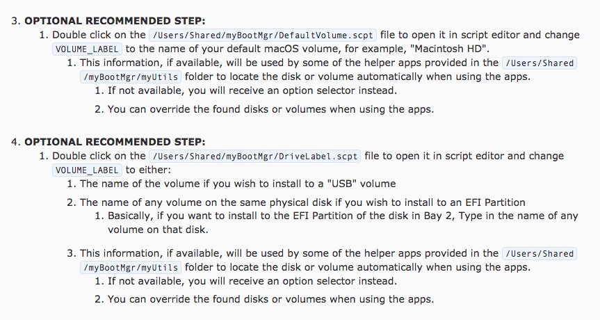

Absolutely this is the first thing I did on 0.59 and 0.60. I removed all the drives except the Catalina SSD still get an error ill try override this time.
Guide doesn't say you should remove any disks. Just says open the file and enter the name of any volume on the disk that holds your EFI partition.
I understand but just to make sure its an easy step for me to troubleshoot the issue is to just slide out until disconnected from SATA just until I figure out why this is happening.
So override worked for both the EFI and Bless App. It boots to Refind boot menu but it get sot a console text menu not GUI based. Is this how the new version works? Do you need a screenshot?

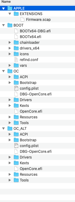

Here is the hierarchy of my EFI:

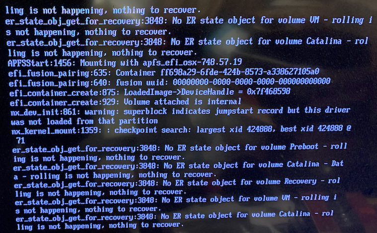

Here is the message I see before the refind menu populates which I never seen before including the 0.59 version.
