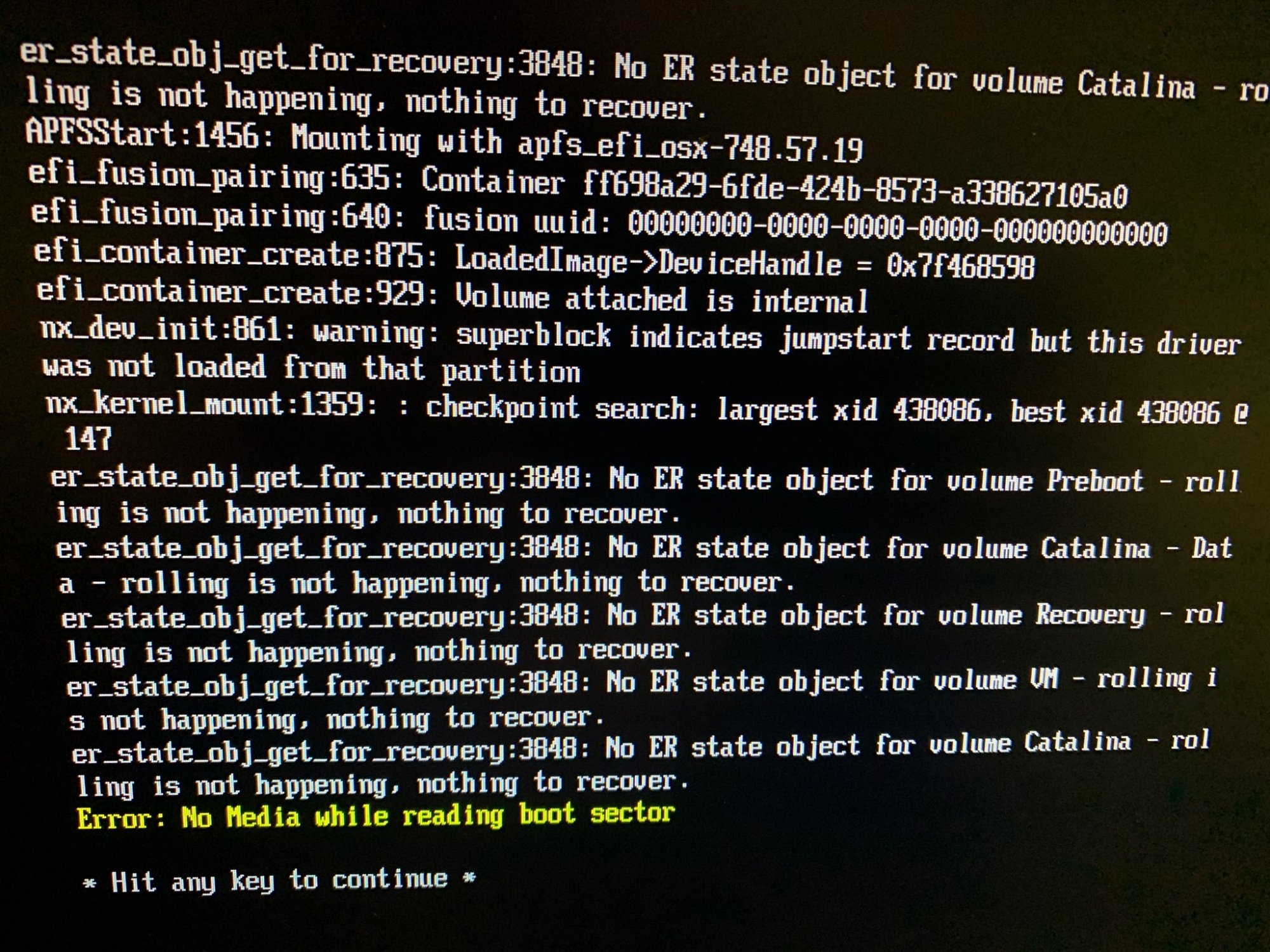

So used the 059 library and the 059a dedug file it doesn't like it for some reason see refind.log zipped and picture of boot issue.
  • refind.log 3.zip
    refind.log 3.zip

Your confusing me now to I had 060a setup and placed in the DBG file you attached. Tell me exactly which version you want in EFI right now its 059 with the Debug file you attached. The first time it was 060a library with the DGB file you attached.
Paste in BOOTx64.efi from v059.
This is not a debug version so you should just tell what happens.
Everything works fine in 059 when I swap 059 boot file for the 059a DBG(renamed of course) I get the error posted above and the refind.log is from 059 package with 059a debug file you attached is this what you wanted? If I replace the 059 file back it boots normal I have the GUI boot menu.
I already posted library 060a in EFI with the DBG file you attached replaced in the 060a library. Same issue no GUI menu and the media error. So you have from 060a and 059 libraries the DBG file you attached replaced in both libraries.
